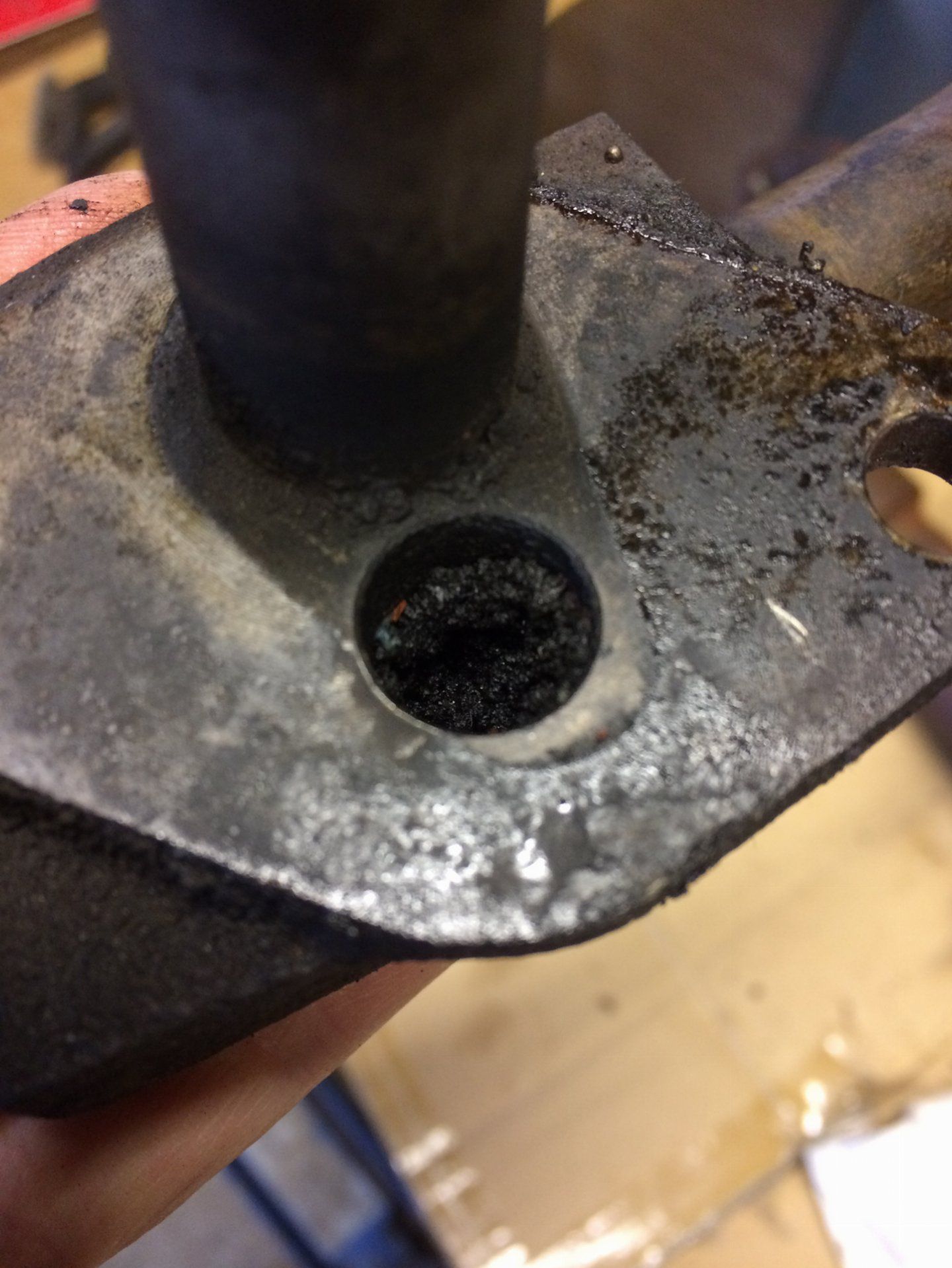

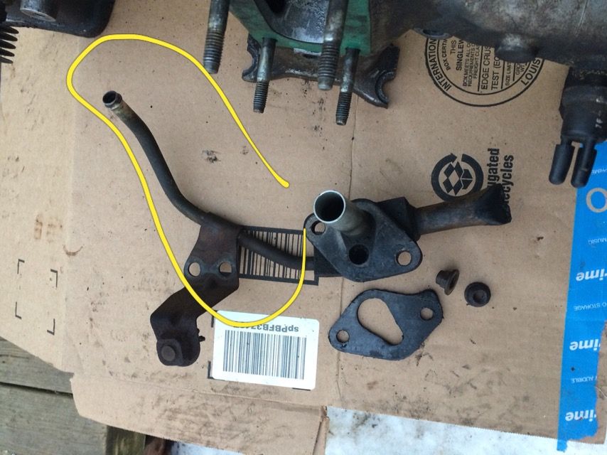

As I did this I realised the crimped intake pipe to egr plate and it's vent pipe to pcv needed to come off. Again easy. Bolts were not tight. Oddly one was a 12m and one was a 13mm. But looking into the mouth of the pipe from the plate I could see it was pretty gummed up. For hahas i tried blowing into the pipe and and found it's totally clogged.
@Cgbeachbum, this pipe goes to the positive crankcase valve I linked you to that I'd cleaned out... thought I'd point it out again as the pipe itself on mine is crazy clogged. Hence cleaning the valve out will do squat if the vapours can't even vent thru the pipe off the carb base.
So my sleuthing has shown me that two fairly big factors in venting hot gasoline vapors from the carb out could have been huge contributors to my intake cracking. 1) My carb fan (doesn't work... knew that awhile back) and now I find my carb could not even adequately vent vapors due to the 2) PCV pipe being completely clogged.

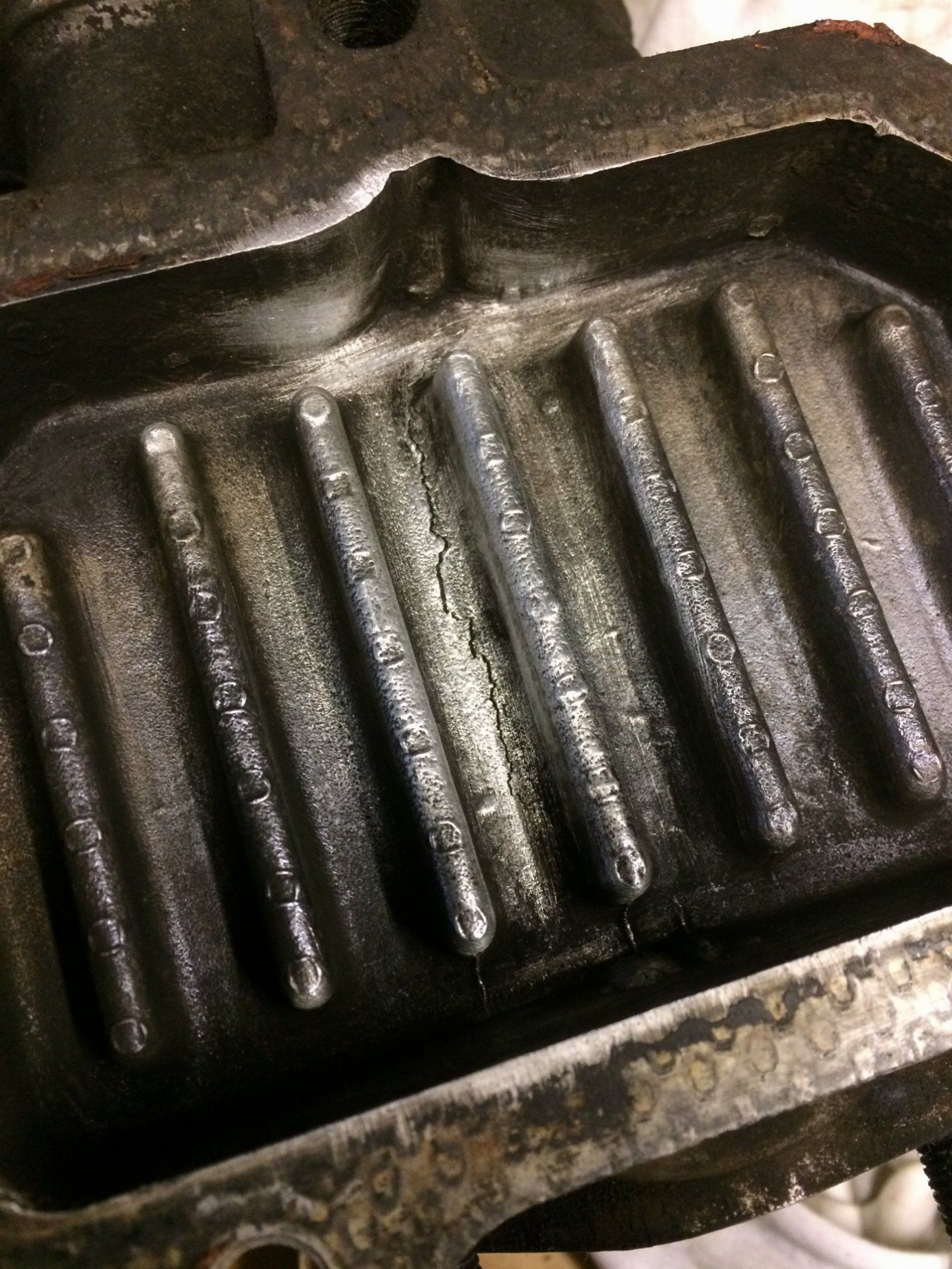

Just another suggestion for future crack inspections, if you go to a local welding supply shop, you can buy a Dye Penetrant system, where you spray a cleaner, then spray the dye, followed up by spraying an activator, if there are cracks, the dye will soak into them, wipe the excess off and the spray the activator, which will pull the dye from the cracks and give you the indicator of where the crack is... or isn't.... I've used this stuff a lot when inspecting ships hulls and their welds... just an FYI, looks like you have it all handled though!!

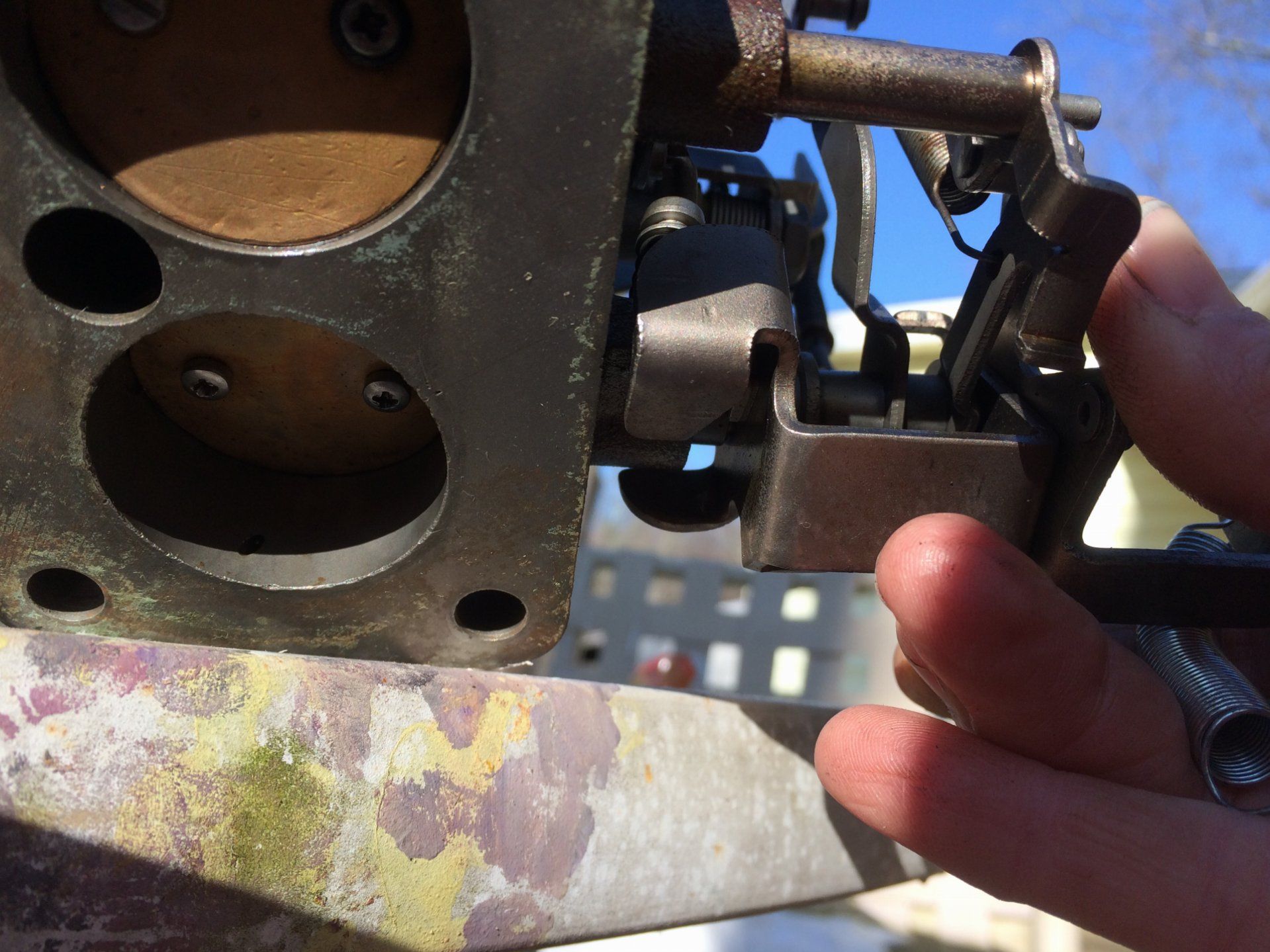

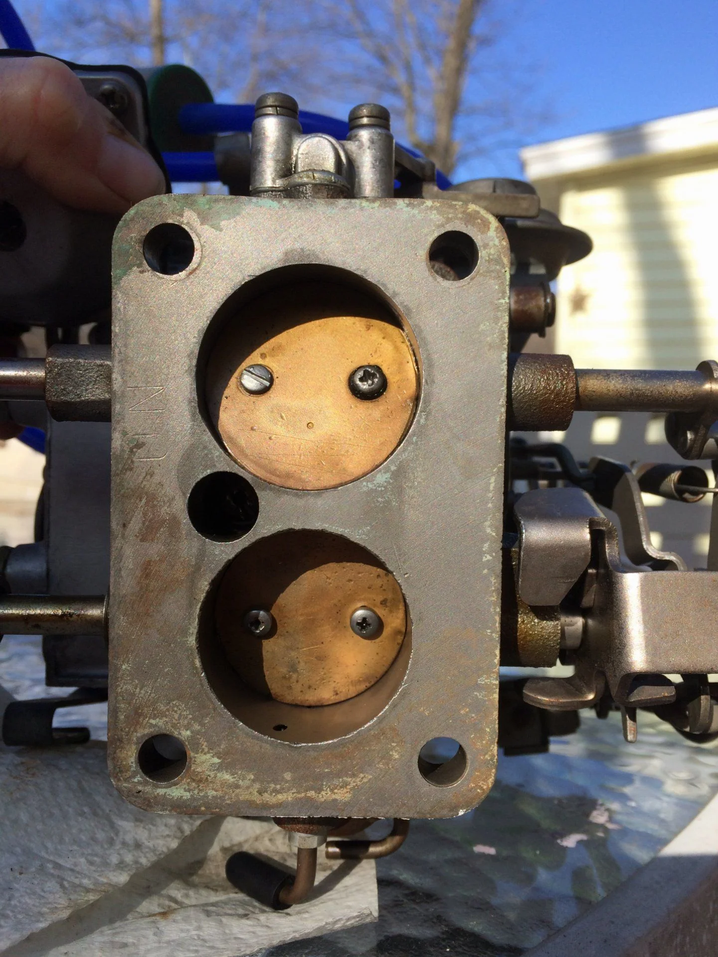

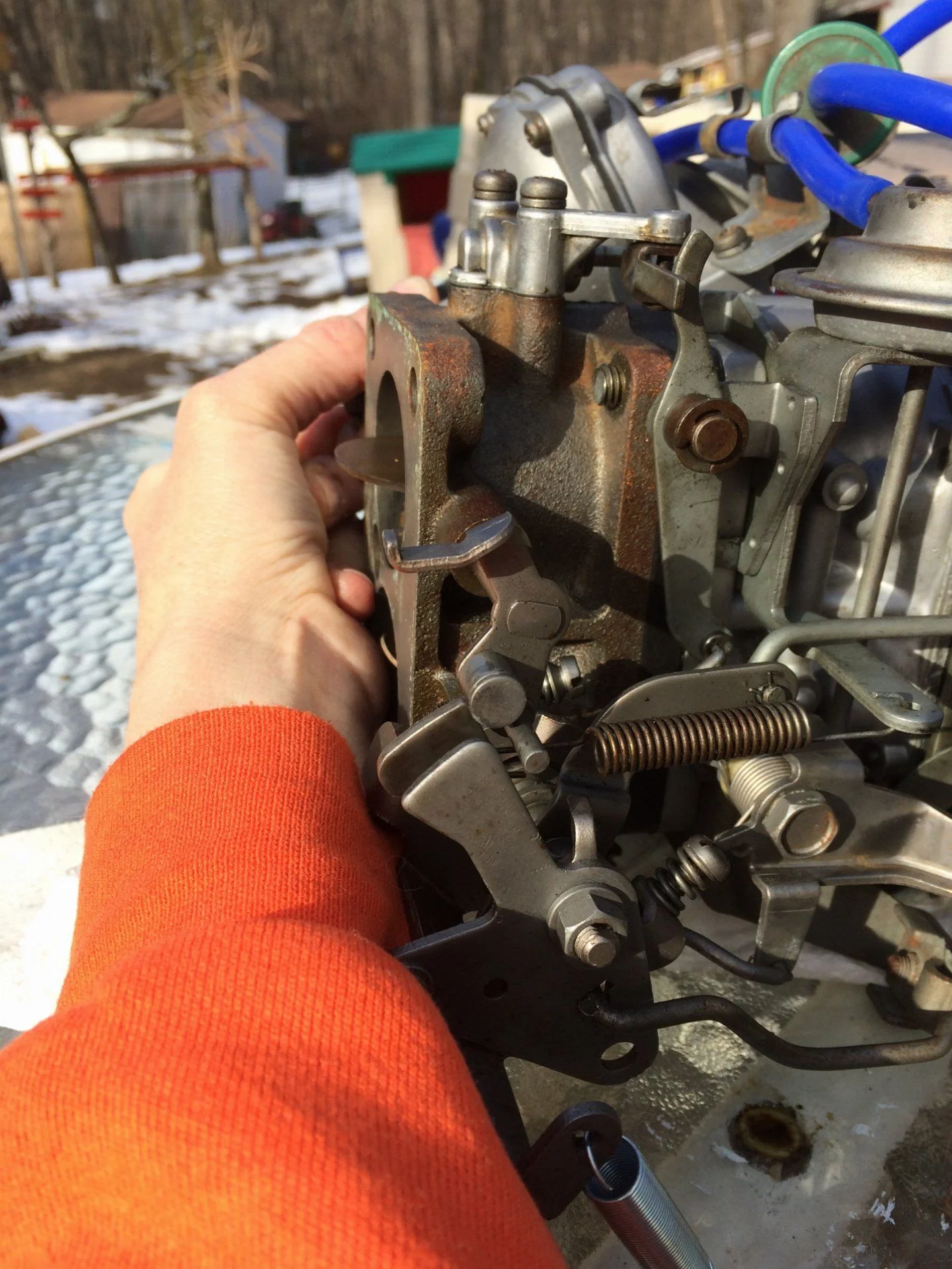

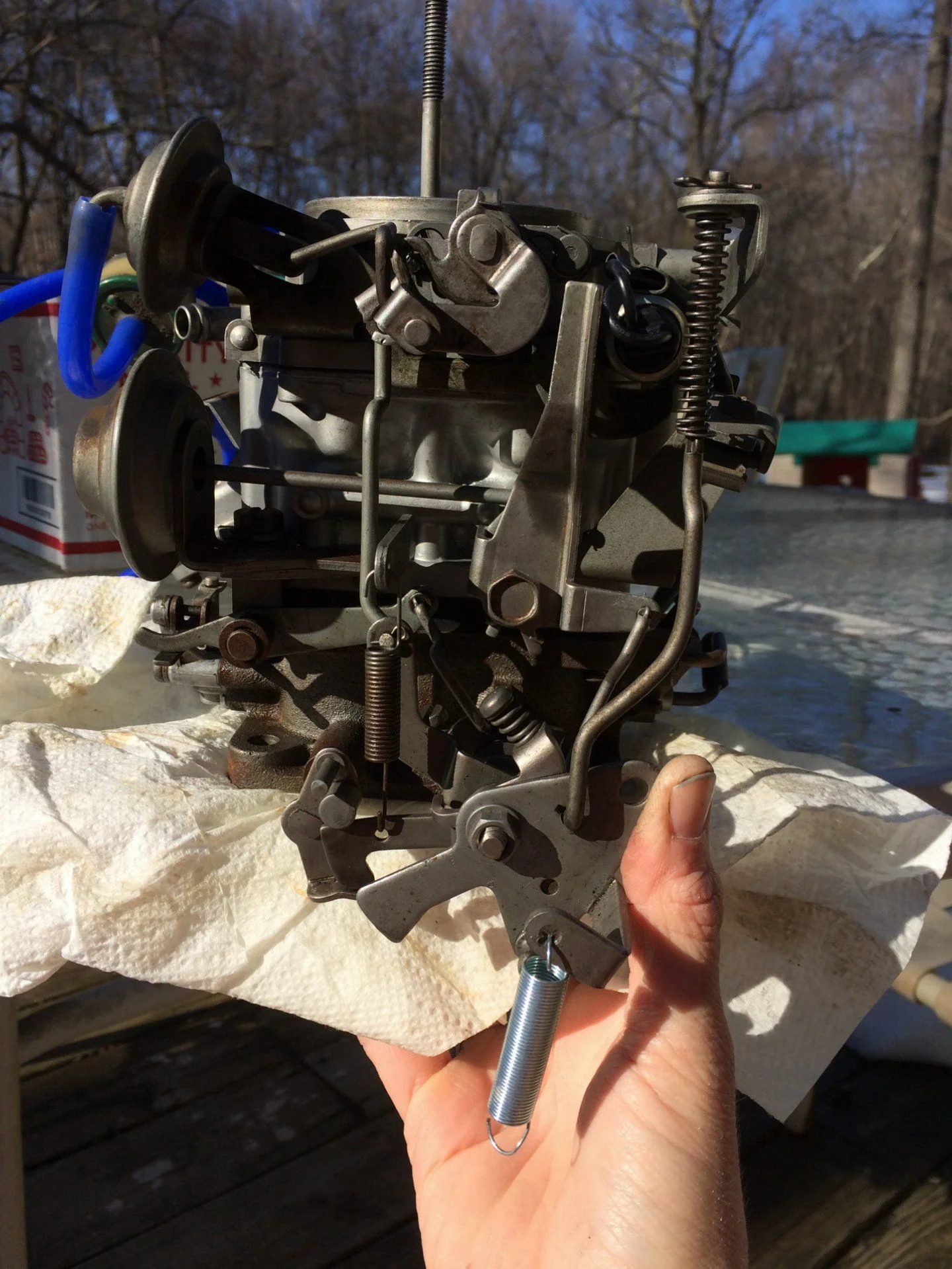

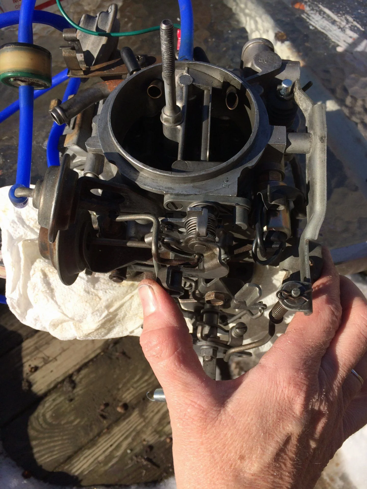

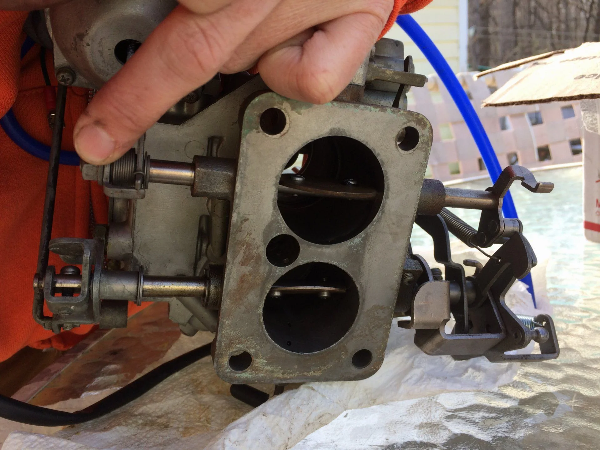

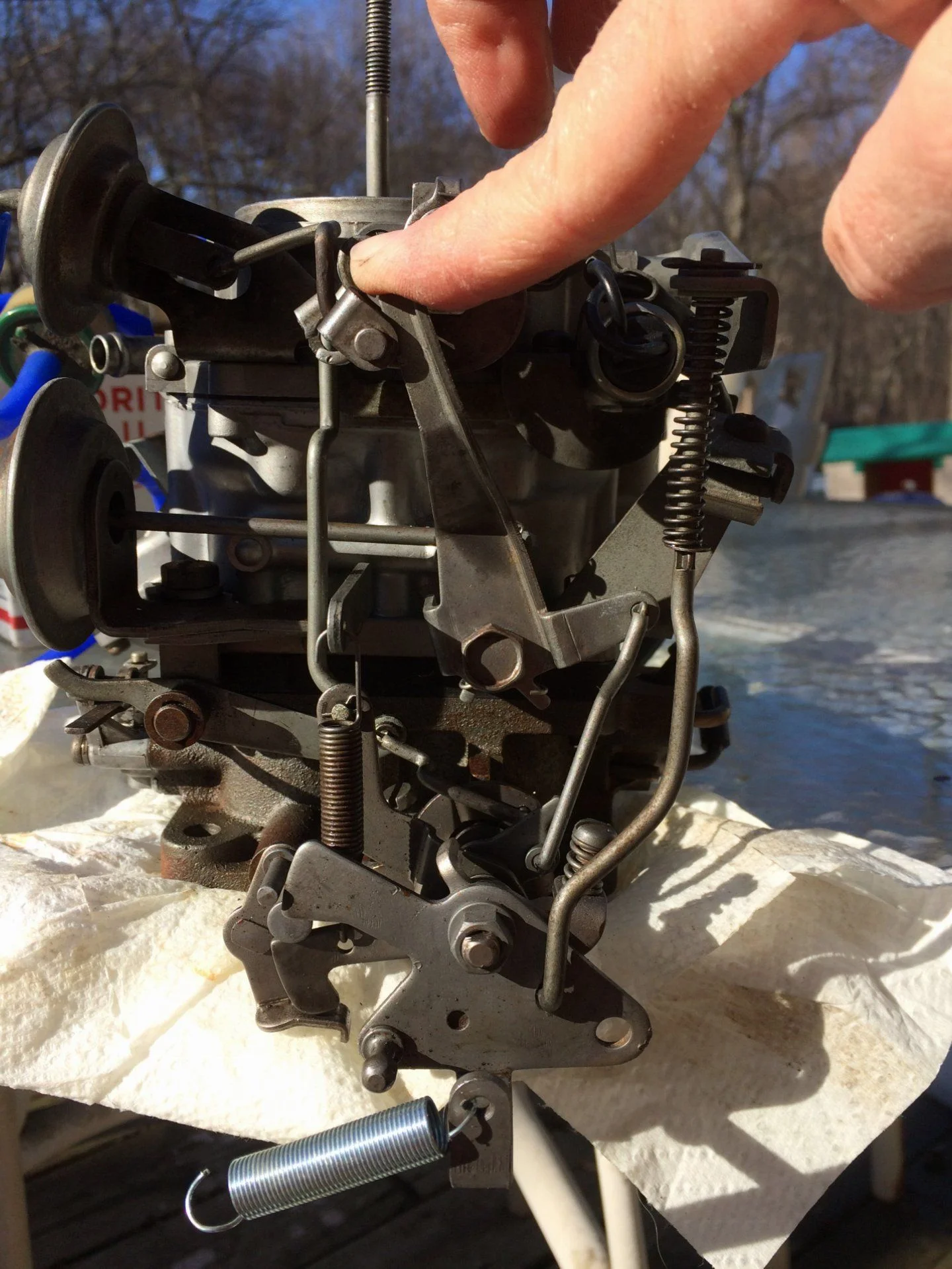

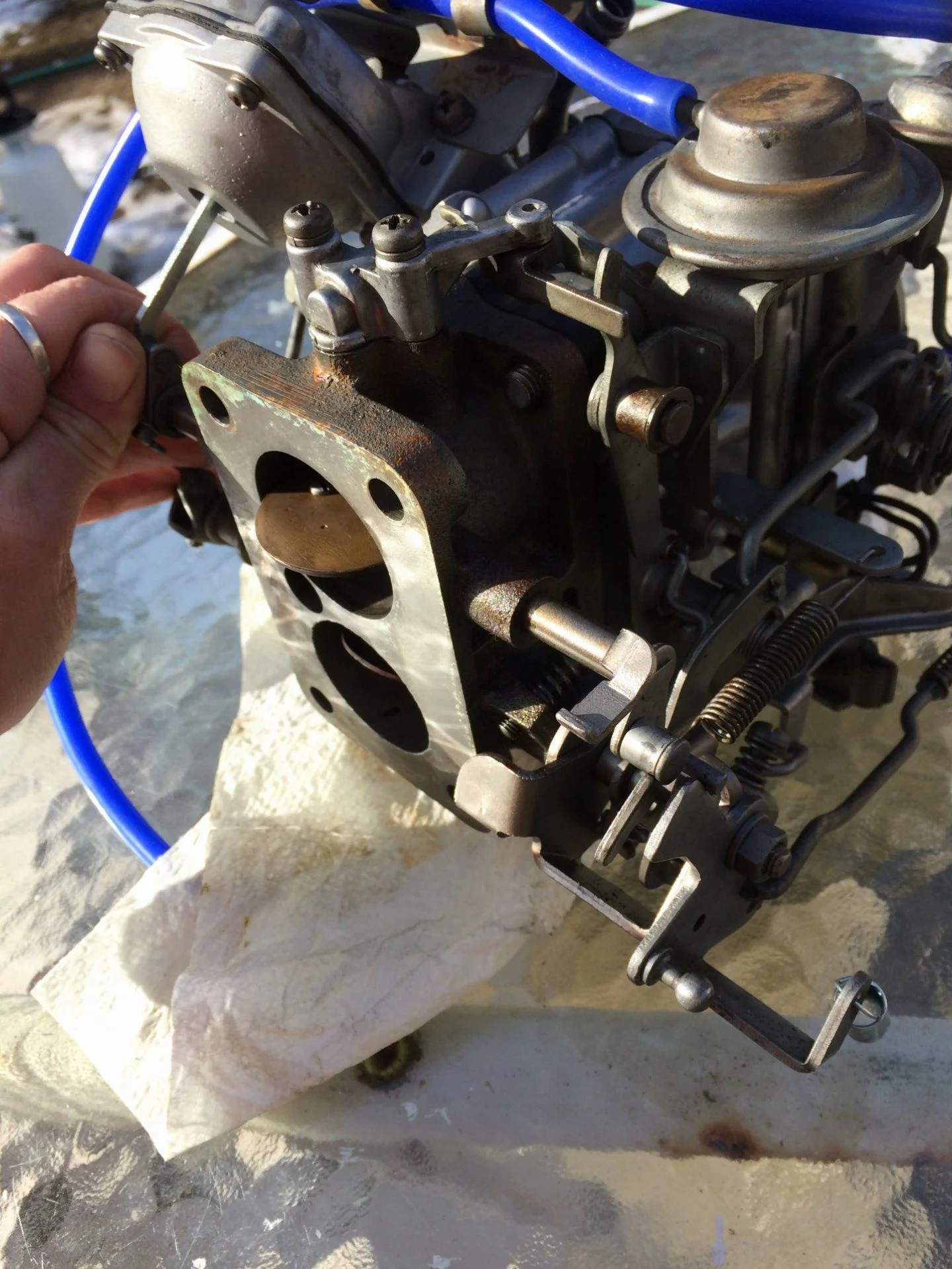

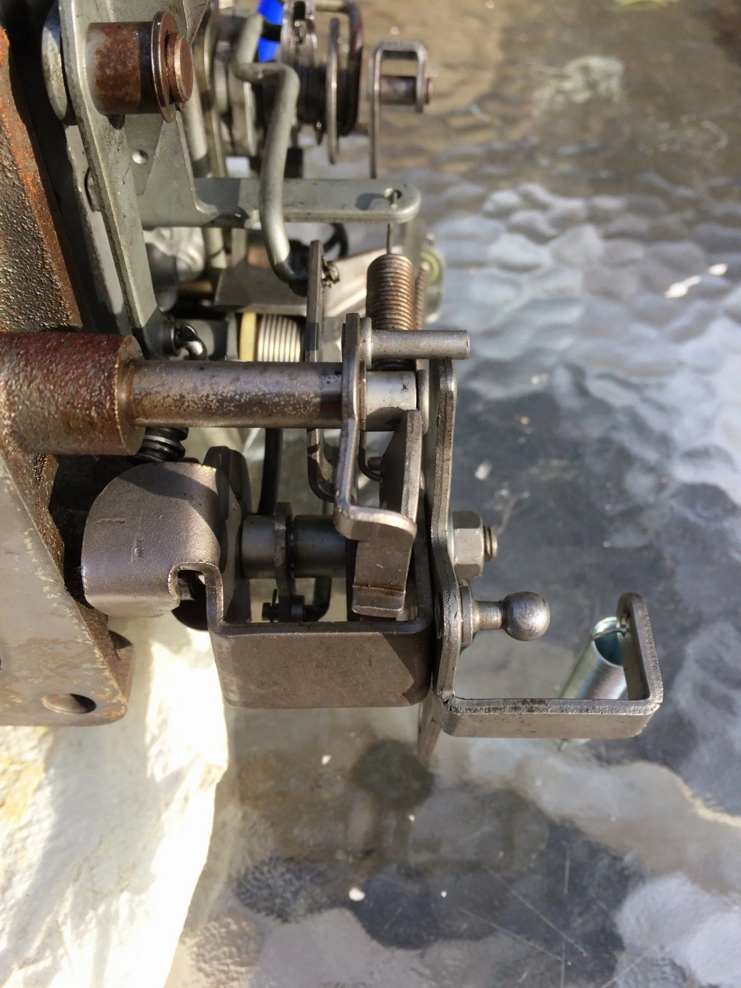

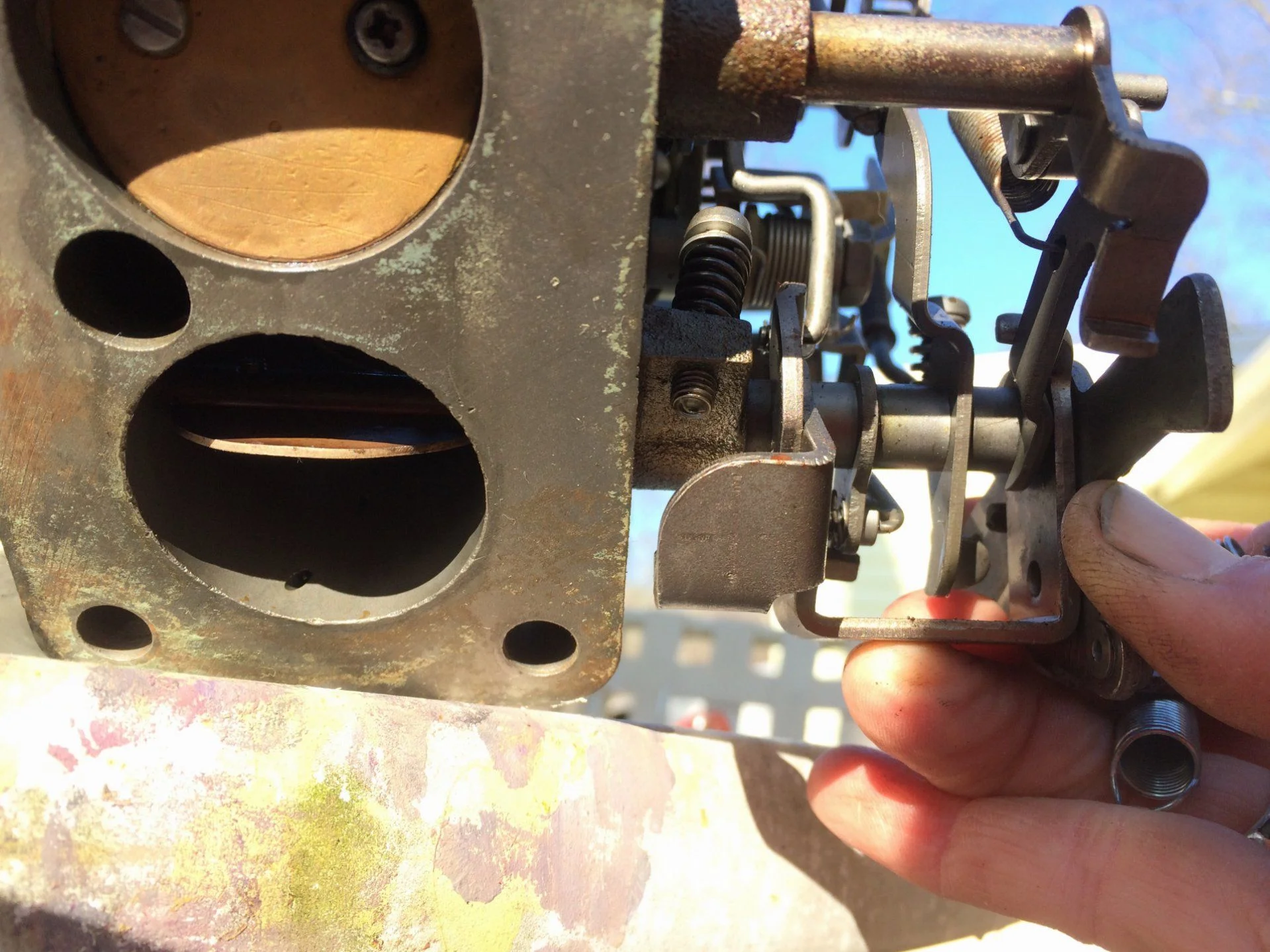

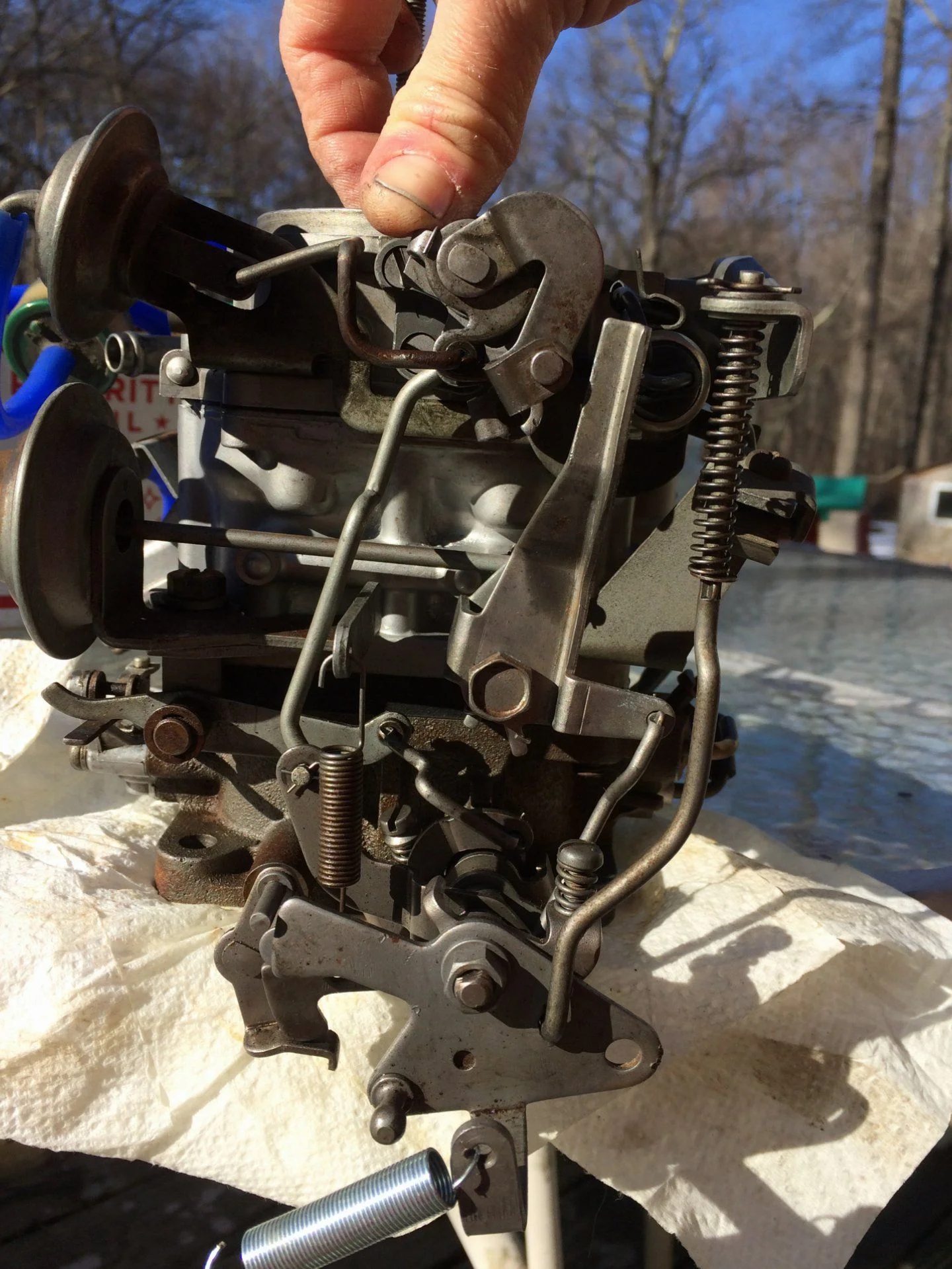

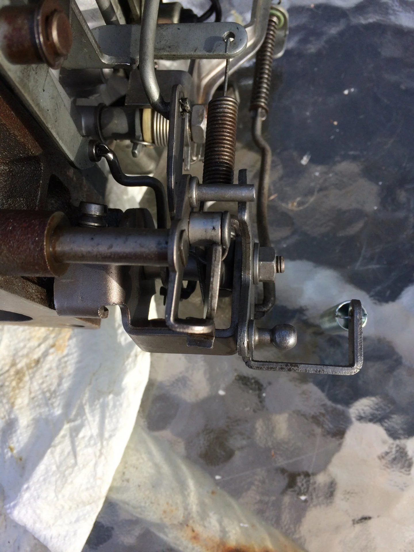

Carb linkages: I was inspired today by a couple pixs that JimC posted of carb throttle plates (the butterflies) and how the appear when a certain amount open or closed.
I have my carb off because I have my manifolds off so I put it in the sun and started tweaking linkages and taking pics.
Choke pulled out fully (plate open), choke pushed closed (plate closed).
Throttle plate (butterfly) opened/closed.
Last are both closed.
Appears someone changed out three of the four screws too. That's huge as I have seen always recommended by JimC to not mess w/ them. The good and bad of taking a core and rebuilding it and shipping mine off as a core. These are things I did not take in and consider.
So to get both plates to open... I keep screwing around w/ linkages ect until I got it. Not easy to get a good shot w/o a third hand.
Third pix I'm pressing the secondary diaphram rod inward and trying to keep my arm on the linkage opposing the carb base.
Then my eye caught that one area has a bend to it that I'm wondering if it's supposed too. As I kept trying to get the secondary throttle plate to open I felt it hanging up....
So I marked up the pix. This section has a outward bend to its top edge (yellow circled and red arrow pointing outward). Should it?
That circled item strikes the foot below it to kick open the secodary a little to establish the vacuum necessary to then activate the secondary pot. It might have been bent outward by accident at some time. I'd bend it back to center over the foot. It took a little fiddling for me to get that part of my carb to work like it should. If it doesn't kick open far enough, your secondary won't open.
Thanks! I'm so glad I decided to check it out.

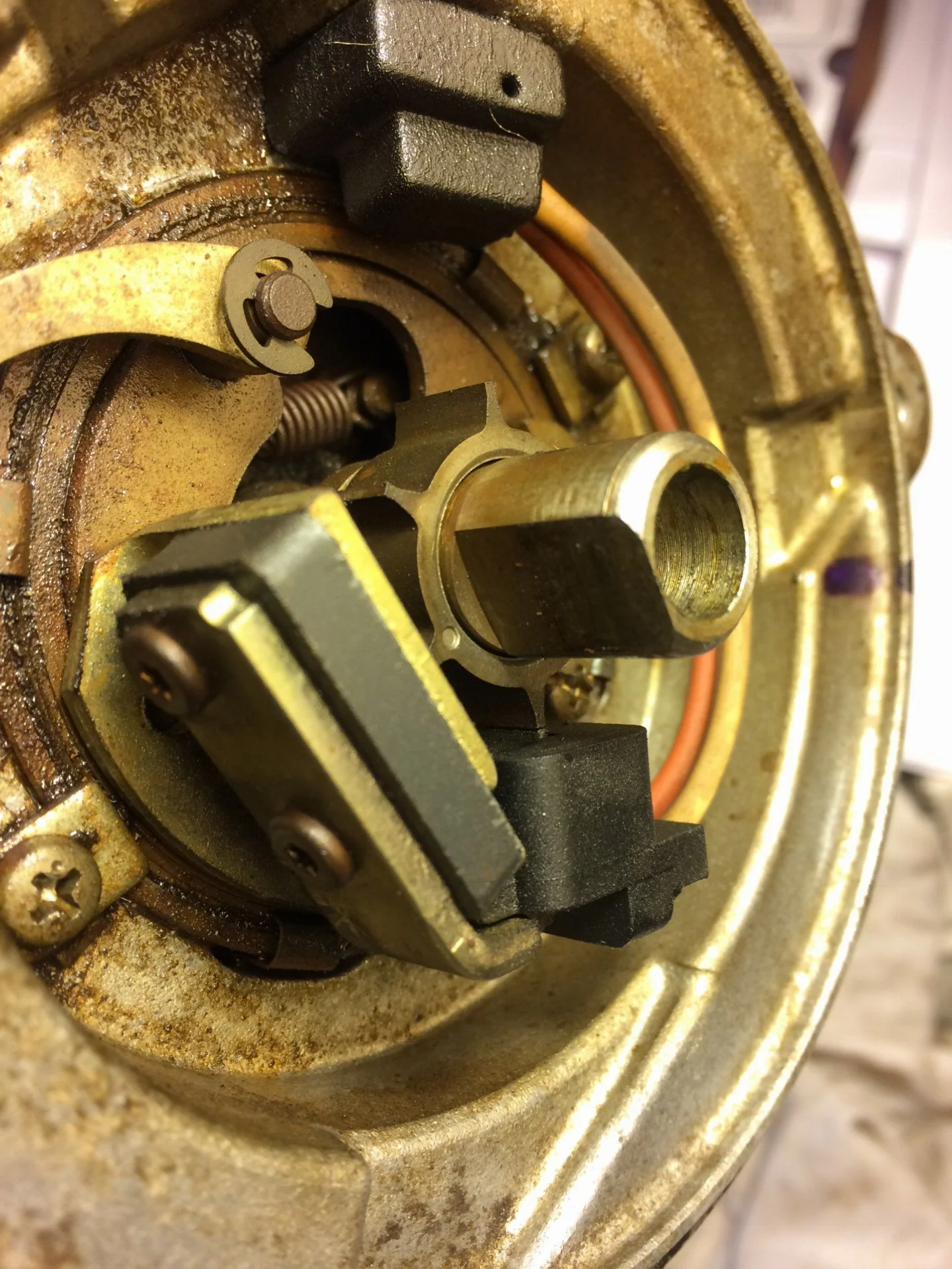

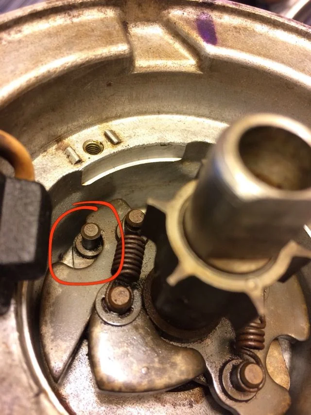

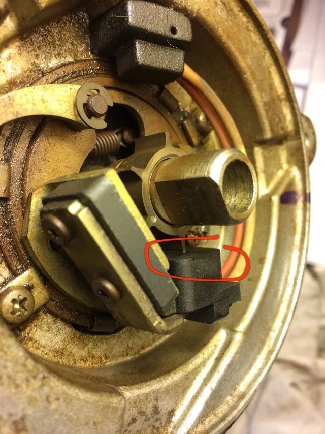

And as I wait for the manifold to get welded I pulled my diz to recurve. Found that the gap was way too tight... guessing that happens over time. Gap (between the cam and the rubbing block, couldn't get a great pix but is the third photo) should be set at 0.3mm and I could barely fit in tightly a .005mm feeler. Will adjust along with a new bushing on the advance stop pin (mine was totally gone, circled in red) and new springs.
