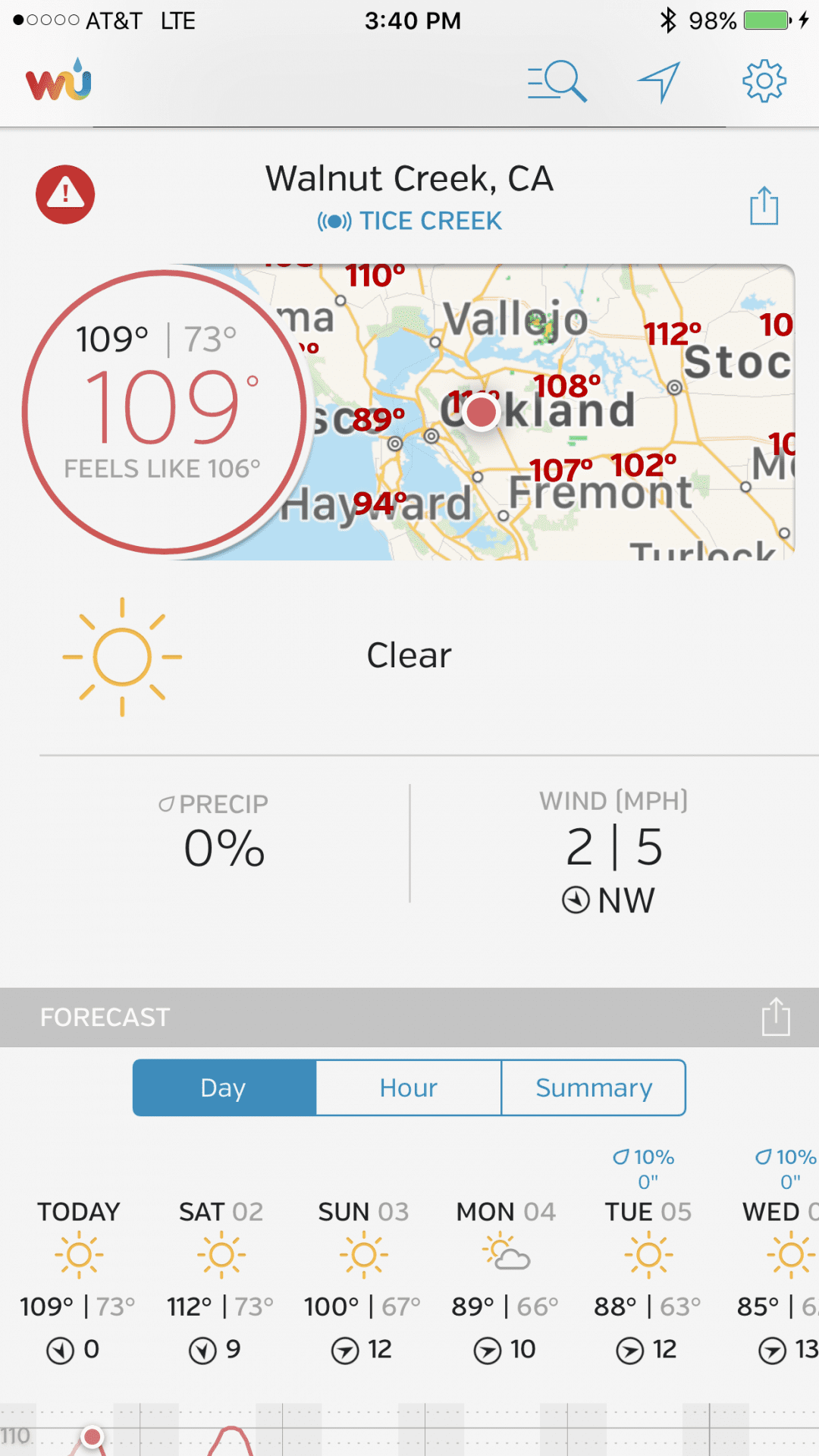

Got the car back from the autobody shop today so I didn't have to drive the cruiser in 109 degree heat. Thank goodness! Put on 108 miles this week. :)
