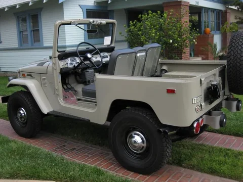

I need the windshield to back about a half an inch to close the gap between the upper section of the door and the frame. Both sides same amount. Both doors line up perfectly everywhere else. What I don't remember when installing the windshield frame over 5 years ago, is whether there is some adjustment where the frame hinges mount. Like floating nuts... And if so, on which side of the hinge if not both.

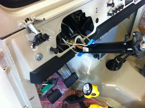

The dash knobs are tightened down to the spacers, and it's not easy. I don't think shortening the spacers will get me there. I remember thinking the windshield frame gasket was really thick at the time of assembly, but figured it was stock. Before restoration I also remember having trouble getting the windshield frame back far enough to get under the lip of the hardtop. I would have a friend push back on it hard to get it under the lip.
In this picture, the space I'm talking about is where the piece of grey foam is...
The PO shortened one of those spacers to get the hardtop to fit - and you can make a new one from a shock absorber sleeve, too. So, don't be too afraid to modify it as needed. You can leave out the spacer (temporarily) to figure out what gaskets may be binding or getting weird on you.

There's not much adjustability in the windshield hinges. Are you sure you have the correct gasket in there and oriented correctly?
I'm not completely sure it's an original gasket. Can someone give me a thickness measurement on a stock one? I remember thinking it was really thick. But the cut-outs for the defrost looked really good. Meaning I doubt someone else cut those oval holes so nicely.
I do think shortening the sleeves will work - I had the opposite problem recently, and two fender washers' thickness (~4mm) on top of the gasket was enough to move the windshield forward by at least a 1cm at the top - not having measured, I think it was even more
that means if you can cinch the gasket down by another 1-2 mm that should get you there

mine is the OEM original and is probably as flat as they get after 40 years in the Southwest (which is why I needed the washers) - it doesn't really get distorted, as it has no place to go; at least I can't see where to
you only need a mm or two
I wouldn't file on the body or the windshield itself, though
