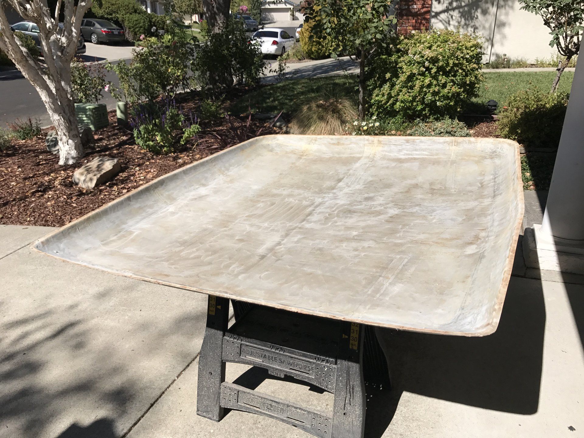

Got it blasted! Little more rust than anticipated so treated it.
Started the top work and thanks to the PO for putting the weird epoxy over the rivets. Spent a lot of time chipping it away. Still have more work to do. Couple small spots that need repair too. The underside is just about ready for the the Lizard Skins.

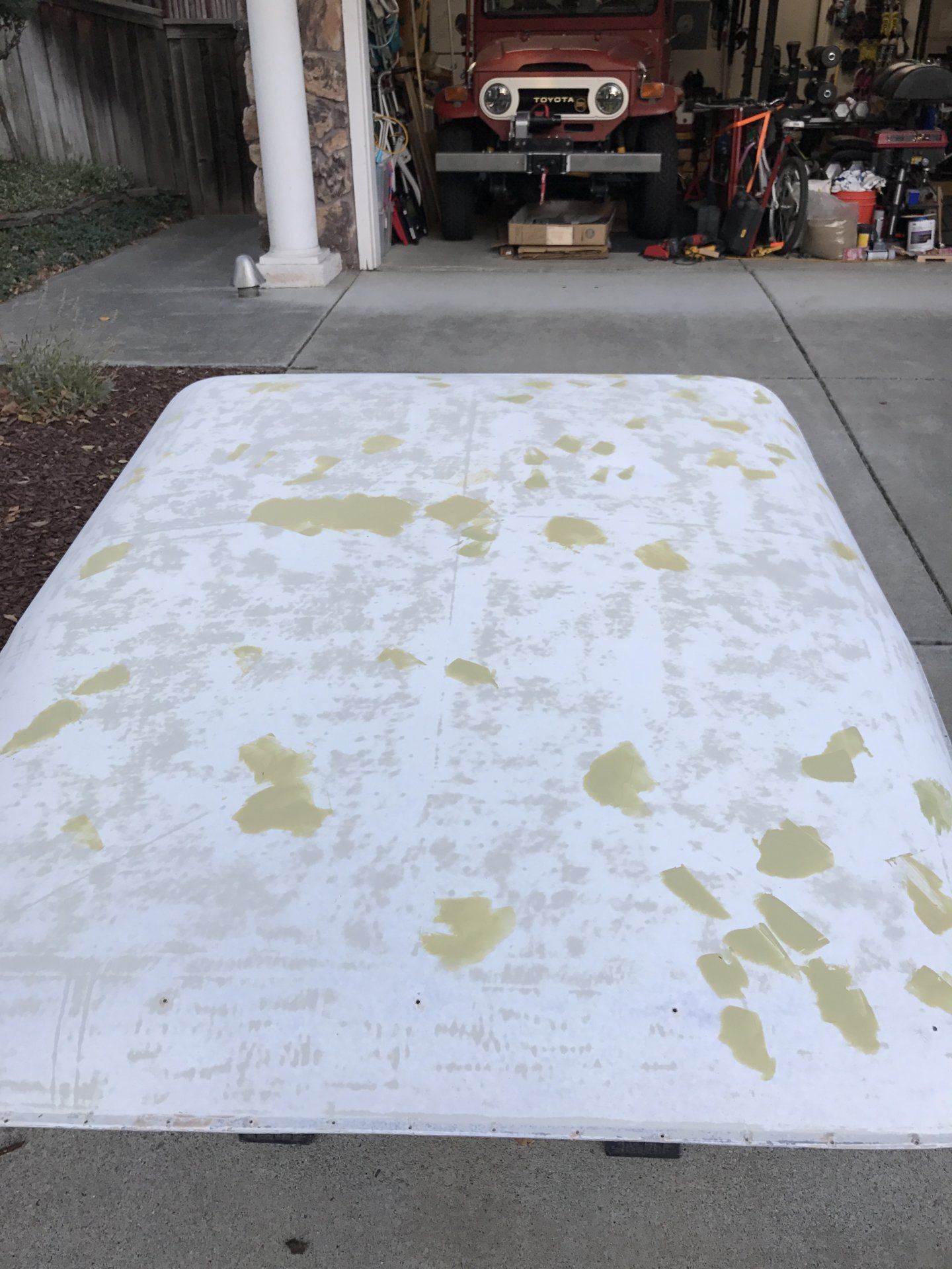

Fiberglass repairs (just some divots did not go all the way through):
Went a little overboard on the skim coat. These were just little scrapes in the surface. I have a few spider cracks which I will try to repair with my fiberglass epoxy I have. Just need to dremel the cracks out some. Then epoxy primer and spray with Cygnus white... I bought the paint a long time ago I hope it's still good...
