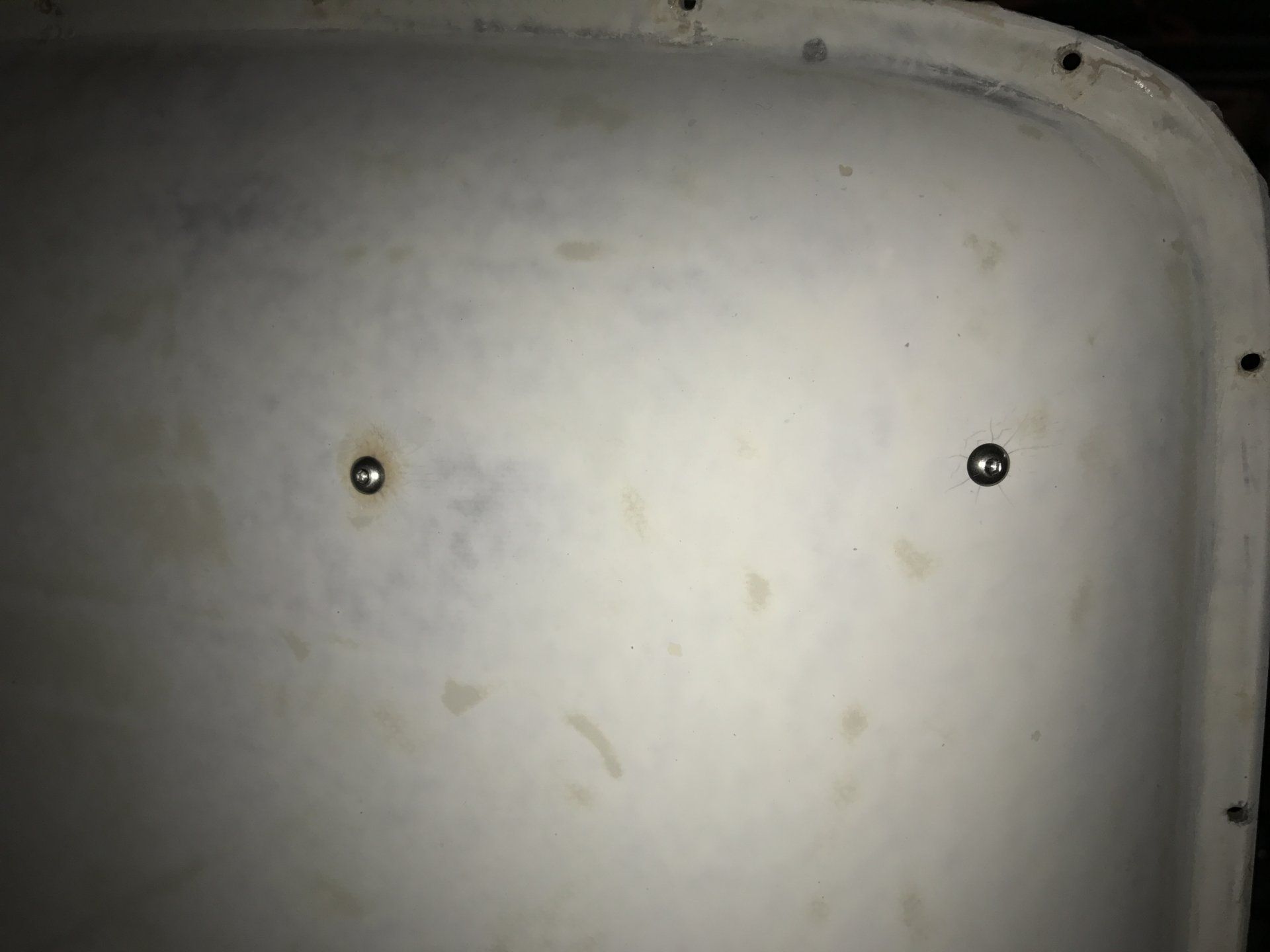

Here are the SS button head screws by themselves I may just go this route. If I put caulk inside the hole and under the screw head I should be good. That is more the profile I was thinking. Similar to the rivets.
^^^ looks like a viable, low profile option (Chicago screws). Lots of available lengths too. By the way, what IS the thickness of the fiberglas?
I didn't measure but it looks like about 1/8". So the small Chicago screw for 1/8"-3/16" thick would work. I will get the aluminum ones too!
The spider cracking seen in the photo is of the gel coat only - fiberglass is still good. That is the problem with gel coats it can be brittle and fracture like that. I'm going to be putting a 10 mil thick marine epoxy primer over the entire top so that will help some and should address the spider cracks.

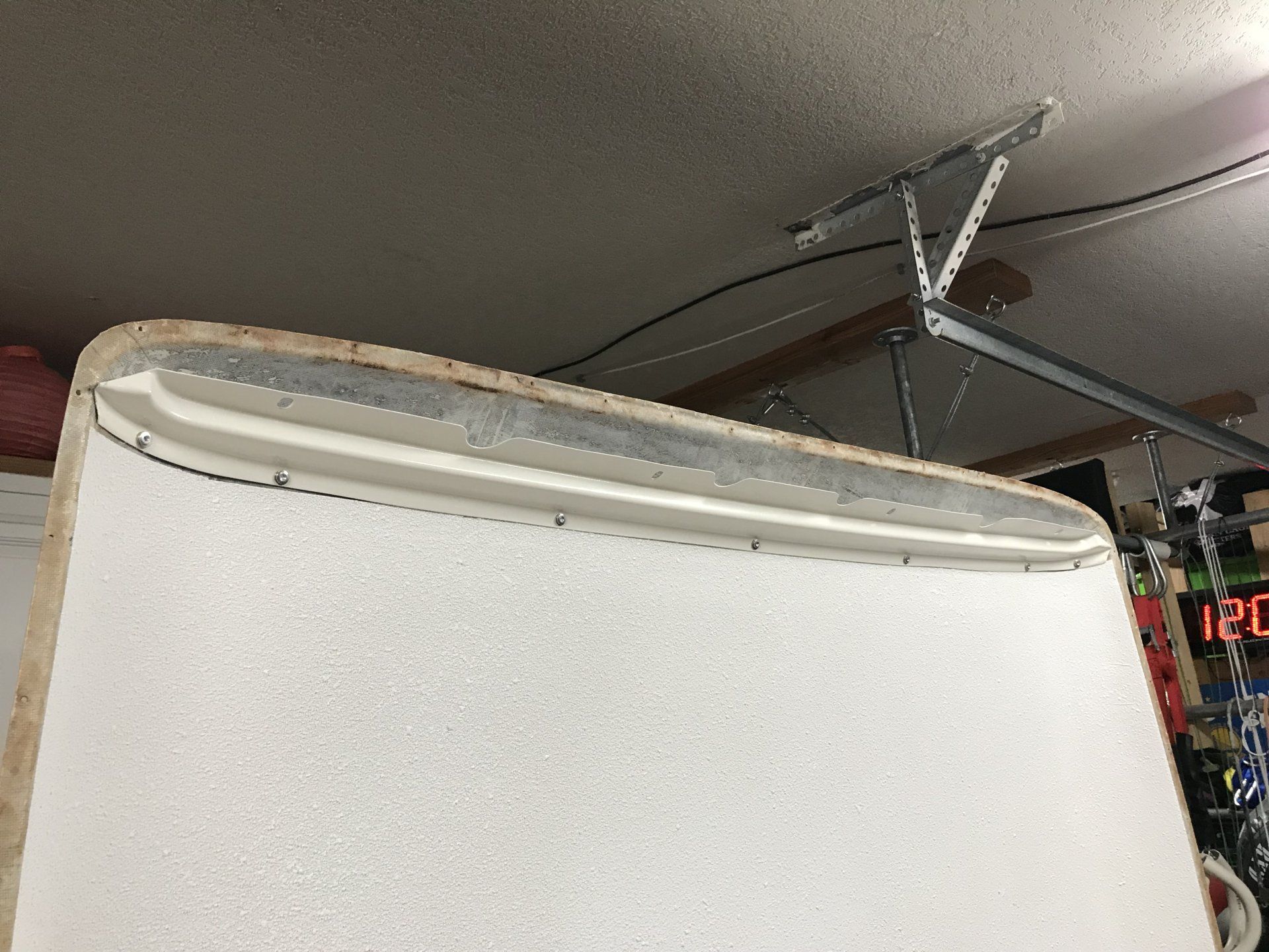

Did a dry fit of the top cap and of course the two outer most holes don’t line up. Nothing can be easy.

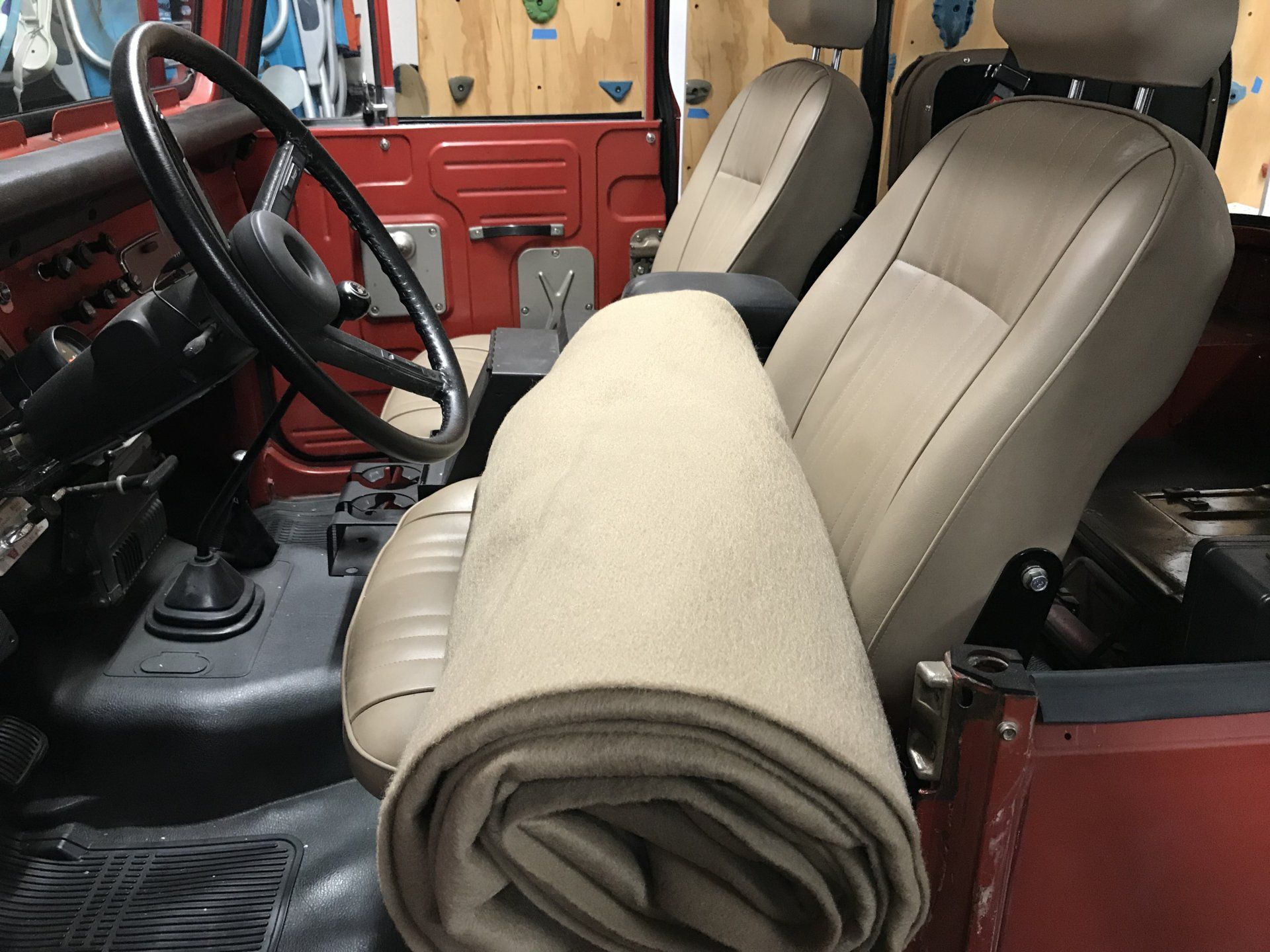

And purists look away before you scroll down. I’m going with this interior backless carpet for my roof liner. My cruiser isn’t perfectly OEM and I can always remove if I decide to. But it was cheap and matched my seats well.

Actually I’m using a different top (the one from my 75). It was in much better shape than the original. For the 75 I’m either going soft top or integrated all fiberglass roof/rain gutter. It won’t be difficult to patch the holes and drill new ones just another annoyance.
Okay top is just about ready for getting that marine coating on it. I plugged the two outer holes for the windshield cap since they didn’t line up. It will be easy to drill two new holes. Unfortunately I should’ve done this earlier in the week since it takes a while for full cure.

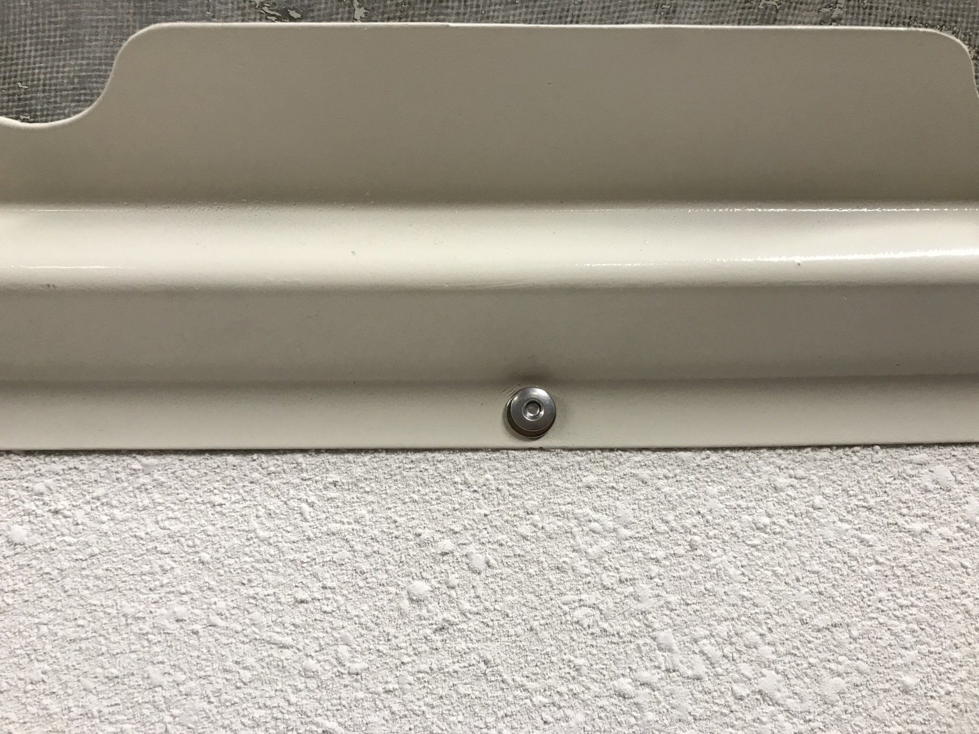

Those little aluminum screws are perfect! Super low profile and will paint nicely. I’ll make sure to caulk under them (and between the windshield cap and roof) - this is just a test fit. My epoxy hole plugs worked perfectly and I drilled out the new holes which were just slightly off.

So, the head of the binding barrel has a hex-shaped hole? the McMaster-Carr diagram doesn't show what it looks like, and there's nothing in the description about it.
No it doesn’t - that is the only issue getting them tight. They seem to hold in place and not spin when tightening. I will also loctite them so they don’t come loose. These things are so flat there isn’t enough room for that. The threads in the barrel run the full length.
The heads are so flat (1/16”) that you have to be very careful tightening them. They have wide slots and the aluminum is soft.

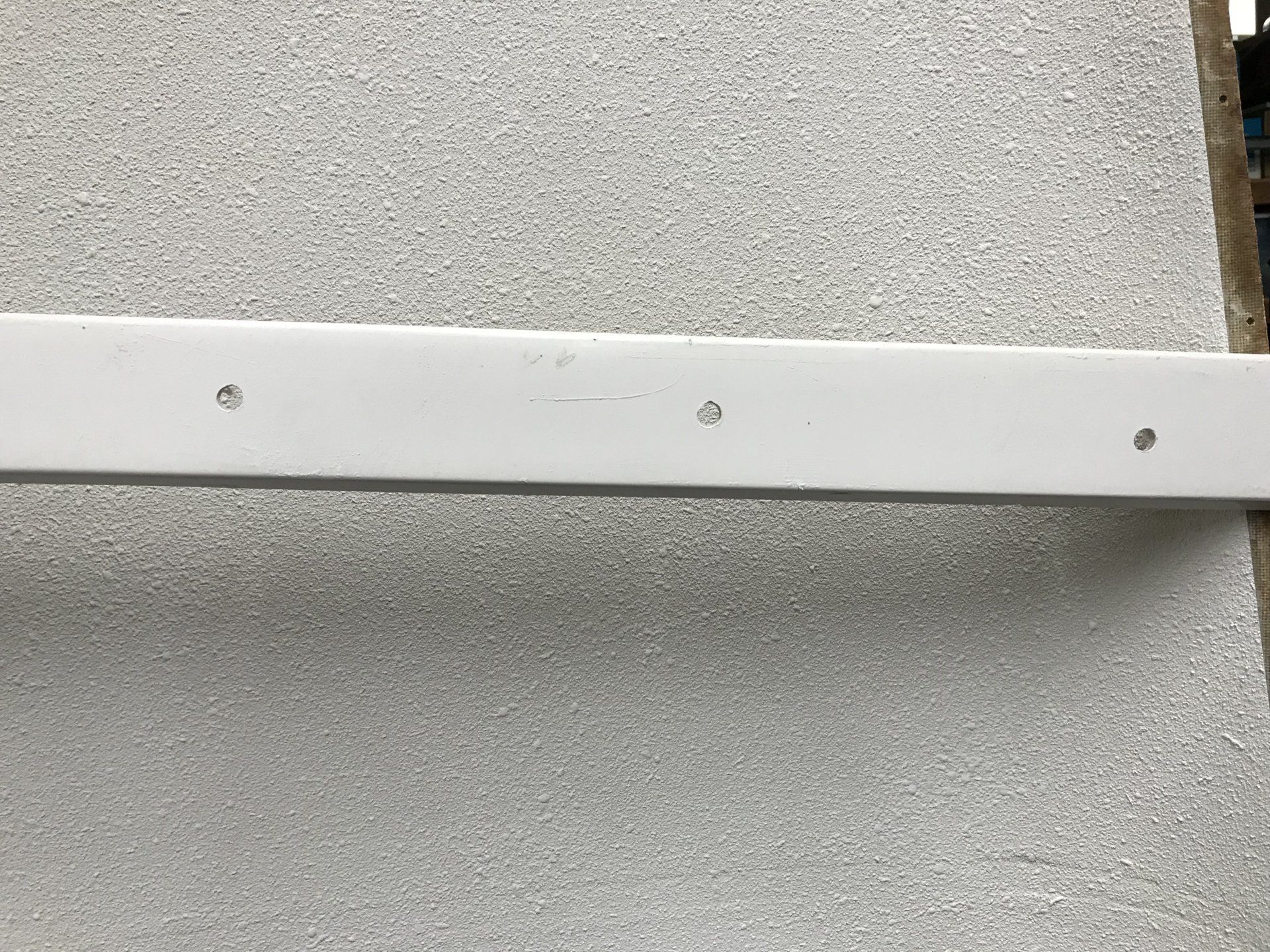

Busy day today! Installed the windows on the rear upper quarter (with the weld repairs of the rusted section). Installed all new @Racer65 weatherstrip on the top/tub junction. Installed the header for the hatch and used nice Racer65 repro gaskets between the header and the quarters. Drilled out the fiberglass rain gutter and test fit with another sweet Racer65 top gasket. Got the doors to align much better, driver side is practically perfect. The passenger side is better but something is definitely tweaked. I did move the doors once I broke the PO’s silicone job which locked the hinges in place.
Drilled out rain gutter
