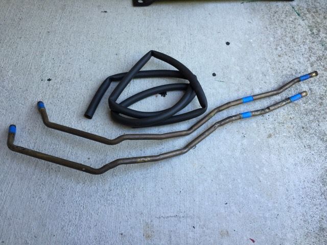

Racer that is what came out of the heater and hard lines after my full flush and air blow through. I rinsed out the hard lines and the rear heater and bunch of gunk flushed out. Perhaps that explains why the water didn't flush all the way through? Also might explain why the rear heater never worked great.
New insulation on hard lines for rear heater! McMaster-Carr

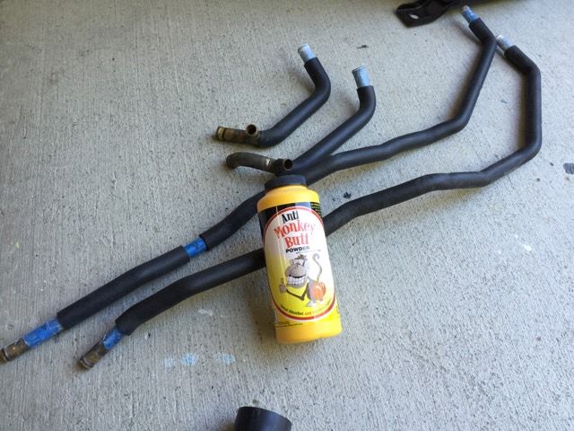

And my secret to getting the insulation on the pipe... Well that's all I could find not sure where the baby powder went. :)
Hi,
They sell the insulation tubes in 6' lines, would one be enough for the job or you purchased two?
Cheers.. I've been hunting for this 1/8 wall thickness tubes ever since .. thank you for sharing info!
Hi,
Nope you'll need two to do the hard lines to the back heater. Glad I could help! I'm certain I got that one from someone else here.
