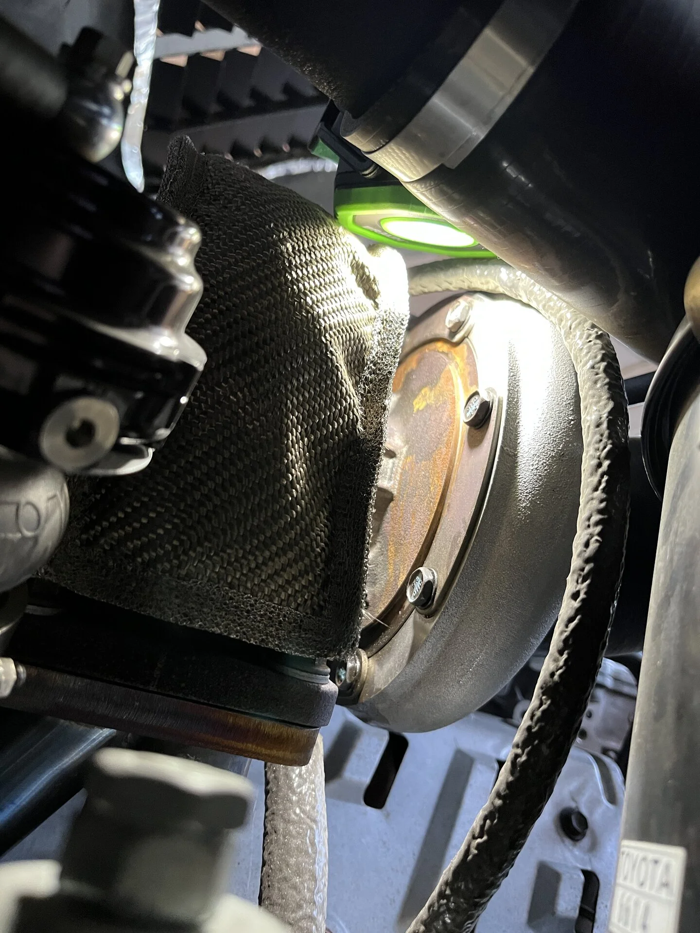

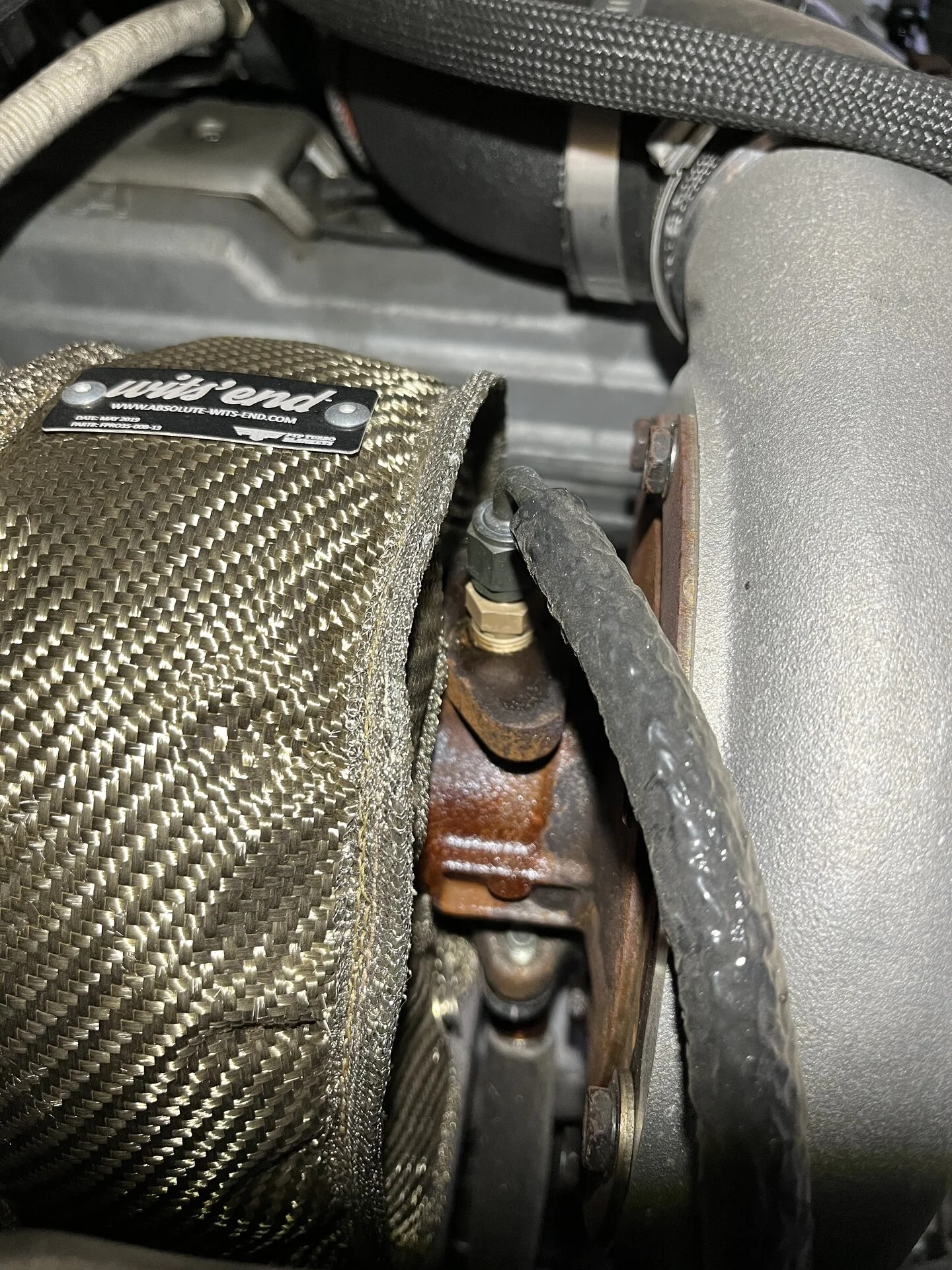

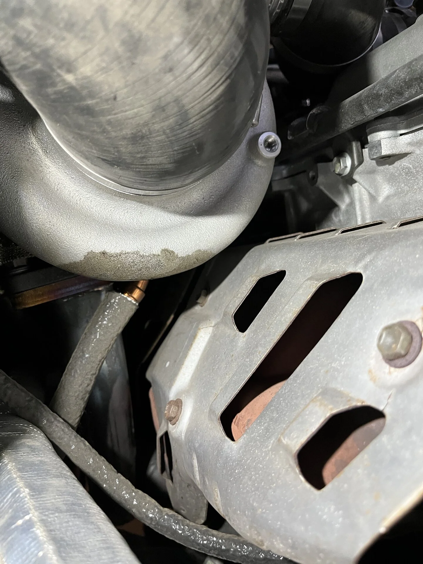

I opened the the hood today (pre-trip) discovered oil residue on the exterior bottom of the compressor housing.
I’ve had no issues for 2+ years (<10k miles) so I don’t imagine there’s an issue with the turbo bearings already.
Based on the photos, It’s not seeping down from the intake (catch can works well). It appears to be coming from the feed line and migrating down that way.
Not sure if anyone else has noticed this, but figured I’d throw it out there.
I’m going to reseal the oil feed line and see if that solves it.
Check your air filter, If you have a restrictive air filter it will cause a vacuum on the cool side pulling oil past the clip/seal on the shaft.
Did you tighten the feed and drain fittings? Seems like the most obvious place to start....
Agreed — the feed line was tight to the fitting, but the fitting was not very tight. I cleaned the threads, reapplied thread sealant, and hand tightened. I’ll take a drive today and see if there’s anymore oil.
The kit came with Permatex Thread Sealant (High Temp) to seal the feed fitting threads, which is only rated to 400*.
I wonder if prolonged exposure from the hot side of turbo had a detrimental effect on it. I’ll take some temps of that area with IR.
Good tip, my googling also indicated that a restriction in the oil drain line could cause those symptoms.
That’s a lot more work to get up into so I’m starting with the obvious and easy variables to check

resealing the oil feed line seems to have worked for me.
With that said, in my researching, I came across Briano saying that his turbo was sweating a little oil so he tightened the bolts that hold the turbo together.

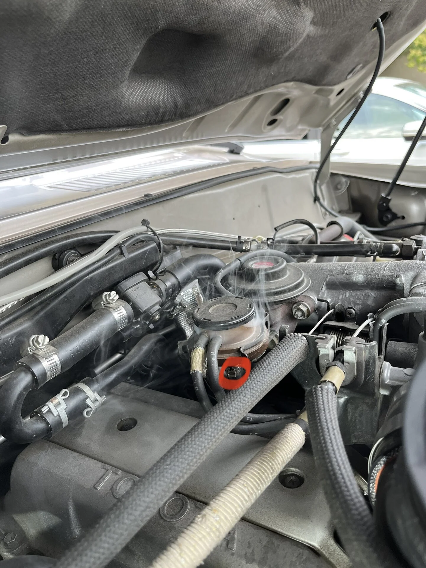

Bumping this thread to discuss another issue I just discovered.
I hear a hissing noise from under the hood, but no CEL. It varied with RPM, and started recently after a misfire on startup and subsequent shudder at idle to 1K RPM.
I figured it was a vacuum leak so I performed a smoke test today and discovered that:
1. The EGR Modulator is the cause of the leak (Pic #1)
2. I was getting a bit of smoke through the crankcase, so I'm glad to have those catch cans. Valve seals or Piston rings, either way it's a top-end :(
(Short Video)
EGR Modulator is not surprising to me. It seems original and we've changed the dynamics where the bottom hose instead of seeing vacuum from the intake manifold, now sees boost pressure, too.
I'm going to replace modulator but I'm wondering if any of the other 10-15 turbo'd 80s have seen this?

I did the same test a few weeks ago because I am only hitting about 4psi of boost and I also had smoke come out of the EGR modulator. I replaced it with a new oe part, but it still leaks.
Interesting. Sorry to hear that your replacement didn’t solve your problem, keep us updated as you troubleshoot yours.
My old EGR modulator failed the “blow into the bottom hole” test. The engine seems much smoother running and turbo builds boost pressure at lower RPM now.
Let’s see how long it lasts!
