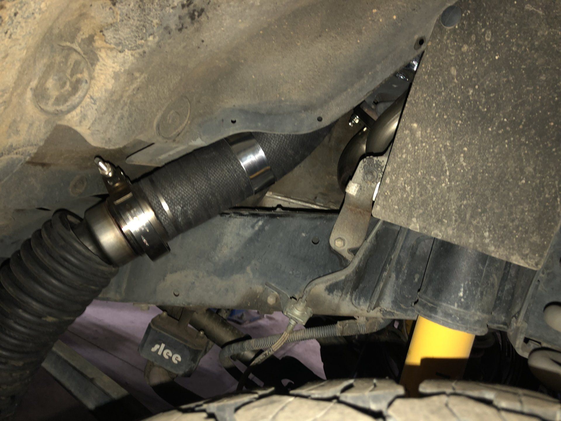

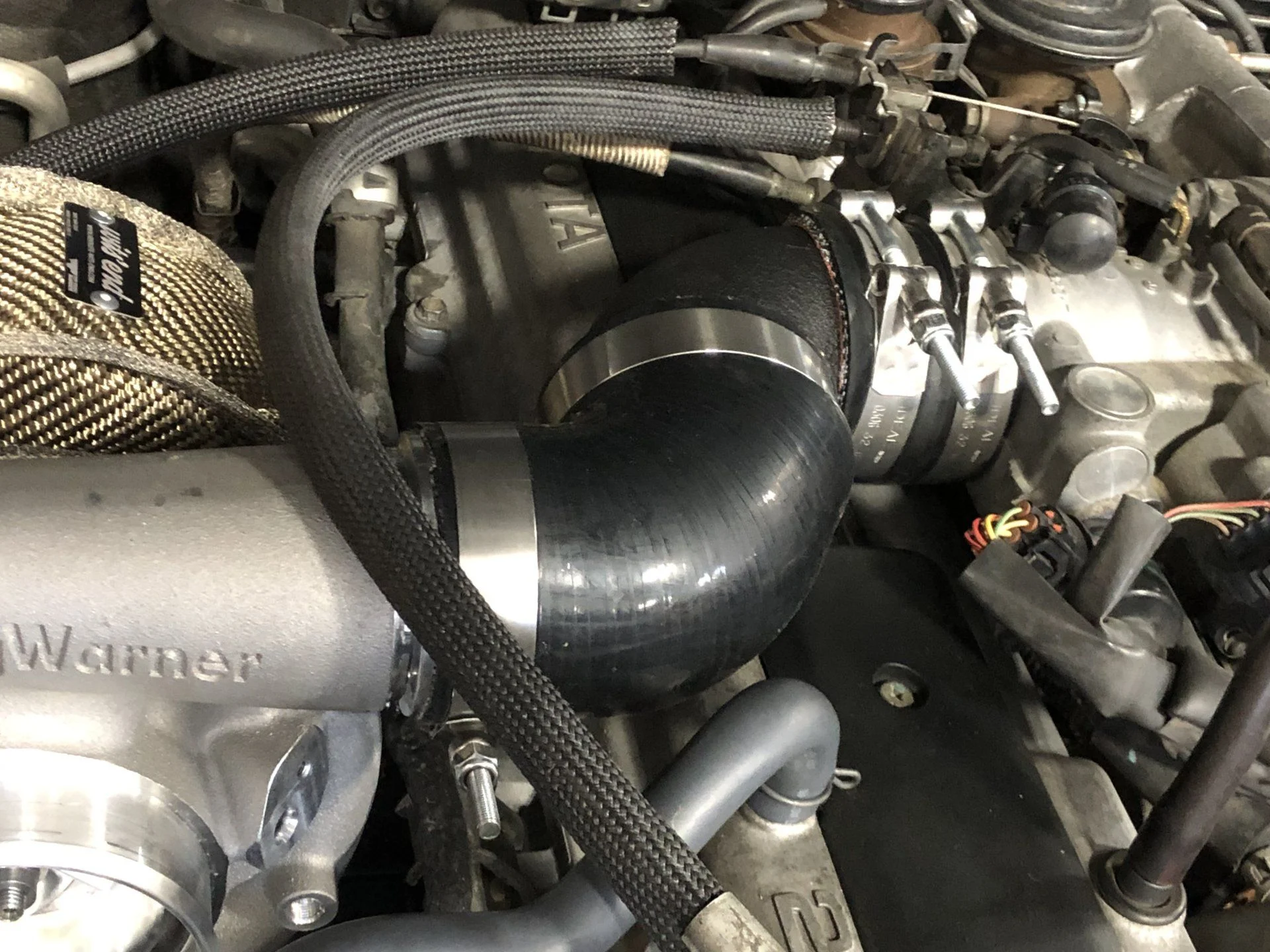

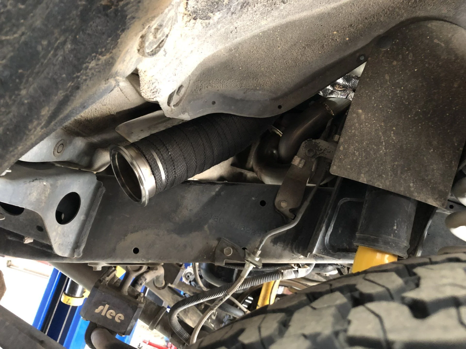

Also decided I did not like the worm clamps, swapped out for t-clamps
Curious why the oil drain flange didn't show up with your order? Or is this a special dealio that I missed in the thread?

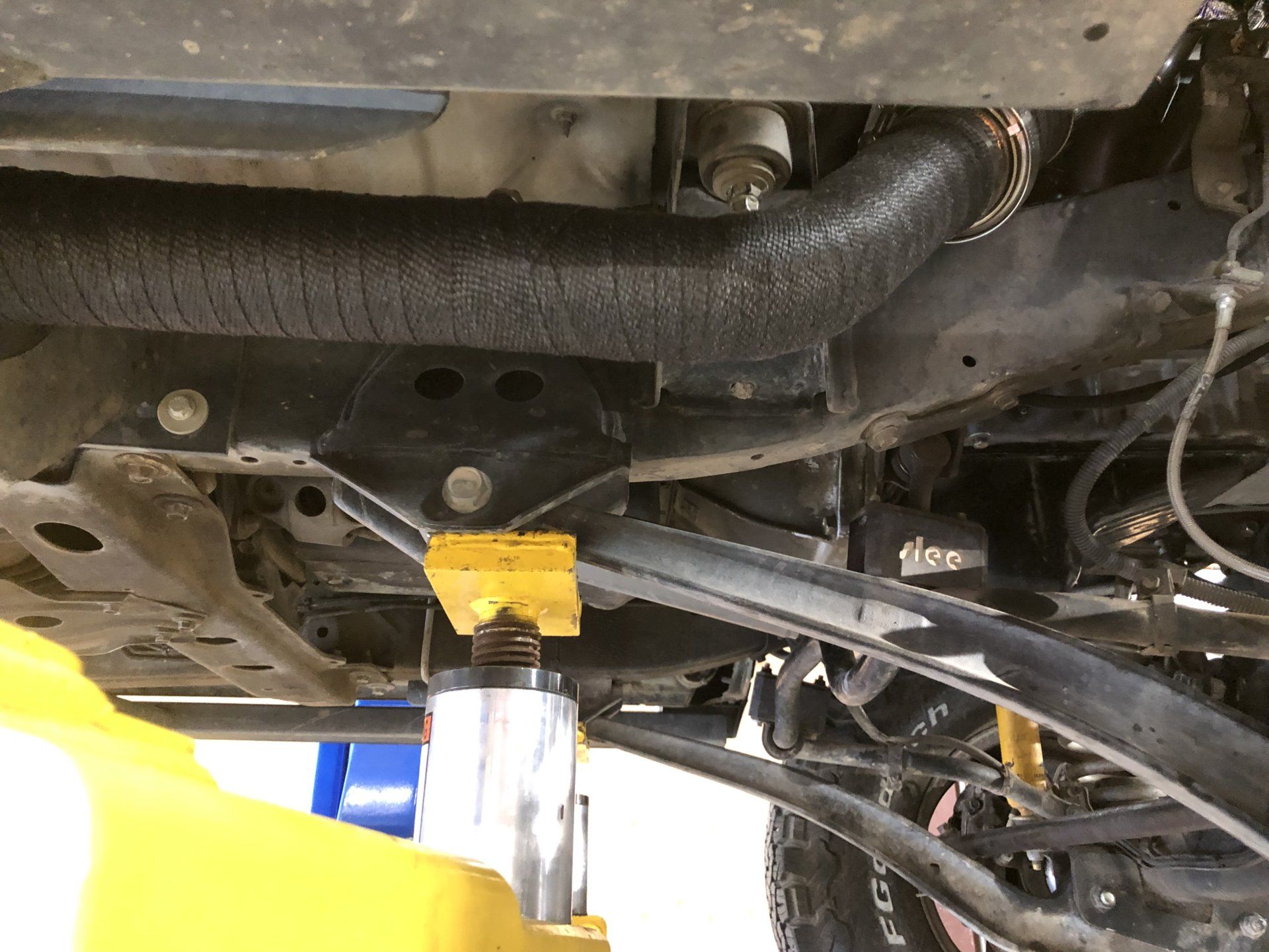

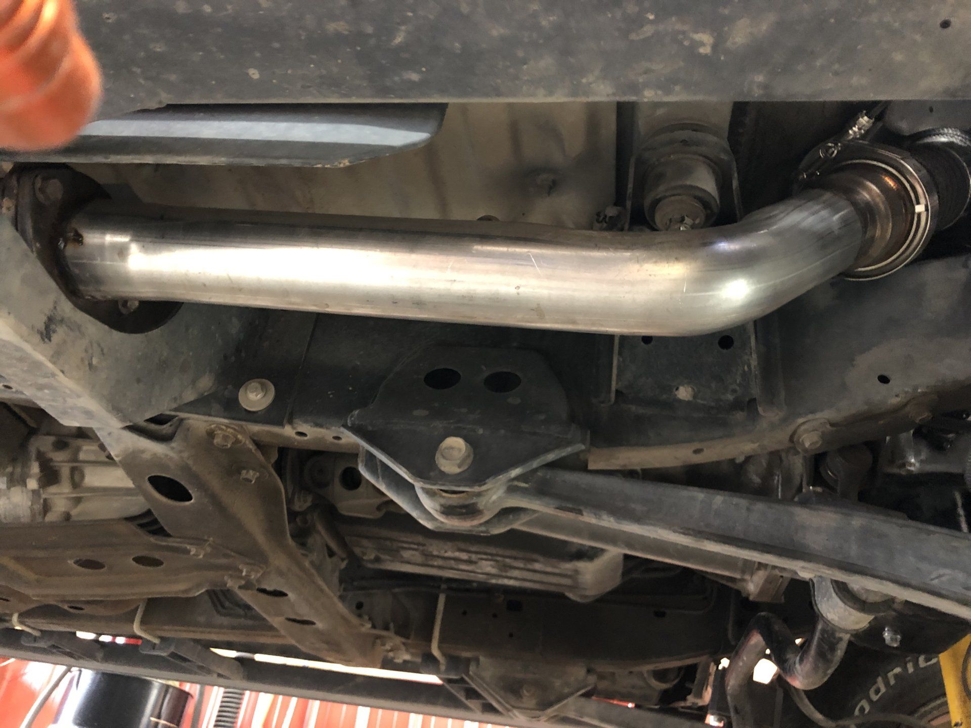

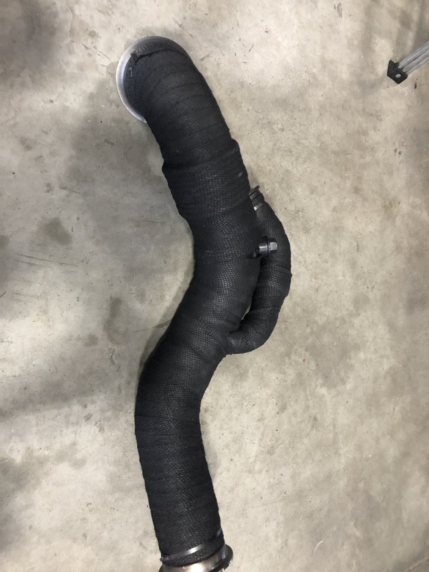

Down pipe clamps showed up, got it heat wrapped and installed, working on welding up the exhaust now! Then hopefully the oil drain flange will be here tomorrow!
Hopping you still have the clamp/bracket on there that connects to the bellhousing. That setup prevents cracking by supporting it in place.

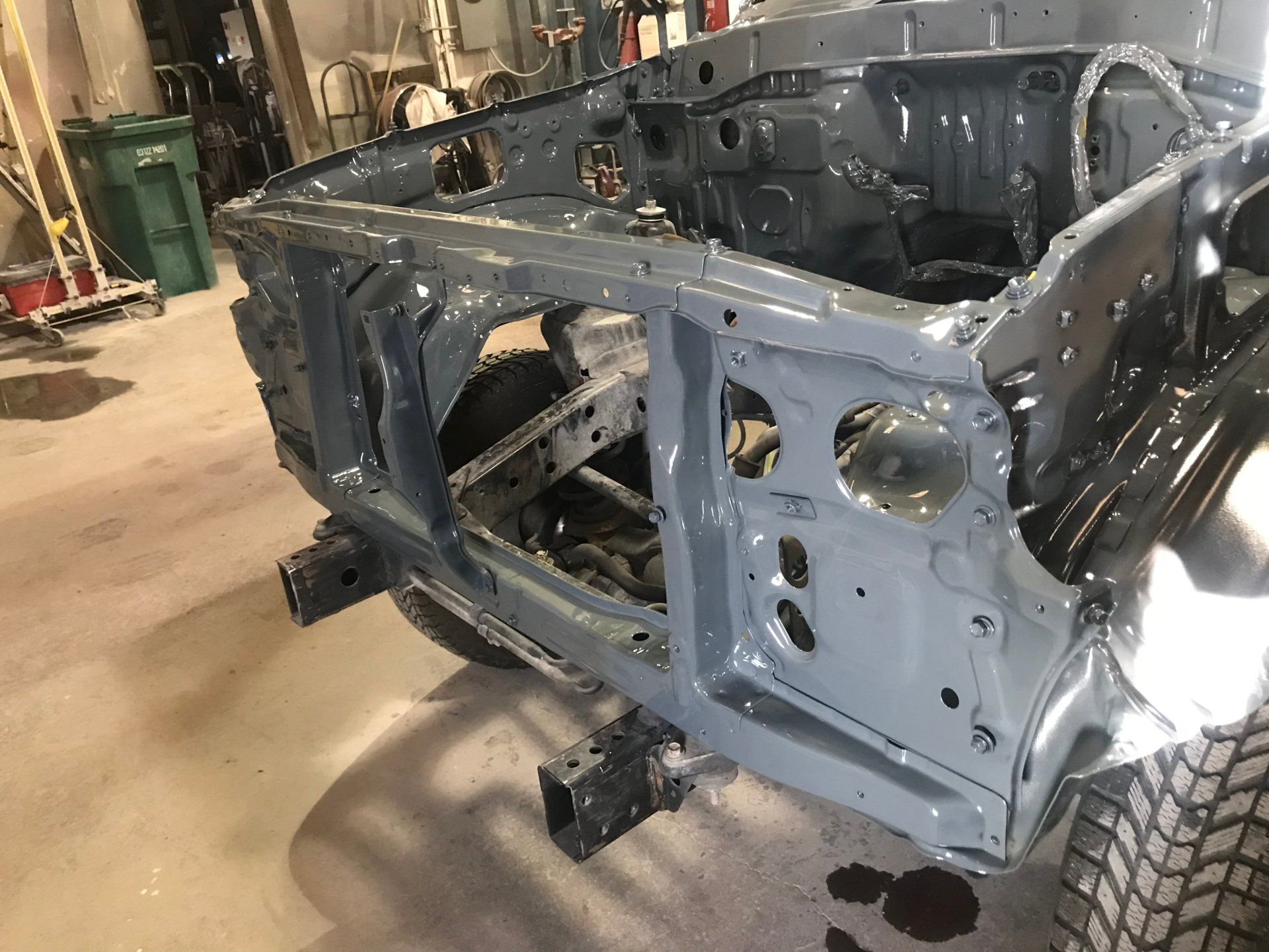

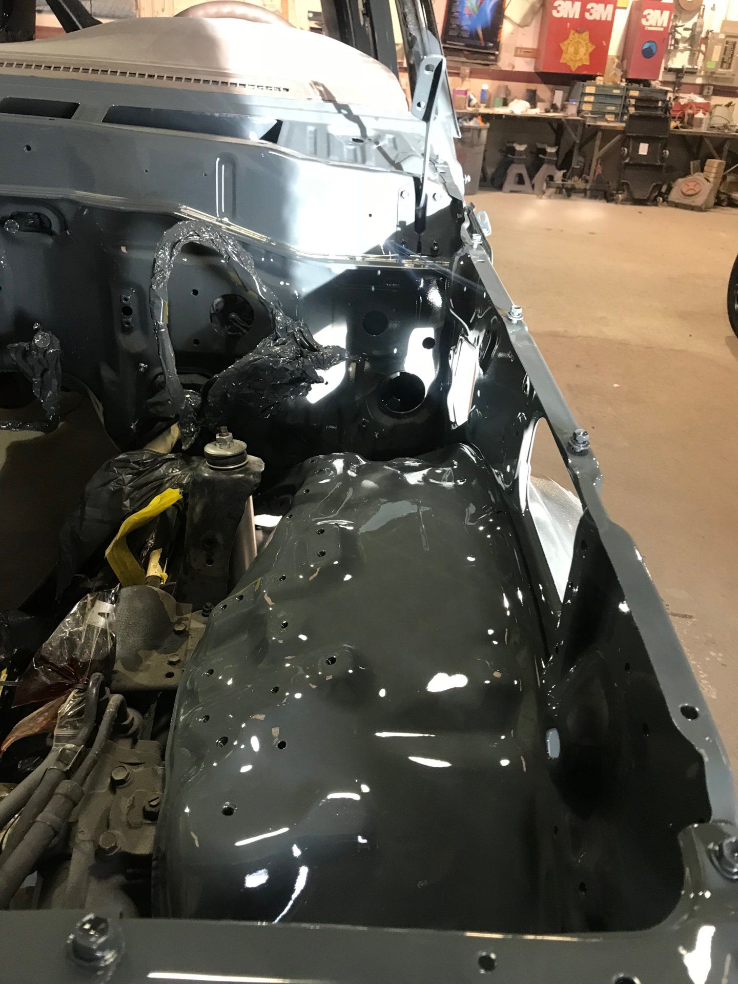

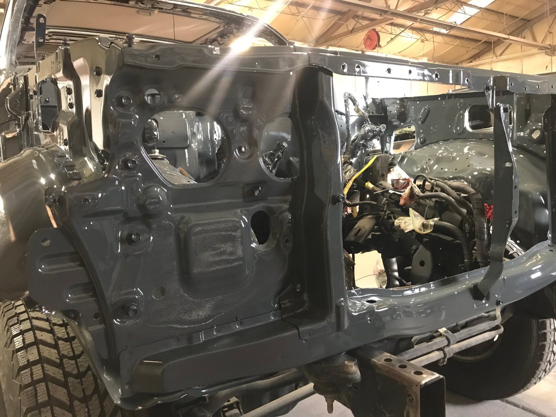

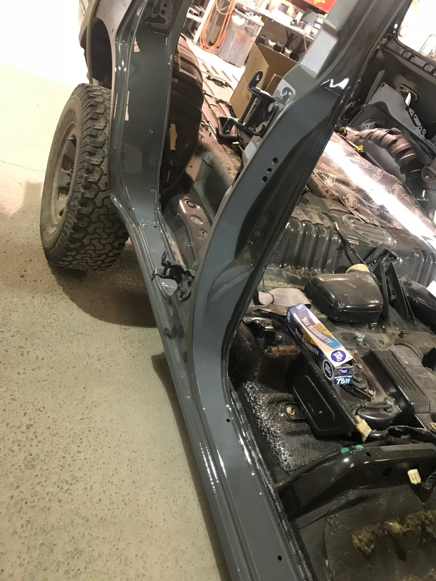

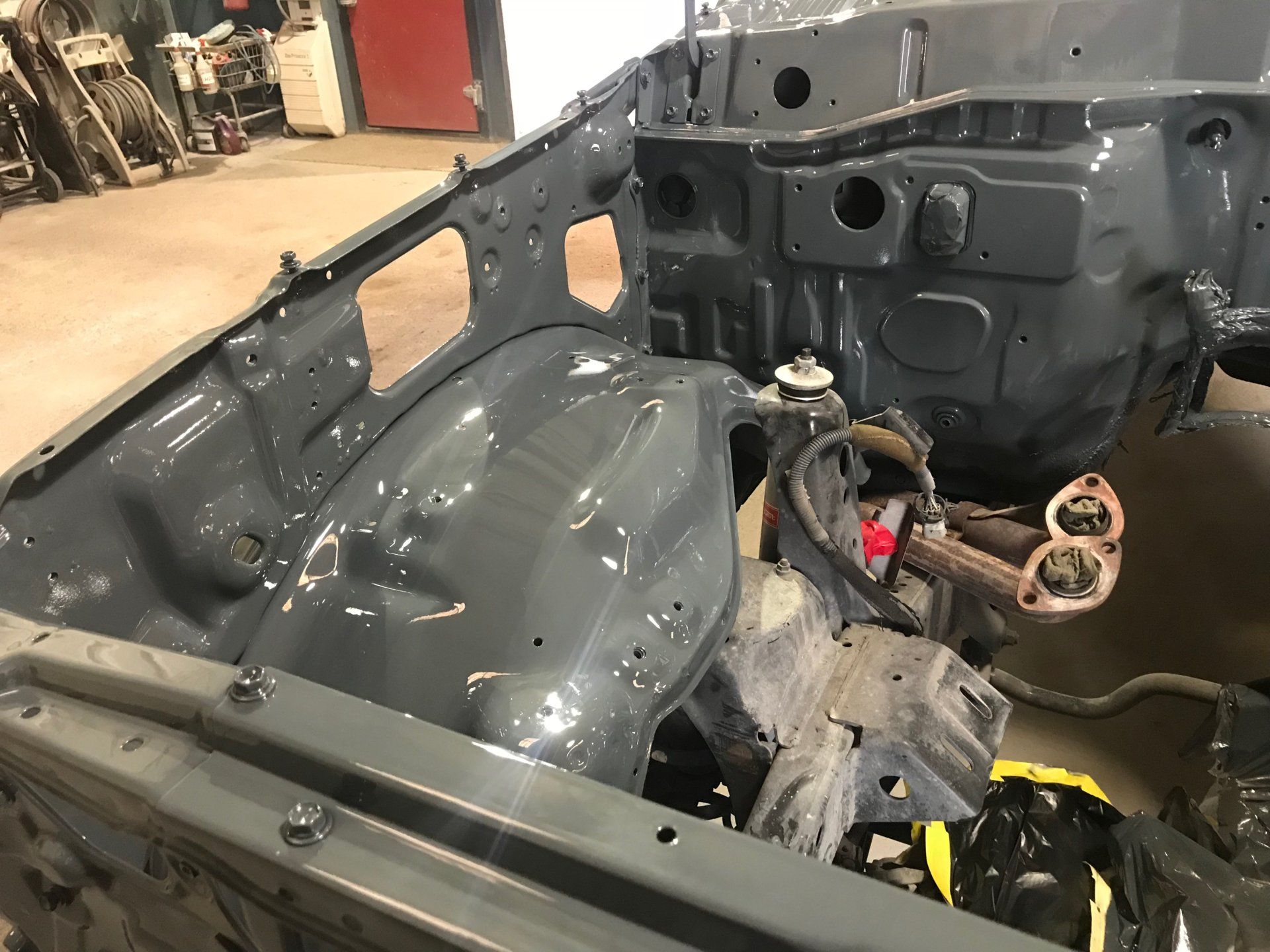

Alright, I know its been awhile, but as soon as I get back in town next week I will be reinstalling the drivetrain! Door jams are painted, engine bay is painted, hopefully things start moving a bit quicker from here on! couldn't be happier with the jam work, the goal is to make this look like an original color, the body shop is doing an incredible job of that, def well on the way!

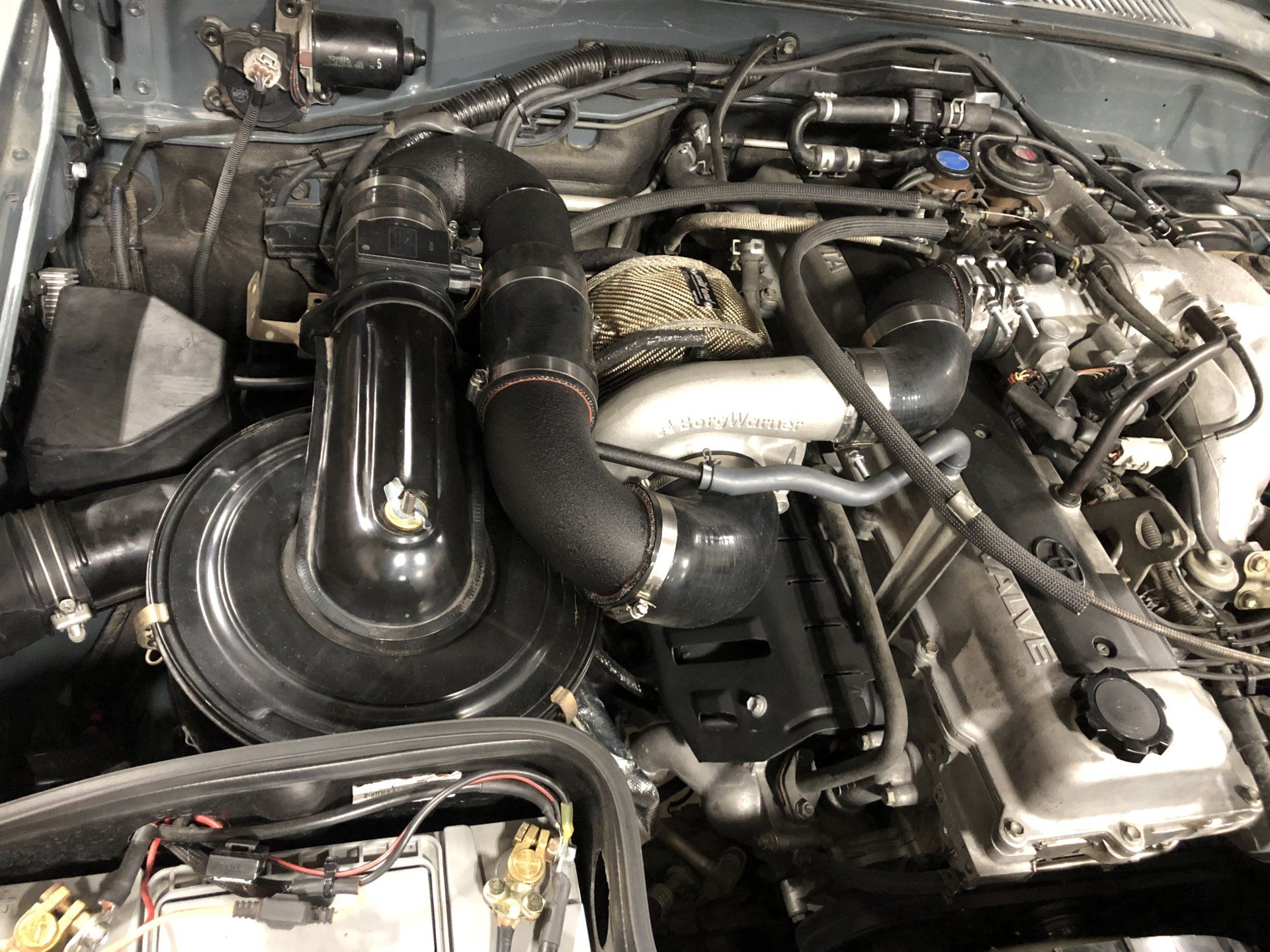

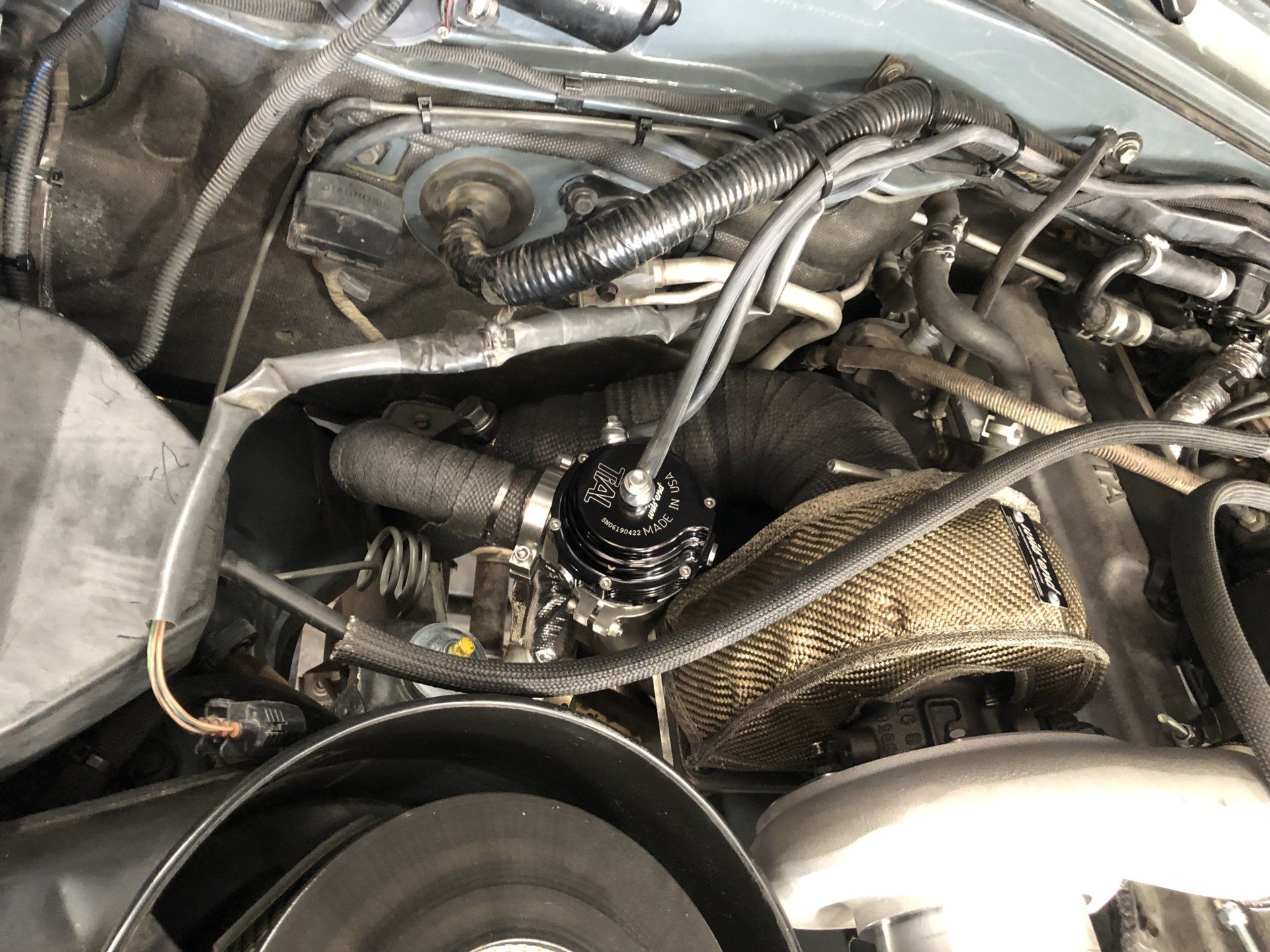

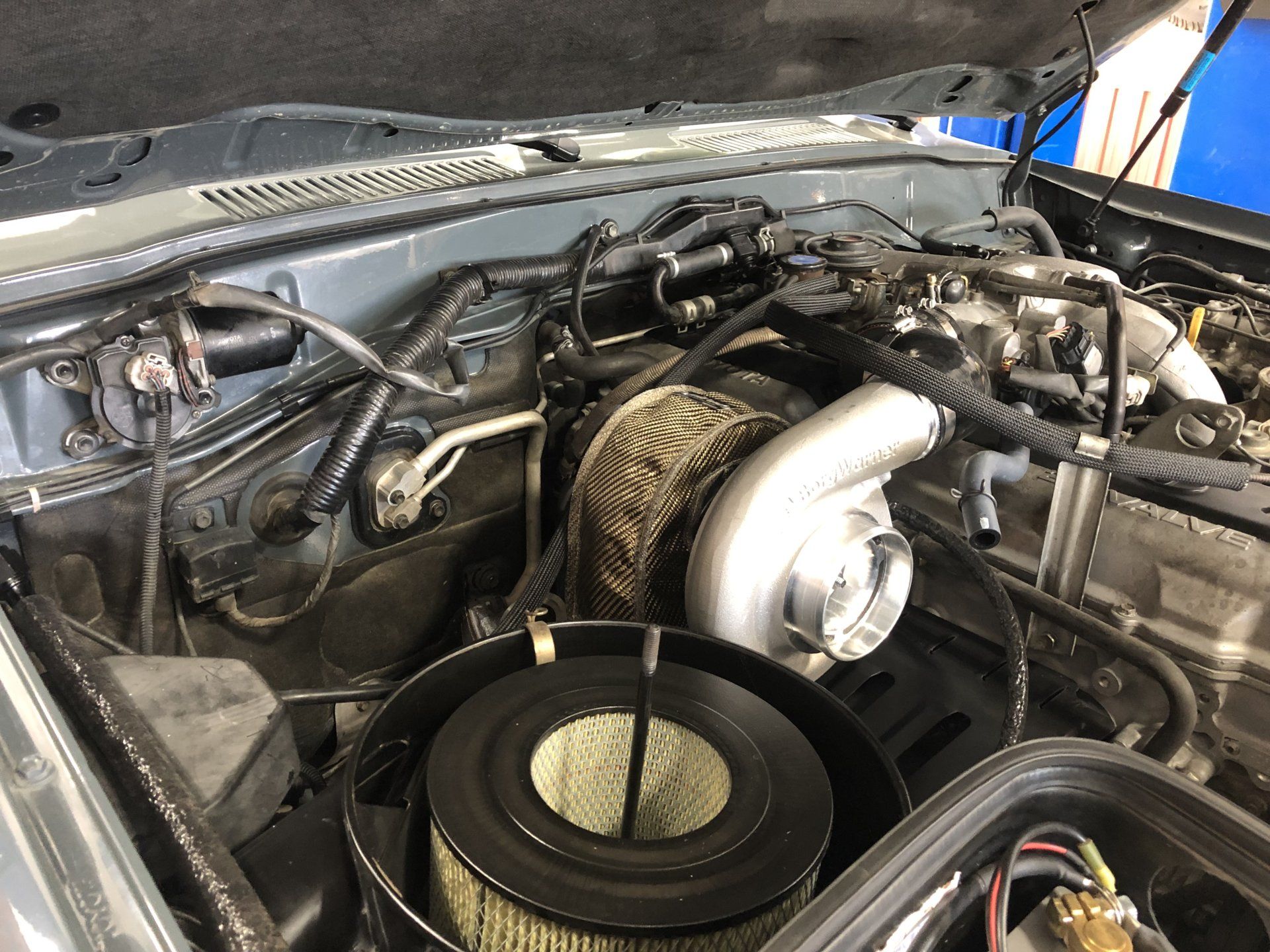

Got the exhaust done today!!!! Decided to wrap the connection piece. Put about 25 miles on it and I am extremely happy, this turbo is such a game changer for an 80 series, I feel like I’m driving a non lifted modern V8! For anyone that is curious I have owned a supercharged 80 series with 4:88 gears and 37s, essential the same setup I have here minus the supercharger and turbo instead, the supercharger doesn’t even come close to comparing, I would never consider a supercharger for an 80 series again! Another note on that, my supercharged 80 lived at sea level, I currently live at 8k ft!
Nice. I am very seriously considering this for my rig. Were your coolant temps relatively unchanged?
I can honestly say this is by far the best modification I have made to this 80! With 37s living at 8k ft and trying to pull a small Offroad trailer, it was embarrassingly slow and frustrating..... This turbo changes all of that, it will be enjoyable to drive and pull the trailer, I own a lot of vehicles and my favorite is this 80, the only discouraging thing about it was the power! Temps seemed normal, did not see anything funky, and I was getting on it a bit! Truthfully I feel like it runs so much smoother than it ever has, turbo is also super quiet, can hardly even tell it’s there, if you had a passenger in the car that didn’t know 80s were slow they wouldn’t even realize it was turbocharged!! Which I think is a huge bonus, i don’t like a bunch of noise while driving hundreds of miles!
