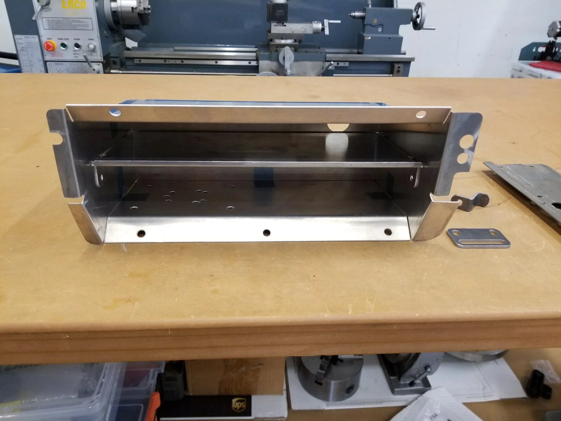

Prototypes are in hand except for the door and RHD box, that comes tomorrow. So far everything is looking really really good. Couldn't be happier. Later on it'll get the test fit and and final production notes. I am still waiting on pricing so no clue on cost yet.

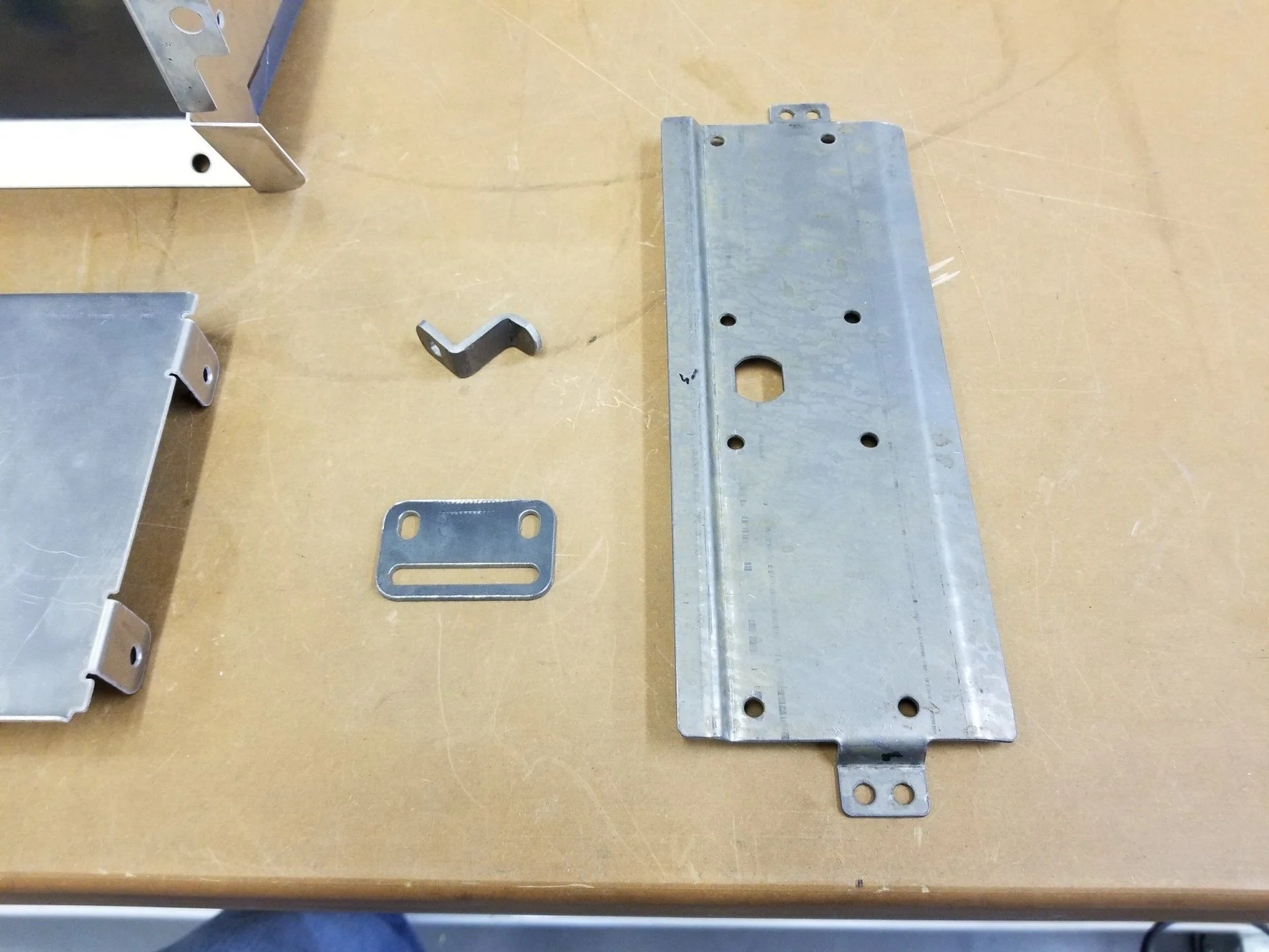

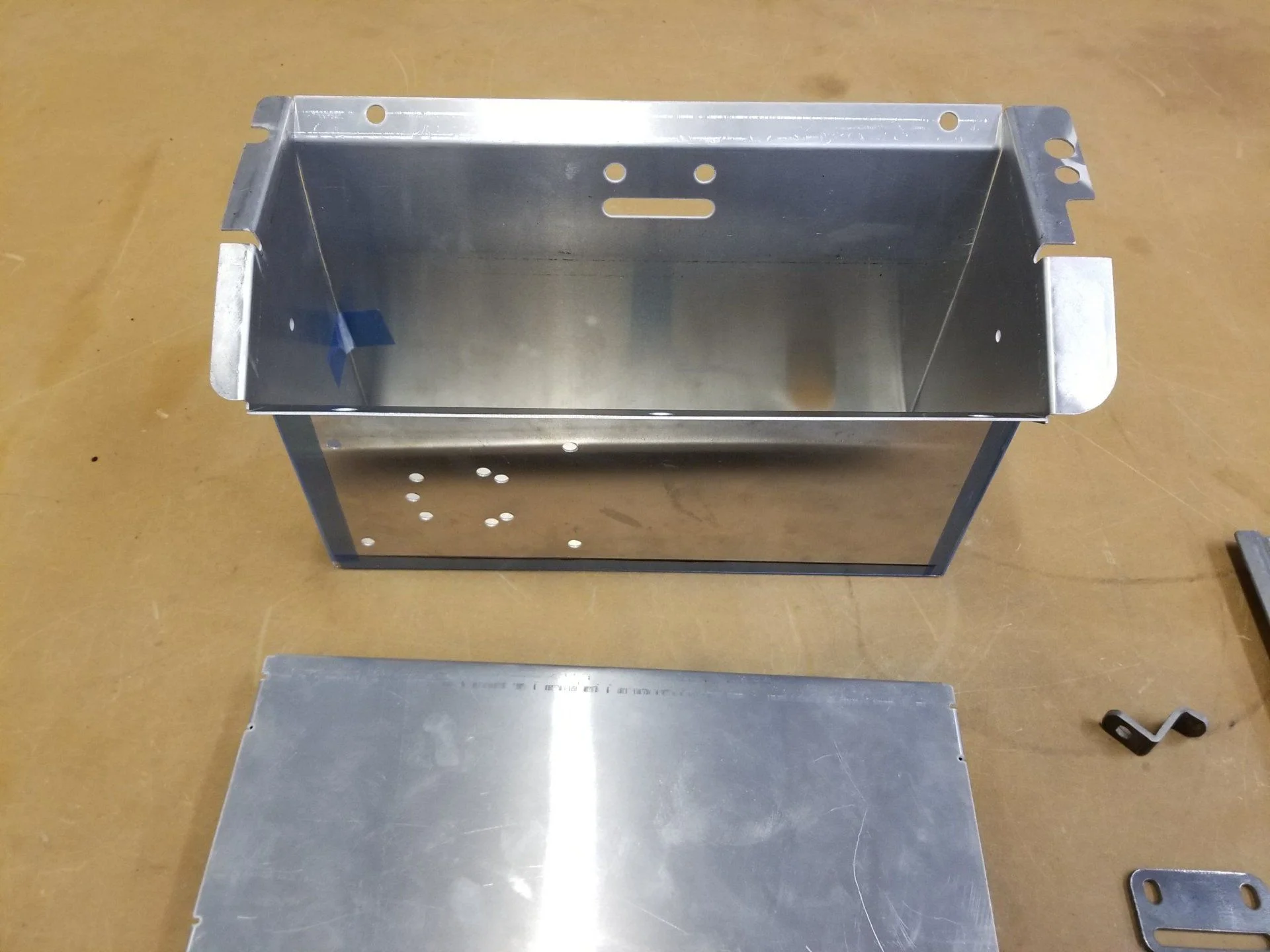

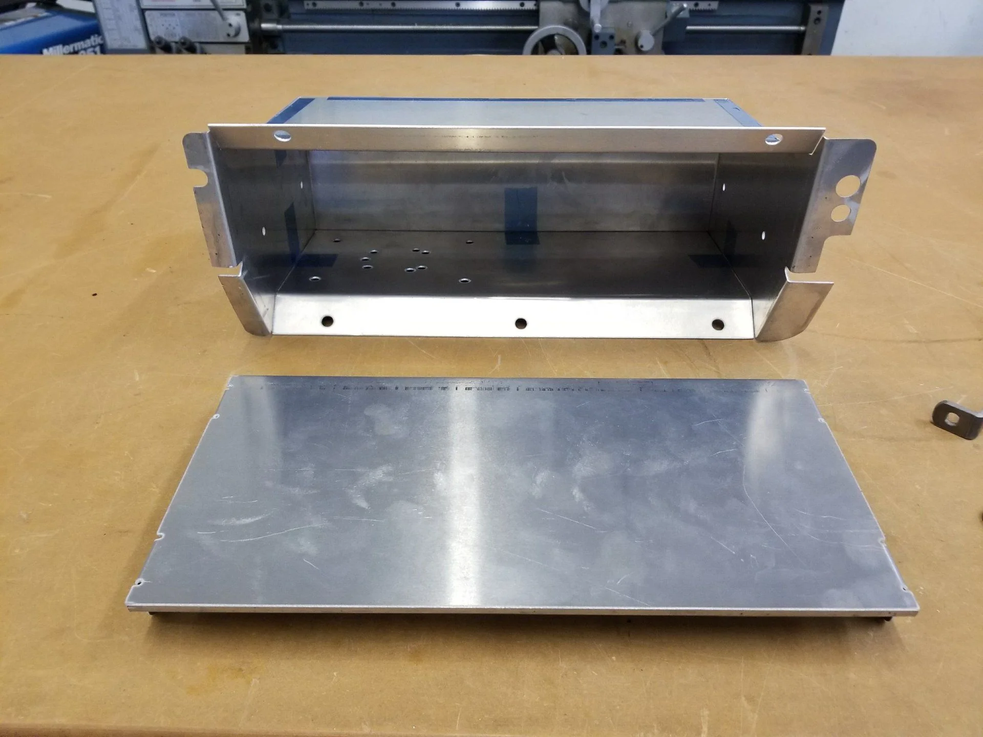

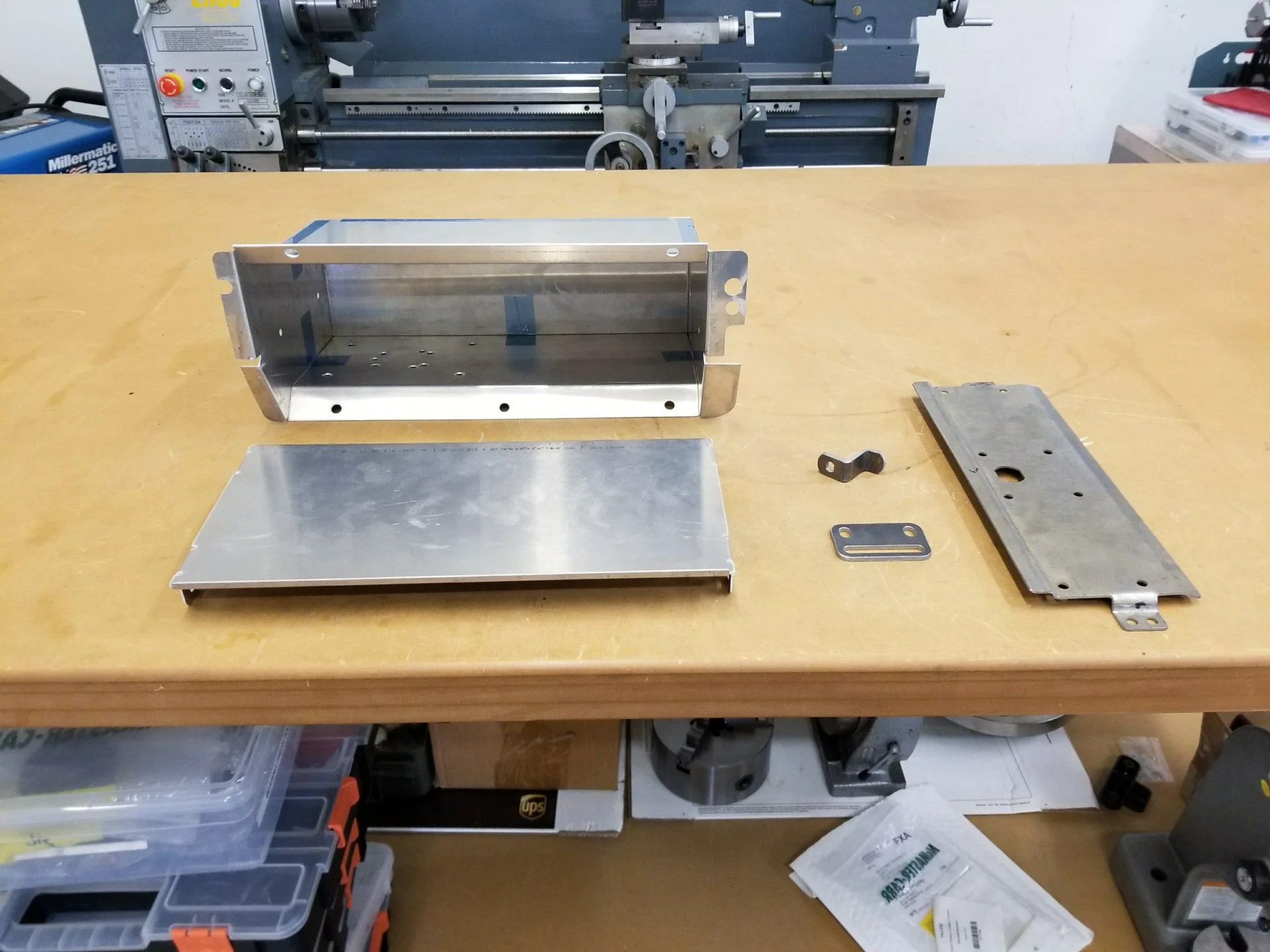

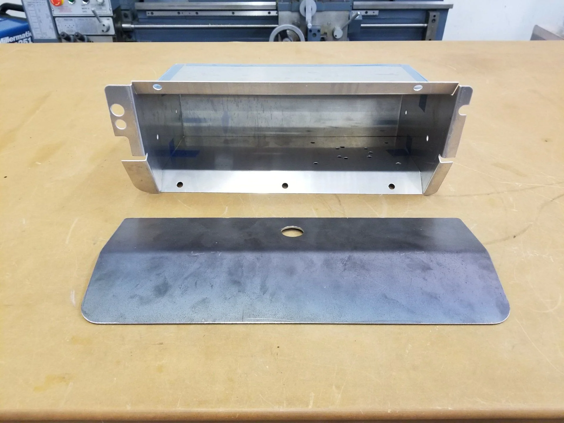

In this pic is the LHD glove box insert, the shelf, the locking cam, the locking plate and the door bracket:
Glovebox and shelf:
Locking plate, locking cam and door bracket in steel:
The shelf at its highest position at 2.5". Flip it around and the shelf is 1" tall.

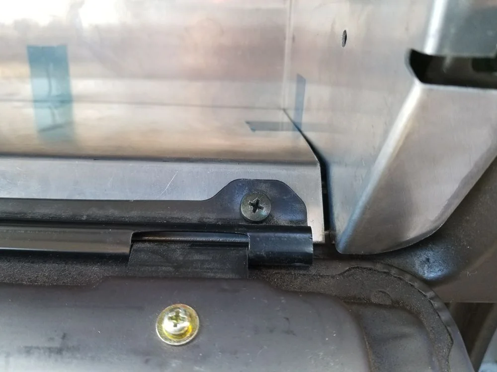

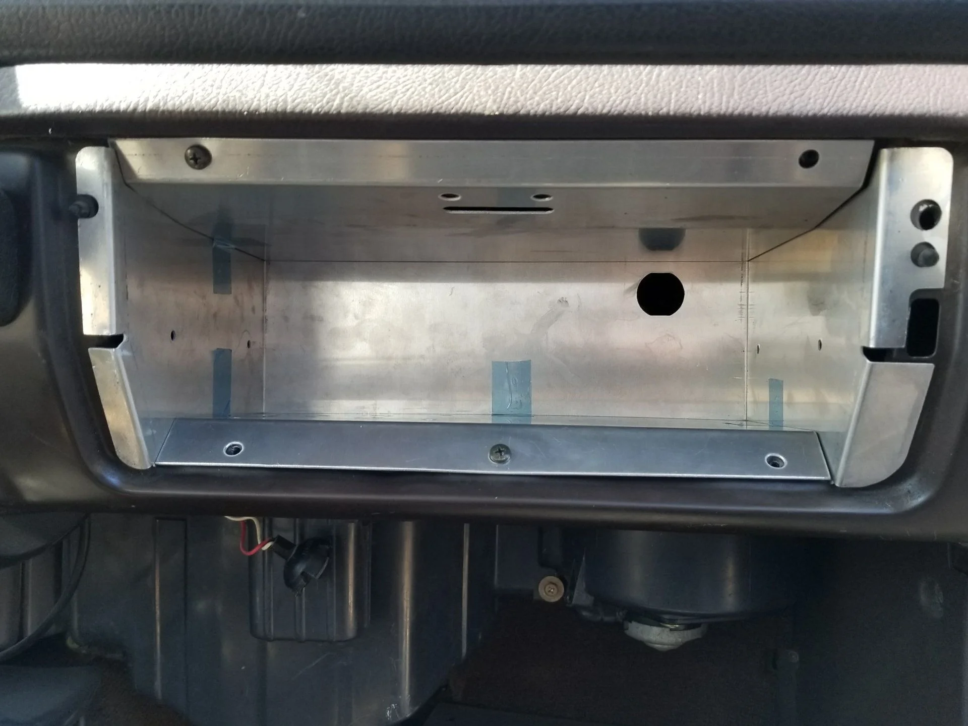

Annnnnnnnnnnd the test fit into a 62...
Overall incredibly happy with the way it fits. It just slid into place once pushed the harness out of the way on the right side.
A couple small tweaks. The bend radius on the side flanges was too tight. This created an interference with the OEM door when closed. Easily fixed in production. Going to move the right side out. It will help with the clearance on the OEM door, and fill the gaps in the corners that you see in the pictures.
Nice work. Puts the original to shame given the durability theme build of the OEM trucks themselves. Count me in for the 60 LH drive version.
A small rat can easily compromise the original design. Well done!!!
