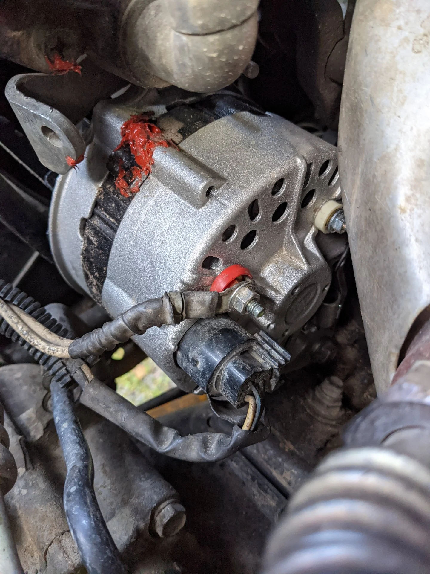

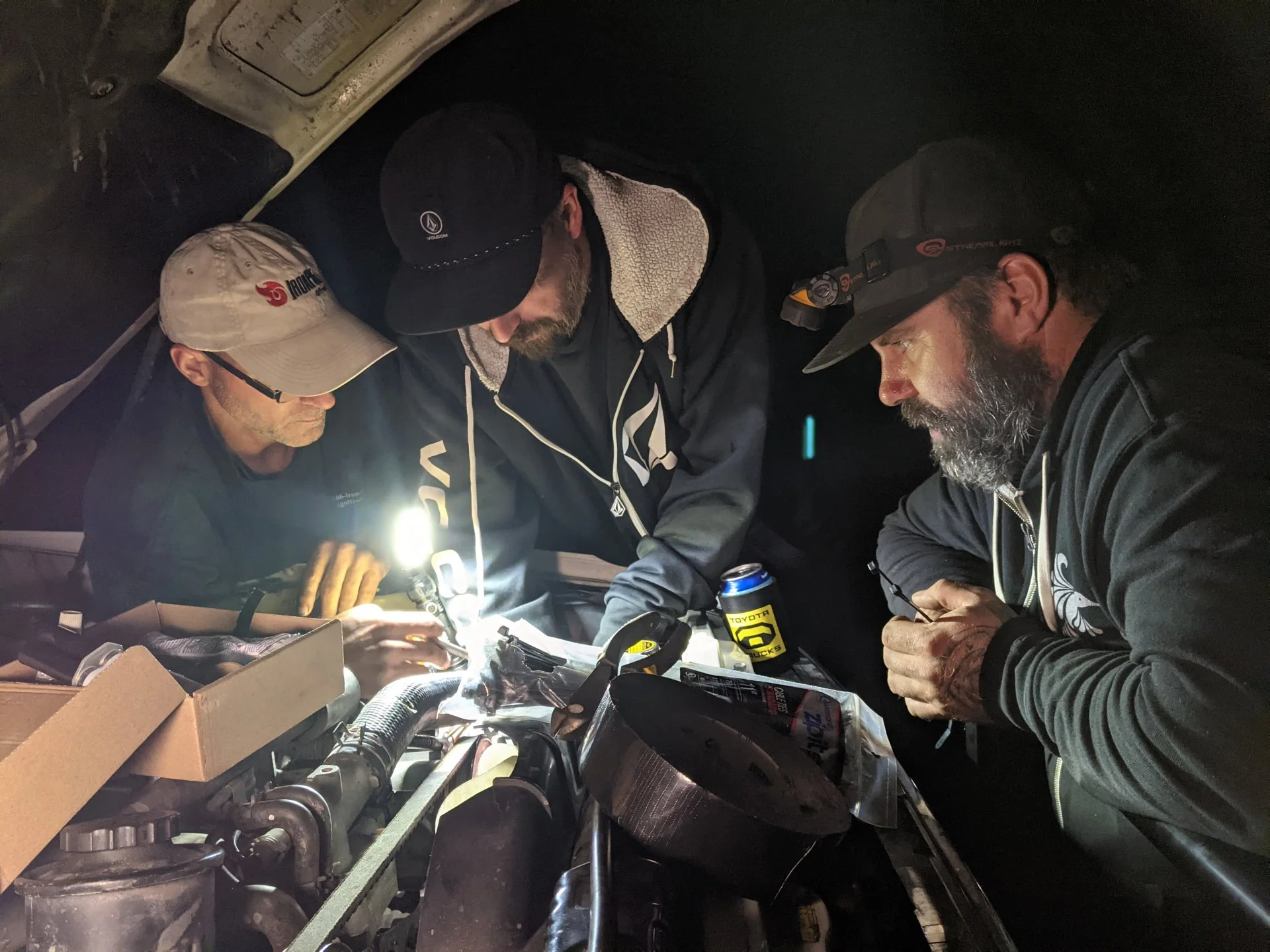

Had some issues with the truck last week, and probably would have taken the 100 but it is getting body work done from an injury sustained at Coal Mine Cruiser Classic. Anyway, my truck wouldn't start/weak start. It's actually been this way since May, but intermittently and haven't figured out the issue yet. I took it to a shop I used to use all the time, Stone Ridge Tire, and Joe assured me I needed a new alternator. So, new alternator.
On the drive to NH, it made a godawful noise. Popped the hood and couldn't see what it was, and of course when it happened I was in the mountains with no service.
Kept driving until I had service, then called my buddy at the event, who put me on speaker so the Iron Pig guys could weigh in. They assured me that as long as there wasn't a vibration to accompany the noise, I should keep driving and they'd come and get me with a trailer if I didn't show up when they expected me to be there.
They quickly diagnosed the issue once I rolled in. A pin from the newly installed alternator worked its way to the fan.
Once they were under the hood, they also saw my brake fluid was low and leaking, so they addressed that as well.

One other thing I need to say about Cruiser people. It was a really unnerving drive with that racket under the hood especially when I didn't have service, and 10:30 at night, etc.
And I love this damn truck so much and was so worried that driving it was going to exacerbate the issue...
I came into camp and at one point there were so many guys under the hood I couldn't even peek in there.
Pretty amazing group of people.

I dont understand...what do you mean by a pin work itself loose and made it to the fan?
@Marco Lau I'll take a pic of it tomorrow. Not an OEM alternator and clearly defective.
You can see where it slipped out and the goopified mess to keep it from going further. Lance's original tape fix only worked until I was on a super long downhill.
