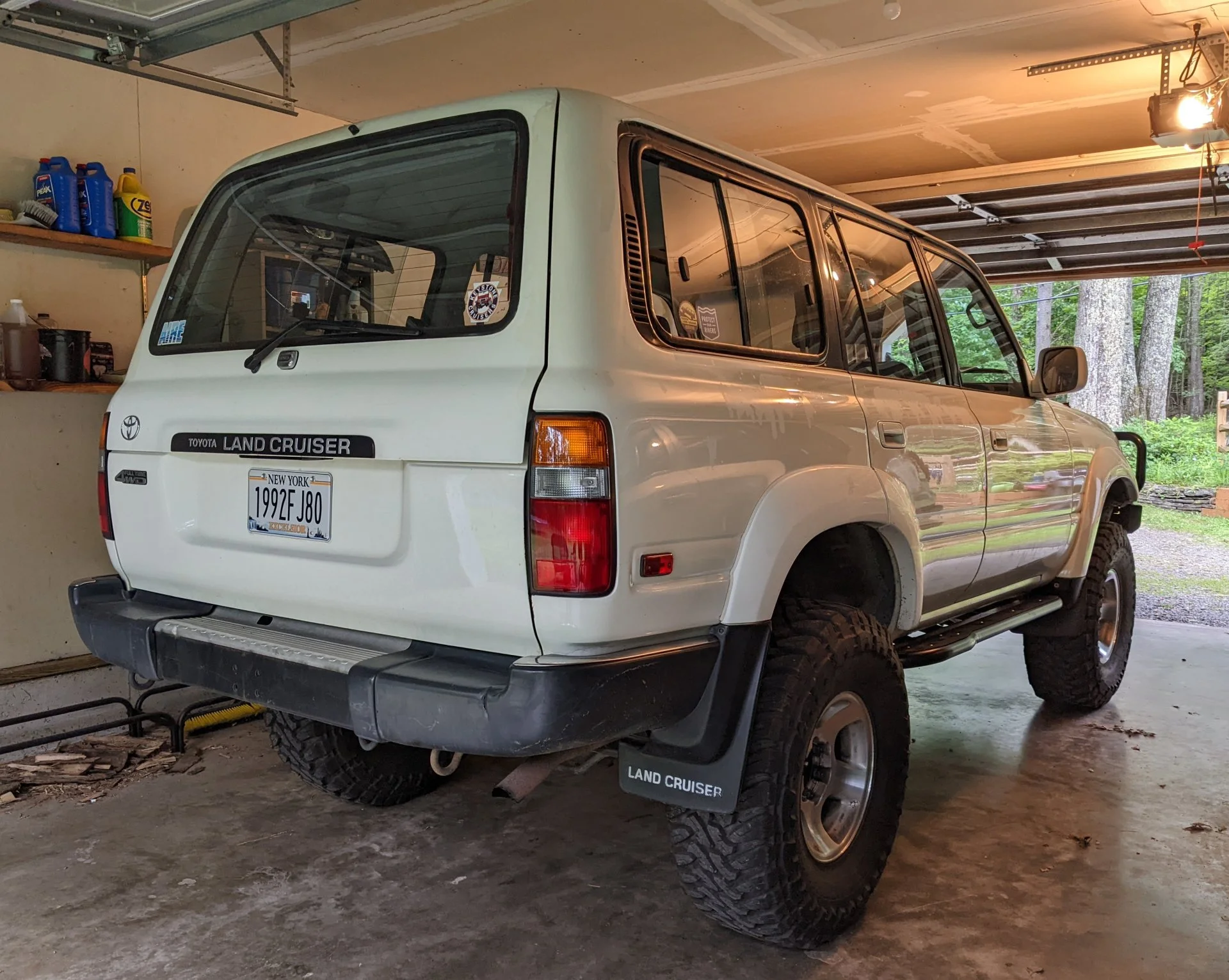

My truck spent some time with @Pacer and came back much improved. Before he took it home a few weeks ago we removed the rear sway bar to install an HD one from whiteline. It didn't match up so will need holes drilled in it, but he wanted to test drive it without the sway bar and the ride improved remarkably. So I've been driving it without it until we have a sec to get the new one on.
He addressed a lot of problems I didn't even know I had and the truck is much happier. He also swapped out my MTs for smaller ATs that were on his 80 and the truck is working a lot less now.

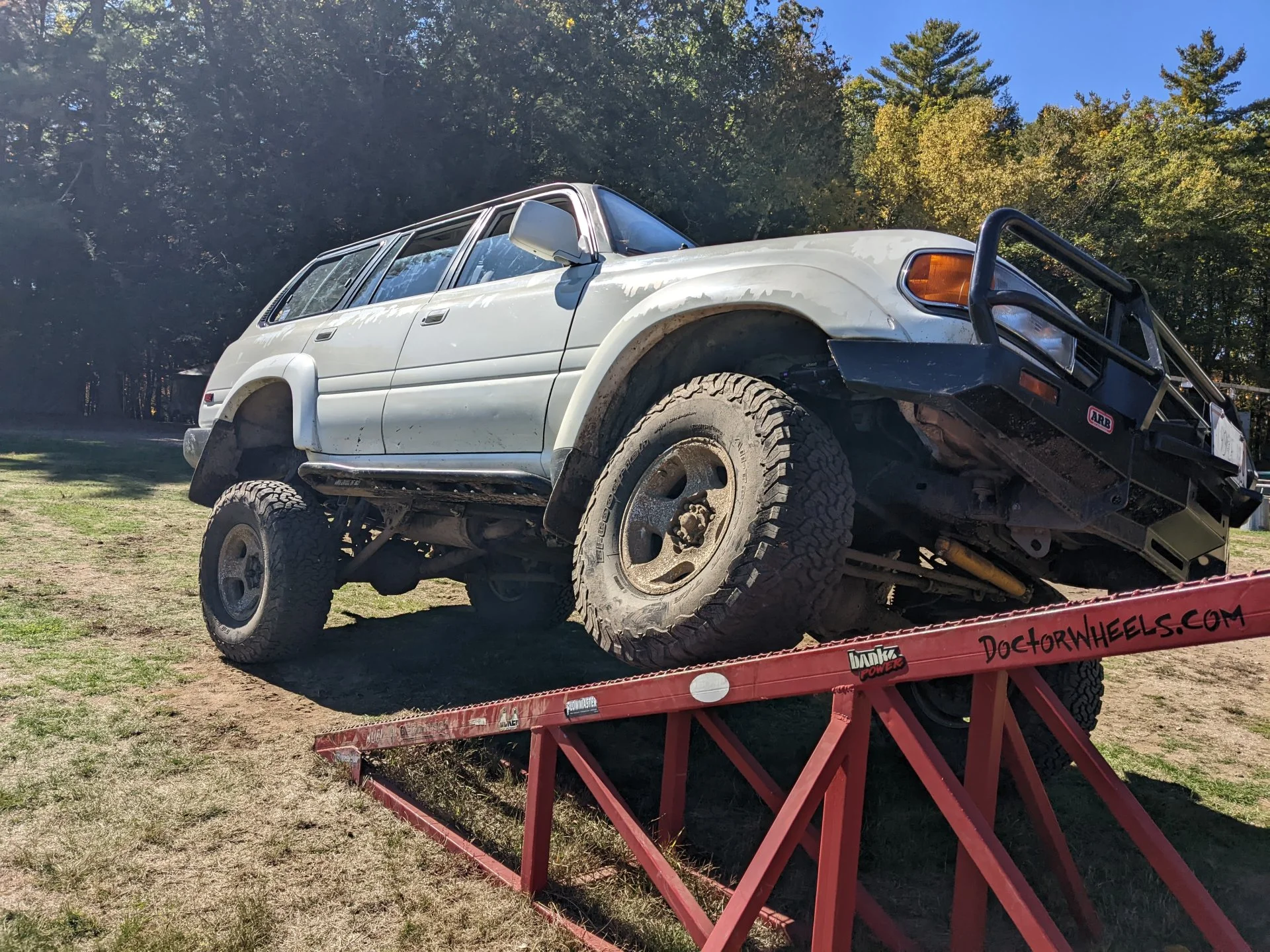

Enjoyed a perfect weekend at Yankee Toys' Fall Gathering. The truck is such a pleasure to drive off-road. And -- as you probably could have guessed -- having real difficulty considering parting with it now.

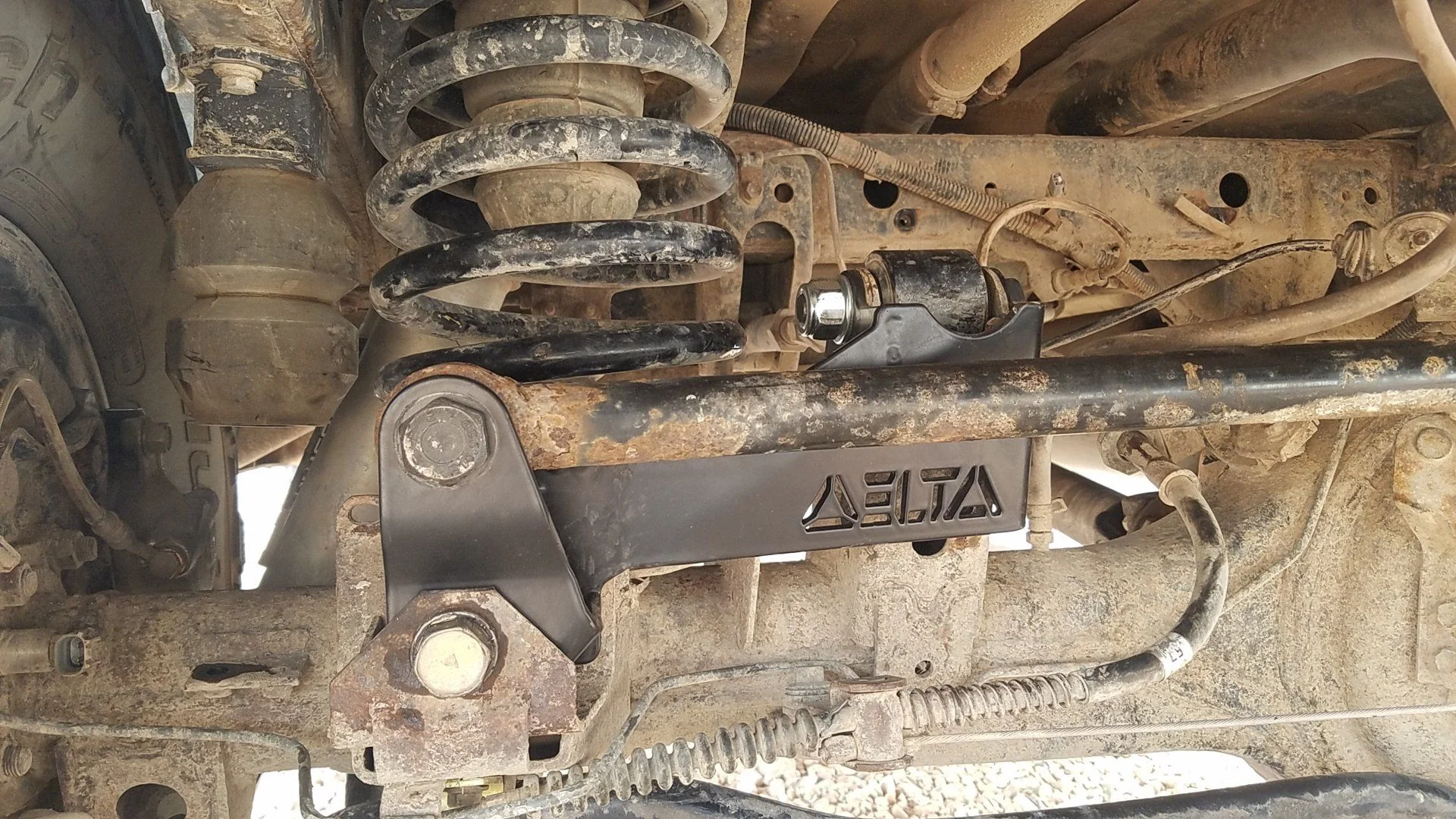

Rather than browse through your whole thread, can you remember if the Delta VS Panhard Lift Bracket was installed in all your mods? If not, look at your rear panhard rod and see if it has much of a slope. According to @Delta VS , handling can be negatively affected after a lift if the panhard has much of a slope. It should be as close to horizontal as possible. Here's a link to the thread that talks about it. Sway bar removal, especially the rear, is not a good idea for pavement performance. Might even have legal issues if you have an accident involving another vehicle and an insurance investigator discovers a safety device was removed. Yes, sway bars are considered a safety device.
Yes, I've got the bracket.
