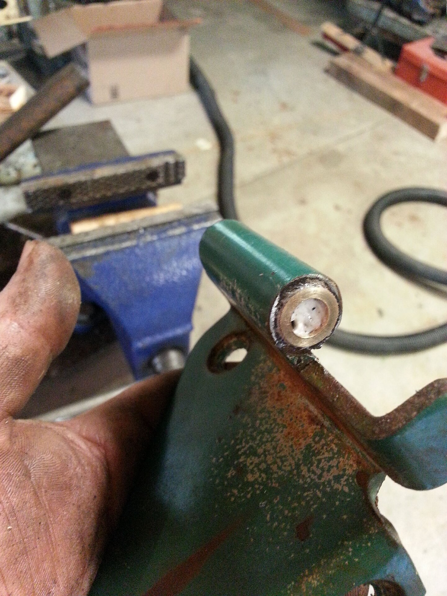

I drilled the hinge out to 7/16".
Installed bushings
I used a vice to press them in, and a file to thin the shoulder for a perfect fit.
The hinges now work better than new.

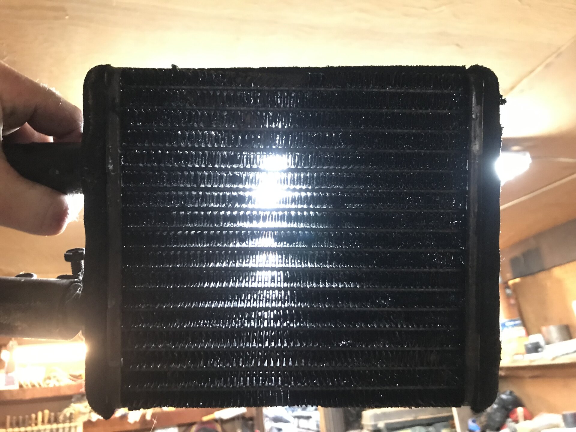

Heater core before and after. Well, light particles can pass through it now. I can’t remember? Is light thicker than hot air??? Lol

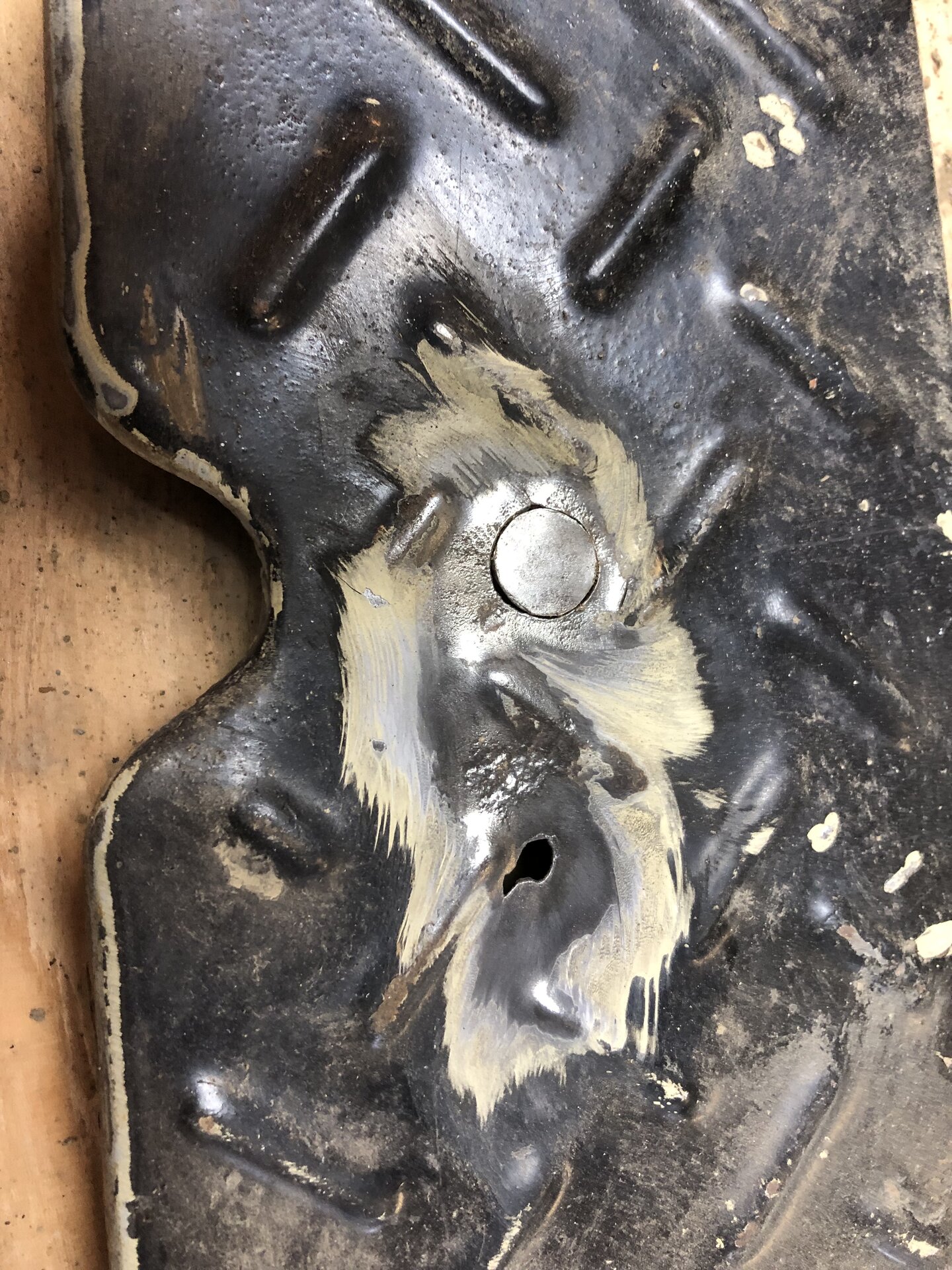

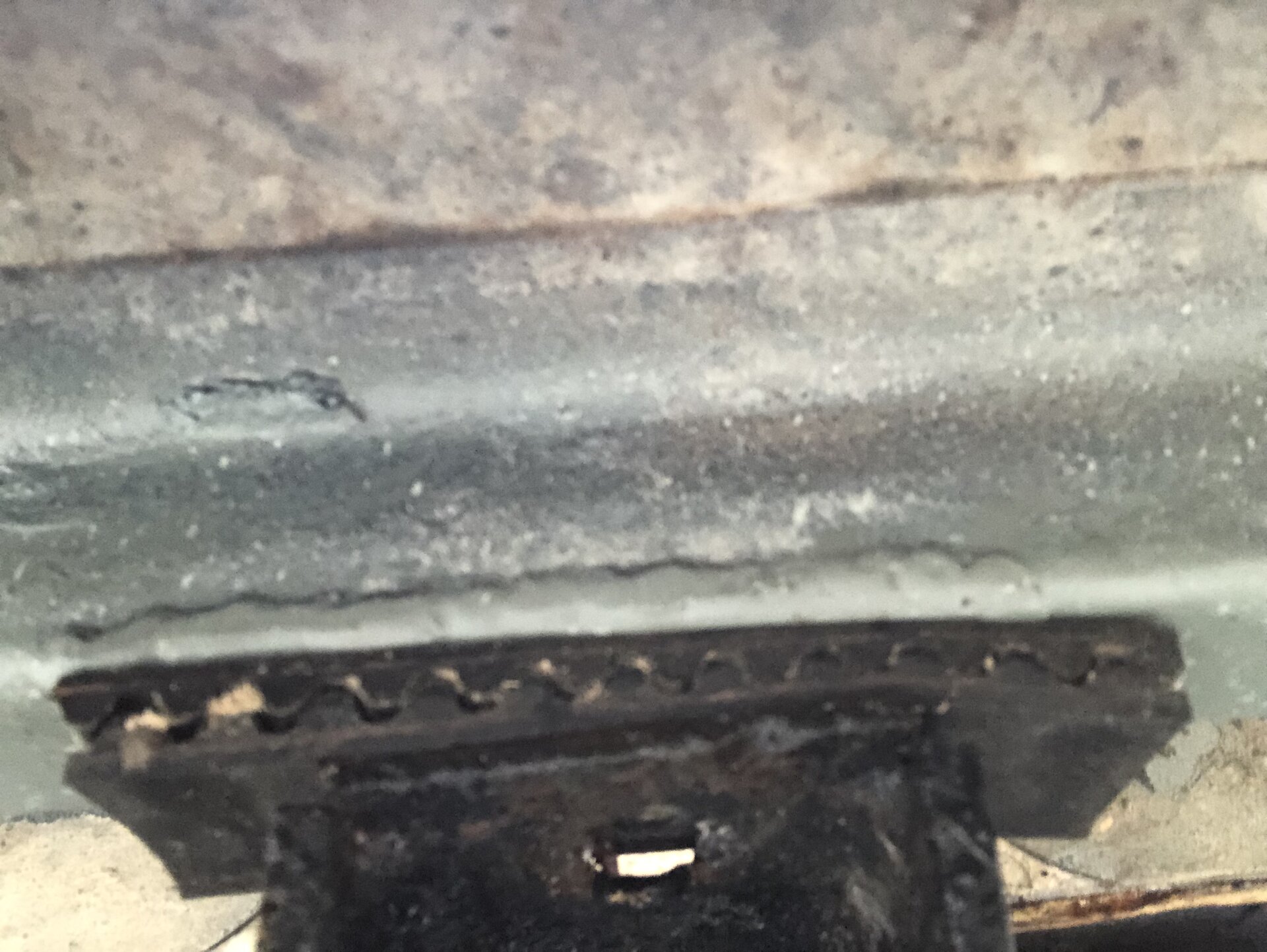

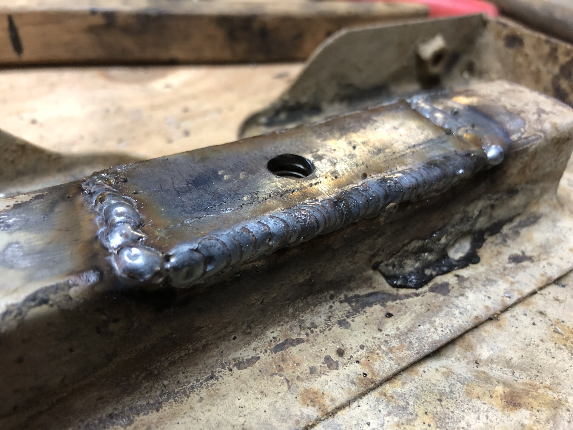

Looks like someone got lazy and just drilled straight through and probably sandwiched it with a carriage bolt. Support rail was squashed on the driver side. I cut it out and replaced it with 1/8th steel with a bolt welded on the blind side.

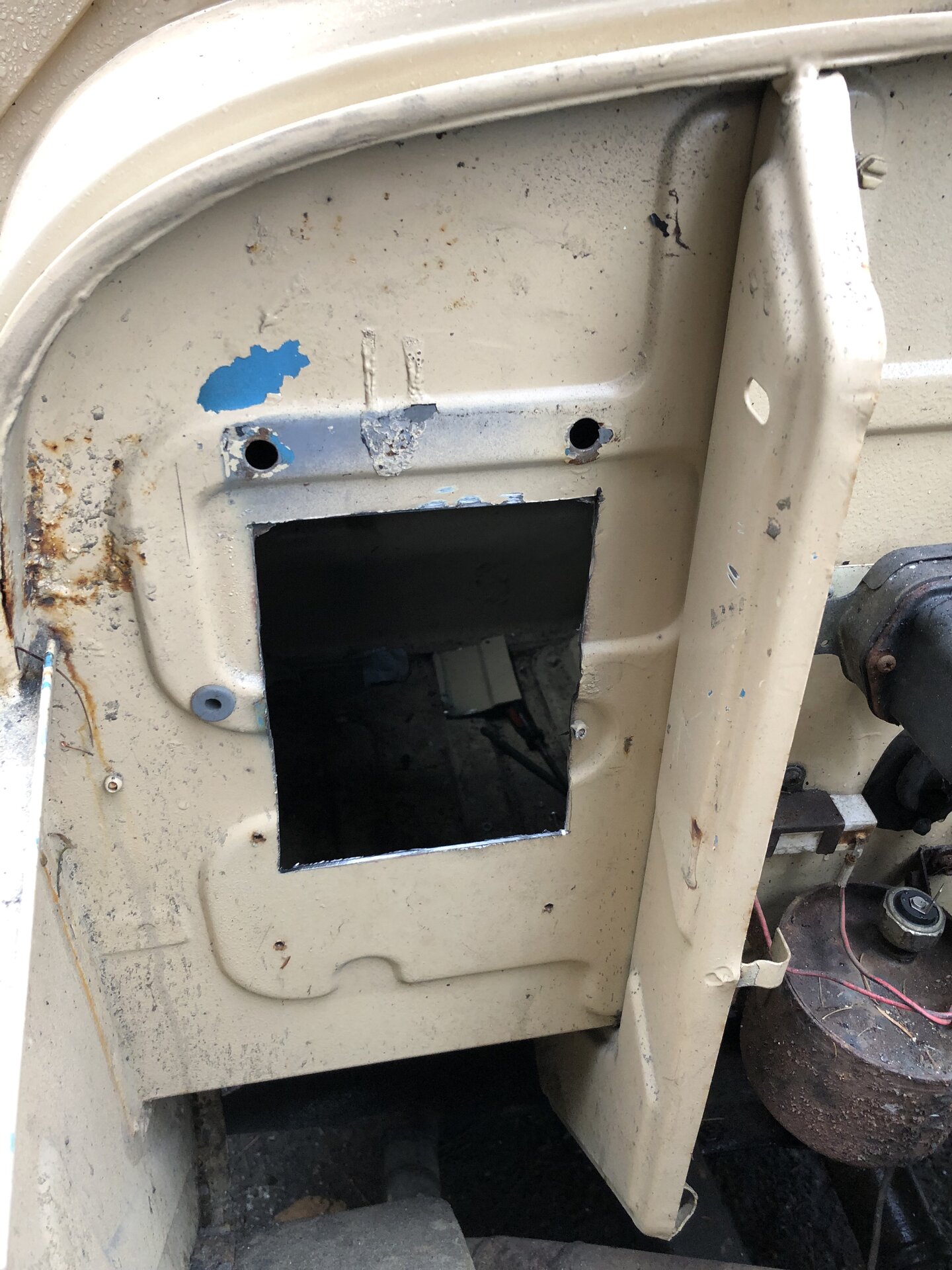

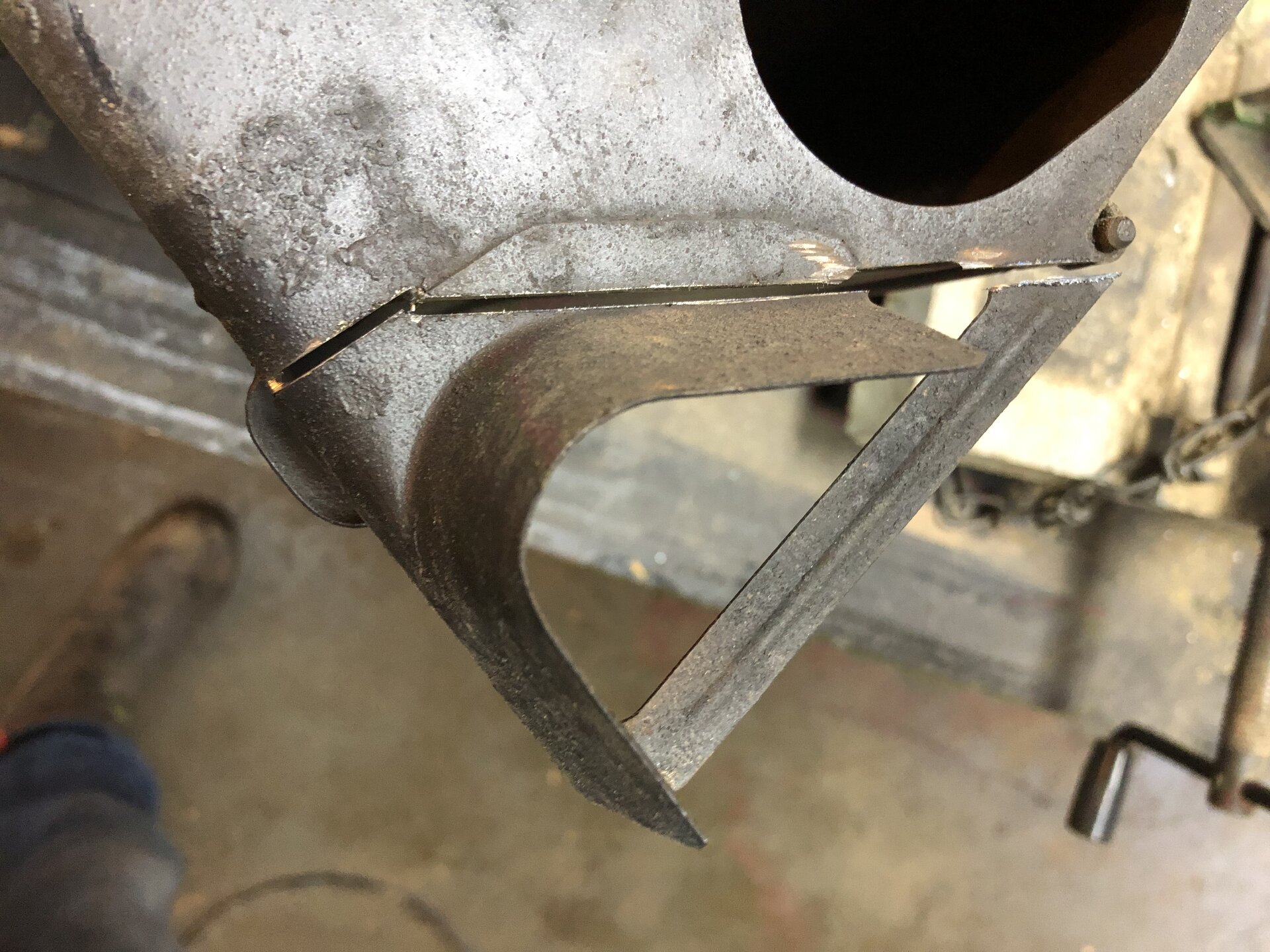

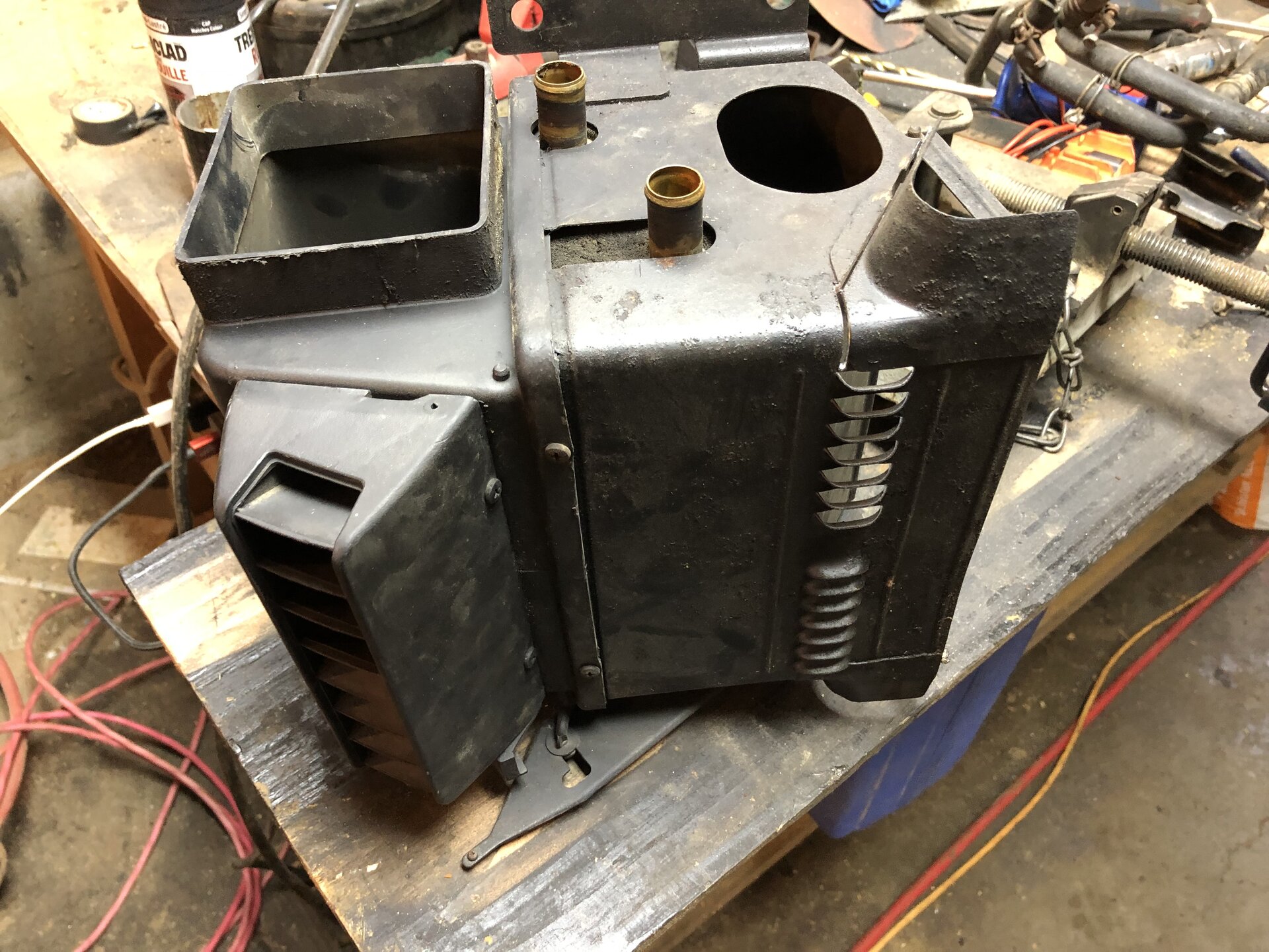

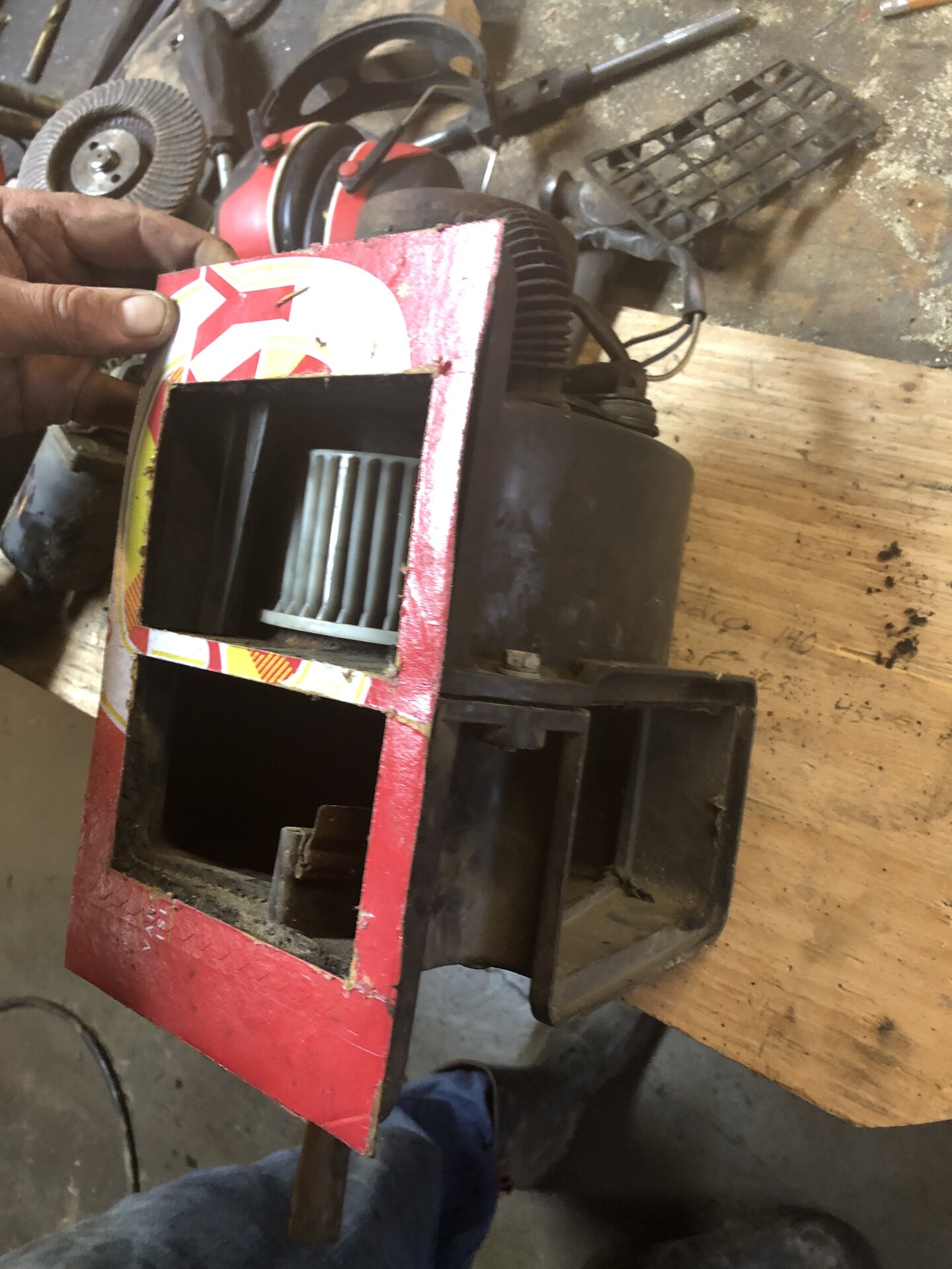

Well…… who ever did the engine swapped used the tranny hole for the OM transmission which was about 2” further forward than the h55 hole. Not in the bandeirante. So instead of hacking the engine mounts off, transmission, new drive shafts. I decided to modify the heater. Minimal heat for the toes now but these weren’t really designed for comfort.
Slowly deleted the old heater core, cut new holes for the Canadian blower motor. This is truly becoming a hybrid. Some more plumbing and window defrost vents to be cut. So far it’s still a win. 3 steps forward, one back.
All the forward gears are touching the heater core but should still be fine.
