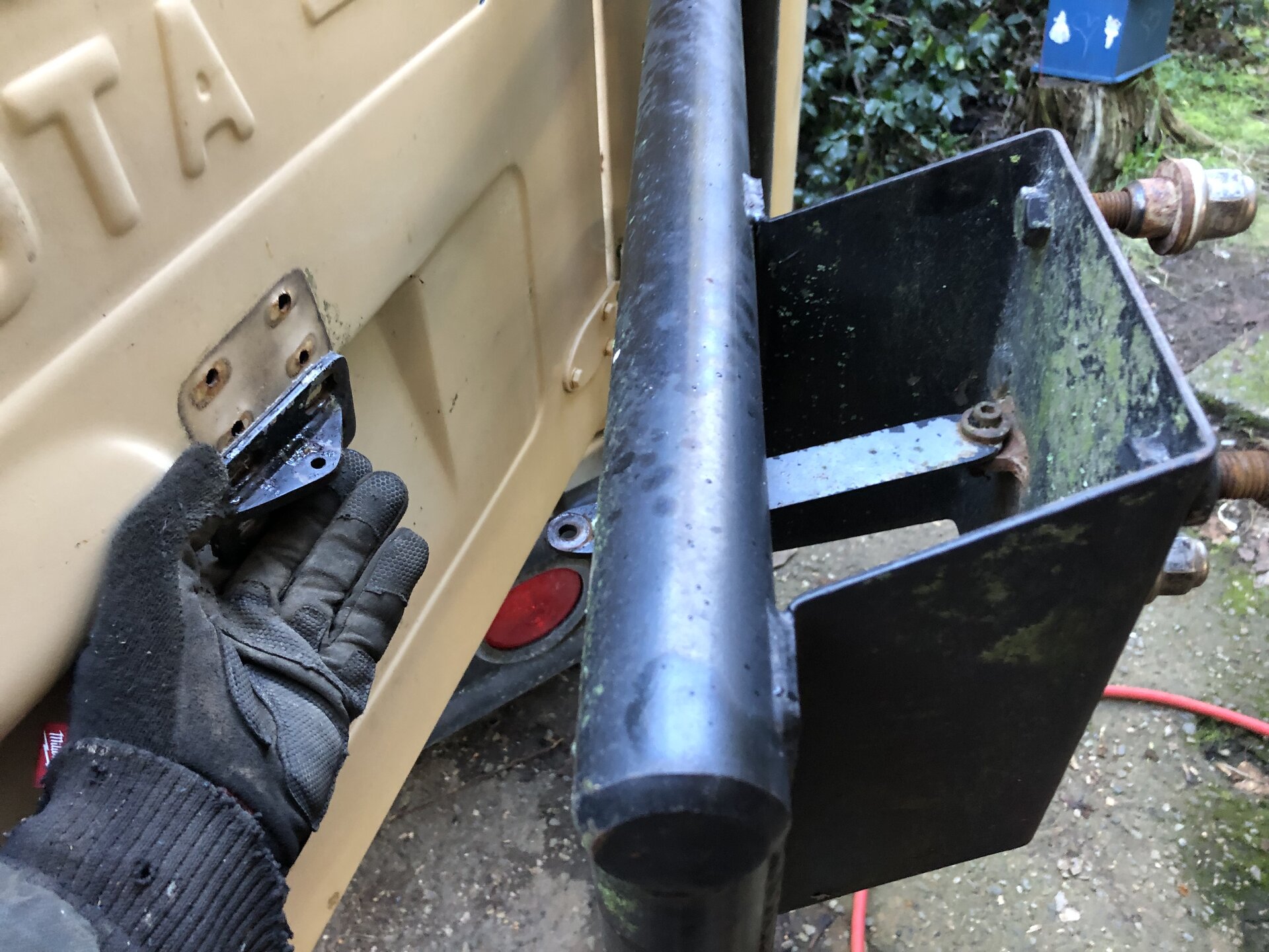

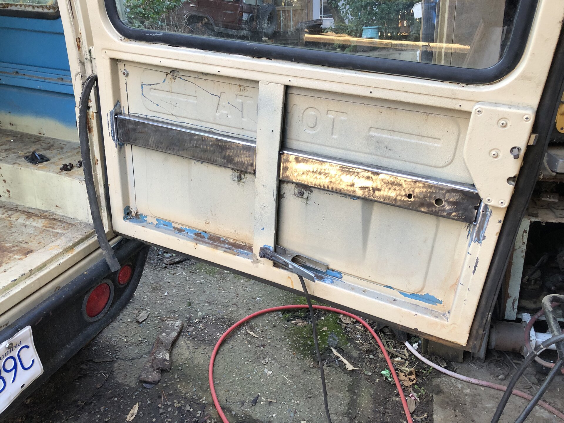

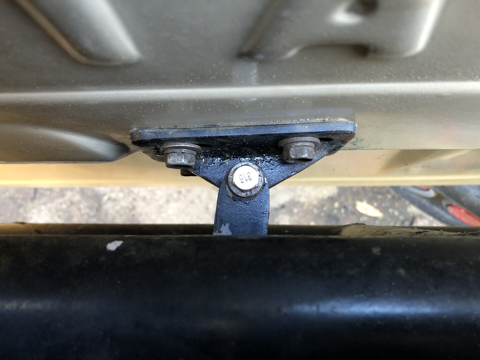

Someone fabbed up this cool tire swing out carrier. Which pivots when you open the rear door. Unfortunately they just mounted the lever mount onto the super flexible 18 gauge steel. I had the perfect piece in my scrap pile the re-enforce the mount. There is a backing plate welded on to the back of my cross member, tapped and installed some oem 12mm bolts. She’s solid now.

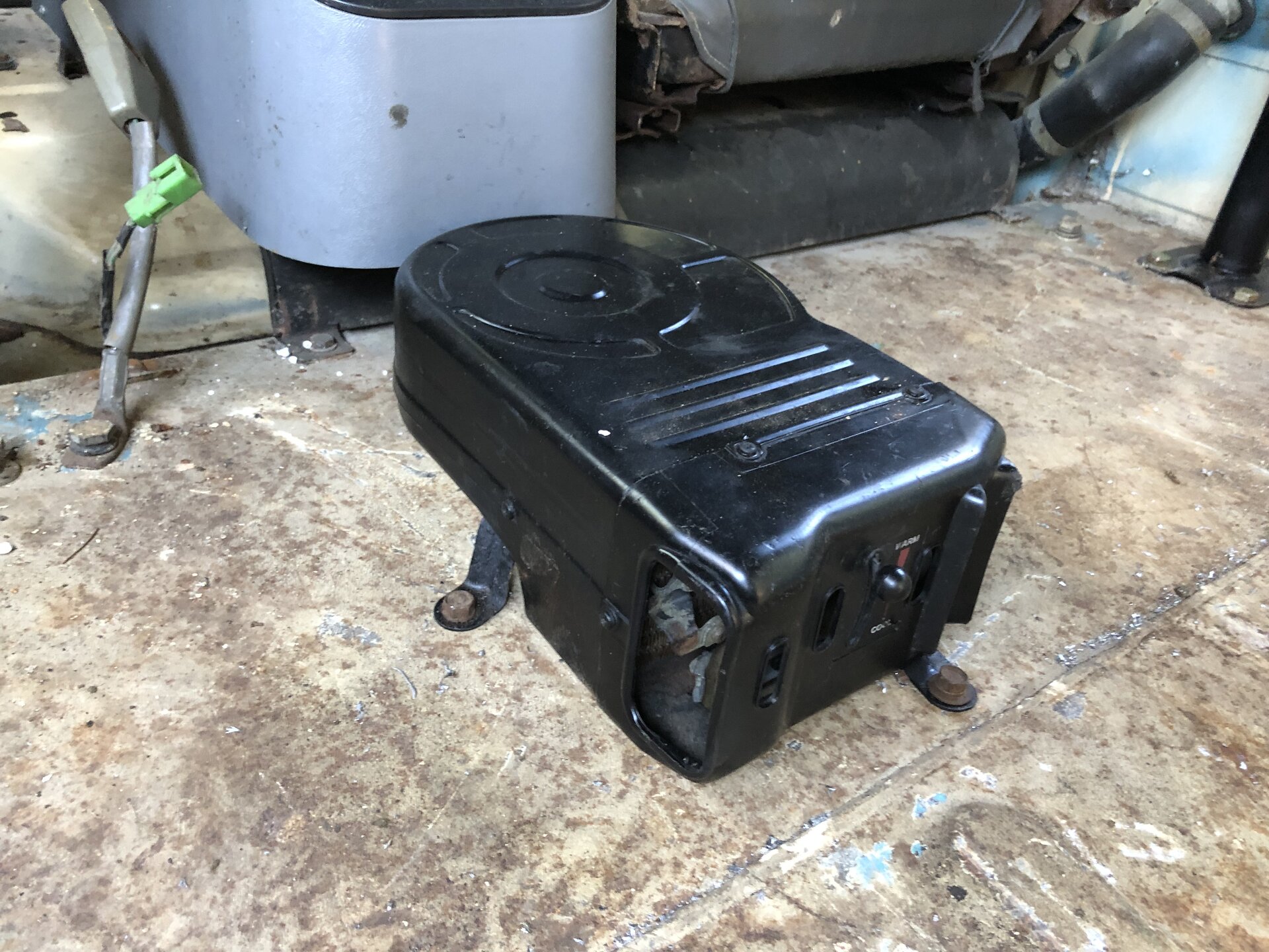

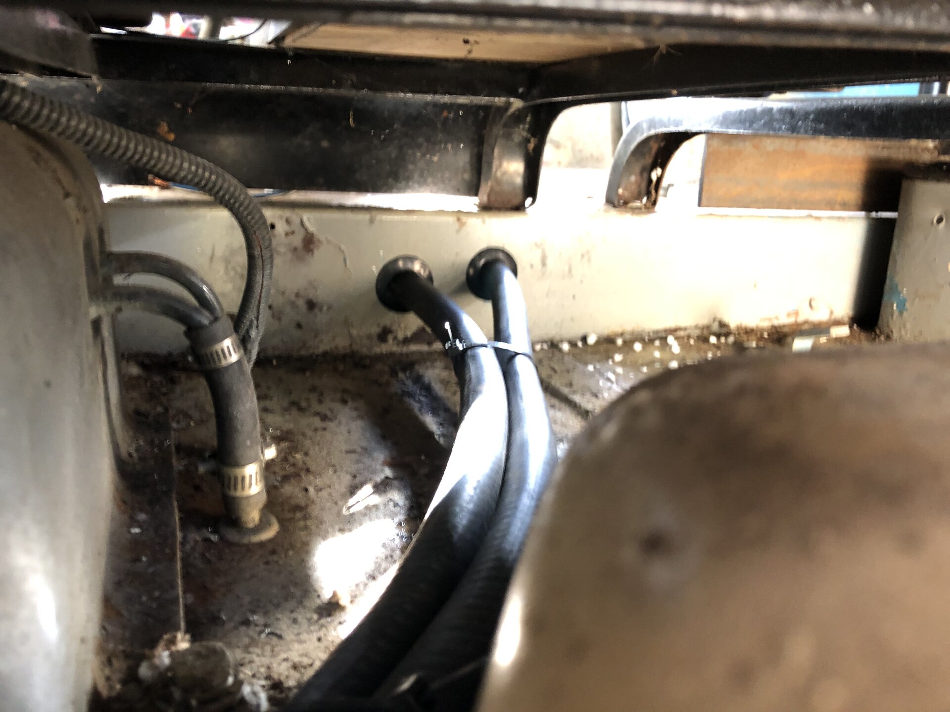

Added a 12 volt rear bi60 heater. Will have to wire it with 24 to 12 volt reducer which I might add a 12v stereo to run on the same circuit.

almost looks stock other than the random holes.
Leak test failed. Lucky is was just one hose clamp

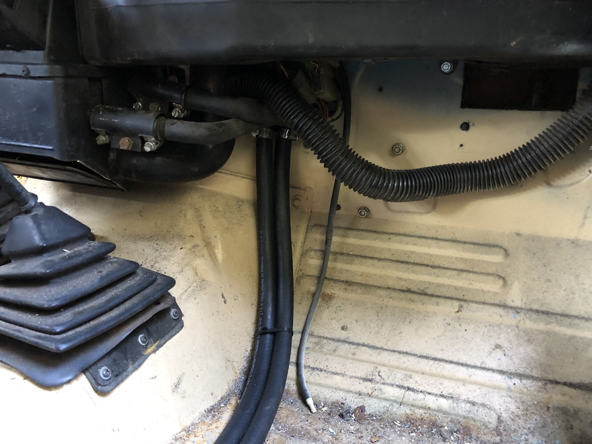

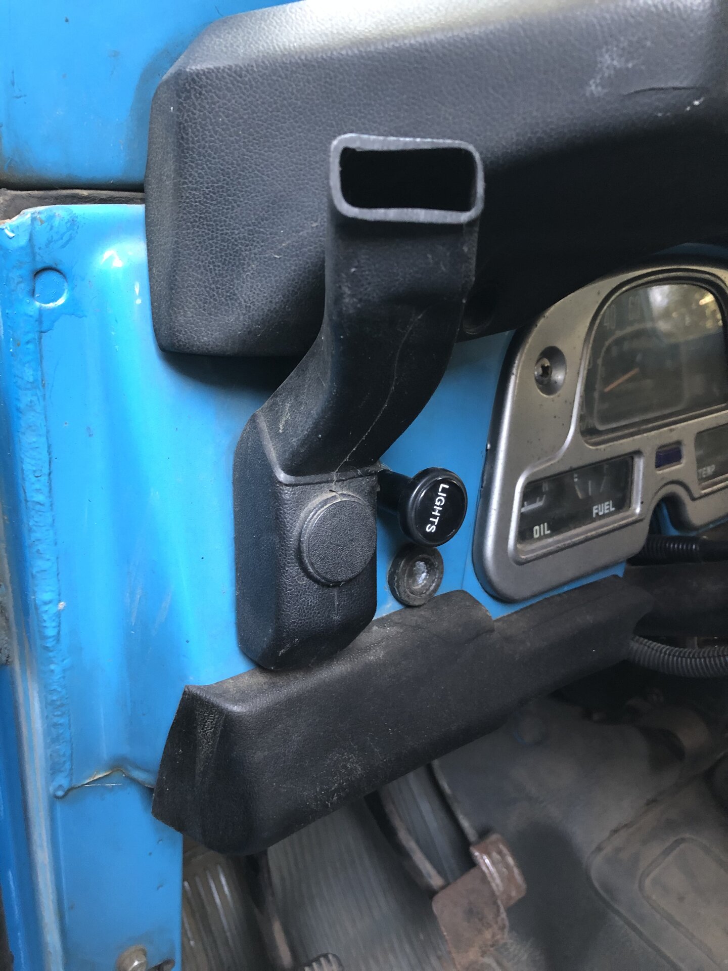

On another note, this firewall doesn’t have the heater jackets to install the window defrost vents to. Although it does have a Canadian window frame. There is no through vents to connect the air flow from firewall to window frame. That means the top has to be lifted to lean the window forward. Which these hinges don’t allow the window to fold. Sounds like a spring time job. Although I can modify the firewall to accept the folding window hinges. One thing leads to another.

That business with the defrost is a pain eh?
I have to run my washer hose up through the frame on mine...same deal. That's gonna wait until the roof is off again in the summer.
