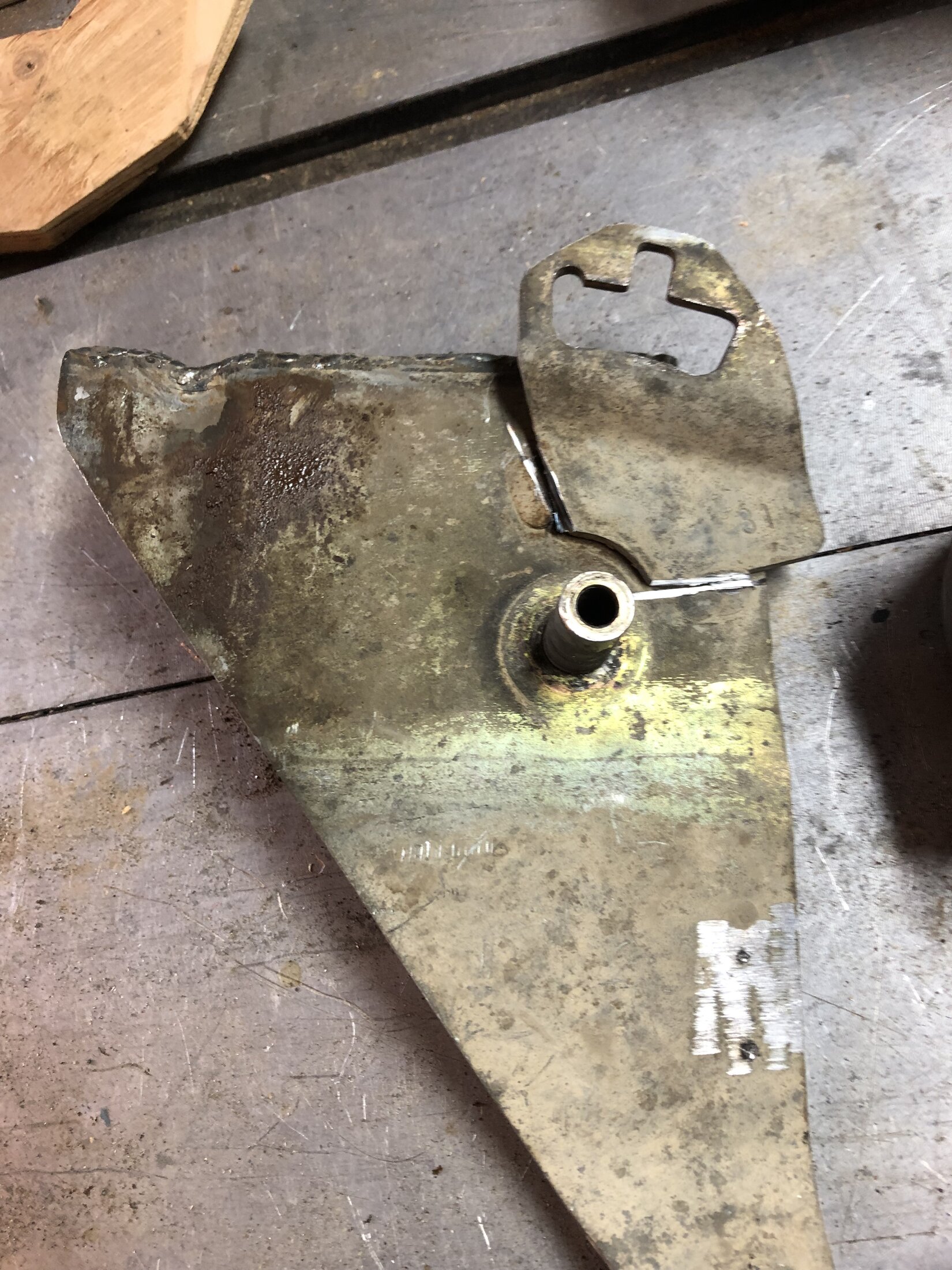

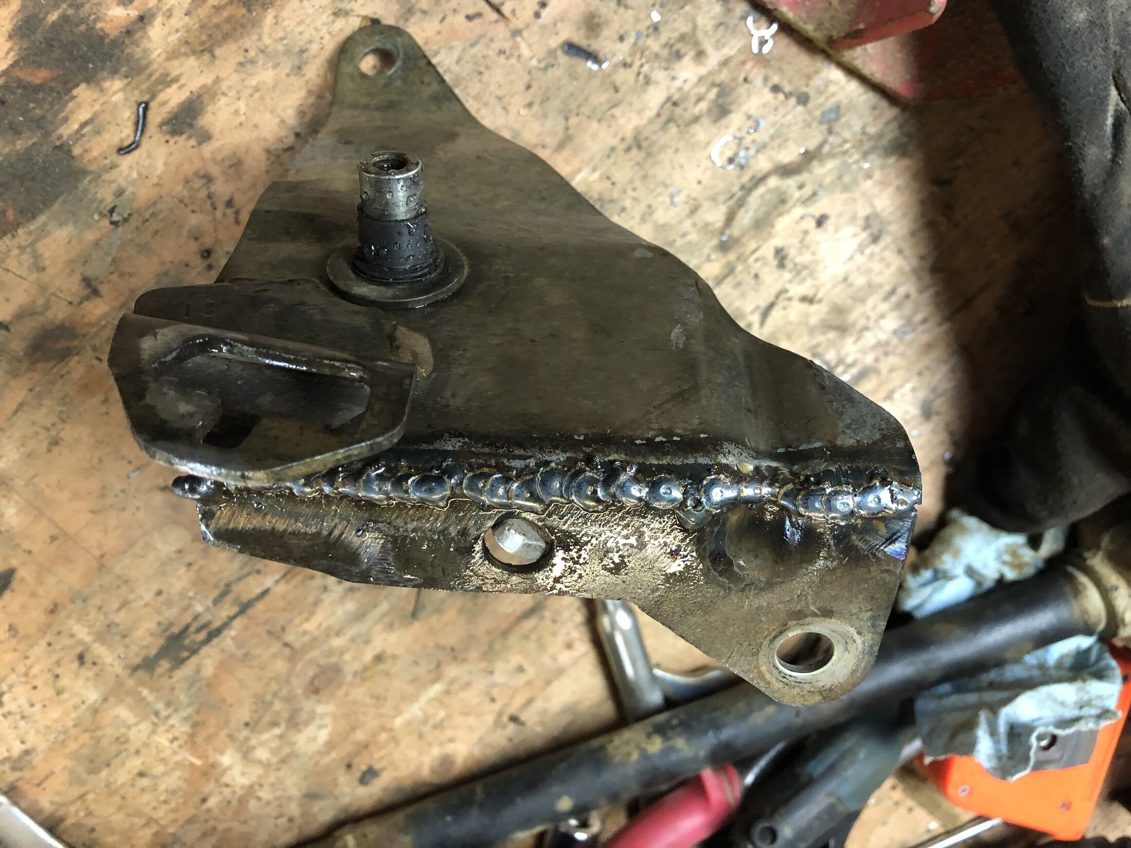

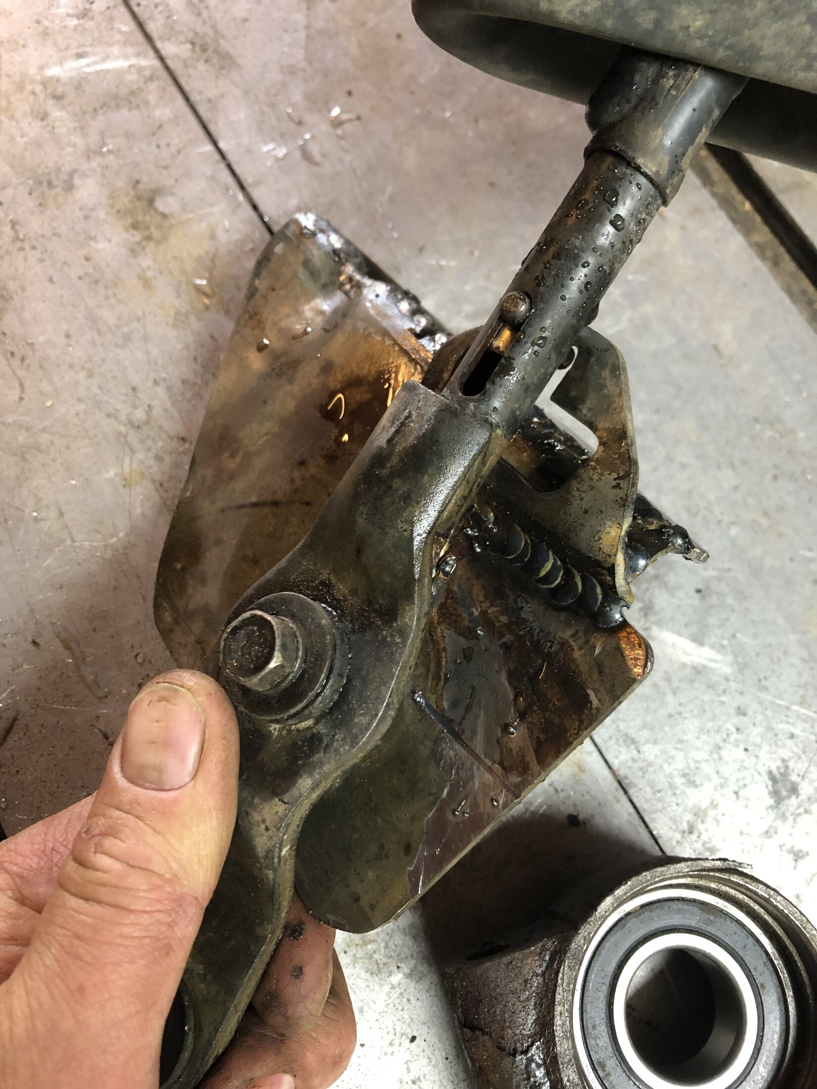

If you have to take the shifter knob off watch out for the tiny ****ing screws. I modded the bracket to get the handle further away from my leg when driving too.
Sticks out a fair bit otherwise. Or at least my RHD 60 bracket did. Maybe there's different ones.
Toyota must've had a mountain of extra PTO gears to get rid of 🤣
I gotta do something with mine. Tripped over a Braden? PTO winch I bought 15 years ago yesterday.
The problem here is my hand brake on the floor. Exactly where my pto level wants to be.
This winch was from a RHD hj60.
I still have to take it off to drill the cross member that someone home built.

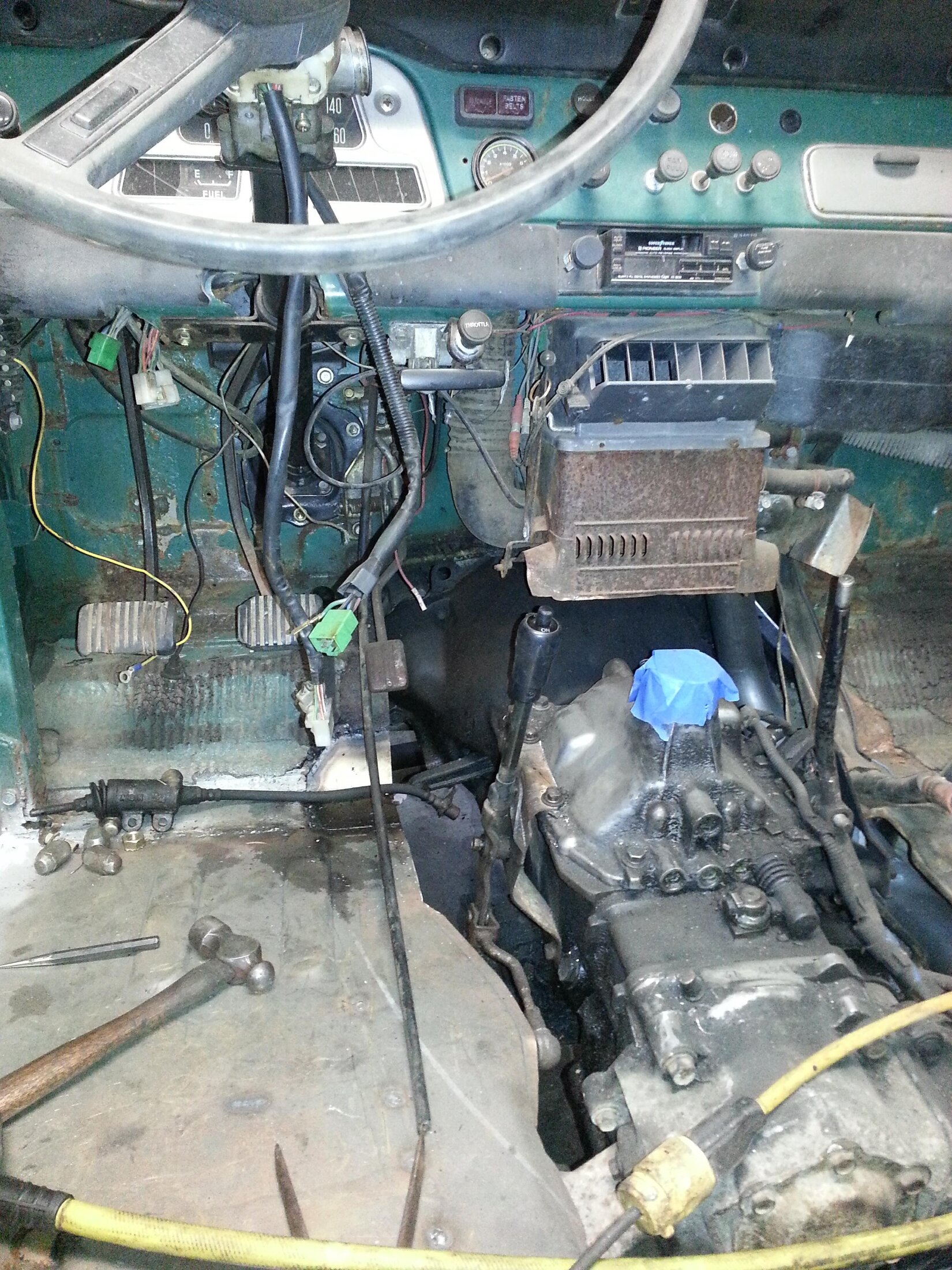

Not sure if you can make these pictures out but this is my tight squeeze. As men are good at these moments, we’ll make it fit. I had to advance the shifter location by a bolts worth on the top of trans. Might try to slide the transmission to the passenger side a bit so I do t have to change the transmission hump. All I need is an extra inch. Custom!
I’m sure y’all would have done it a different way but this is how my brain does puzzles.
Would using a 60 series top cover for your transmission to move your shifter back 3.5” to get it out from under your heat make things work better? Or is it already a 60 cover and the transmission & engine really far forward?
Usually I only see heaters modified that way when there’s a V8 under the hood.
It’s a 40 series top. This winch was from a 60. The engine swap was t done to Toyota spec. Seems way more forward than stock setup.

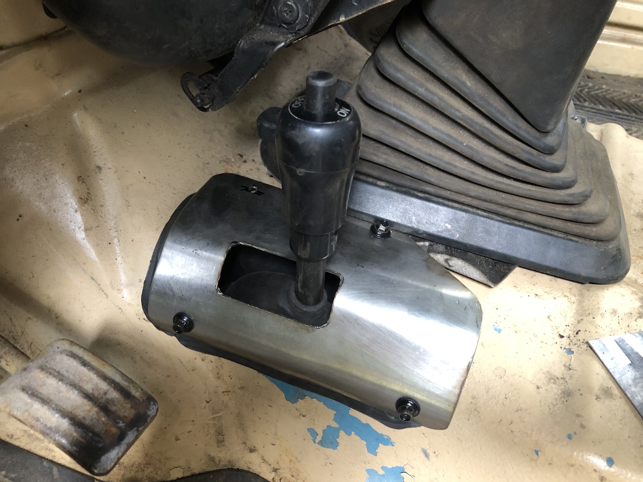

Well it fits and dang that was tight. I imagine the 40 series had a different transmission hump than the bandeirante. Had to swing the transmission cross member over a good 1/4” and heavily modify the lever mount but it works.
Ugh. That stainless looks horrible.
