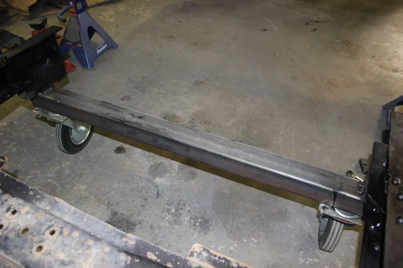

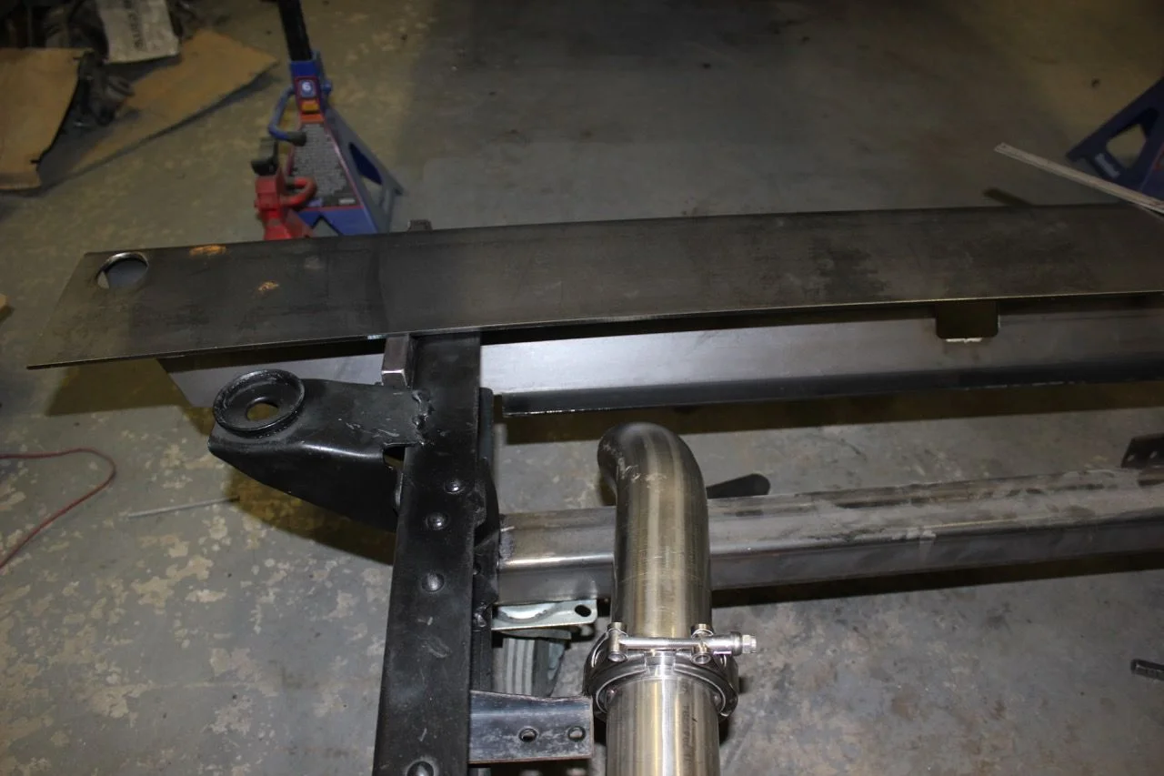

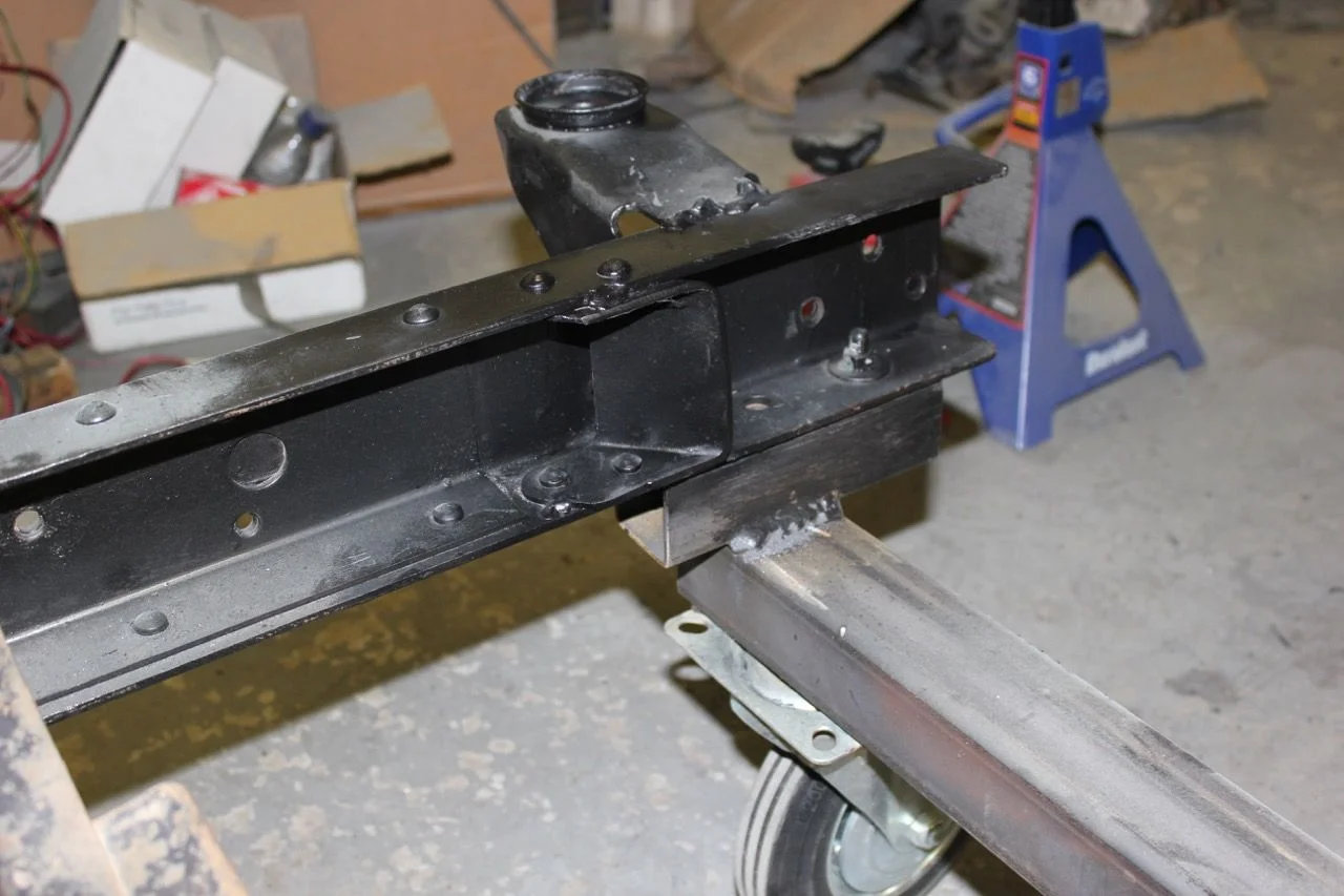

First job today: finish prepping the frame for the rear bumper.
I had already removed the 5 rivets, but I still needed to cut out the rear crossmember.
Then, I placed some of the 4x4Labs bumper on there, so that I could get busy fabricating the rest of the exhaust.

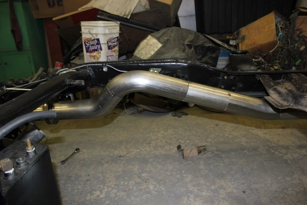

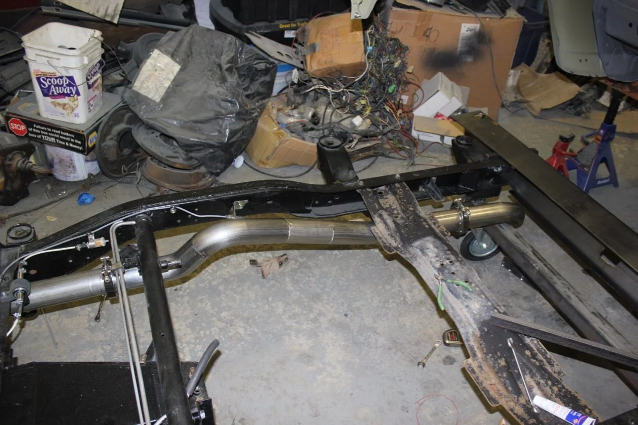

All done!
Here's some pics showing it vertically. It should clear the fuel tank at this height, and the only place where it really drops below the bottom of the frame is around the rear axle--and even then only a little.
One more pic, of the tailpipe. I still need to add the last exhaust hanger (probably tomorrow).
You'll notice that the tailpipe is removable. Dad and I debated that a bit, but this way if the exhaust gets damaged (we damage the exhaust on the 60 pretty regularly) I will only have to deal with about 8" of the exhaust to fix it.
That said, this shouldn't be very susceptible to damage anyway, being pretty much above the frame rail in the back, and tucked into that cornet of the frame and bumper.
I already realize that I need to shorten it as it is. That way it will clear the crossmember that I have not yet welded in on the bumper.

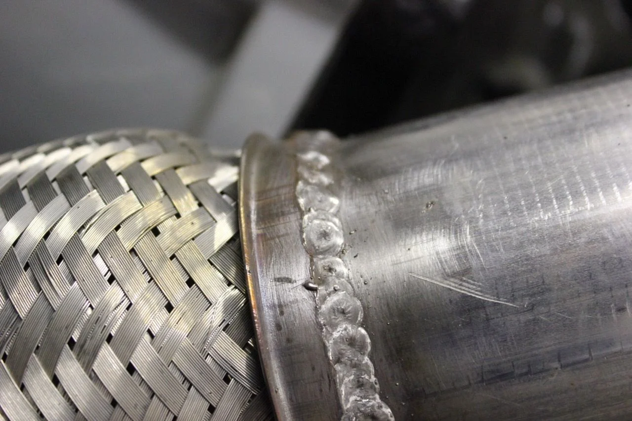

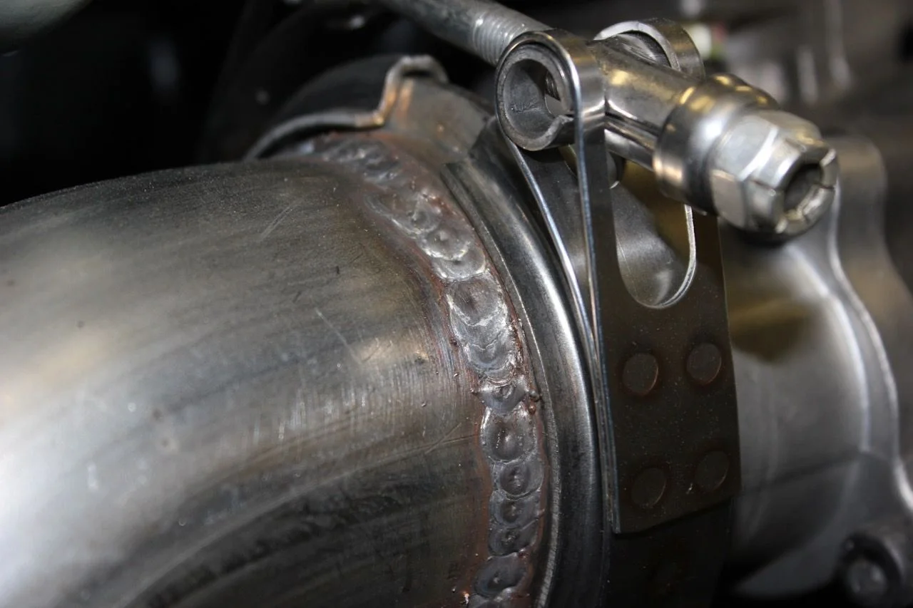

I finish welded the exhaust. Doing a series of tacks turned out to be the most consistent way for me to get a decent weld. We've got a Miller 210, which doesn't have the infinite voltage setup that newer welders do. I think that would make it easier to not burn through. I definitely had to control the weld carefully to avoid burning through. But I'm happy with how it turned out.
FedEx had a hiccup, so I didn't get the box with a few parts I was waiting for, but I'm glad that the exhaust is done. It really looks great, IMHO.

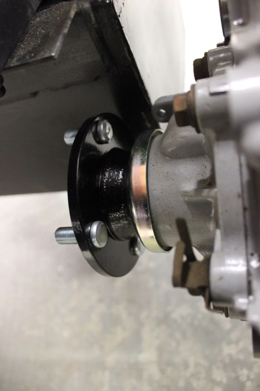

So today I did some other odds and ends that needed doing. Like powder coating the T-case flanges, putting in the new studs and dust shield.
Much better.

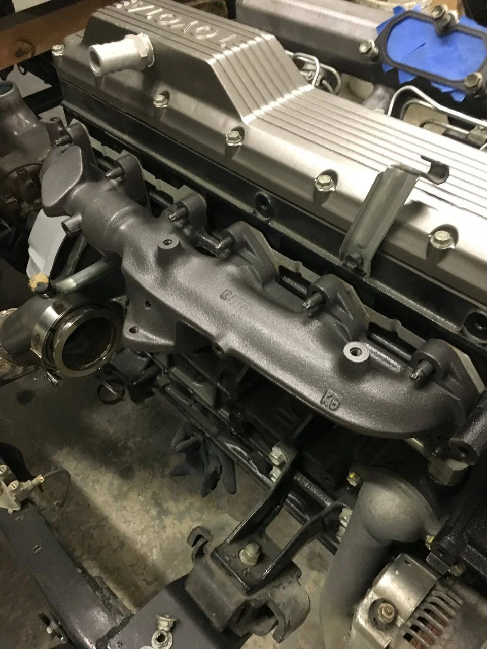

That's a funny color to ceramic coat the manifold o_O
Fixed it for you.

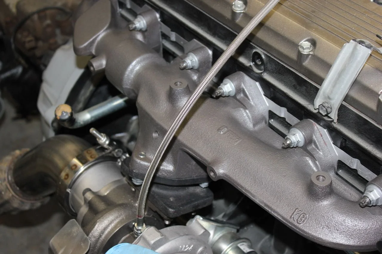

The Exhaust Manifold is back from the ceramic coater. Looks great! I can't wait to get back to working on the truck so I can really button stuff up for good!
Dan
Did they blast it for you too or did you have to do that before you sent it in? Looks nice. I am having exhaust envy!
Nope. The rusty/patina look is how I dropped it off to them. i did separate the front and rear sections (and removed the C-clip seals). But that's it. No masking, no cleaning of threads, etc.... Drop it off rusty looking, pick it up like that! I've never dropped off a super crusty manifold to them though, maybe that would be an issue. But all of the manifolds we have given them have looked about the same...
Don't focus on how it looks though. Focus on how little heat it will radiate. ;) It will be mostly hidden behind a heat shield anyway.

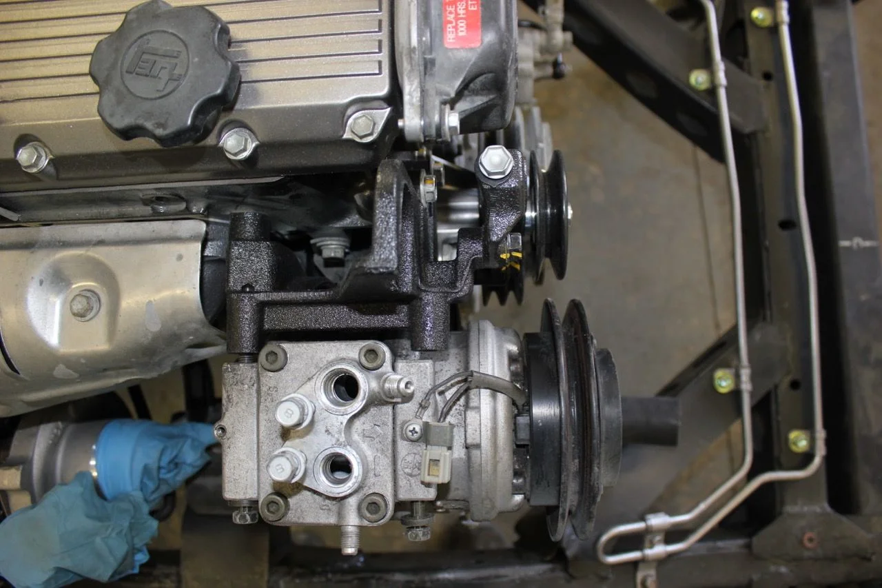

I recall some discussion about the possibility of using a 2LT-E A/C compressor on the 1HZ. Since I had one in the shop, I tried it:
As you can see, the bolt holes are not far apart enough to fit the 1HZ bracket, and the pulley is too far forward to work.
More pics tomorrow, I think. ;)
