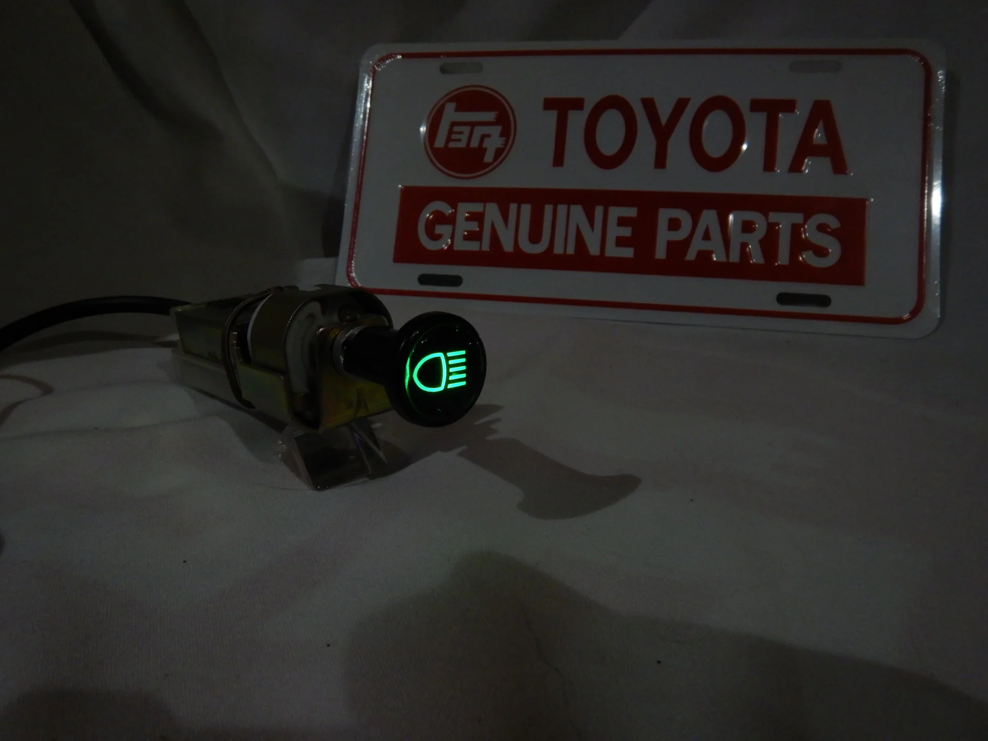

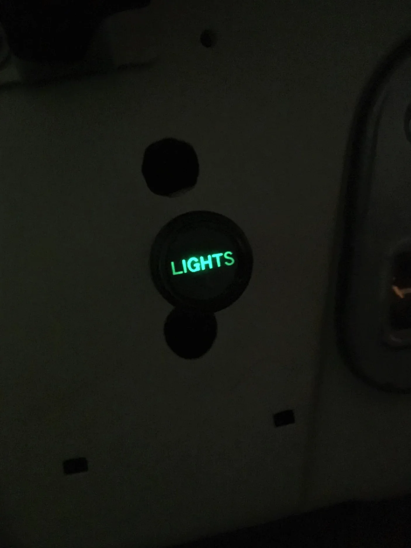

This bulb!
I used these because I wanted green. They also have other colors including warm white and white.
Ruiandsion BA7S Instrument LED Light F3 1 LED 12V DC Green Car Mini Bulbs Lamps Led Car Instrument Light Warning lamp,Negative Earth (Pack of 4)
https://www.amazon.com/dp/B07G9ZQBVM?tag=ihco-20
