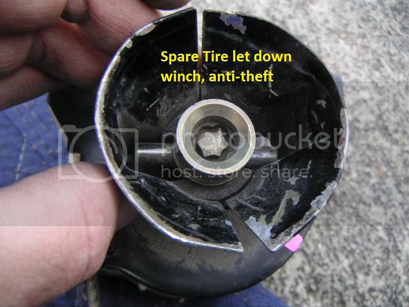

That kit would work, just make sure that your stock tire winch uses that style crank vs the one where it has a special key in it. Shine a flash light through the access hole and see if you see a slot or a star shaped key.
Even if it has the anti-theft 'key', it can be removed. It's just a piece that is pressed in the bore of the winch. I removed mine so I could use the standard 'hook' type tire let down tool.
Hmm, you must have had a different style winch because on the "keyed" winch I had, it did not have the slot inserts for the blade type winch tool. All it had was the keyed star center in the middle of the winch mechanism.
That 'star' is removable, it is just pressed in the bore. Remove the black plastic dust cover and star and the standard 'slot' will be underneath it. You'll be left with the standard slot and the metal 'funnel'.

Yes, unfortunately some Land Cruisers and quite a few LX470's had an anti-theft spare tire winch (which is nothing but a standard winch with a pressed in star key).
Just peel the plastic dust cover off of the key, hit/pry it some....and it will come right out, leaving you the standard slot and metal funnel on the winch.

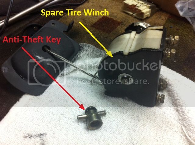

How would you suggest I try to pry out the cone? Funny enough, the LX 470 Owners manual just shows the hook insert that you stick in the cone, but in real life I found a wheel lock two feet inside the hole on my bumper. Thank god I didn't find out my wheel lock was missing while on the road! Anyway, I am missing this stupid key and frankly I could do without it. Is there a way to remove the parts you mentioned, while the wheel is attached? I just want to have access to my spare tire, you know, like normal people would.

I went through this fiasco a year or so ago. I ended buying a winch from a fellow mud member who had moved his spare to the bumper. I even went to the local Lexus dealer and they were absolutely clueless about the key. You may want to look on the part out forum in the classifieds. Someone may have a spare key they'll sell.

I don't see an easy way to access the key without having the winch removed and on a bench.
It is just pressed in place and held with a star shaped thin metal washer. The design of the washer is such that it makes the 'key' difficult to pull straight out, but you can grab it with a pair of pliers or hit it with a drift punch and hammer and move it side to side). This will deform the star washer and allow you to remove the key. There is nothing to do after that.... since the requisite channels are already in the metal cone to accept the hook on the let down tool (same hook end that is used to operate the jack).
I was able to reach over the top of the tire and using a ratcheting wrench...remove the four bolts holding the spare tire winch. Others have removed the bolts on each side of the supporting cross-member and then wrestled the entire thing out...but I found it easier to just do the winch.
