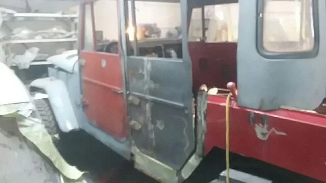

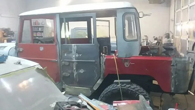

This is a custom build that I am working on. I am new to this forum and could use a lot of help. I bought this machine from a local guy that took a 67 fj40 body and threw it on a 2007 fj cruiser chassis. I loved the idea of having the look of the fj40 but the durability and comfort of a newer machine. Seeing that the body is longer on the fj cruiser, i decided that I could fit 2 more doors on the fj40 and make it a 4 door machine. I may have bit off more than I can chew, but I hope that it works out.

So far the overall stance looks good. Others I have seen have the wheel base vs. wheel arches completely off. Proportions seem to be correct also.
Do you have more pics of the original 2 door version? It looks like the previous owner did a nice job on it.
Did you cut up the original 2 door extended tub or do you still have it? I'm asking because I'm interested in buying it if you saved it.
It appears he cut up the 2 door tub to make the new one. The 2 door looks like it has less taper from the windshield back to the b pillar than a stock tub. A flat sided 40 is about 48" wide so that can't be the case.

Looks like the front axle needs to move forward about 3 or 4 inches to match where a fj40 front axle sits. Where you have it now is not where a fj40 axle sits in proportion to the front wheel opening. The front wheels in their current position looks like it was in a accident or has a bent frame or something. If you move the control arm mounts and strut mounts it would fix that.
Good eye, I actually moved the body forward a few inches so that I had more room in the engine compartment as well as created more room in the back seat area.
Remember this is the combination of two different vehicles so some concessions will have to be made.
As long as there is clearance for turning and vertical travel I see no problem. While it does look different I don't think it looks bad.
The more I look at it the more I like it.

If you moved the body forward, it make the front axle placement looking weirder
The front tire must exceed the front bib to look right IMO
This!:cheers:
A simple solution to the front axle placement is a solid axle swap. Looks sick otherwise man.
