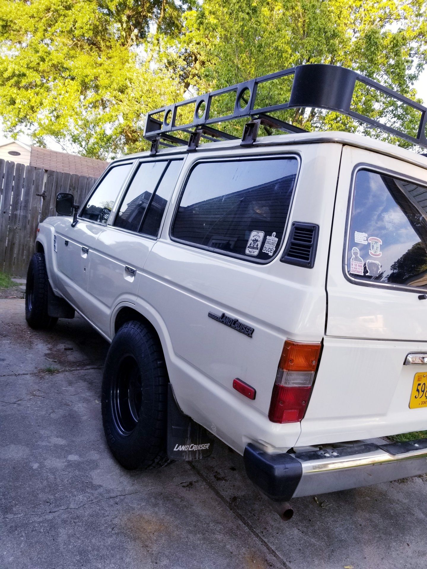

Finding wheels for the FJ60 was a pain! Thanks for everyone that’s posted here, it sure helped! I decided to go with the TRE Pro wheels! I didn’t want to use spacers and couldn't find the right back spacing. They are wrapped in 265/70/17 Toyo A/T 3. Had planned to go with 275/70/17 bfg ko2 but, it only gained 1/2 inch and were $55 more per tire.
Nice looking to do this same wheel...So, I assume you needed spacers...what size are they? Also mine me asking about what looks like a 4plus bumper? Did he also build the ladder? Mine didnt come with that option is all....thanks

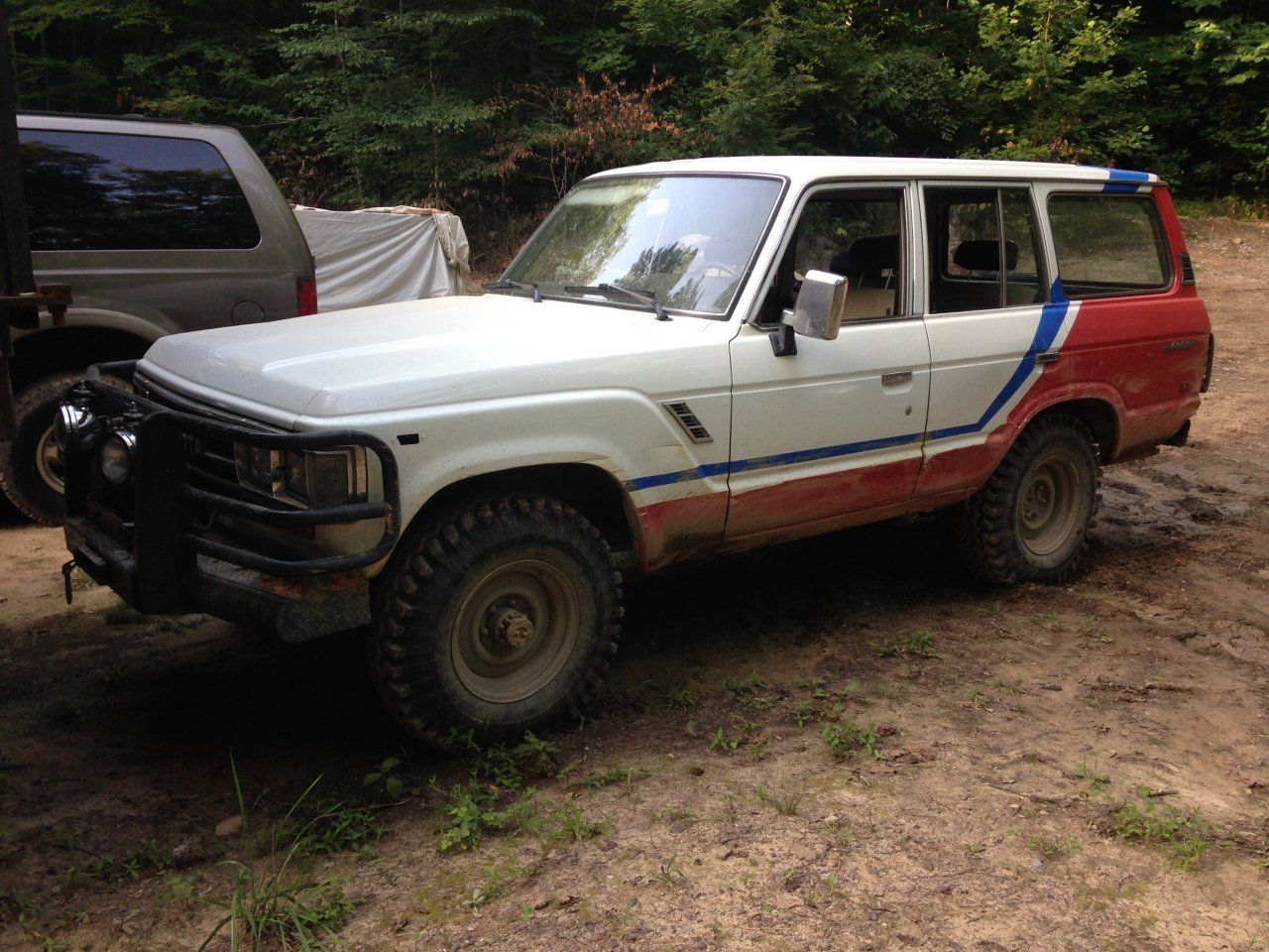

and picture of my rig so you can visualize.....thx
The 309 for sure of the two. I have the same set up and run 285/70/17 stock FJ Cruiser wheels with 1.5" spacers. No rubbing. I do happen to have TLC calipers from a donor v8 swap a few years ...dont ya just love the v8? Gosh, now its my daily...having it rebuilt as we speak. Betsy Build if ya wanna follow....

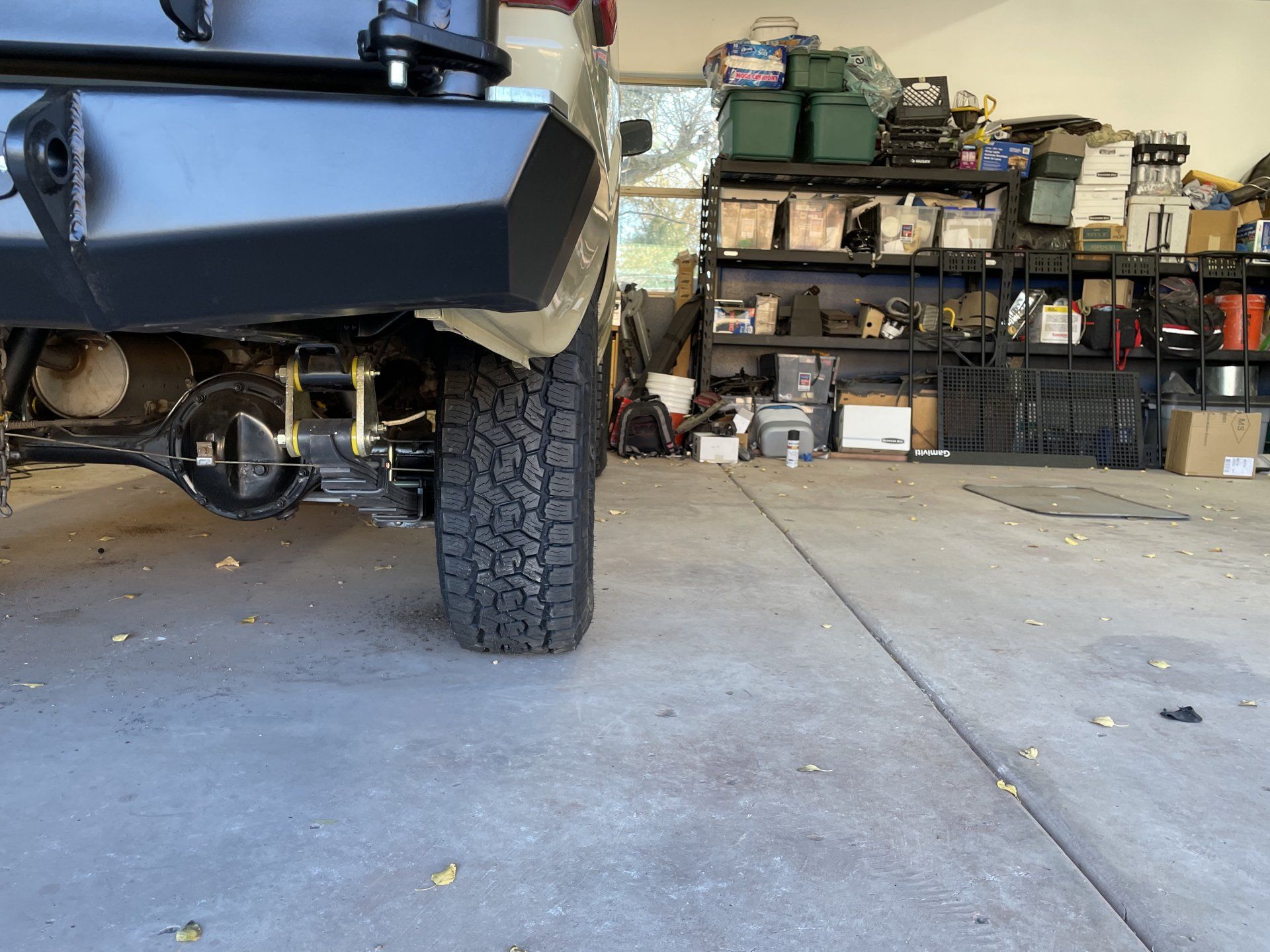

Unless my eyes deceive me, your anti inversion rear shackles are up side down and could damage the leaf spring under full compression (can't see the front).
