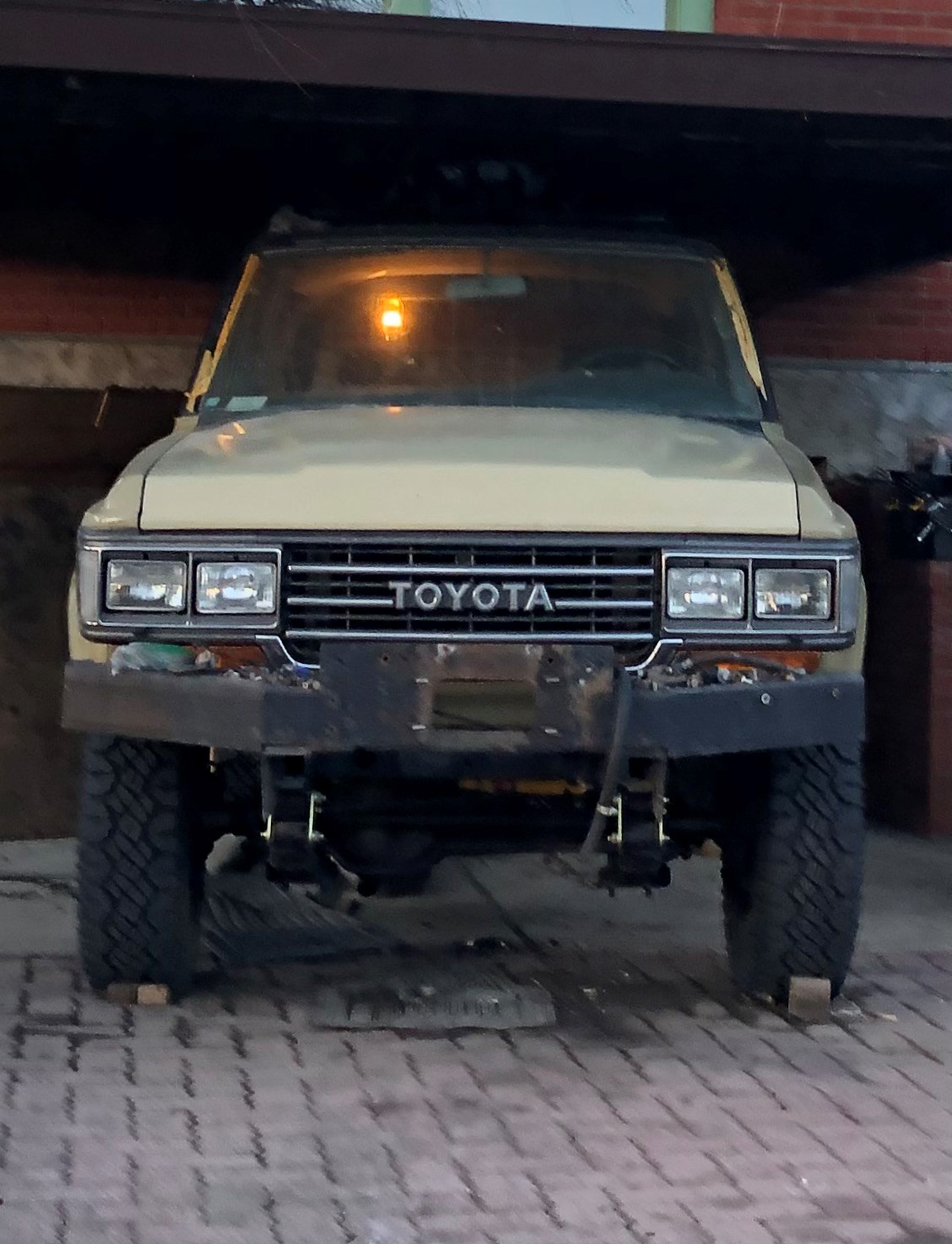

I recently picked up an 89 and the current wheel tire setup is not ideal. The current wheels has some rust and the tires are about a decade old so I really don't want to drive it anymore until I get I safe to drive around. I'm not looking for anything fancy as it just needs to be safe and looking to get something in stock specs so I know it will all work fine. From my quick googling I can tell I need 15 inch rim, 5 on 5.5 bolt pattern, 3.25" backspacing, and a center bore of 106mm but seen a few posts around that have some conflicting info

Yeah might get some 16s. just wanna make sure I get something that won't hit the tie rod ends, seems like that's the main concern from reading around.

yeah that would be ideal, but trying to be very budget friendly + getting is safely moving asap is a priority.

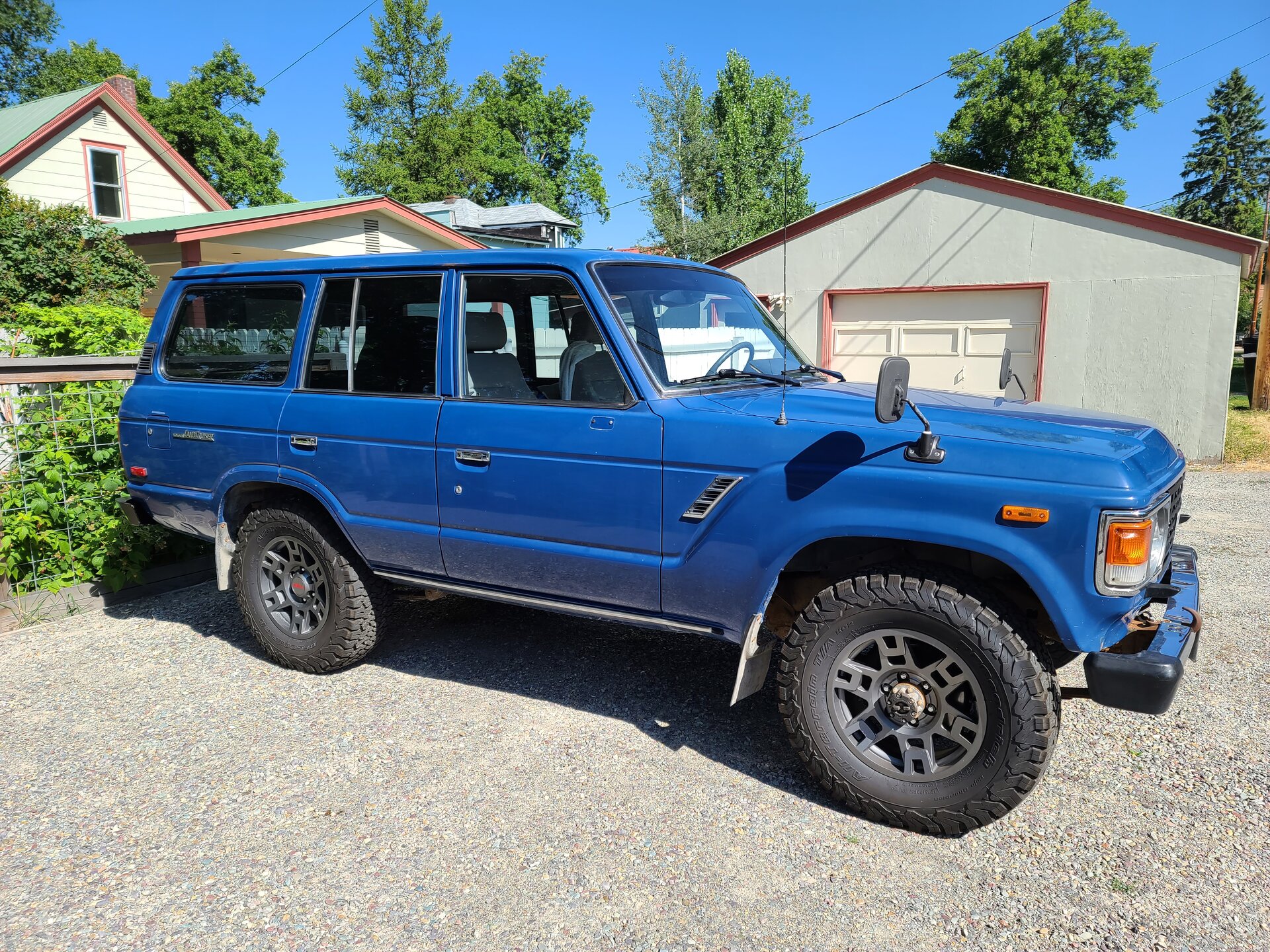

I run a 255/85r16 for a 33”
You can use a 235/85r16 for a 32”

The stock 15" wheel wheel is 6" wide, with offset of -15 (ET-15). The 70 series wheel is about the same width ( think) but has an offset of 0, so it sits inward about 3/4 of an inch (or 15mm to be precise) compared to the stock wheel. I run the 70 series wheel and I personally like the look with tall skinny tires. You could get a more stock look with some spacers. A wider tire such as the ones @HemiAlex is running also makes for more of a stock look.
I actually run mine with a 1.5" spacer all around.
