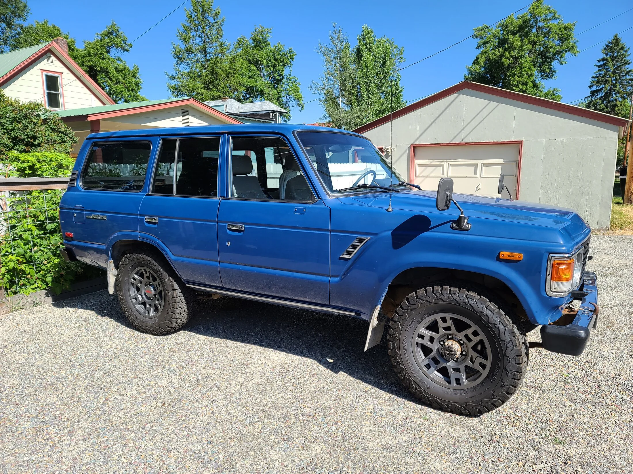

You might oughta consider keeping the stock until you upgrade your brakes (Tundra Mod). Then your options will increase because you will be swapping to 16-17" inch wheels. but personally, I think the stock wheels with 33x10.5's KO2's tucked under has a special look and works really well. Not many of the new wheels look right or fit well.
after looking at waay to many modern wheels, I agree. Nothing I see looks better than stock wheels with KO2s. I'll just swap my chrome wheels for black/gray steel wheels. thanks for the help.
something like this with the center ring/cap.
