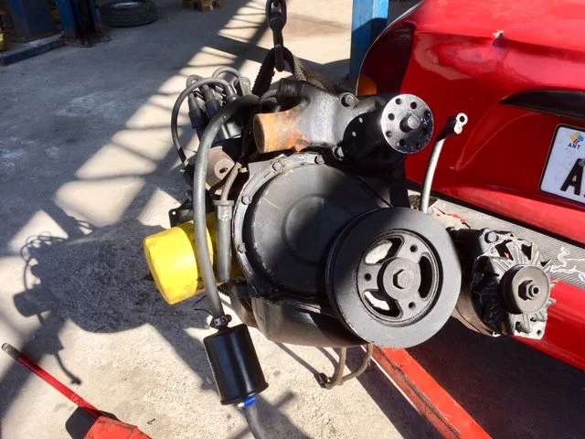

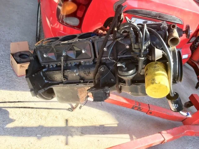

I forgot that i took these two photos after we pulled the motor and removed the head. Anyone recognize it. I'll post better photos when i get the motor back.
Hopefully you’ll be able to get new pistons and parts. Whereas a parts for an F motor has become obsolete and many parts are no longer available.
Plan on rebuilding the transmission and transfer case now. That GM motor has a lot more poop than the original Toyota one, and things need to be snug in there or they won’t last long with that extra power.
A lot more??? Not saying you shouldn’t rebuild them, but if they stood up behind V8s why the concern about a 155hp l6?
Three speeds have been said to be marginal behind a V8.... but I ran a 300 hp V8 in front of a 4 speed for twenty years, and now have a 200 ish hp V8 in front of it. The ‘72 350 was only rated at 165 hp with a Rochester Quadrajet..I’m curious to know where it sits now (RV cam, 1406 edelbrock...)
