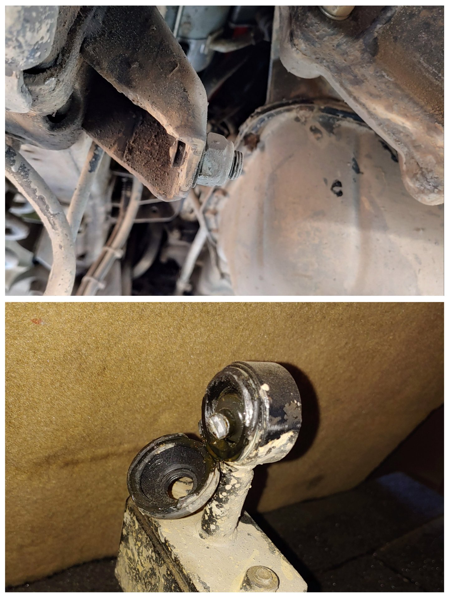

What did your have to cut? I had to cut off the two corners on the bar ends, they hit the bracket and the bolt wouldn't go through. Hole was about 1/4" off. The OEM bar end is round, Whiteline is square. Don't know why Whiteline doesn't make them round.

Just wanted to give a PSA for running HD sway bars up front and the ticking time bomb that is the passenger front sway bar mount. This mount will rip itself away from the axle housing and during this process it'll cut your front passenger hard brake line. If you like to twist up the suspension while wheeling, I highly suggest getting a front quick disconnect in order to prevent this. I also suggest purchasing this five inch short piece of hard brake line and stashing it in your spares kit. Not just for you but for the other 80 dude who needs to get home after running the trails with you.
This has happened to 80 owners who are also running the stock front sway bar. The weld in that area on both sides aren't super stout and the mounts tear themselves away due to fatigue. Landtank does sell HD front sway bar mounts that replaces the wimpy oem mounts but they need to be welded on, or make your own.
It's also easy to make your own front sway bar hanger (under the driver side chassis area) or ping landcruiserphil for his product, not sure if he still sells them.

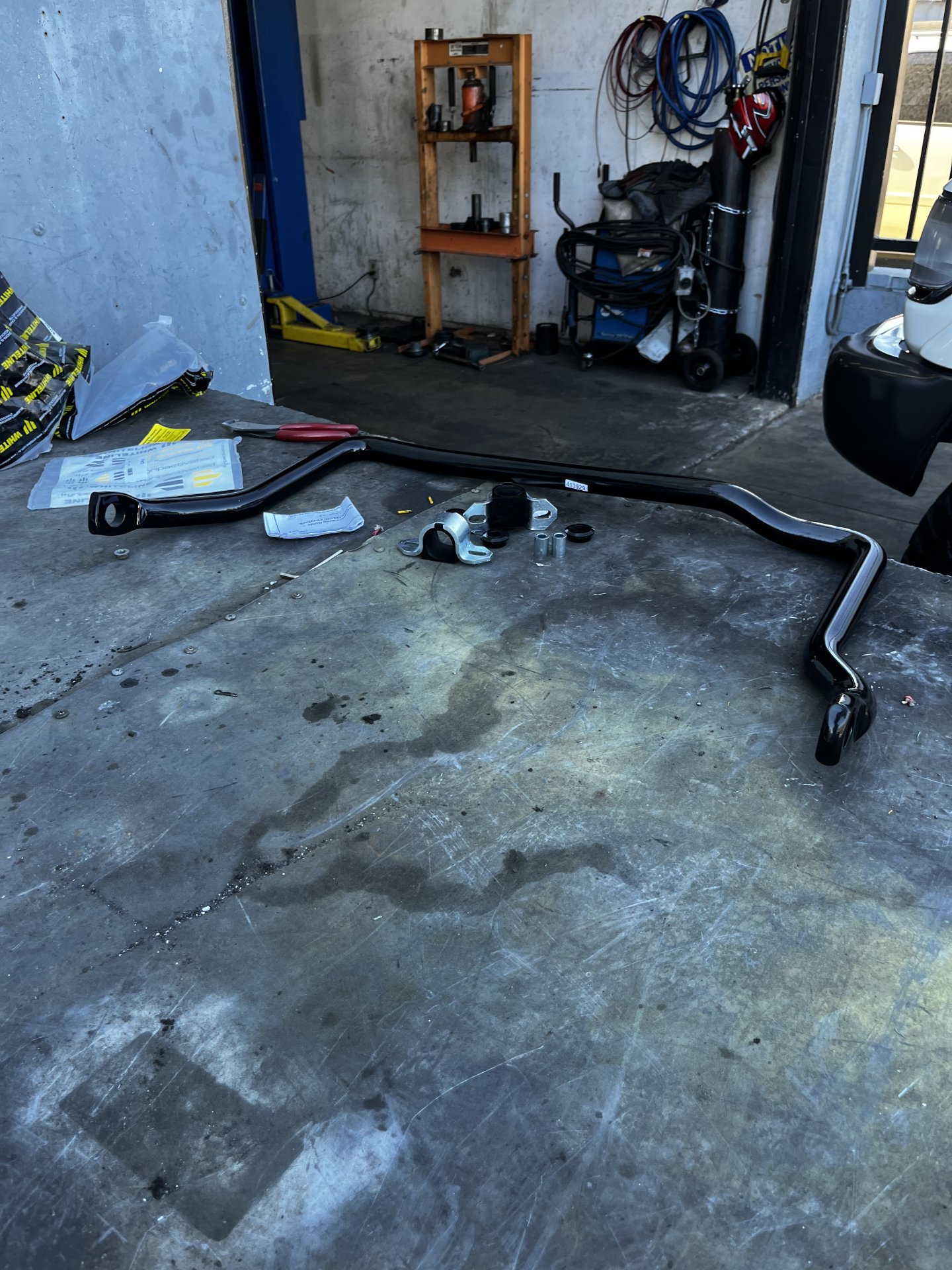

I ordered the WHITELINE HD 30mm rear sway bar and will go the stock front route with LCP sway bar disconnect and LCP HD rear sway bar mount.

I just ordered a WHITELINE HD 30mm rear sway bar amd gonna keep the front OEM sway bar. Add LCP sway bar disconnect and his rear sway bar HD links.
