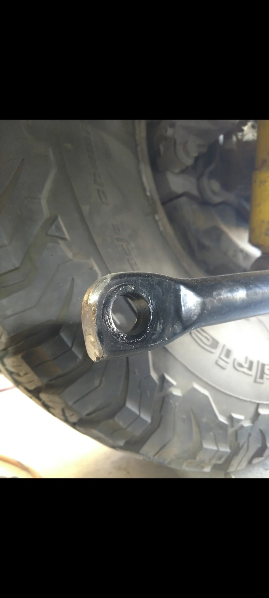

I had to grind my back whiteline a bit to prevent binding but if I had the @LandCruiserPhil links which are on the way it wouldn't have been an issue.

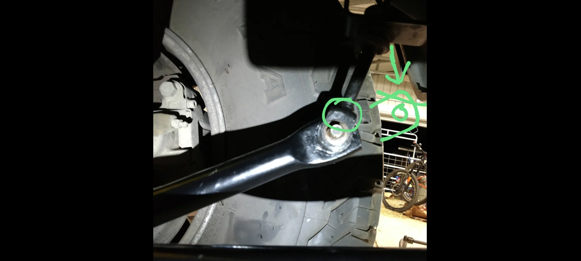

Depends, your stock links will work fine if your not flexible a bunch, and your lift. Ideally you want the new sway bar just above the rear lower control arms. Lots of Mud on this subject
I went with 100 series extended links first go around and the Rubicon ate those alive. I could go with slee drop brackets and new stock links but the Land Cruiser Products - LCP - Severe Duty Rear Sway Bar Links - https://sites.google.com/site/landcruiserproducts/severe-duty-rear-sway-bar-links are the bees knees.
In the photo you can see my rear whiteline bar is high.

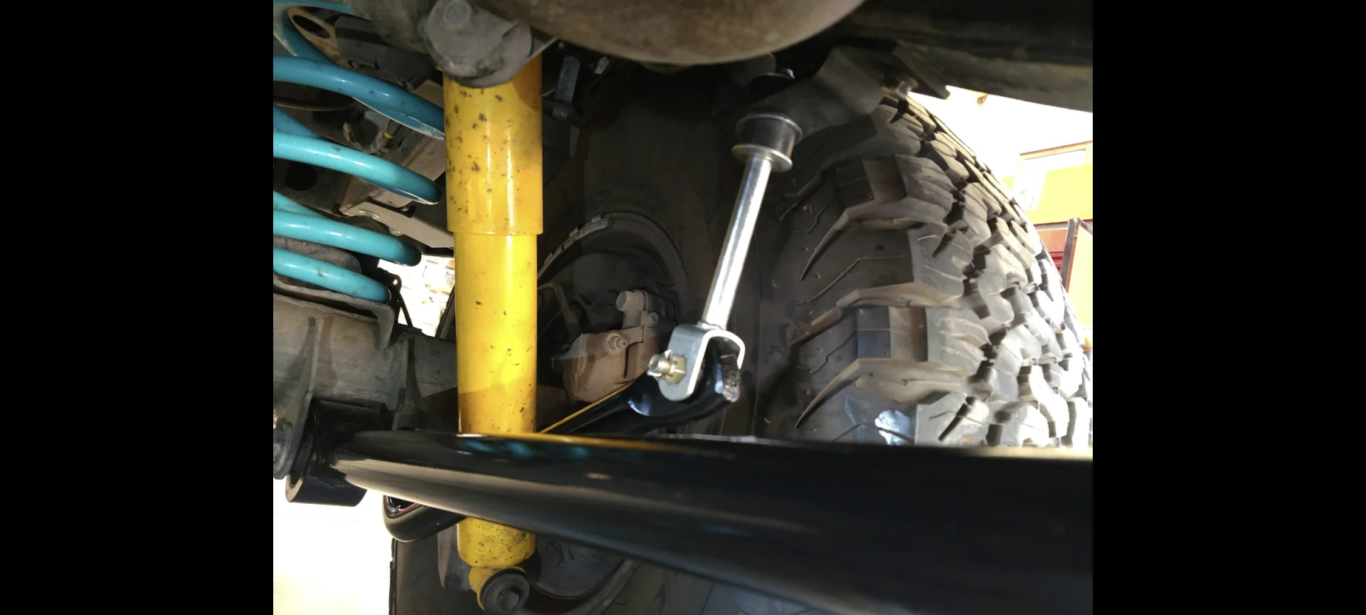

In this pic, which link are those? They look quite lovely but a tad too short.
Those are 100 series links 1" longer. With my 3" lift they are to short.

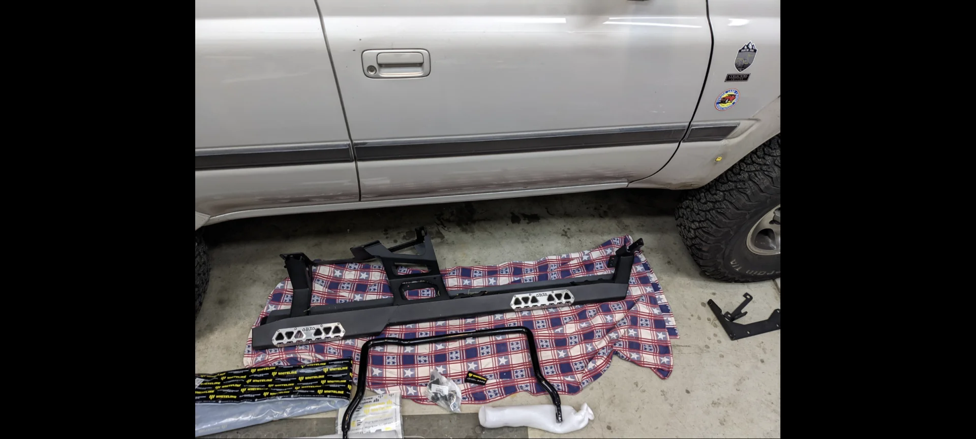

Projects for the weekend lined up, new sway bar and @Delta VS passenger side slider.

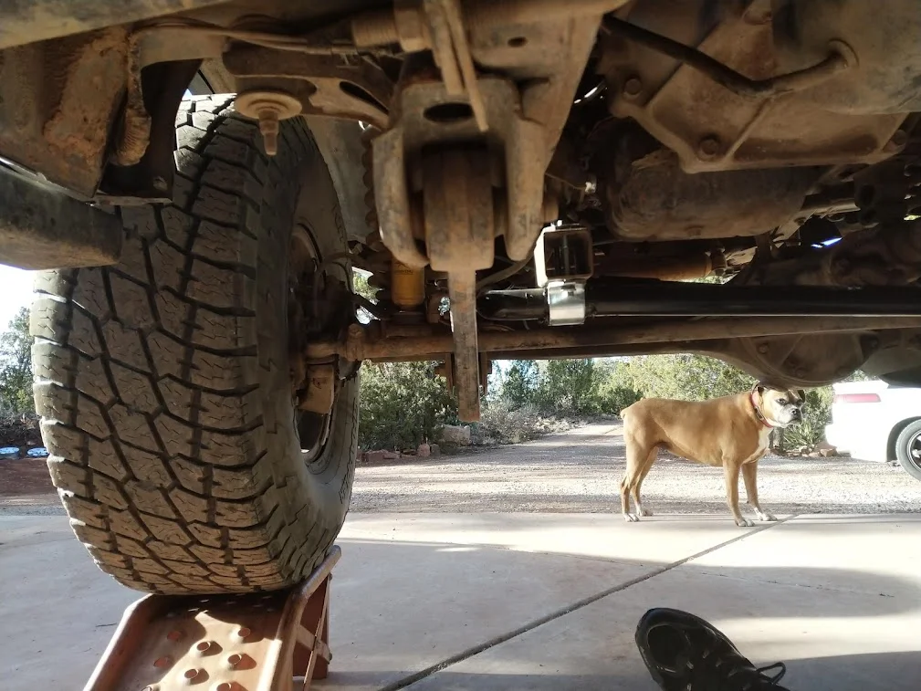

I had a guard dog on duty to make sure I wasn't too vulnerable while doing this project :rofl:
