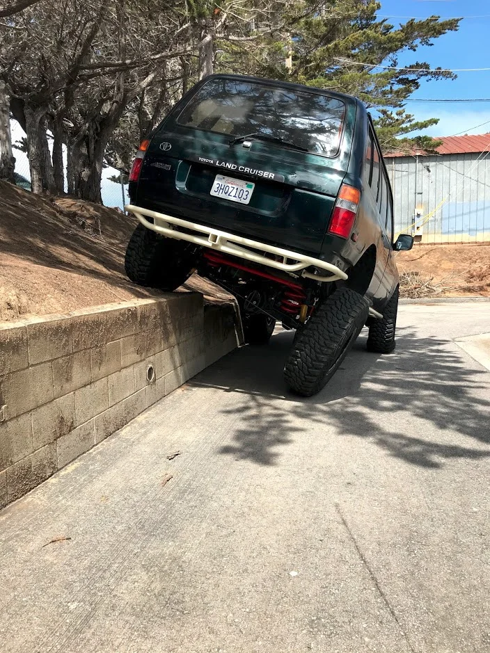

After five years of running with no sway bars, I have installed the AnitRock rear Sway bar (RKJ-CE-9906-21) It has made a big difference in on and off road driving.
Just got back from a 5 day trip on the Rubicon. With the new sway bar I saw no loss in articulation , way more stability in off camber situation and a nite and day difference in on road handling on the 90 mile on road trip back around to the tow Rig fully loaded with gear.
In short I was wrong about the sway bars. The Reg feels much safer, more stable on and off road with the new rear sway bar !!!
