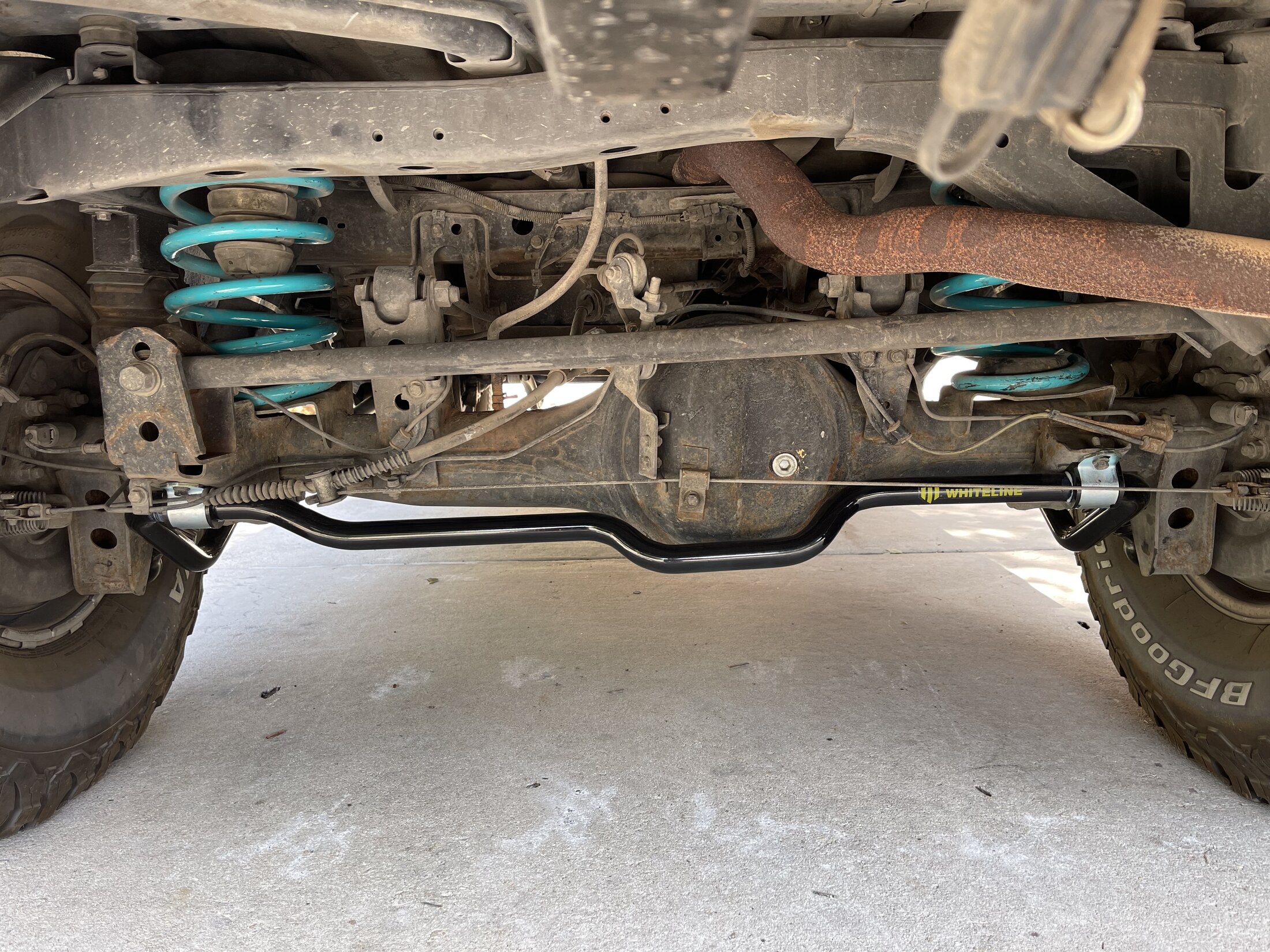

I got my Whiteline rear bar installed yesterday and it is a major improvement over the stock bar. I ordered direct from Whiteline Performance and it arrived in less than a week with free shipping. The ends of the bar are now coming rounded so no modifications were needed when installing. I’m considering adding their front bar (plus front LCP disconnects) to help with road manners while still having the ability to flex offroad. Has anyone installed one of the front bars recently? Any fitment issues? I’ve got 2.5” of lift all the way around and I’m running stock links that I sleeved to extend about 2” and I frequently drive with a canoe on the roof or with roof rack boxes while traveling to camp/hunt.
For all those that installed the front, did you have to slightly spread the front brackets sitting in the axle?
I'm sure my bushings are well seated at the bushing shoulder but I can't quite get them low enough to fit the bolt neck through.
