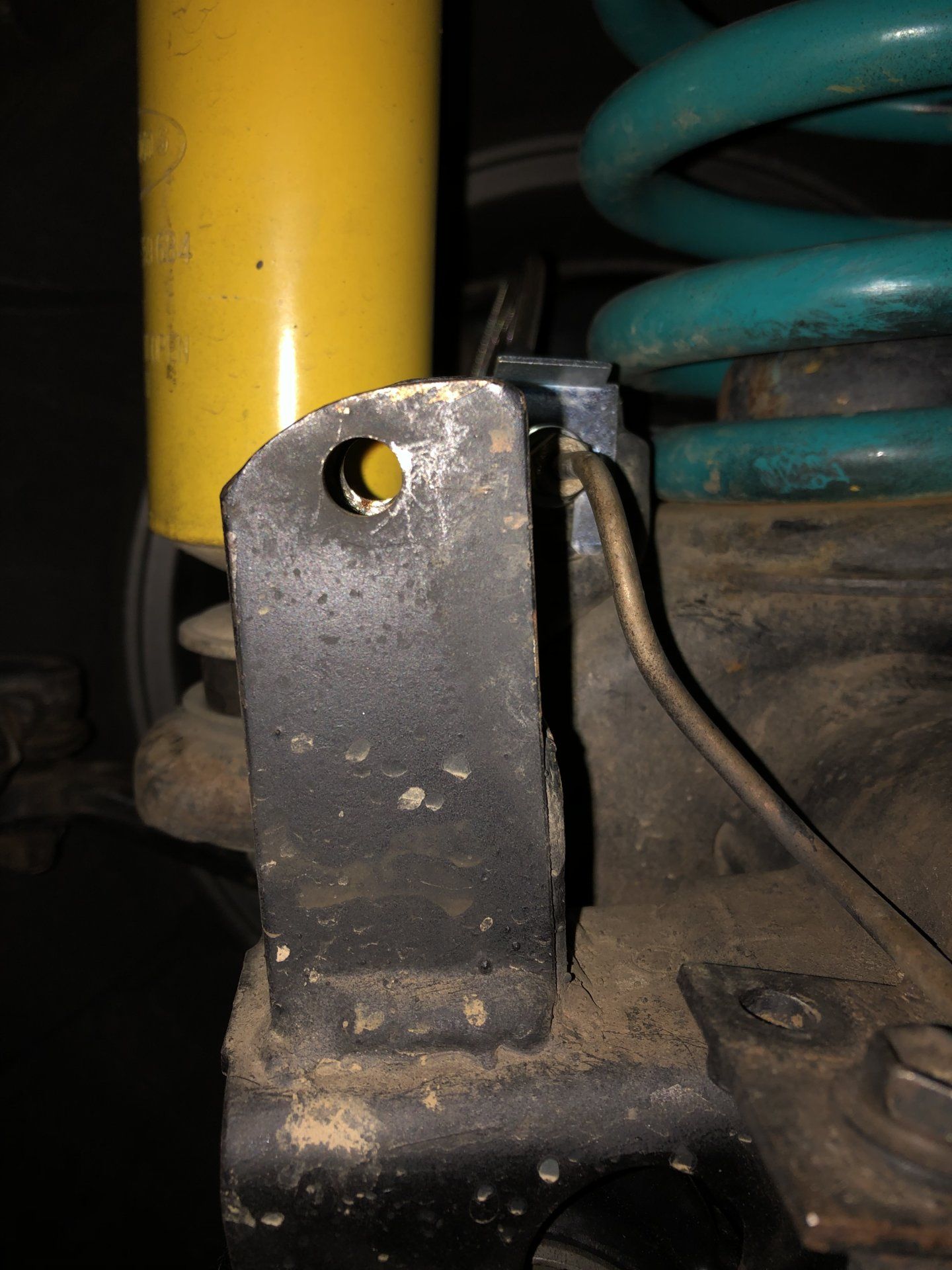

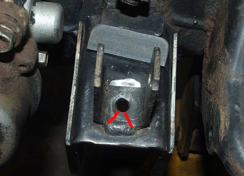

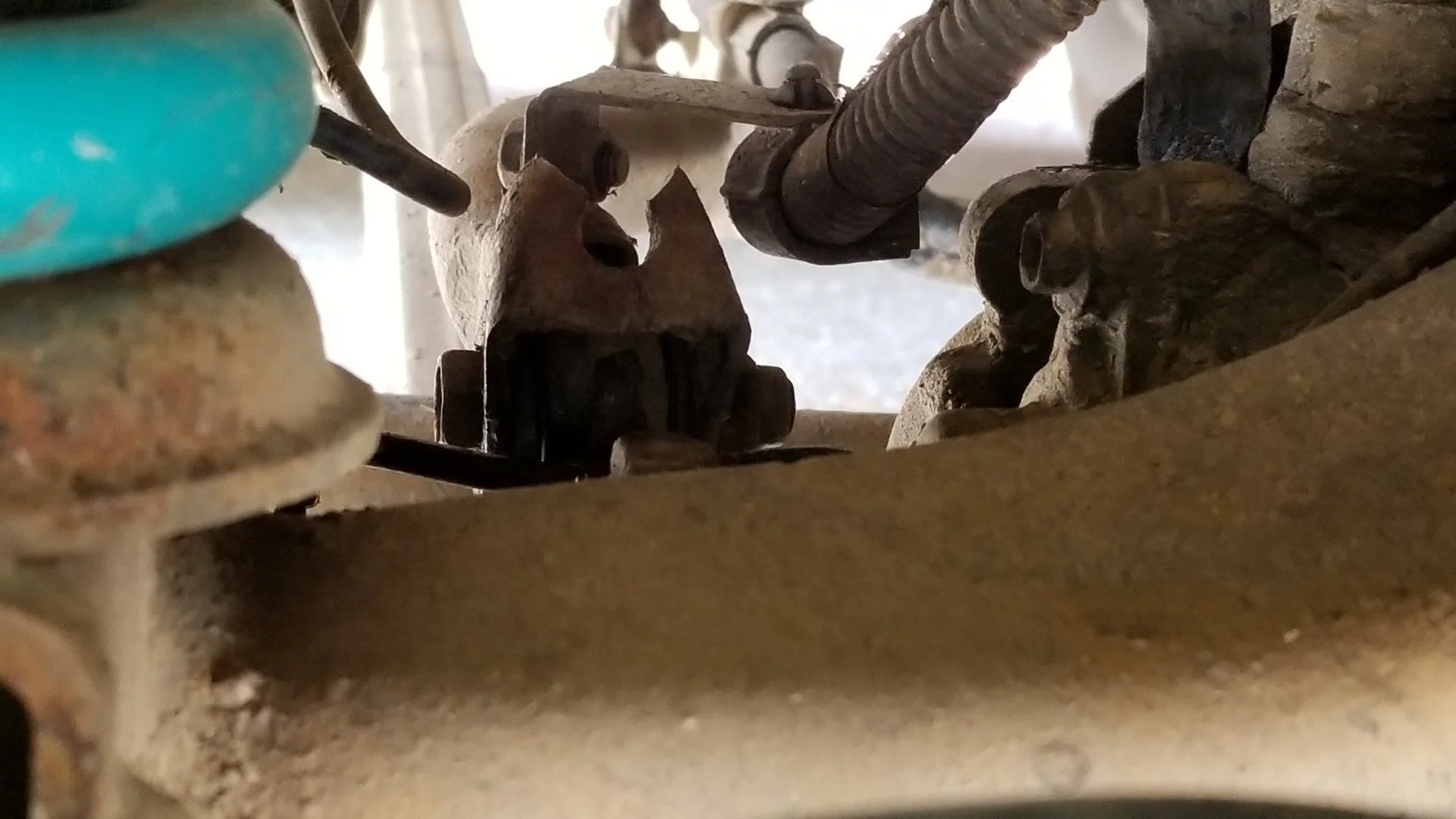

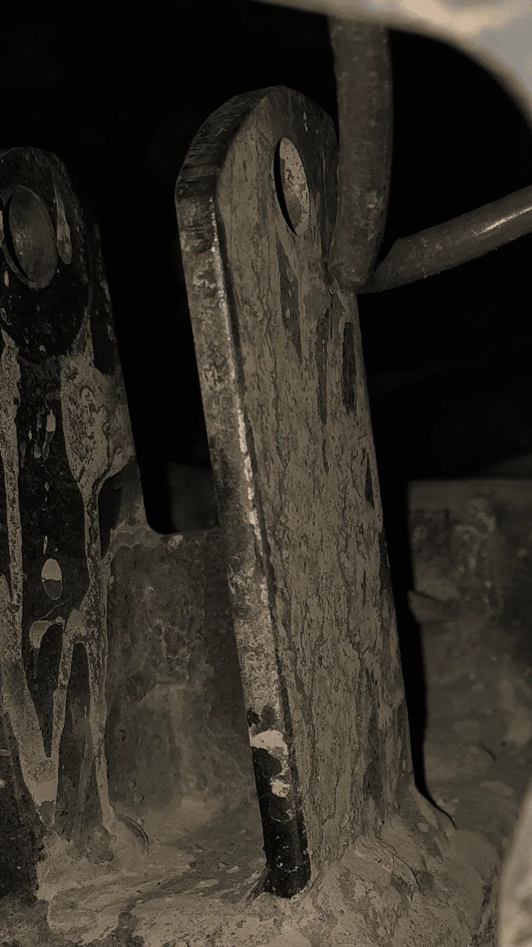

So I noticed some odd sounds last time I was out wheeling (5/11), but I was unable to isolate what it was or where it was coming from exactly. It was the first time out since doing the head gasket so I was much more focused on temps and no leaks. Anyway, after a quick drive on the highway today it was apparent something wasn't right. I had a rattle at speed and the truck felt like it was wandering. It was breezy out, but this felt like more wander than just that. I got to work and expected to find loose knuckle nuts and found this instead.

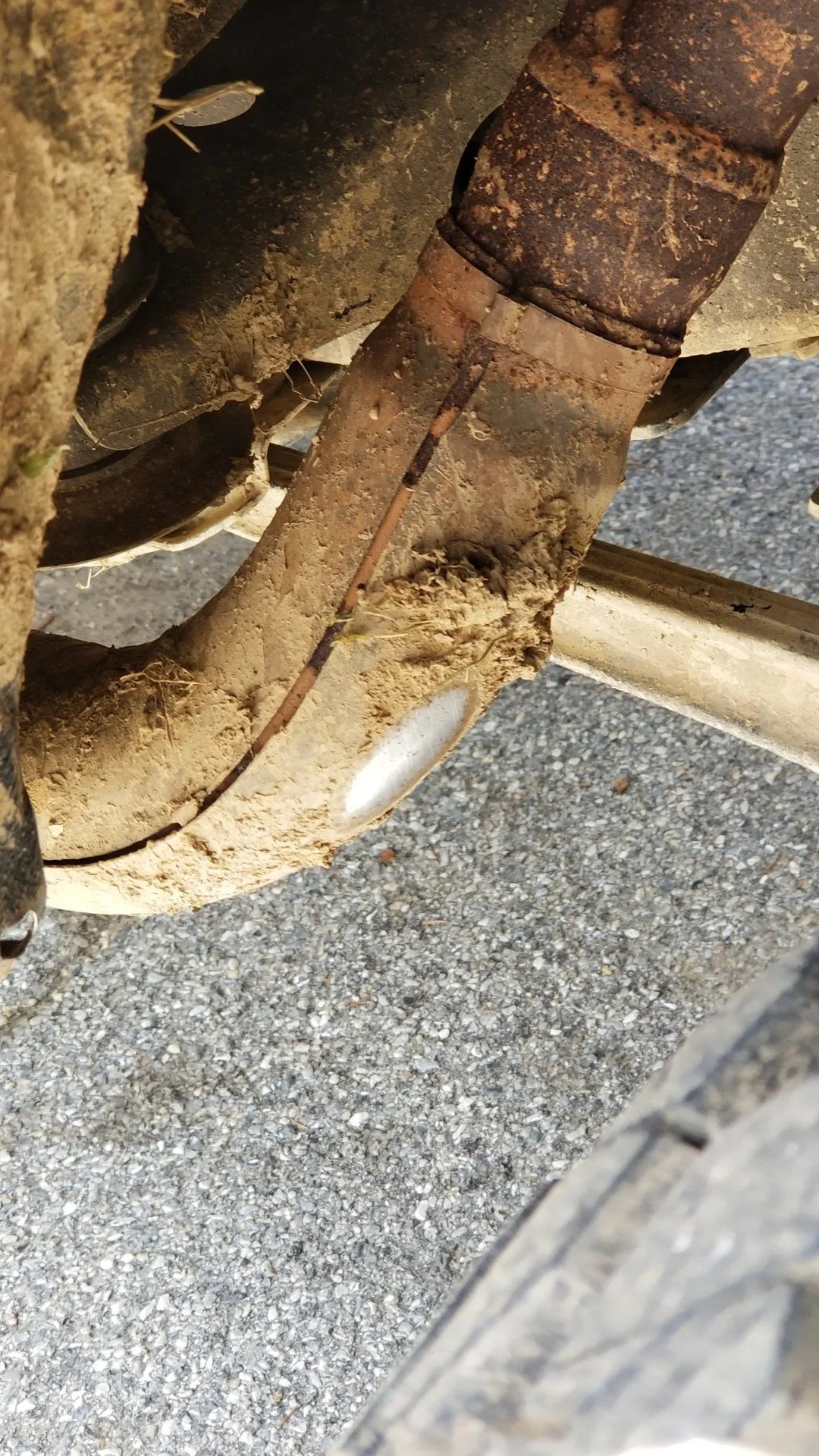

Never good when a muddy truck has a bright clean spot. I thought I heard some rubbing when parking it in the driveway, but it normally doesn't rub there. Knuckle nuts were good and so were control arm bushings. I grabbed the sway bar and it moved ... a lot. Checked bushings and found the issue. The pass side mount to the axle has snapped off. I was clean at work and truck is covered in mud, so didn't check if the bolt is sheared off in the axle or not yet.
Did some research and this seems to be an odd spot for this to fail. Some people said they run without the front sway and that would be a last option, but here in PA it's 10 miles of highway minimum for me to go anywhere quickly and 90 mins highway to get to the wheeling spot with winding roads and elevation changes everywhere. The truck is a '97 so it should have the updated mount hardware. Is this a replaceable part or does it need to be welded back onto the axle? Have others that have had the same failure seen it as a repeating issue?
I'm just now getting more comfortable with my truck in terms of wheeling it, so the use is only going to get harder if anything. Just want to fix it once and done if possible.
Bump to the top ... no input here?
It's hard to tell from your ONE picture that shows anything at all as to HOW it broke.
How about more pics?
If it's the hanger bracket, buy the new link.
If it's the bracket ripped from the axle housing, weld it back on.
If it's the end of the sway bar broke off, get a new sway bar.
If YOU cannot get under the truck to take clear pics of the break, how are WE supposed to diagnose it FOR you?

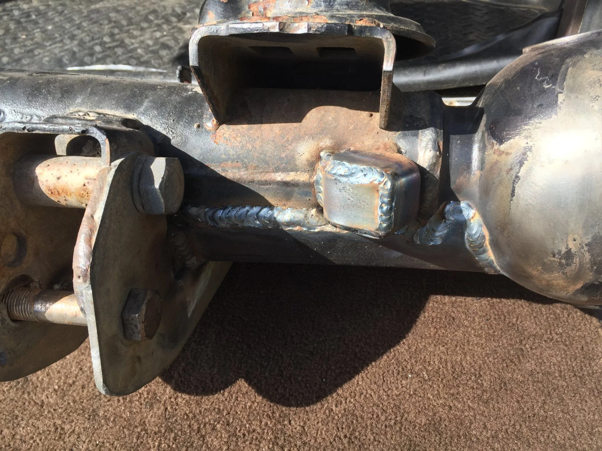

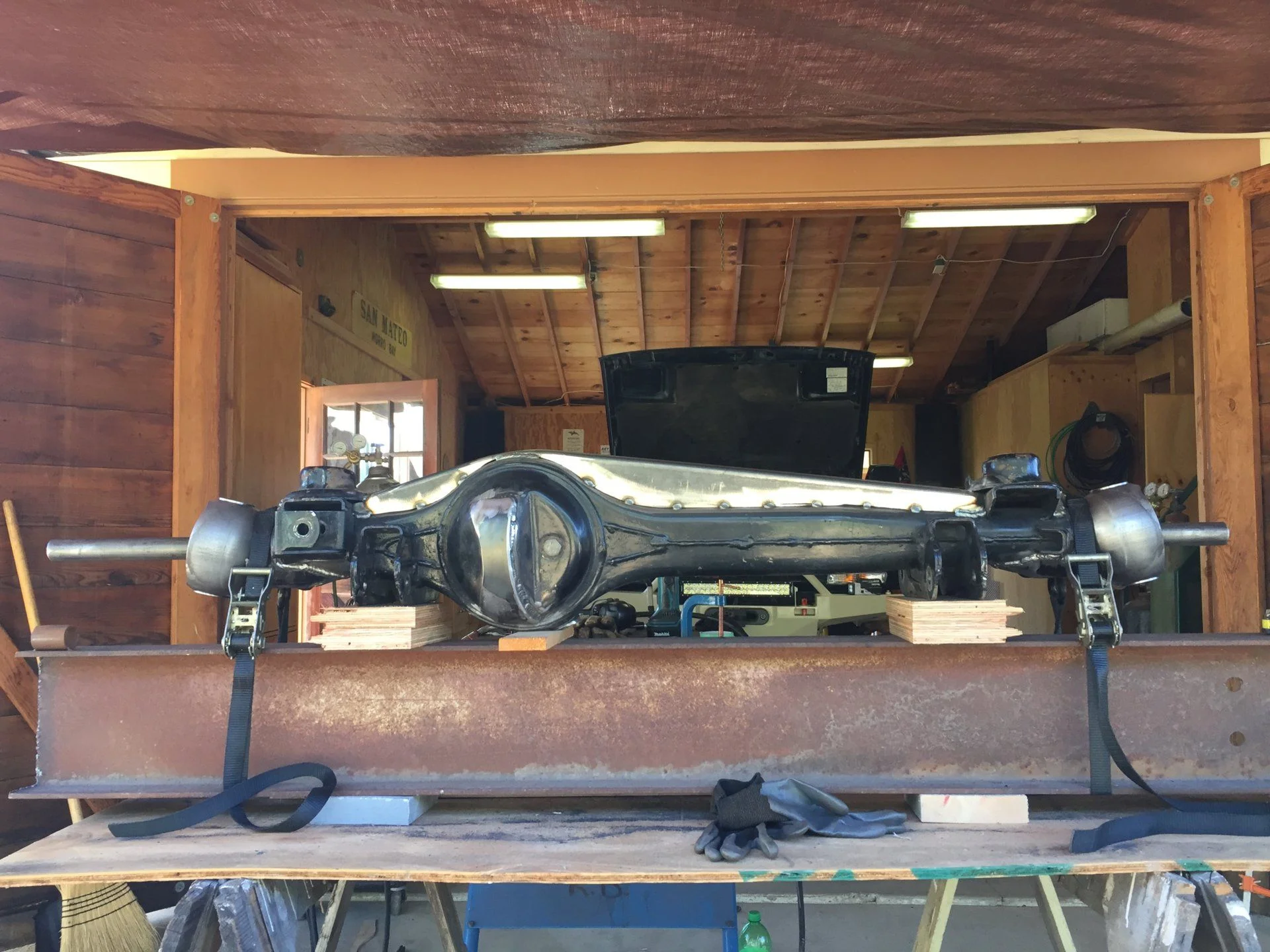

Common deal, the mount doesn't have much weld and gets ripped off. When doing a lift job, we fully weld them up and add a gusset.

Thanks guys now I know what direction and possible options I can look into.
@BILT4ME I only had the ONE pic because I assumed others had this failure before and would have known what they were looking at.

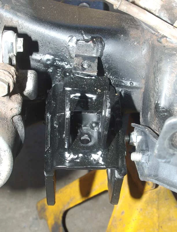

Just recently went thru this on my '97. Didn't have time to mess around so went the Landtank route thru Wits' End: Heavy Duty Extended Length Front Sway Bar Tabs

I prefer both sway bars for highway in that I have to go over two suspension bridges to get anywhere. I switched to whiteline sway bars and promptly ripped the mounts off the drivers side front axle and the drivers side rear axle (the rear I pulled one bolt out). I got a set of the witts end heavy duty swaybar mounts and welded them in for the front swaybar, I also have a set of the landcruiser phil front swaybar disconnect brackets. I had to drive home from the outter banks to RI with the front attached to those. I disconnect my front if going offroad and plan to run with the rear on unless for a multi day excursion offroad then I will just remove and store until I get back on the road. the rear I fixed by tapping some 3/8" bar stock and welding that over the old mounting area.

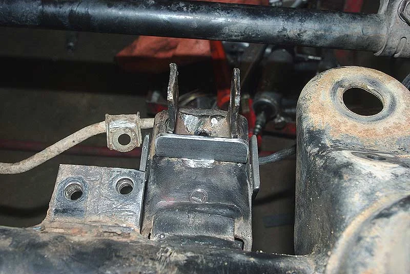

After minimum 22 years my customers are starting to see this occur more and more. Yes this takes care of it but does require cutting off the old ones and welding on these:
How much longer than stock are these Joey?

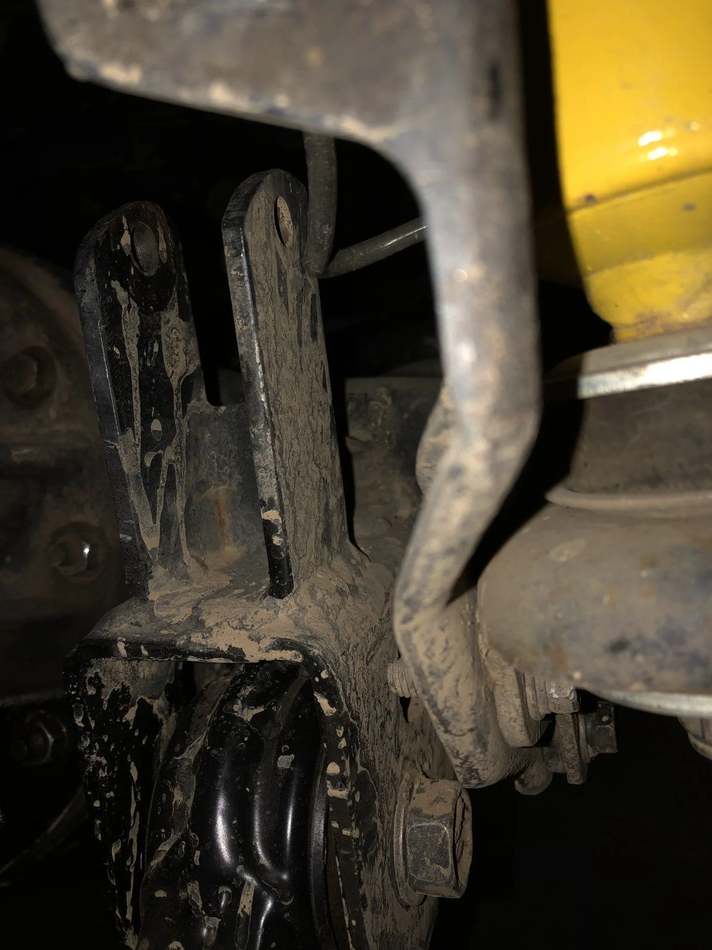

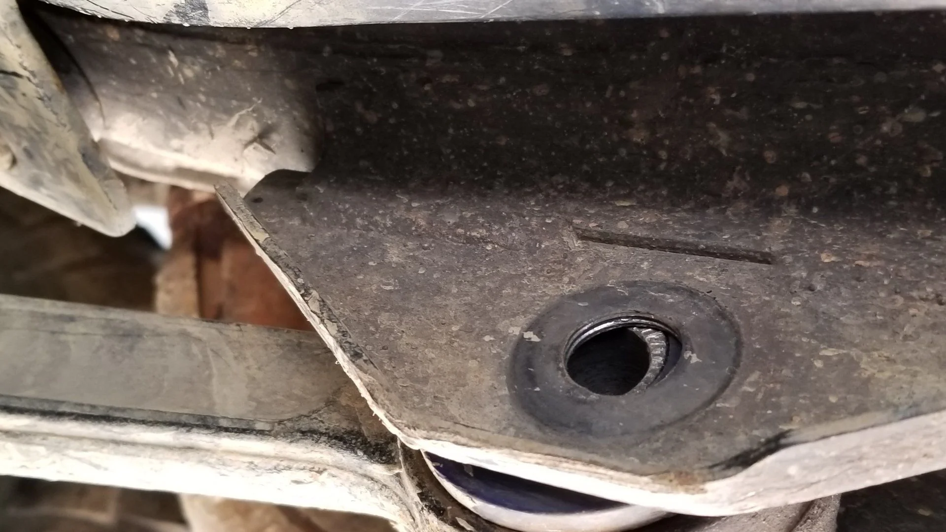

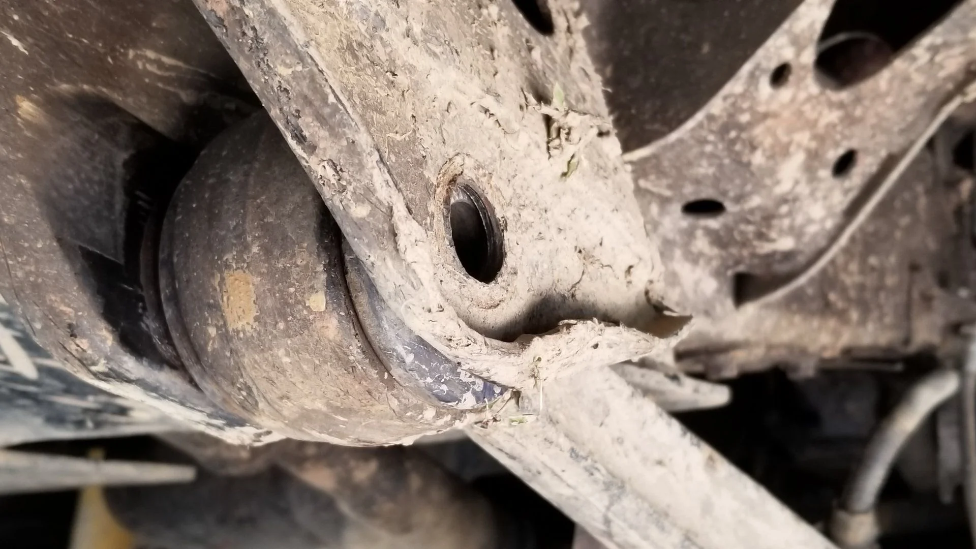

It's supposed to rain hard later today and the truck is very muddy so I went to remove the sway bar so I could drive it and wash it off a bit and found another issue.

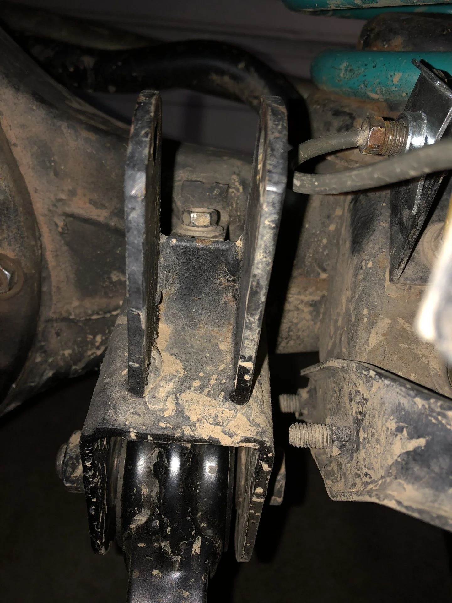

Just the rear bolt missing from the pass side control arm ... no big deal 😵
This seems like it would have been the cause of the sway bar retainer breaking off? A huge THANK YOU to @Pacer for seeing the rubbing on the exhaust and telling me to look for a larger problem. I'm sure he saved me from larger damage.

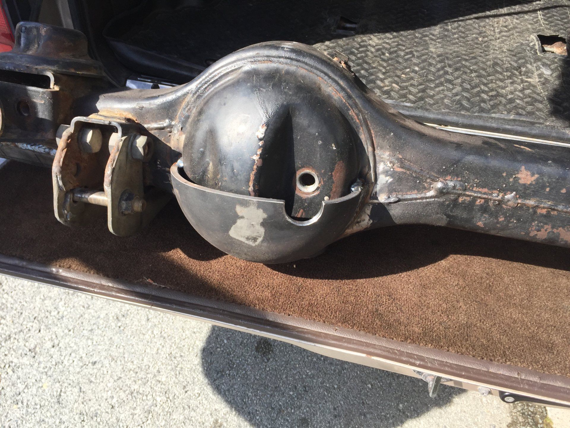

While you are down there may as well do everything short of upgrading/replacing the entire axle housing. Anti-sway bar brackets are welded, axle is gusseted, dif cover is armored, steering stops are boxed, castor plates are burnt on. If I had to choose only one of these mods/reinforcements, it would be reinforcing the anti-sway bar brackets! Even though my brackets are reinforced, When I am rock crawling I pin them up (I have a home made system fabbed from angle iron that is almost identical to Phil's) Swaybar Disconnects - Land Cruiser Products - LCP. I prefer the ant-sway bars connected in the sand or mere rough roads.
