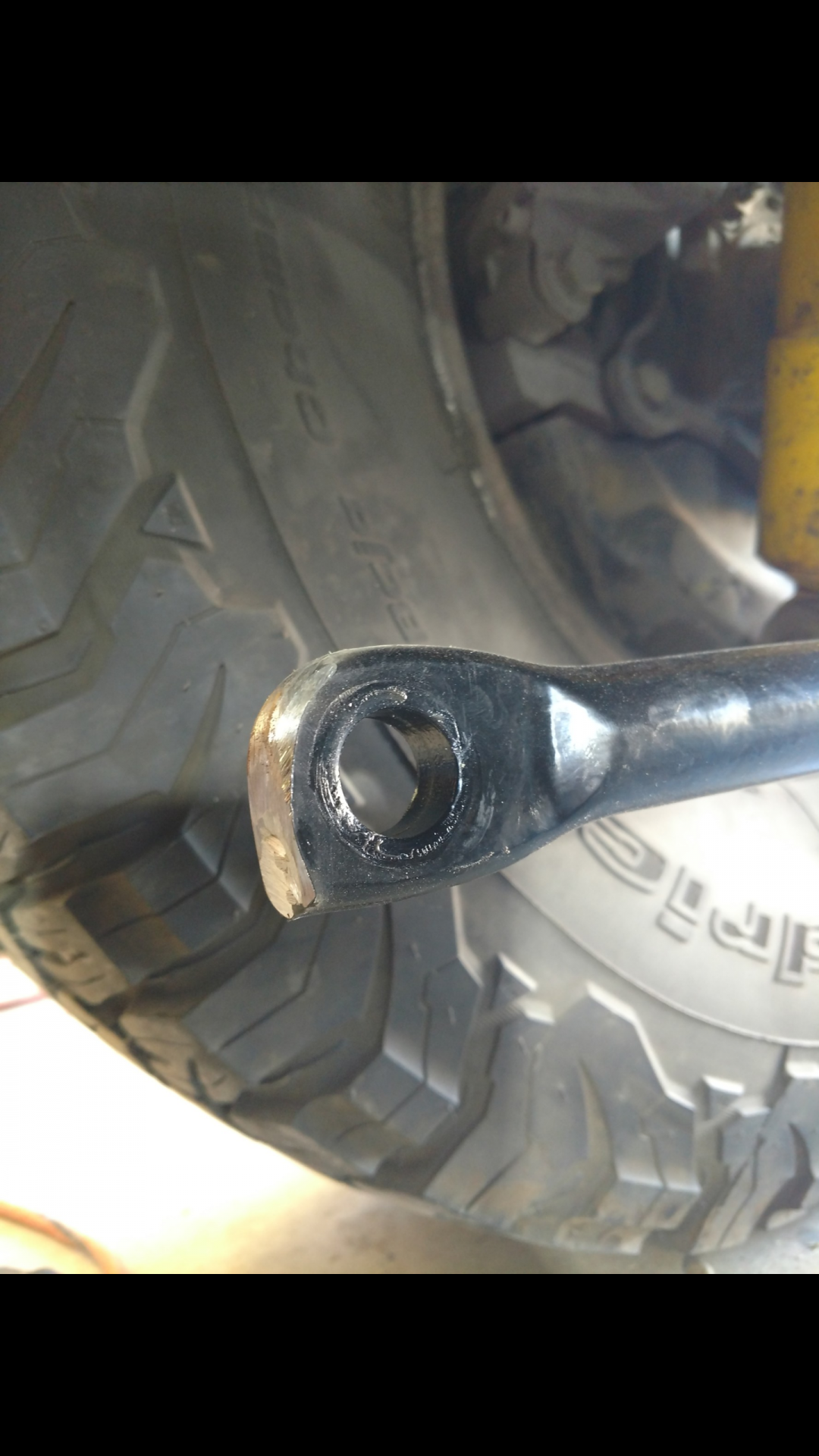

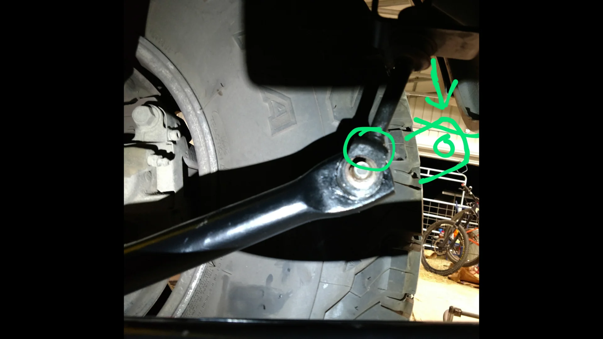

The install was super straight forward :banana:except for where it connects to the links. The new sway bar is much heavier duty and the ends are squared off compared to the factory sway bar which are rounded.
I originally installed it and realized it would need to articulate freely so I removed the links drop the bar and got out the grinder and results turned out perfect.
I'm driving a whole new rig with just that rear sway bar it is absolutely amazing!!!

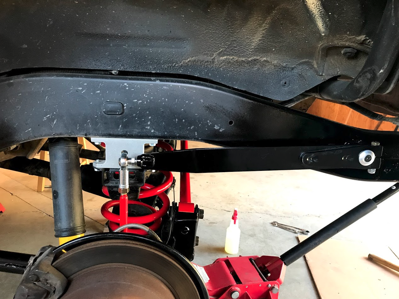

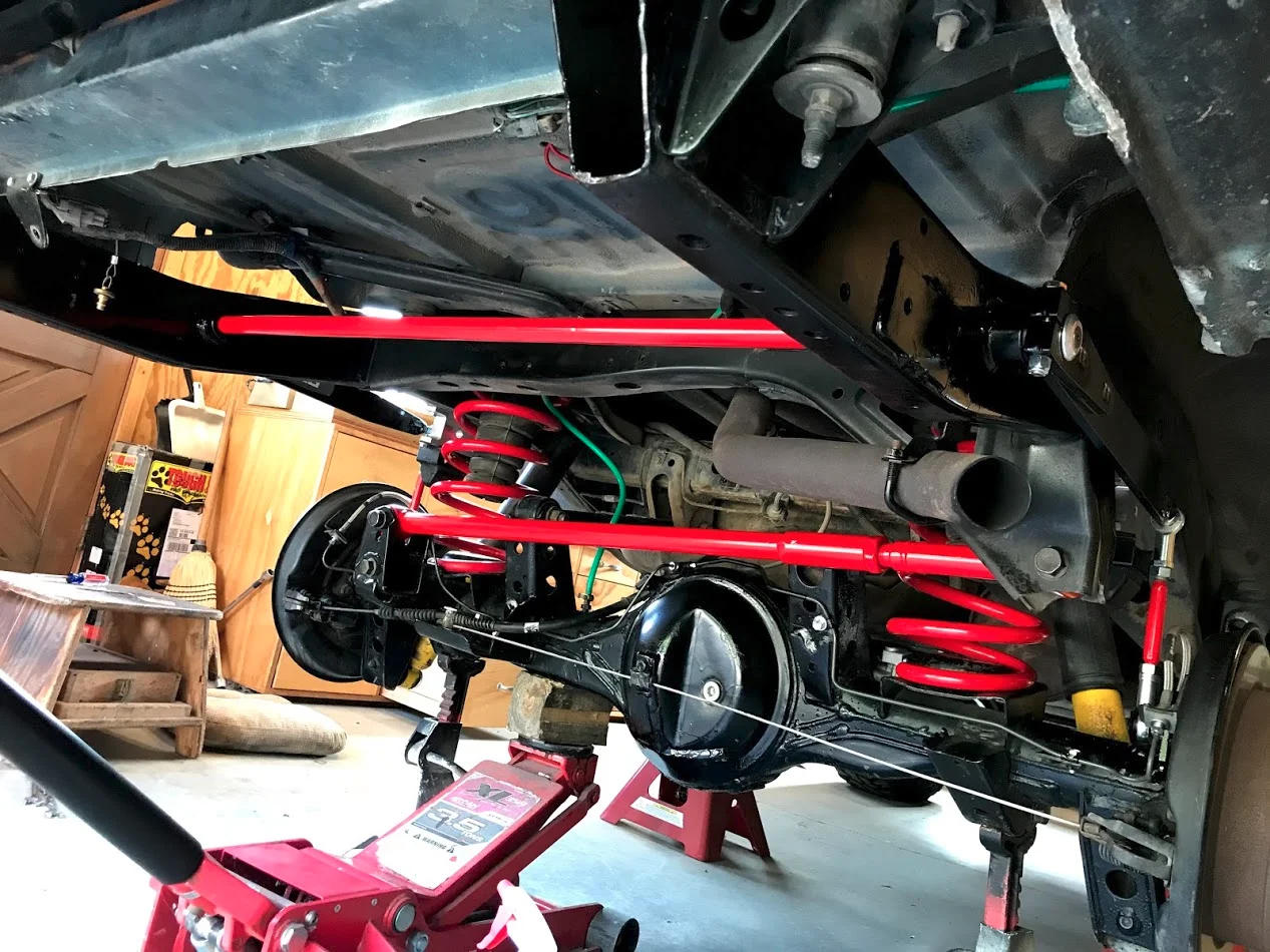

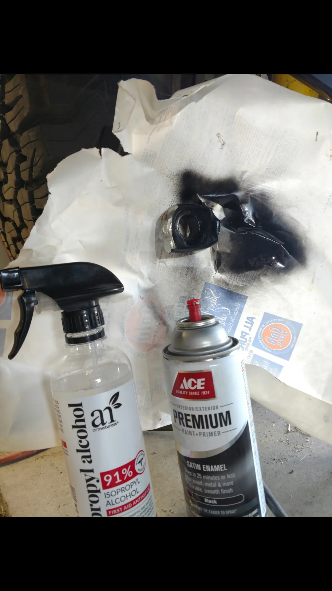

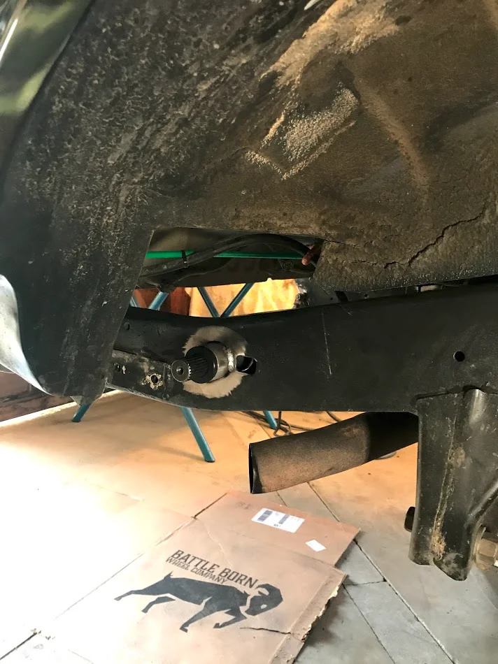

Got the Rock-Jock by Currie- Antirock SwayBar.
Full custom install, it works well, definite improvement over running no sway bar for the last 5 years. It's still not a sports Car and still drives like a lifted 4x4 on 39s ;)
The big surprise is I am see a bigger improvement off road in off camber situations (way more stable, cup of Jell-o felling gone) then on the street.🤷‍♂️

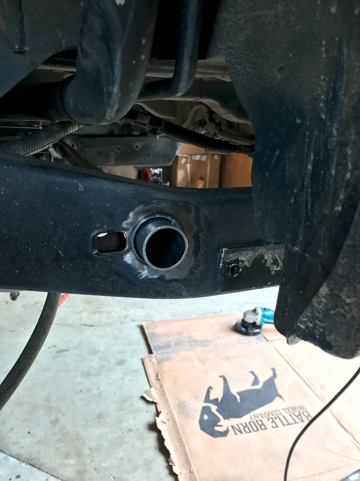

I cut holes through the frame using a template I made and the plasma cutter.

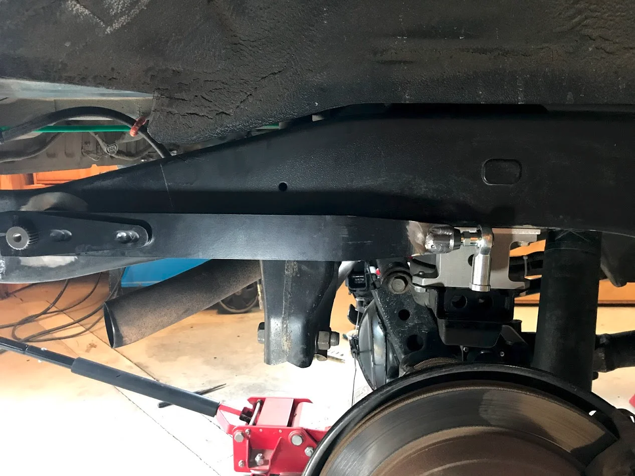

Modified arms

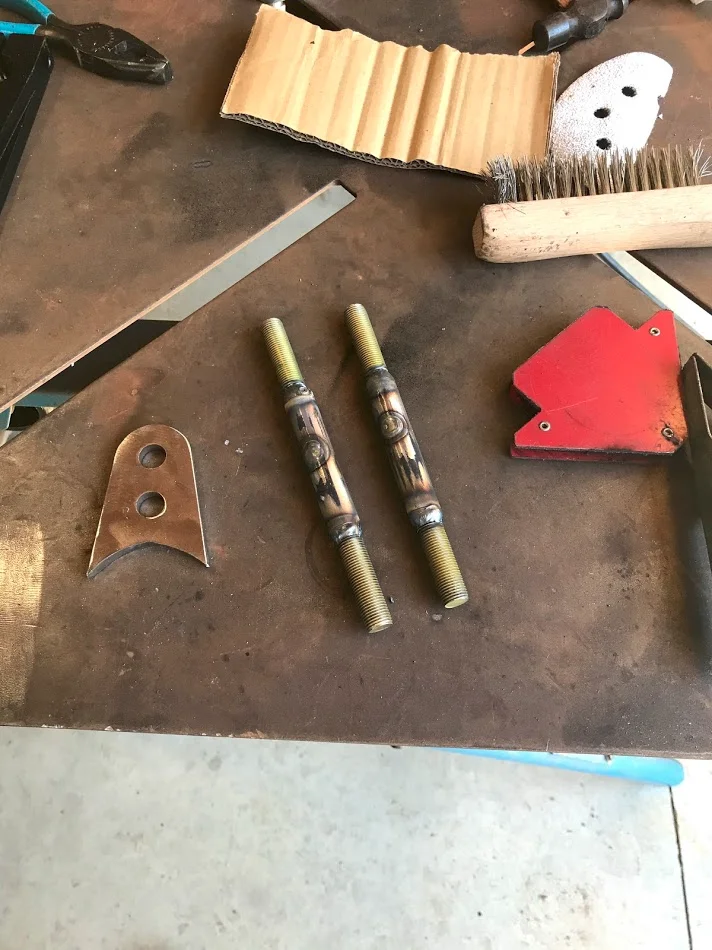

and Links.
And tabs welded to the axle.
Some flex shots
Sweet part is there is no low hanging fruit to get hung up on the rocks, everything is tucked up out of harms way. ;)
I well be fully testing it a the Rubithon Run in a few weeks.
