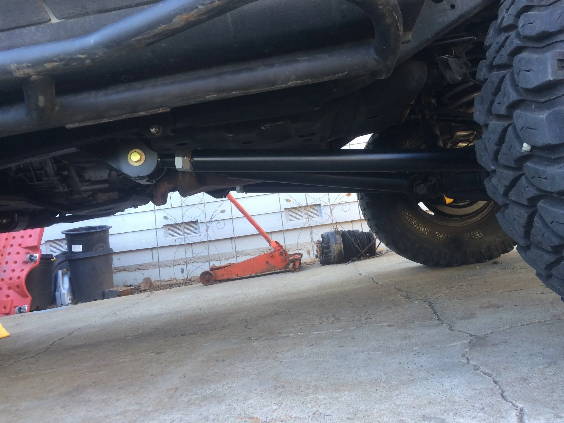

Heres 1 more front

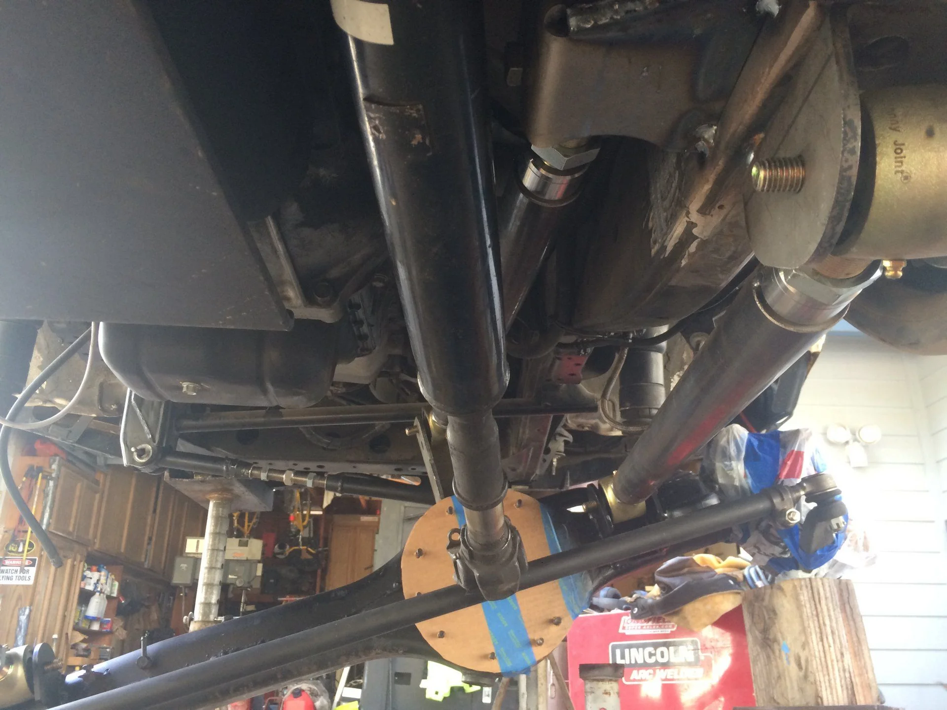

And the rear after I centered the axle with the same links and joints
