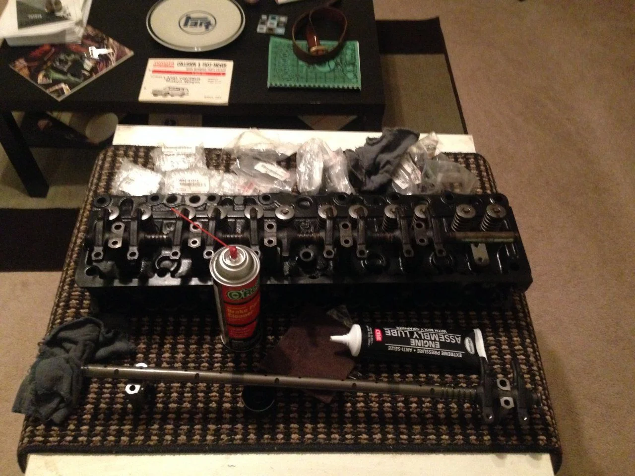

Small update.

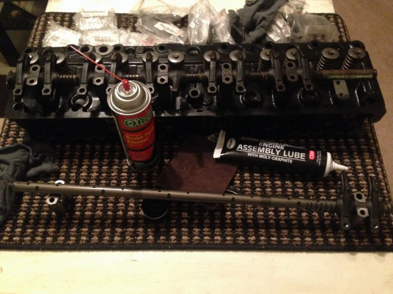

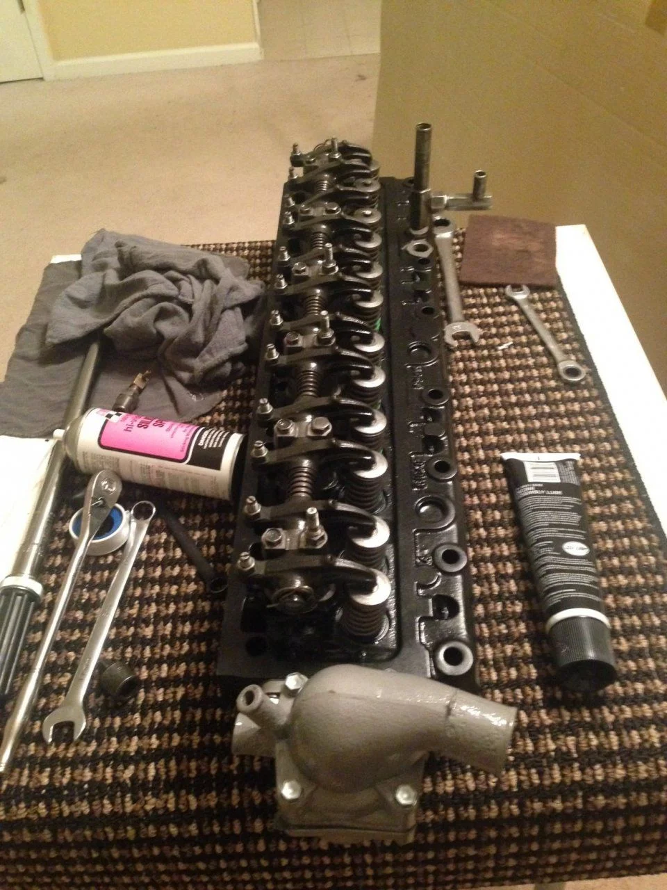

Started building the rocker/support/arm/springs assy.
Missing the final two arms on the end. Those should be here next week and I can finish the assy and bolt her on.

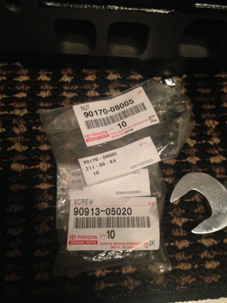

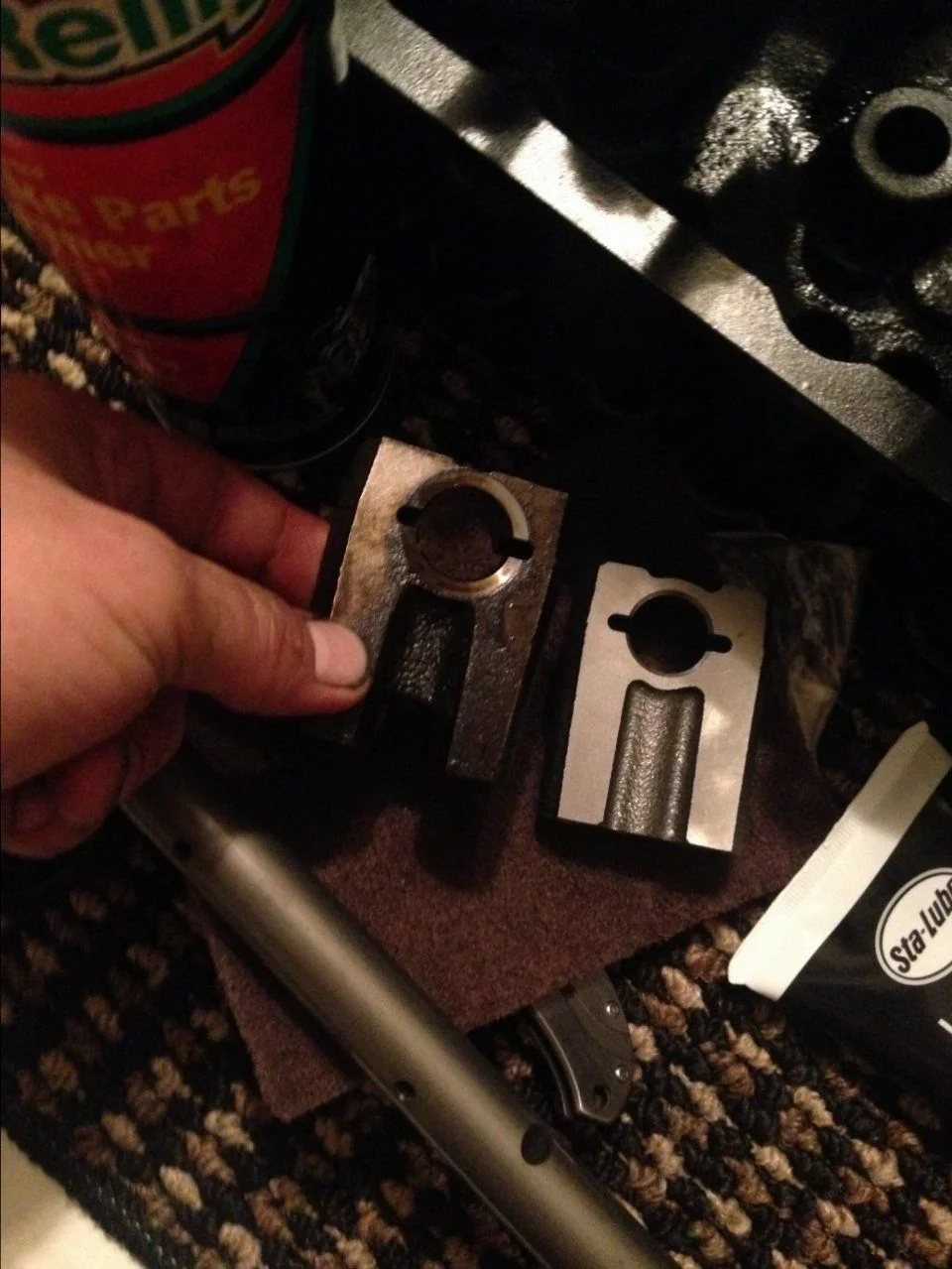

The old setup on the support arms was a different arm for where the oil comes up through the head and oils the supports/arms/shaft.
The new setup by Toyota is that the part numbers for the supports all supersede to the oil hole style so you would have, ostensibly, all supports oiled as oil comes up through the main support at #4. I like the change at least on paper.
Anyway, everything installed was new OEM except for the springs between the arms. Those are discontinued so I cleaned up the old springs and reused. Not much choice there.
:cheers:

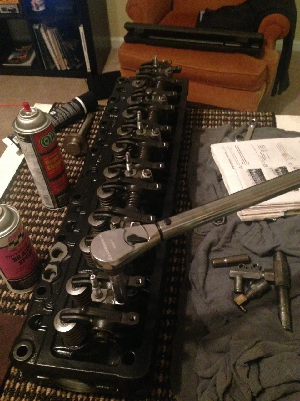

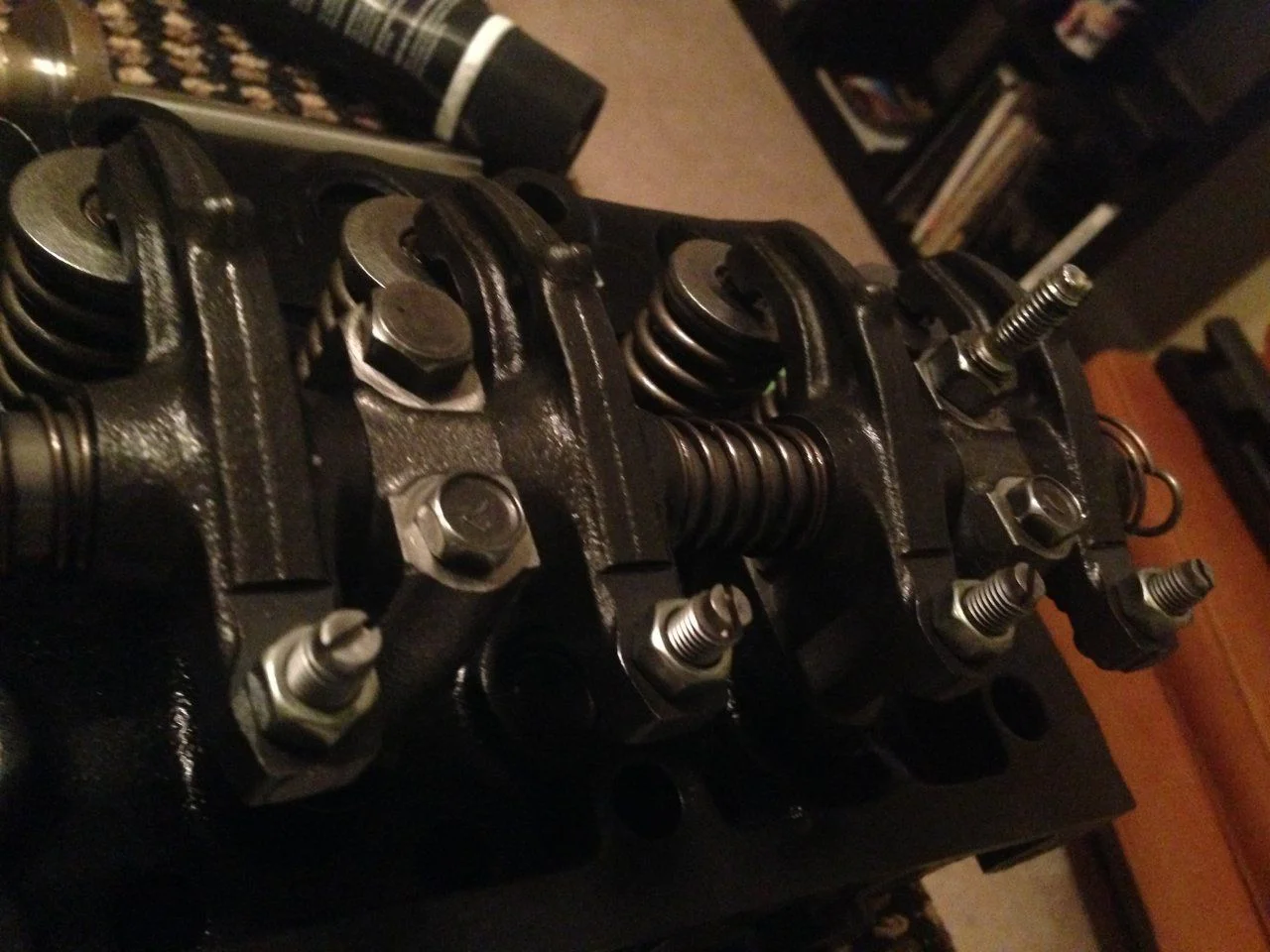

Slow work on my end. Rocker shaft and arms finished. New adjusting screws and nuts. I really love how everything just fits perfectly with new parts. I don't have to worry about anything not fitting. Everything is just uber perfect.
This thing is going to look very nice when it's done. Threw the VC on it just for a quick "ah..." moment Hope it runs too!

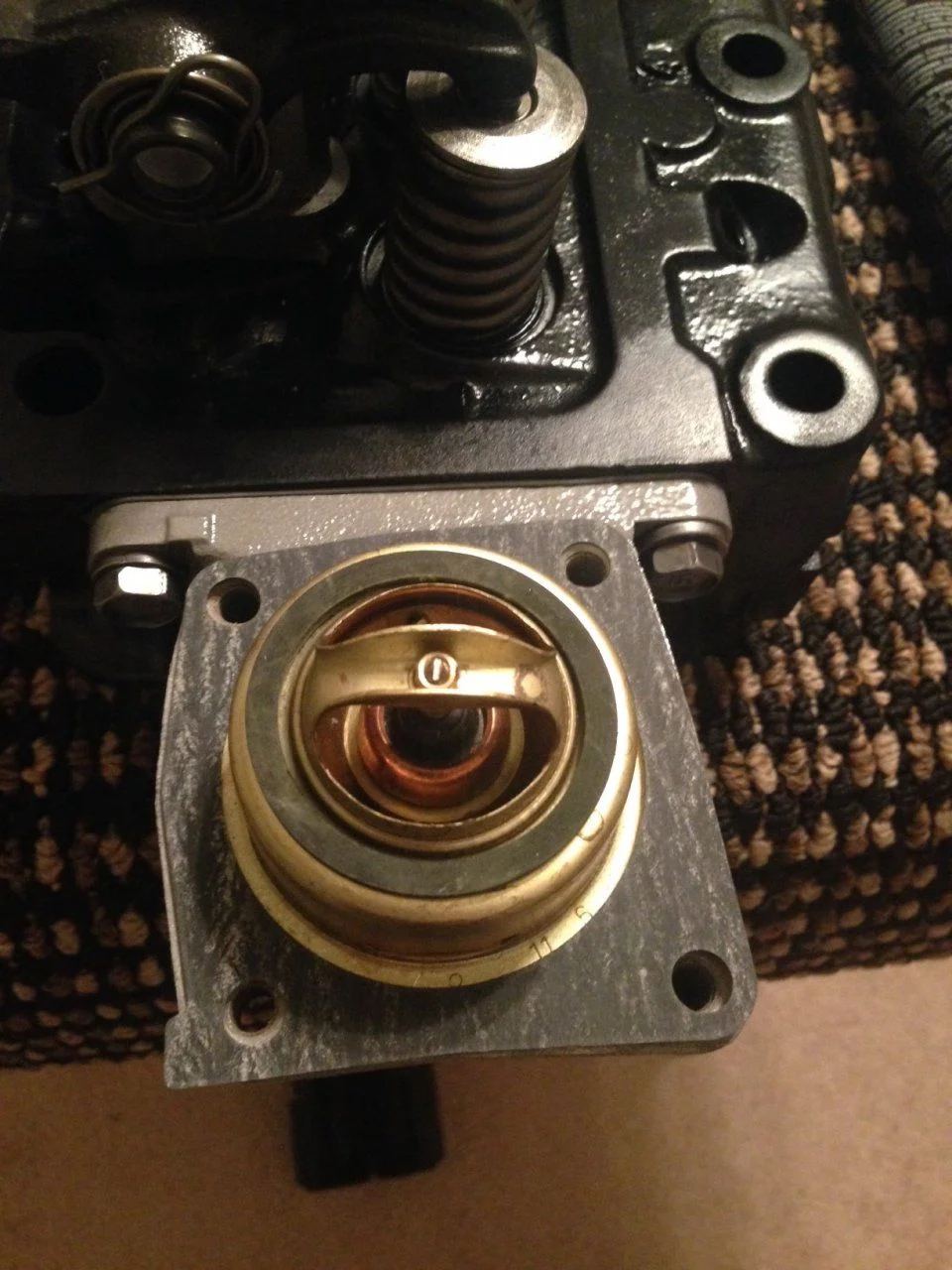

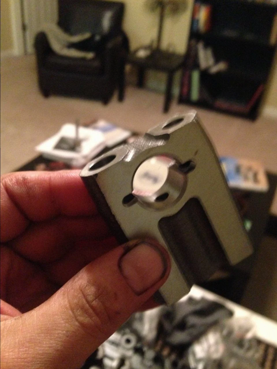

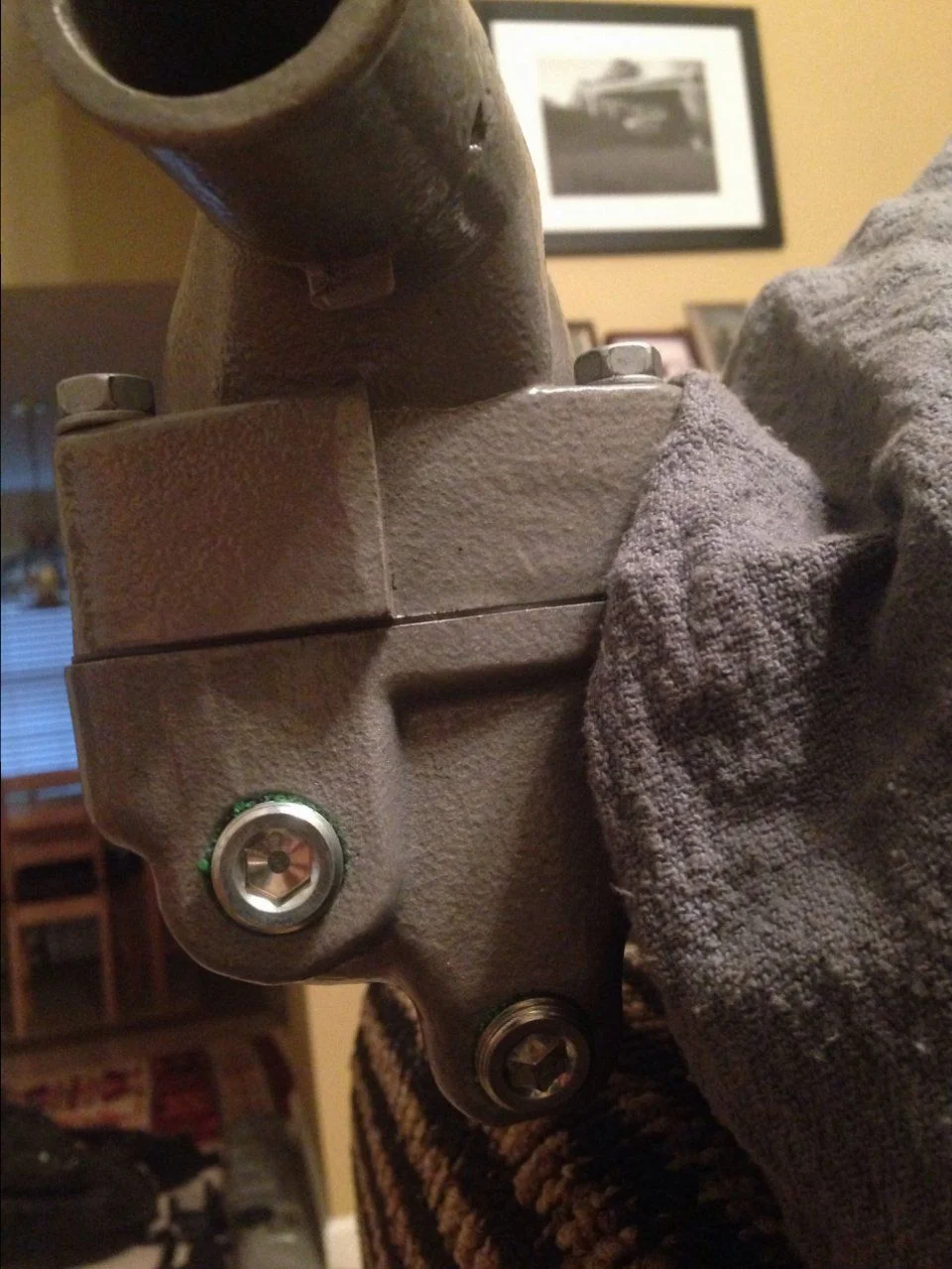

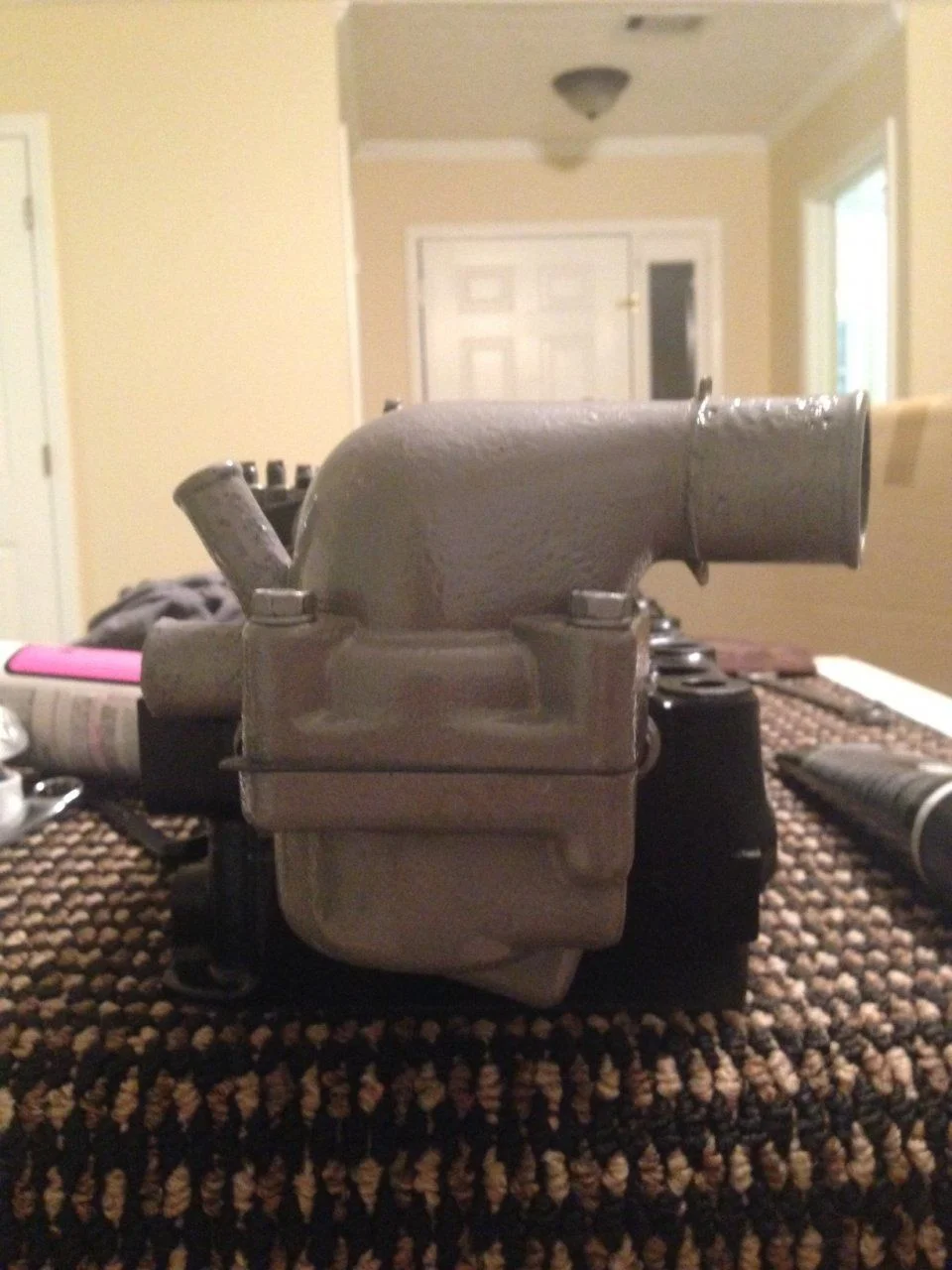

I was drinking a Leffe last night and decided to play a bit more on the head.
Correct orientation of thermostat and gaskets. :)

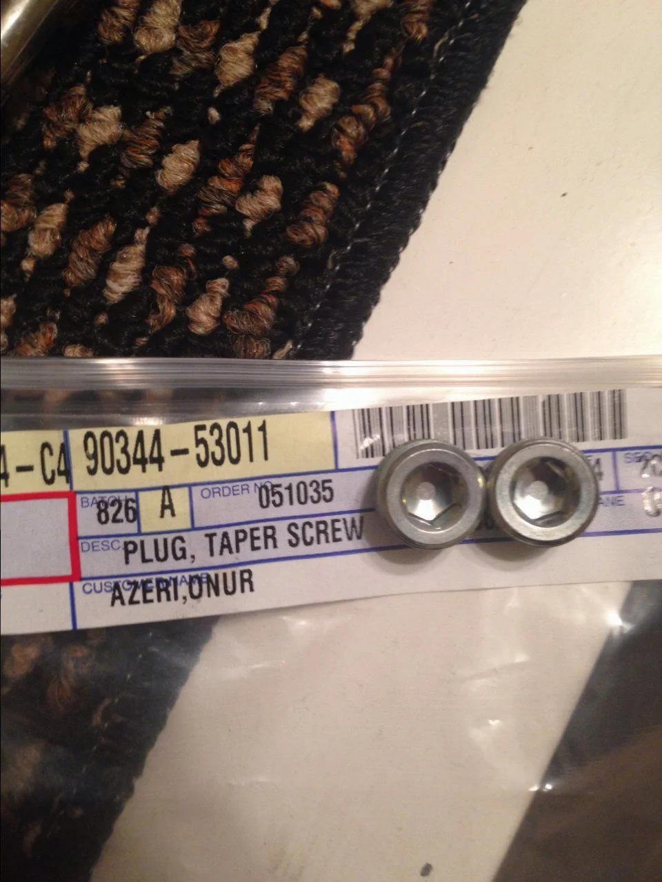

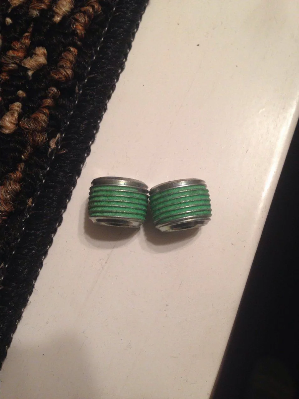

Are those the same dimensions as the air injector plugs?
What do they accomplish?
They're different size. People use 1/2" NPT, but I think the Toyota plug is the correct METRIC size, that's why it screws nearly flush with the t'stat housing. Different part # for the AI plugs.
That plug is also for the port in the late 40s /FJ60 intake manifold on the runner to the right of the carb.
Borrowed from Joe_E
I'll have to take a look and see if they would have a function on a 3fe...
