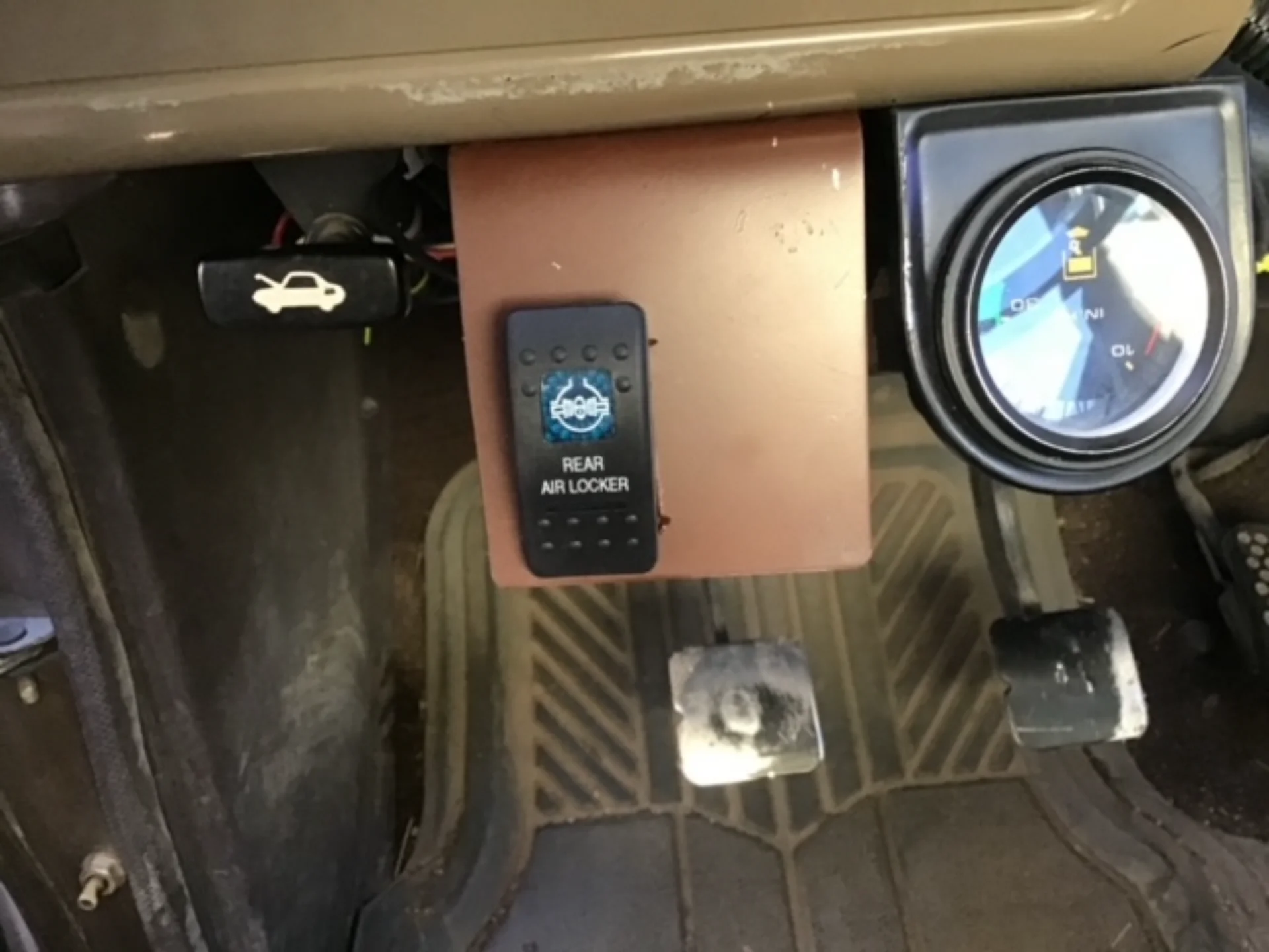

Working feverishly right now to be certain the ole 60 is ready for SAS. Making good progress over the last several months (front locker, new radiator, new shocks & some other minor stuff) & almost there. Again, not impossible…we shall see.👍👍👍
Maureen is returning tomorrow from a little over a month back in Texas.🇨🇱🇨🇱🇨🇱

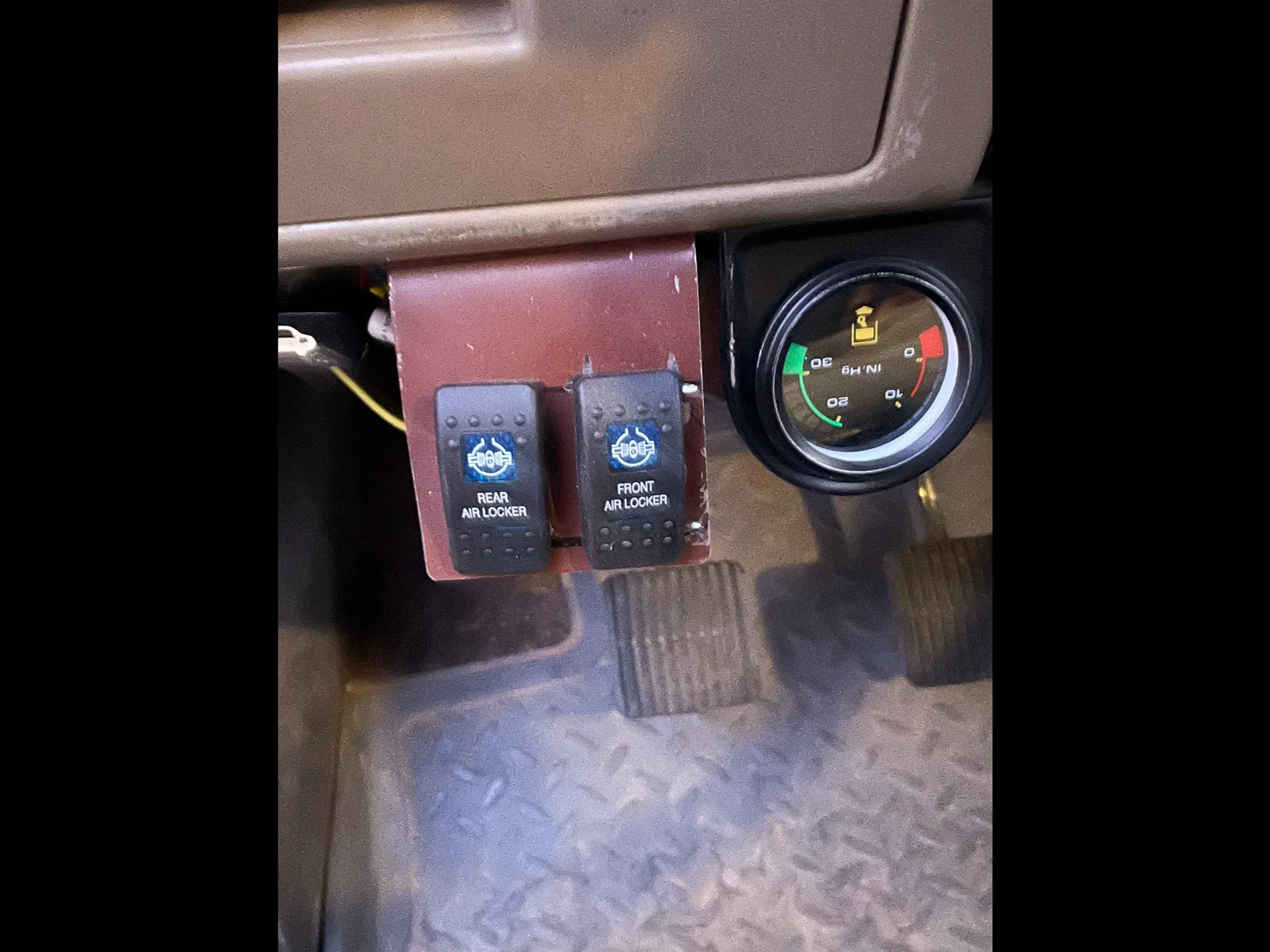

Thanks, not impossible.👍
And fully locked…Scary.🙈😱🙈

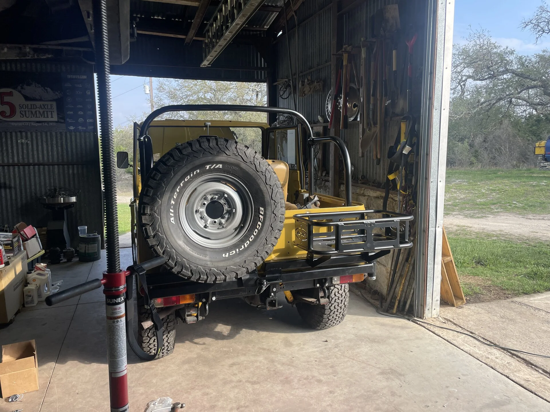

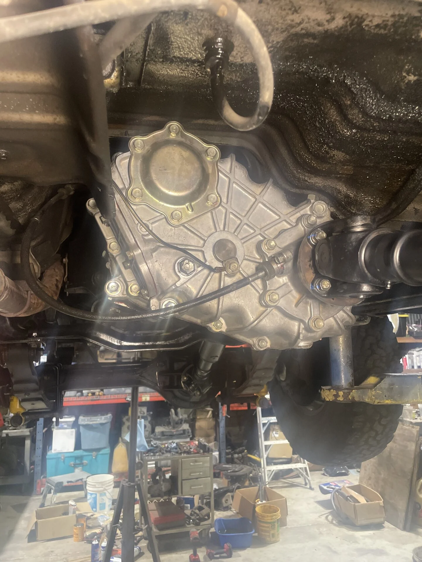

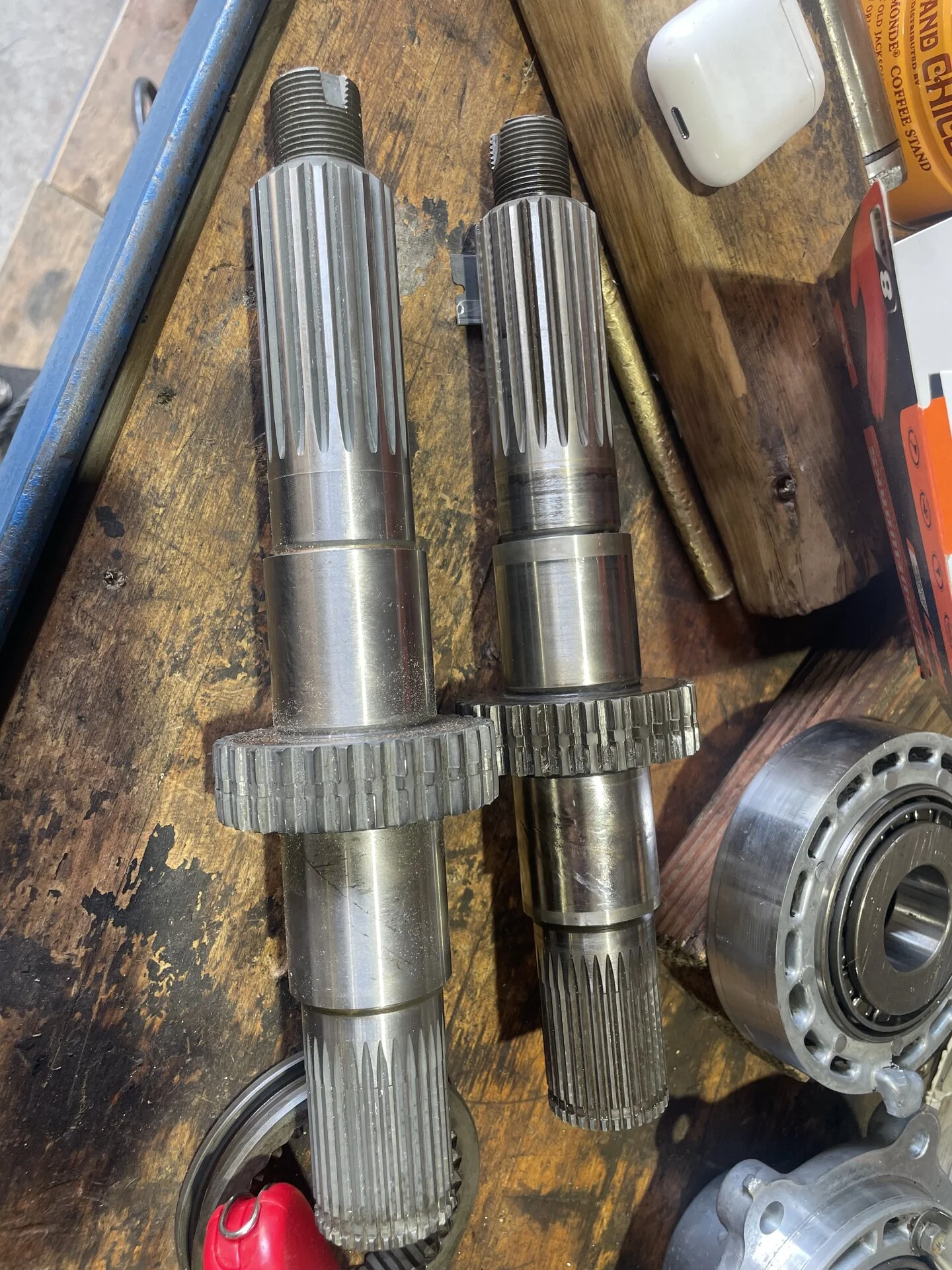

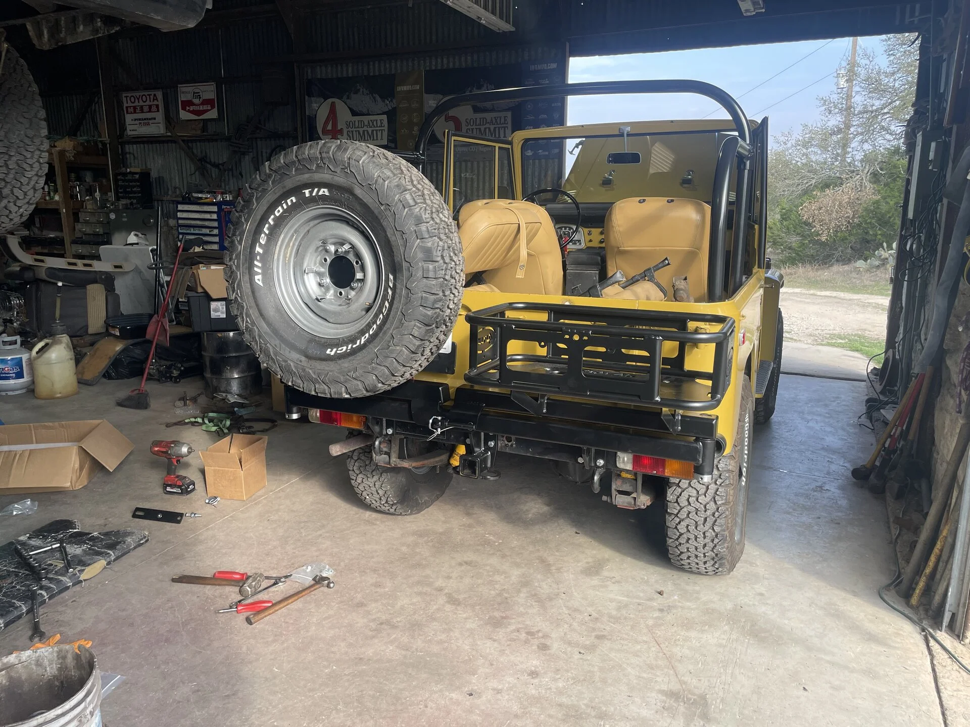

Received a new output shaft from @orangefj45 for Daniel’s @LETSROLLEM T-case. BTW…I know we have many good vendors to source parts from and all are really good. From my experience the service and tech support from George and his team is hands down the best of the best IMO. Will build this case back onto the H55 & get it loaded under the truck today. Drive shafts should be back from getting resized today as well. As a diversion I installed this incredibly nice bumper made by Dave Gore @lcwizard on my brothers @kmj64 40 yesterday. Glad to help anyone local obtain this look if interested.

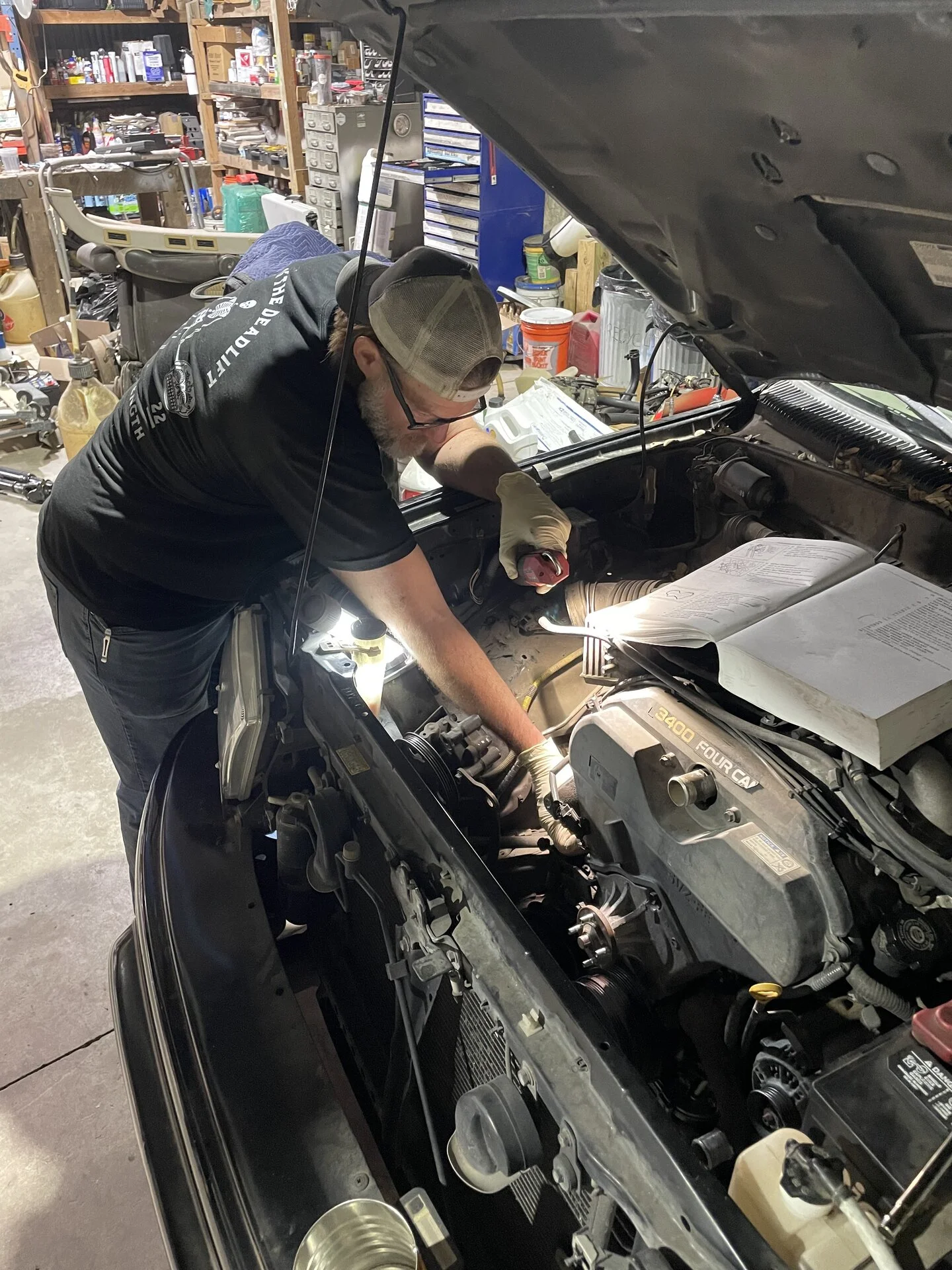

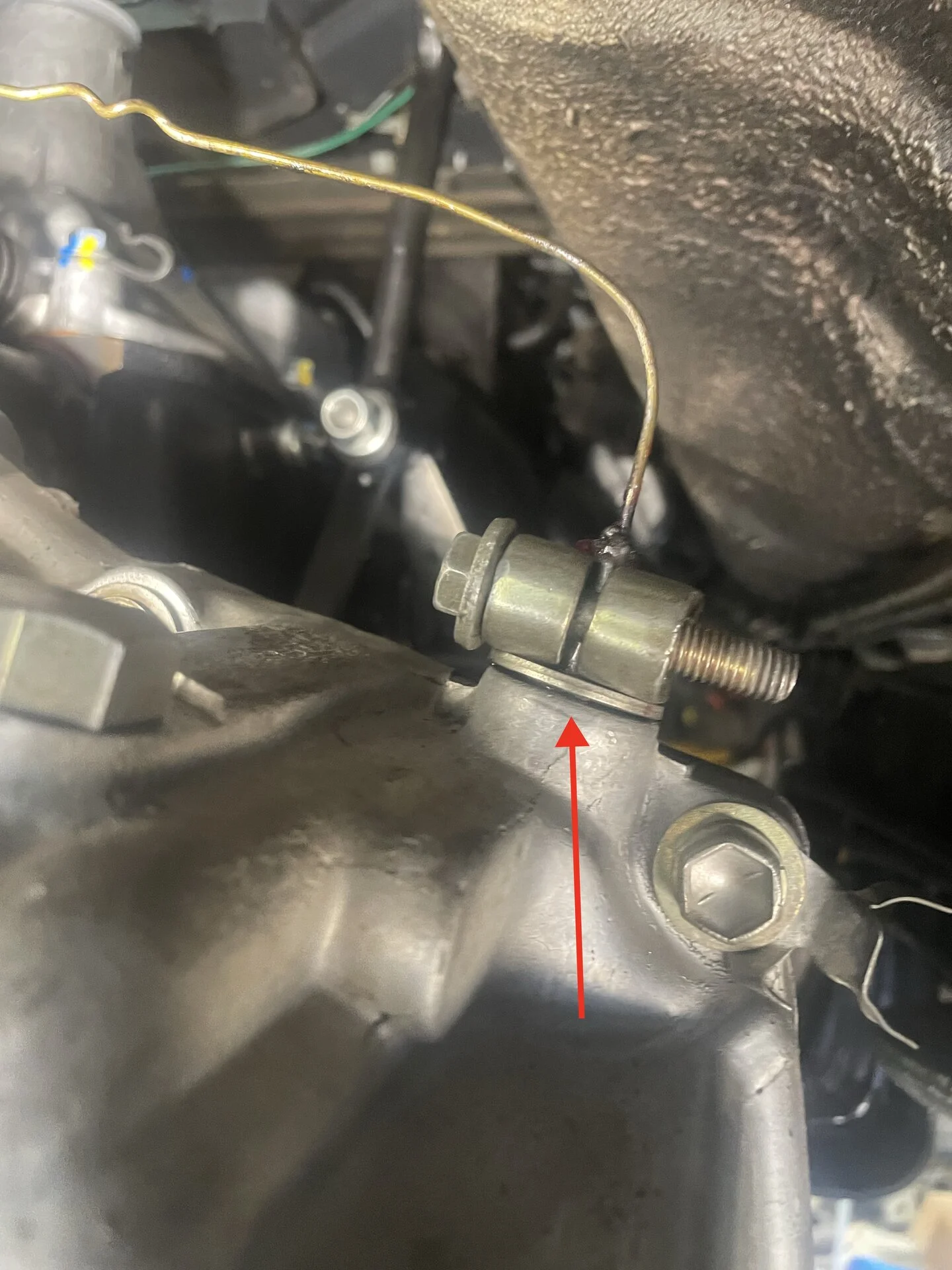

Had Ben @BigHighBlue in for the weekend so he could do the timing belt on his sweet Gen 3 runner. Was fun looking over his shoulder as it brought back memories of the few I did years ago. Also, spent the latter part of the day wrapping up an error that @iansplatinum Ian found when he stopped by the shop today. First time meeting in person and what a sharp young dude. I’ve done several t-cases and always attach the bolt and spacer washer back to the hi/lo selector when I tear down a case. For some reason I did not do it this time and just threw everything loose into the coffee jugs and into the parts washer. So earlier this morning the bench is about empty and I’m wondering what this washer/spacer is doing sitting there. Ian had a similar error on his truck so that was one of the first things he checked out when he entered the barn. Then it was the dreaded “what do I do to avoid dropping the lever into the case”. Scratching my head I call one of my “go to” friends @POTATO LAUNCHER and Casey and I brainstorm. He had a great idea to get welding wire to stick to the top of the rod. Well…he’s one of the few I know that can make the mig dance the way he wants. Needless to say I could not make it happen and then it hit me…cut a piece of hanger and tack it. Was able to hold the lever up and get the washer installed. Filed off the excess and all is good. Ian had a great suggestion as well so I appreciate all the cruiser wisdom.
Great meeting you as well Jimmy! Thanks for the hospitality and beer. Great solution, glad it worked.
After having to crawl under my 60 a few dozen times on muddy trails in colorado to man handle the t-case lever to shift it from low to high, it's the first thing I look for now.
