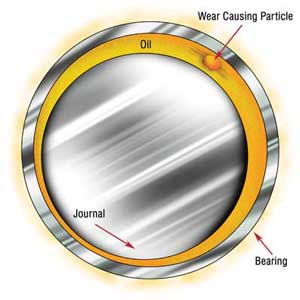

Figure 1. Bearing Wear​
Additionally, consider how most vehicles are driven. Anyone accelerating slowly or driving at the speed limit to conserve energy is a danger to himself and other drivers who are in a much bigger hurry.
Auto manufacturers, on the other hand, are concerned about fuel economy. The manufacturer faces big fines if the fleet of cars it produces falls short of the Corporate Average Fuel Economy (CAFE) requirements imposed upon them by the federal government.

Any abrasive particles equal to or larger than the oil film thickness will cause wear. Filters are necessary to keep contaminants small. The other side of the equation is oil film thickness. Thicker oil films can accommodate larger contaminants.

Viscosity and Wear​
Thinner oils have less drag, and therefore less friction and wear. Right? Perhaps in the test engine or engines that experience normal operation. But somewhat thicker oils may offer more protection for more severe operations such as driving through mountains, pulling a boat, dusty conditions, short trips, high rpm, overloading, overheating and overcooling.
Figure 2. Ring Wear​
Temperature has a big effect on viscosity and film thickness. As a point of reference, one SAE grade increase in viscosity is necessary to overcome the influence of a 20°F increase in engine temperature. At a given reference point, there is approximately a 20°F. difference between viscosity grades SAE 30, 40 and 50. SAE 20 is somewhat closer to 30 than the other jumps, because SAE 30 must be 30°F higher than SAE 20 to be roughly the equivalent viscosity.
In other words, an SAE 20 at 190°F is about the same kinematic viscosity as an SAE 30 at 220°F, which is about the same viscosity as an SAE 40 at 240°F. This approximation works well in the 190°F to 260°F temperature range. One might be surprised at the slight amount of difference between straight viscosity vs. multiviscosity oils with the same back number (for example, SAE 30, SAE 5W-30, and SAE 10W-30).
If an SAE 50 oil at 260°F is as thin as an SAE 20 oil at 190°F, imagine how thin the oil film becomes when you are using an SAE 5W-20 and your engine overheats. When an engine overheats, the oil film becomes dangerously thin and can rupture.
Ford is bumping up against its CAFE requirements and recommends SAE 5W-20 oil for most of its engines in the United States. It claims SAE 5W-20 is optimal for fuel efficiency and wear.
To determine if SAE 5W-20 oils provide the same level of protection as SAE 5W-30 oils, Dagenham Motors in England, one of the largest Ford dealers in Europe, was consulted. SAE 5W-30 is required for warranty purposes in England, and SAE 5W-20 is not even available. If SAE 5W-20 were better for both fuel economy and wear, why would Ford not recommend it for its same engines in Europe?
