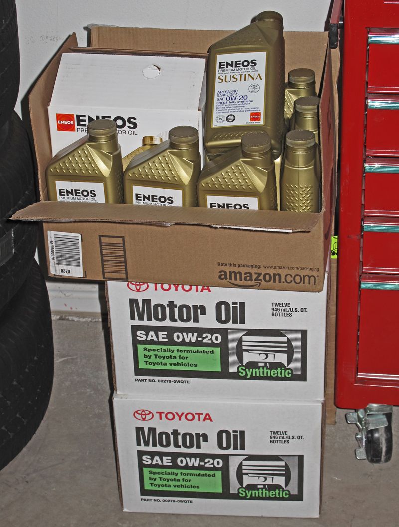

Mobil1 Full Synthetic 0W-20
TGMO (Toyota Genuine Motor Oil) 0W-20 is one of the best motor oils available anywhere:
If you want to splurge, try some of the ENEOS Sustina 0W-20:
HTH
