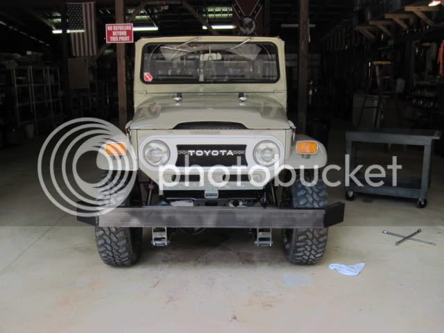

picked up a real nice set of powder coated OEM springs on Tuesday from a fellow MUDDER and friend. And my friend Sambo helped me intall the front 2 today.......did i mention it was a freaking 100 degrees in a barn/shop in Gawja today.......:o
got rid of the cruiser lean on my fjj40...........it was so bad on the pasenger side due to a weak/damaged spring. Picked up the passenger side a full 1 1/2 inches( notice the 1 1/2 inches of rusty shock, where i had painted them:D), and the drivers side a 1/2 inch...............lot of work in the heat ---but in turned out nice and safer for sure.
after the install we took it a little ride in " the twisted pines farm" to check out a few places to bowhunt this fall.

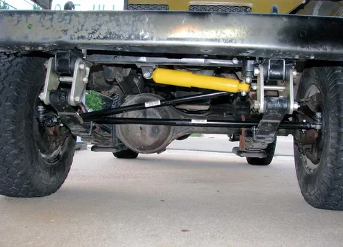

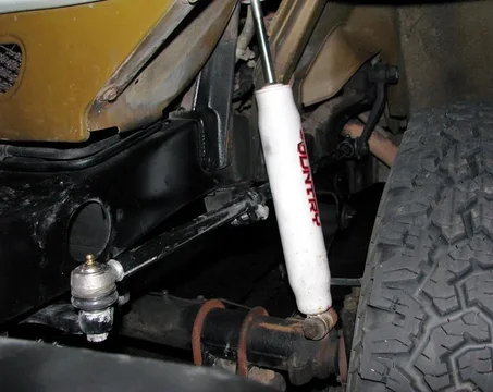

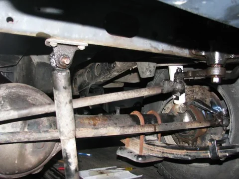

New steering components
Replaced, rebuilt all the steering components from the pitman arm to the wheels.
Handles much better now. I had been running the tires at about 25 psi to avoid death wobble at 50 mph when they were at 32 psi. Now, tires are at 32 for road driving, no death wobble, no under- or oversteer, and no tendency to jump around the road. It'll get the off-road test on Red Cone this Saturday.
From this:
To this:

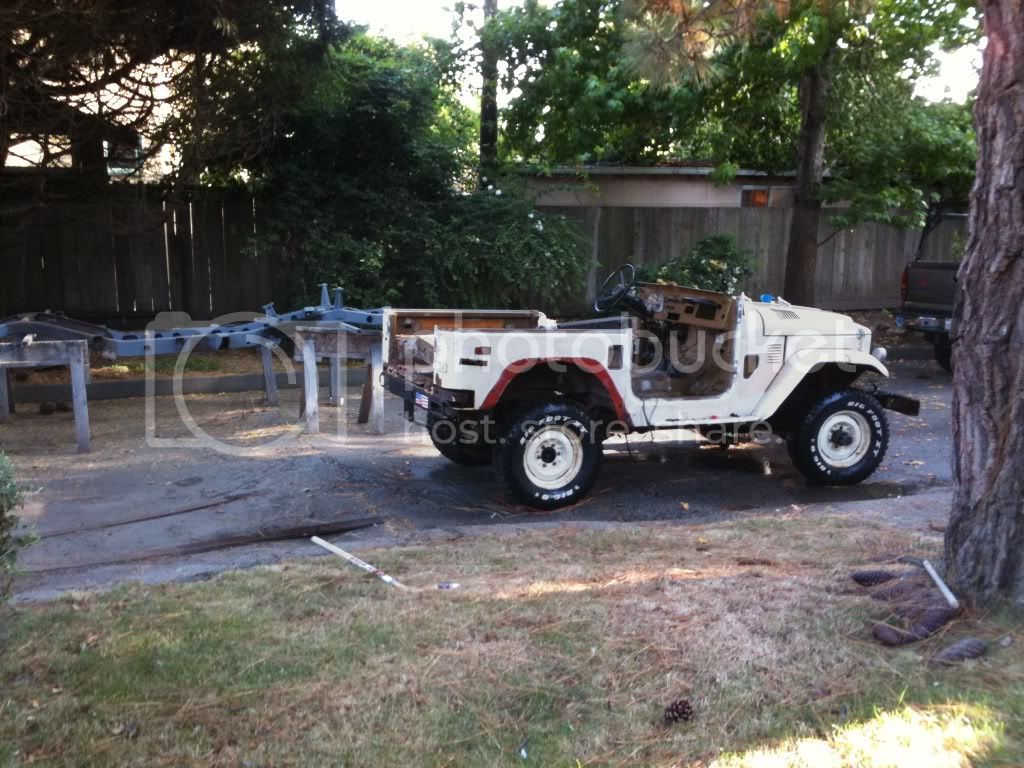

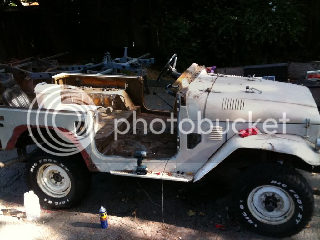

went from this to the red still have the hood, tailgate, and odds and ends to do
/IMG]
I will try a couple bigger pictures, these are hard to see
