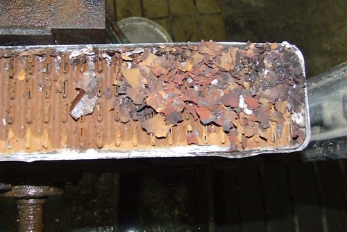

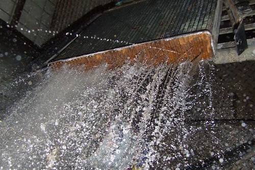

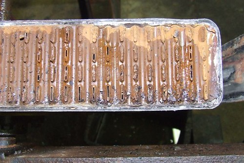

As my FJ40 had been laid up for close on 20 years and only recently having been re-commissioned [In Australia.....now in RSA] I have been undertaking some routine maintenance tasks, naturally one of which was the cooling system being my main priority.
I performed a full cooling system flush and also decided to fit a VDO auxiliary temperature gauge for peace of mind as I just do not trust the OEM one......:rolleyes: The OEM sender needs to be swapped out for one that's compatible with the new gauge if you're only going to be relying on the new gauge in isolation as the OEM one is not compatible.
On completion of having fitted the new gauge I immediately discovered she was running very hot. I was now left wondering where the problem lay......so, I decided to take the radiator in to a radiator shop to do a flow test, it was about 53% blocked [85 out of the 160 tubes], I could hardly believe what I was seeing :eek: There was my problem right there. Replaced the radiator with a new one as the cost of the re-core was the same price, re-flushed the engine again before offering up the new additions, fitted a new OEM 82ºC thermo with the rubber sealing ring, new OEM hoses, fresh coolant, new OEM cap and I'm now sitting at an ideal 82ºC [180ºF] no matter how hard I drive her....problem solved :cool:
So, despite having flushed the radiator, and water seemingly flowing through it beautifully with the hosepipe in the top inlet flushing clean water through, it was actually over 50% blocked and the cause of my problem.
Possibly not something a daily driver is going to suffer from with regular maintenance and the use of proper coolant, but something to be aware of for vehicles laid up for protracted periods and being re-commissioned.
On removal of the top tank....not pretty.
Close-up of the blocked tubes......recipe for disaster and impending doom.
Flow test showing the result of the blockage......more than a 50% restriction :eek:
Thanks for posting this Peter.
(A fine example of the damage people do by neglecting their cooling systems.)
