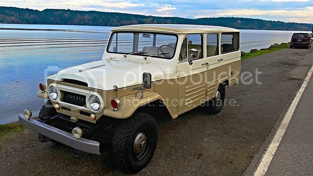

Replaced the old Drum brake hub cap wheels, with new OEM wheels and a set of reproduction Arorn caps, same old 28-29" BFG's but black out. I really love the stock look....it made a huge difference

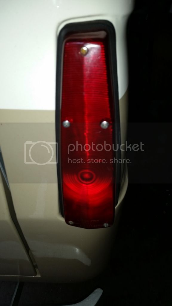

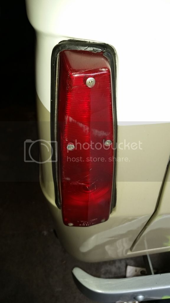

Replaced left rear taillight rubber, not very impressed it tore at the corner when I installed it(and I was using brute force)
original on right side

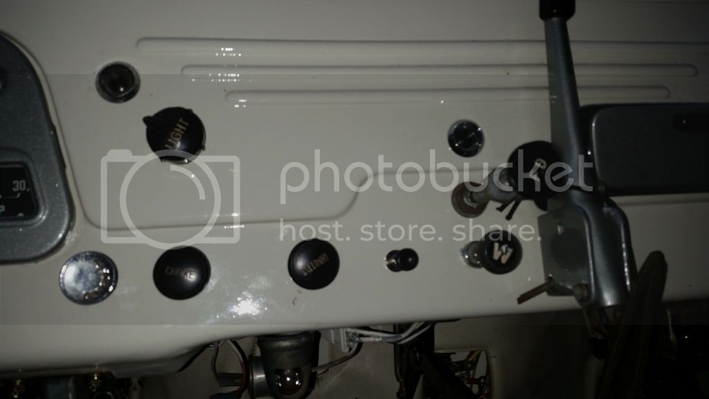

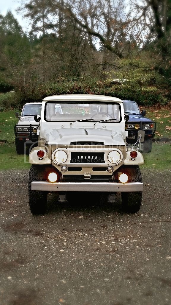

Wired up the OEM fog lights, used a little push pull switch, looks old and only a few bucks, added a replay and made a nice harness

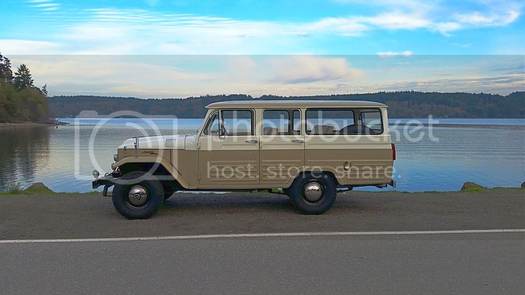

64 FJ45LV
Got the new(old 9mm) drum brakes finally done Monday I think. Stops fantastic, glad I got new hoses and brake tubes(I got the whole kit just in case) did all 4 corners, took us(Jared mostly) alot of patience to get them all adjusted up, is bitched out his back for days(and why I don;t do that unless I have to or have a lift). I also had him change the oil......I hate the 25mm drain plug and canister filter......now he does as well
Put about 300 miles on it last week, worked out some rattles, need to chase down some more.
Got it up to close to 60mph on freeway, did so well,I went and did 65 than 70 ;) It likes 45-55 the best
Adjusted some of the slop out of the column shift
Replaced original steering stabilizer with an OME I had on the shelf.(all other shocks are OME)
Did a rattle can on the repro Land Cruiser Bezel, need to align it(aka make holes bigger) but I like it.
Put the OEM tool kit back in......found a 1965 Colt Trooper(same guts as a Python) under the seat...;) (kit is a bit of new and abit of old, have a few others to go thru
think I have final got the right gas cap that doesn't spill when making a right hand turn with a full or close tank
List of things still working on
Replace brake master(its starting to leak), I had a mismatched pair, wrong bore, always wondered why the clutch was stiffer than any of the others
Get wiper working
install OEM Denso optional heater
replace hoses with OEM, not the SOR crap that is one there
correct caster 4 deg, the shackles are making for quick caster. Darn thing has the least play of any 40/45 I have, but you gotta be on your toes.
Add a leveling block to the right rear spring pack to hopefully level it out.....kinda funny I like it low and I always thought I would do OME like all the others. In the end i may still but 33.9's are gone(even though I have 12) and not sure I want the 33x10.5 look on this....it would be killer looking but stock is really fun.

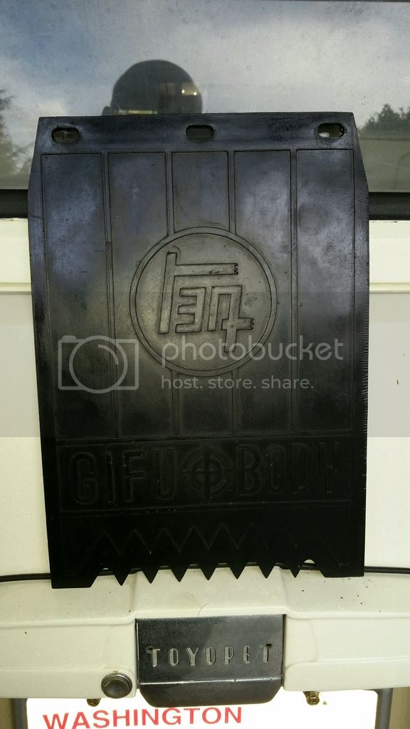

Put on Gifu mud flaps

Beautiful 45LV love the color combo!
