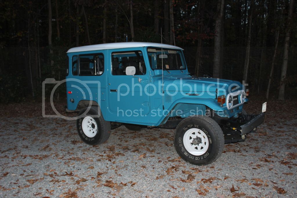

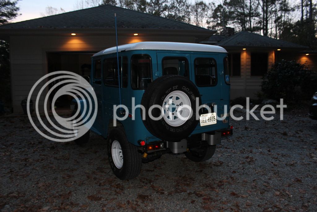

The troopy got a freshly powder coated set of late model FJ40 wagon wheels wrapped in new 33x10.50 KO2's.
Well, they aren't late model. I've been one up'ed by Rustic76!
But I got my new wheels installed today. I like the look way better than the old American Racing aluminum wheels the rig came with.
The blue and white combo looks great! That cruiser is such a beauty!!
