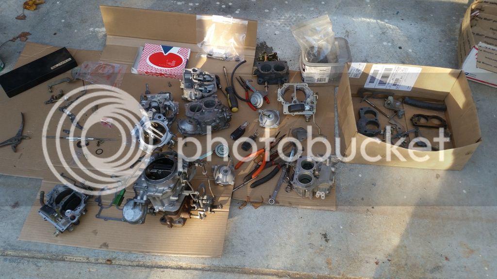

New bumpers installed and also rebuilt my carburetor. I'm always looking out for deal on the Asian carbs. Found one recently on ebay for $60. Damaged top, but excellent body. Took a top off one of my spares and built a new to me carb that is performing the best ever.

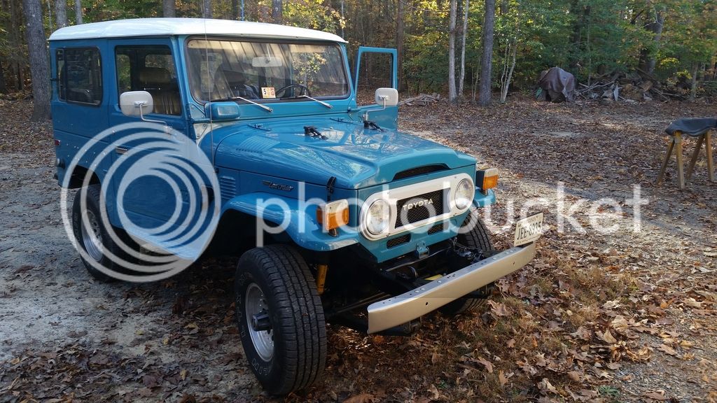

New factory bumper...
New rear bumpers. Bought the rear bumpers from Toyota for less than what paint would cost.

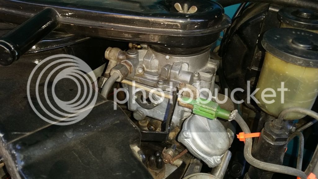

Carb installed...
Spare carb parts...
