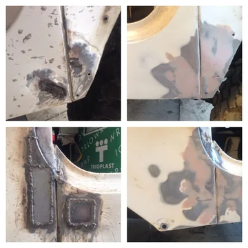

I cut rust out of my shorty & removed the tail lights I had in the rear end then resprayed it.
