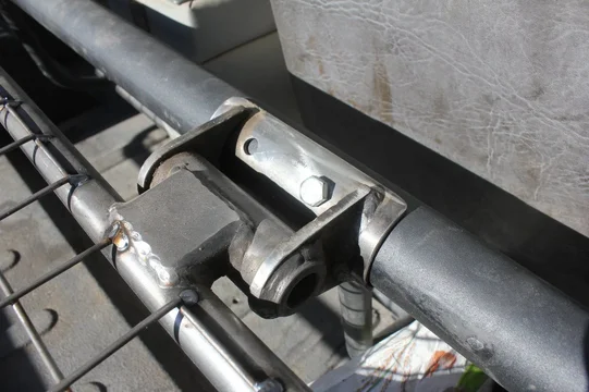

Nice thinking there with the cargo rack LC magi. What did you use for the hinges? I'm have a hinge dilemma at the moment......
Also curious as to your design decisions in terms of the bar work. While it seems a simple square frame would have worked I really dig the way you added the bars out to the sides etc.
Pete
The hinges are actually really simple. IMG_3538.webp IMG_3552.webp IMG_3554.webp IMG_3713.webp IMG_3719.webp It's just a 1 and 1/4 OD round tube slipped inside a piece of 1 and 1/2 OD x .120 D.O.M with a mounting bracket welded to each side. LCWizard cut the side plates for me on the plasma table we have at work.
As far as the bars on the side of the cargo barrier go they were actually an after thought. The first hoop I bent up was like you say just a square but after mounting it in my truck and flipping it up it hit the corners of my hoop on the gussets at the top of my cage. So I narrowed the hoop and then I had open space on the sides. So I added the two side tubes to fill space and make it easier to mount my pins that lock the barrier up and down. I originally intended for my dog to be able to ride on top of the rack with all my crap underneath it but I'm in the process of trying to make it more dog friendly I'm looking into getting some racing nets to mount on the sides of my roll cage so he can't roll out.
