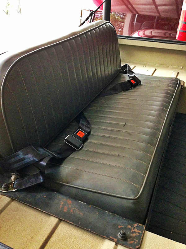

Mounted my 'new' Con-Ferr rear bench and some new belts - now the whole family fits. Gonna refinish the Con-Ferr when I redo the front seats, which is on the list...
