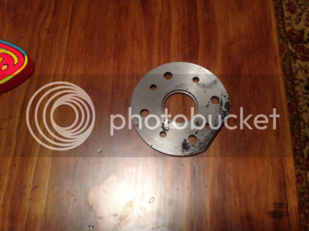

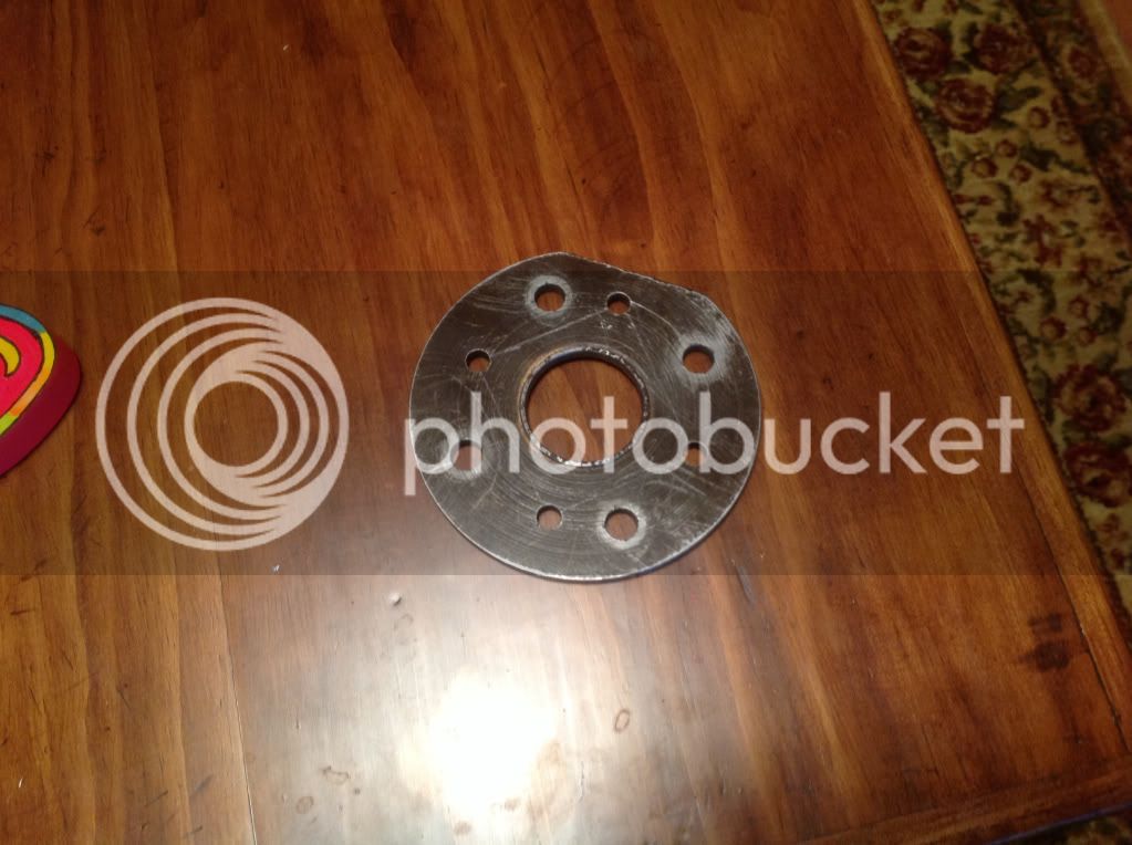

Axle adaptor washer
It is icy in oklahoma this weekend so I got around to making an adaptor to connect the 1967 drive shaft to a 1978 front axle with disc brakes. Was going to buy a new flange but what better way to waste a cold ice day then making something. Started out as a 5" piece of angle iron.
Here it is, have to Wait until it is a little warmer outside to see If it fits.
