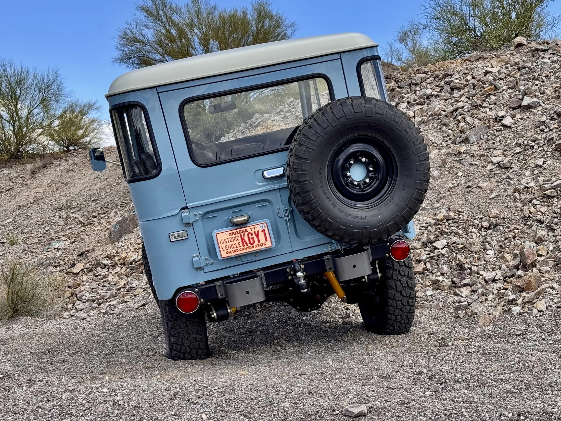

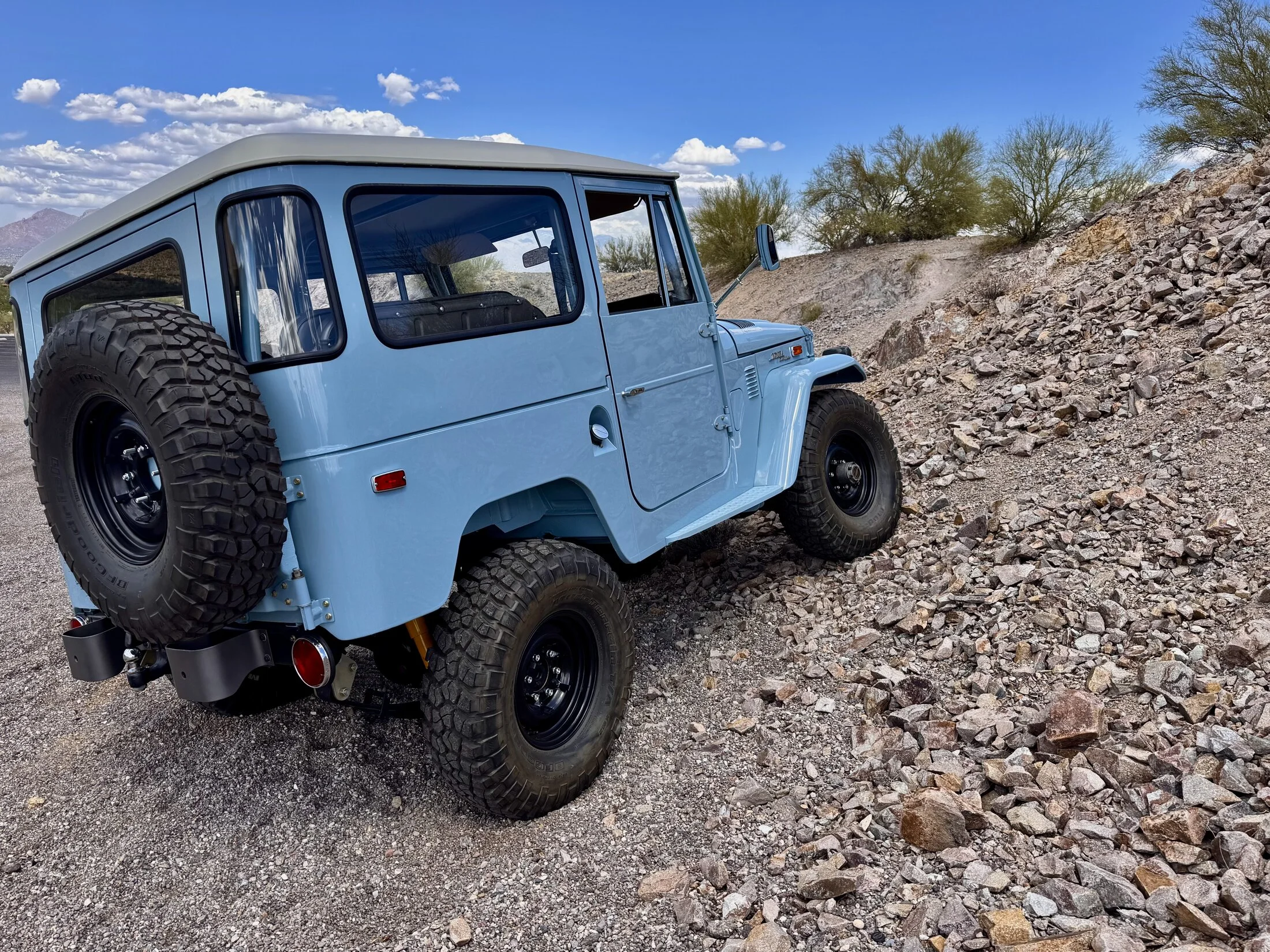

I’ve been trying to find a spot to flex it so I can check clearance- found the tire rubs the exhaust pipe - get to trim some more.
The good news is that 33” tires clear no problem. I’m not sure what the springs are but seems to ride decent and I almost flexed to the bump stop, again, pleasantly surprised

Looking good, springs appear to be Old Man Emu light duty.
Years ago I had 4"BDS springs that were military wrapped on both ends and I think hell for stout springs are too.

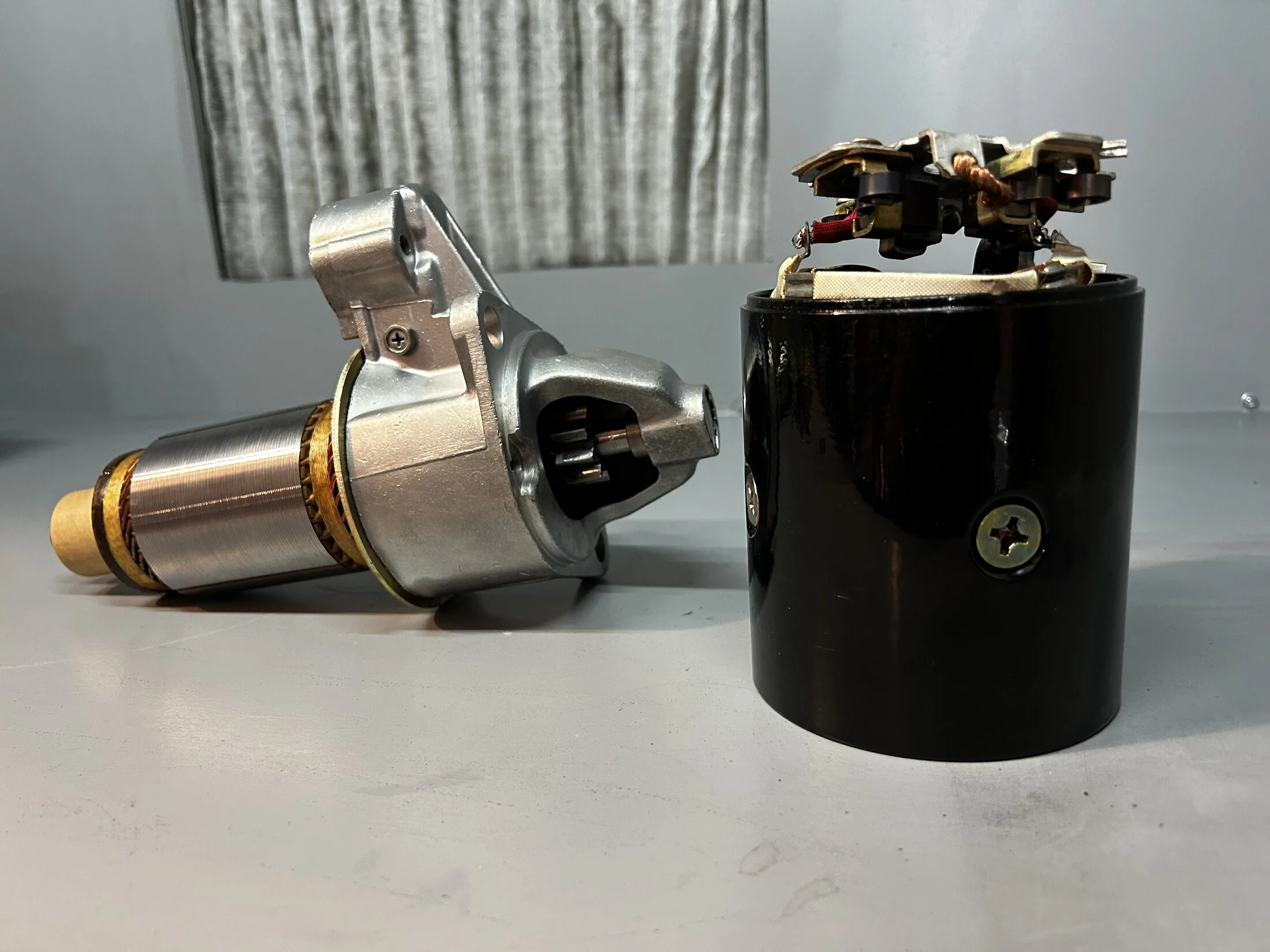

Tackled the restoration and rebuild of a Toyota OEM factory starter part number 28100-60041. The NipponDenso part # is 028000-236.
Vapor honed nose case, powder coated field coil housing, new denso armature, clutch, field coil, brushes etc. All insides are new or were in new condition for rebuild. These parts are difficult to source.

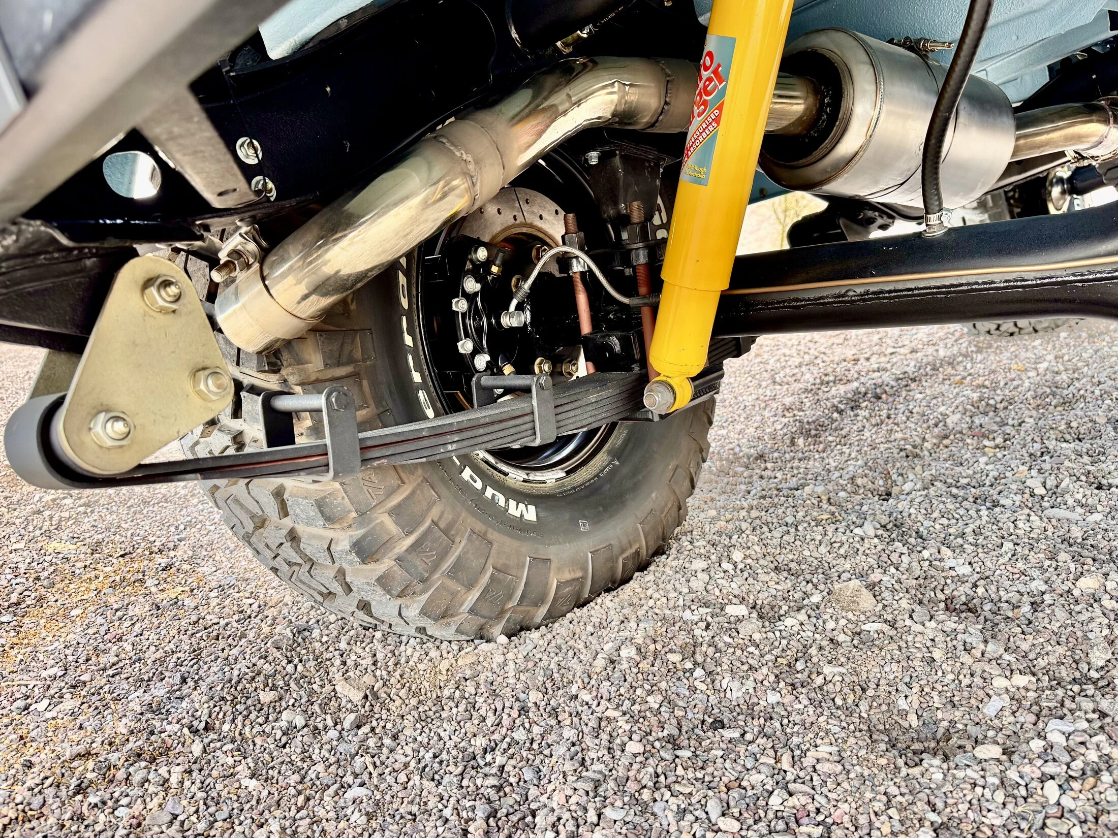

Will have a review as soon as it’s on the road- note the shackle angle with just the weight of the frame(I’m happy so far, also, nothing is torqued).

Rog- lift on the springs? Shackles? What rim/tire package is are you planning?
