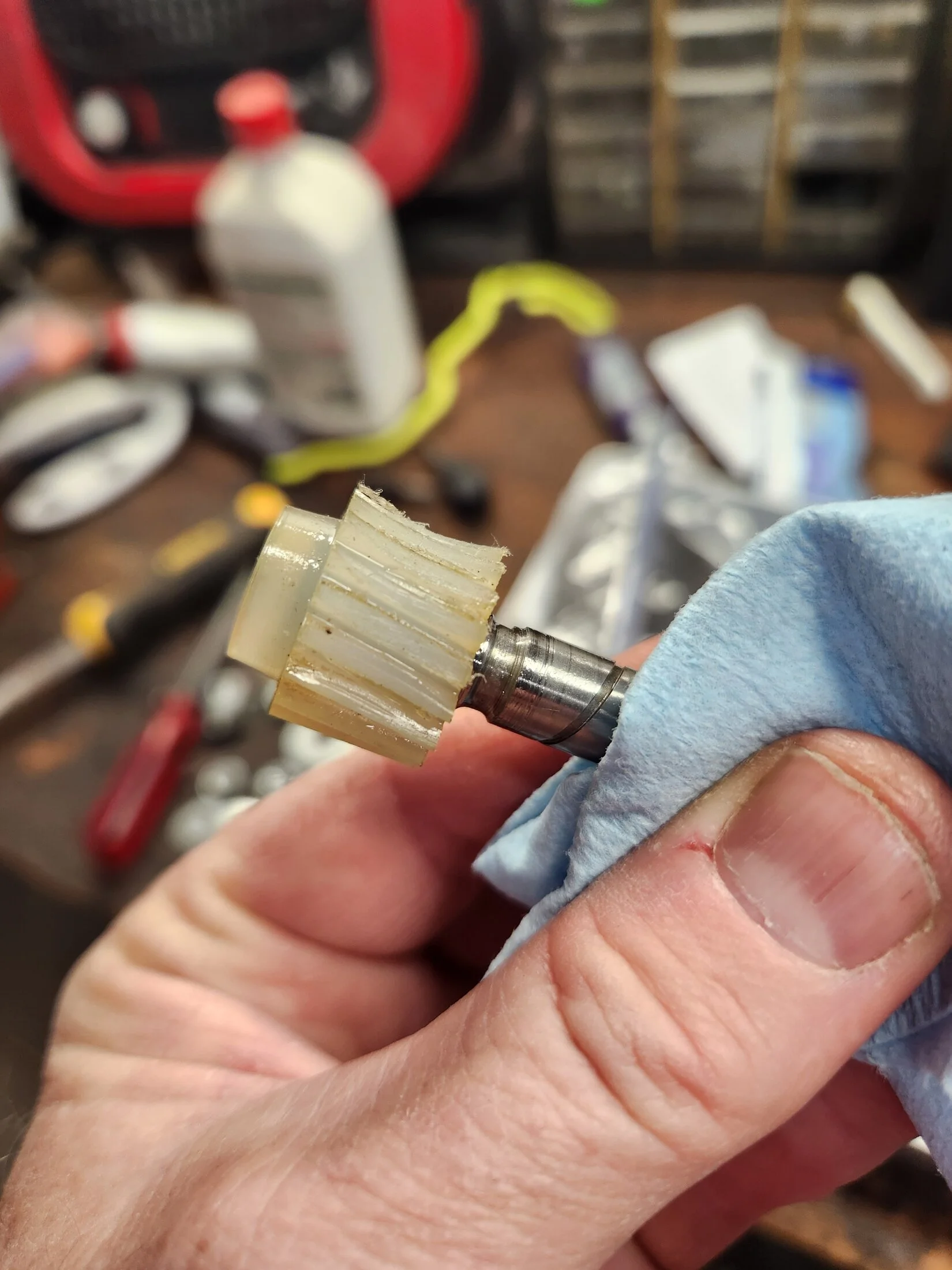

Once my Dad repaired a worn out NLA nylon speedo gear by heating 1/8" brazing rod segments about 1/2 long and melting them into the gear. He then filed the tooth profile with a needle file. I think he did 2 segments per tooth and it work like a champ for many years. +1 for changing mating gears as a pair if you can.

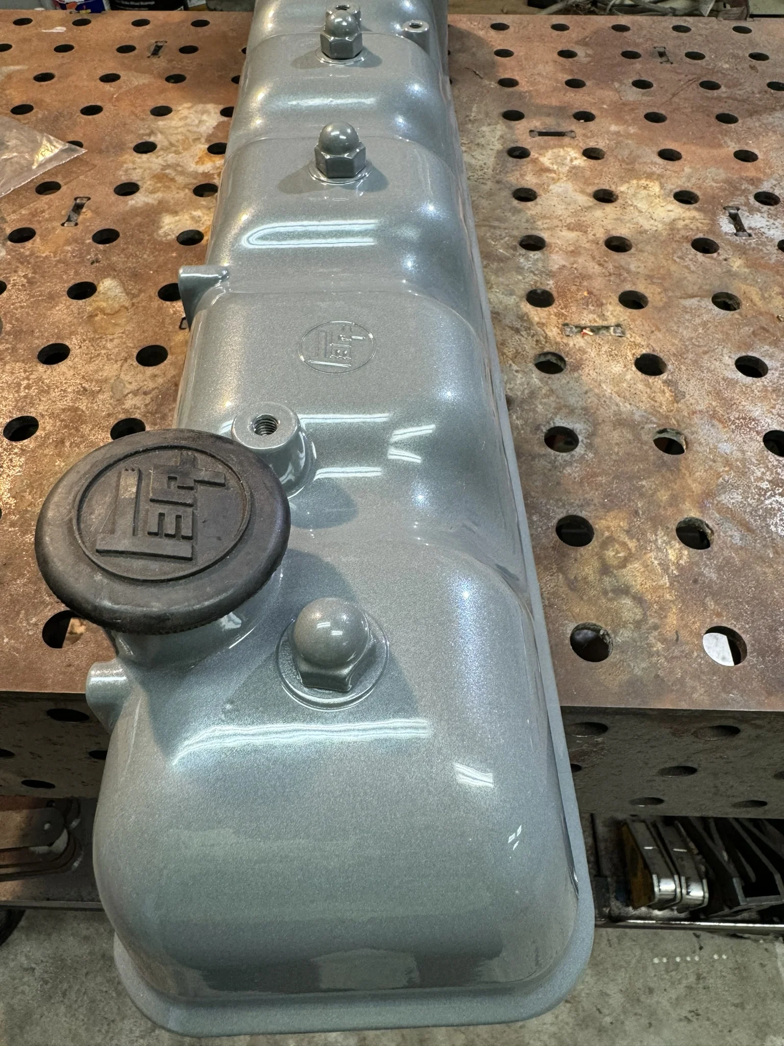

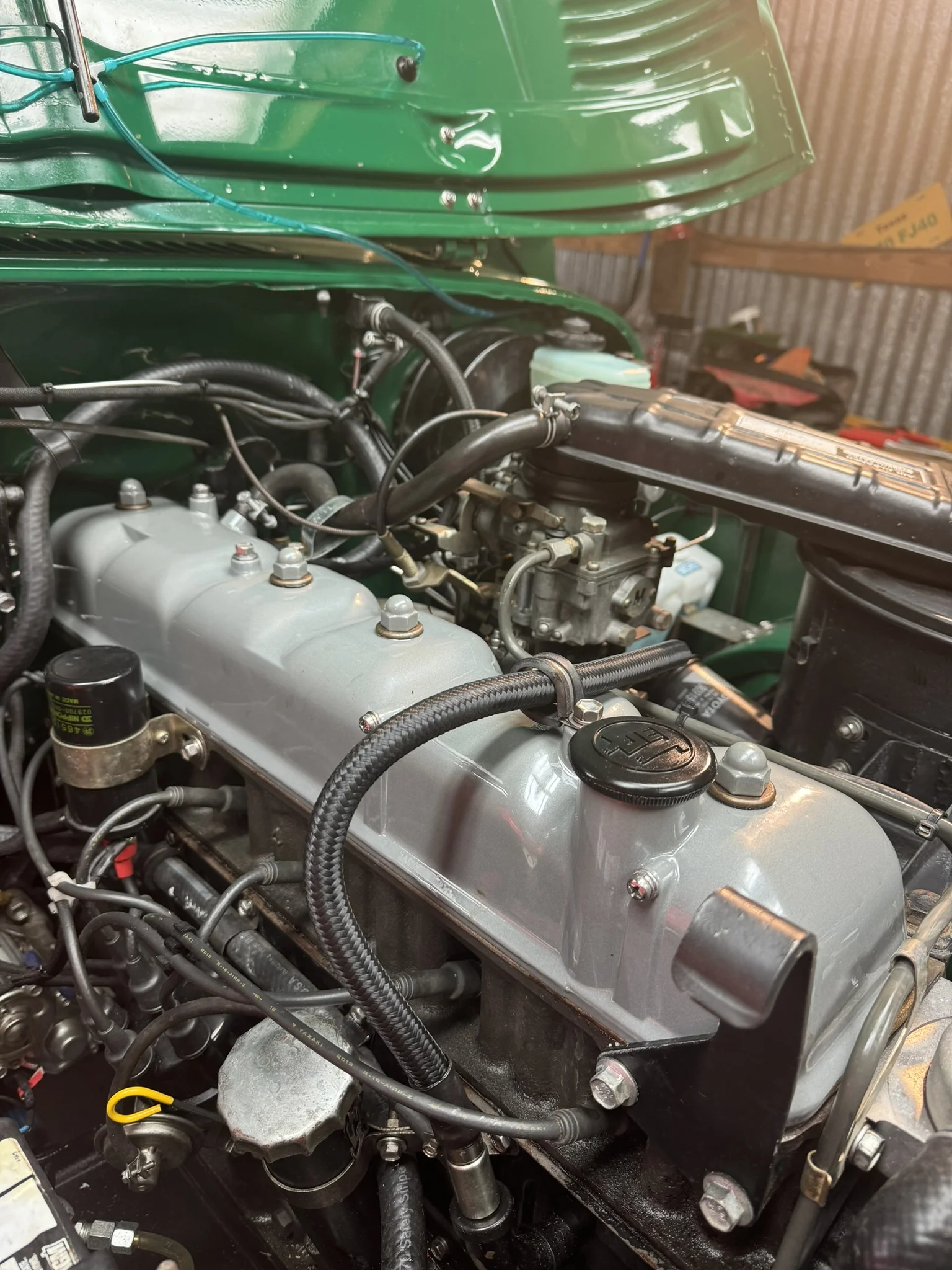

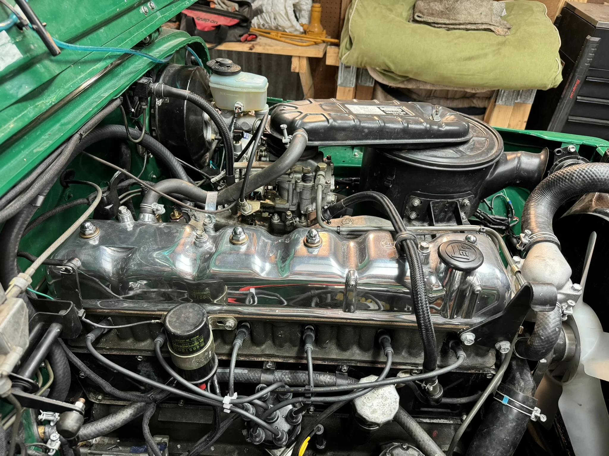

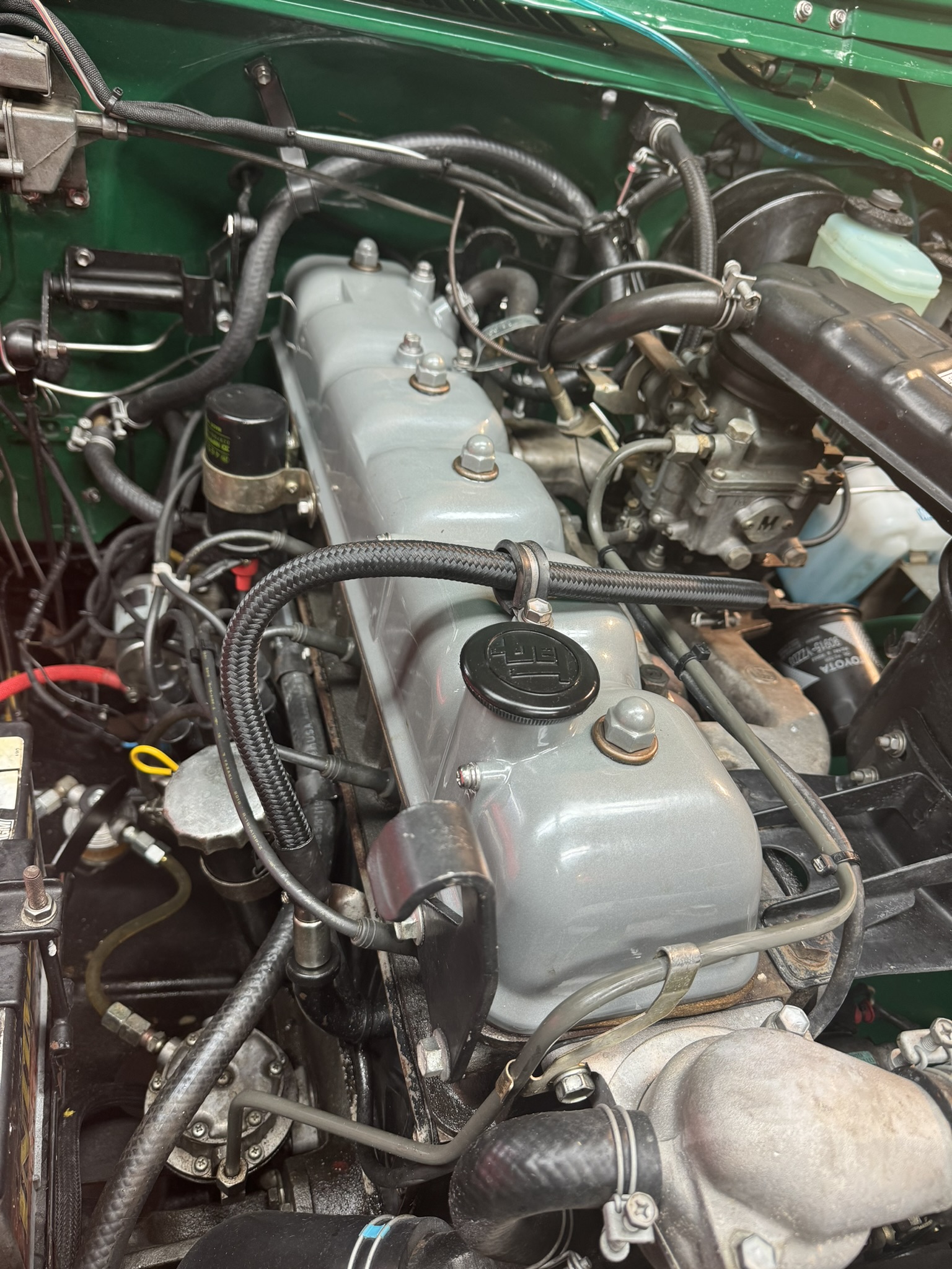

And now for something completely different... I had an extra aluminum valve cover and 4 acorn-style nuts, so just for grins, I had them powder coated. I removed the polished valve cover and replaced it with the powder coated one. It is definitely a personality change under the hood.
Before:
After:

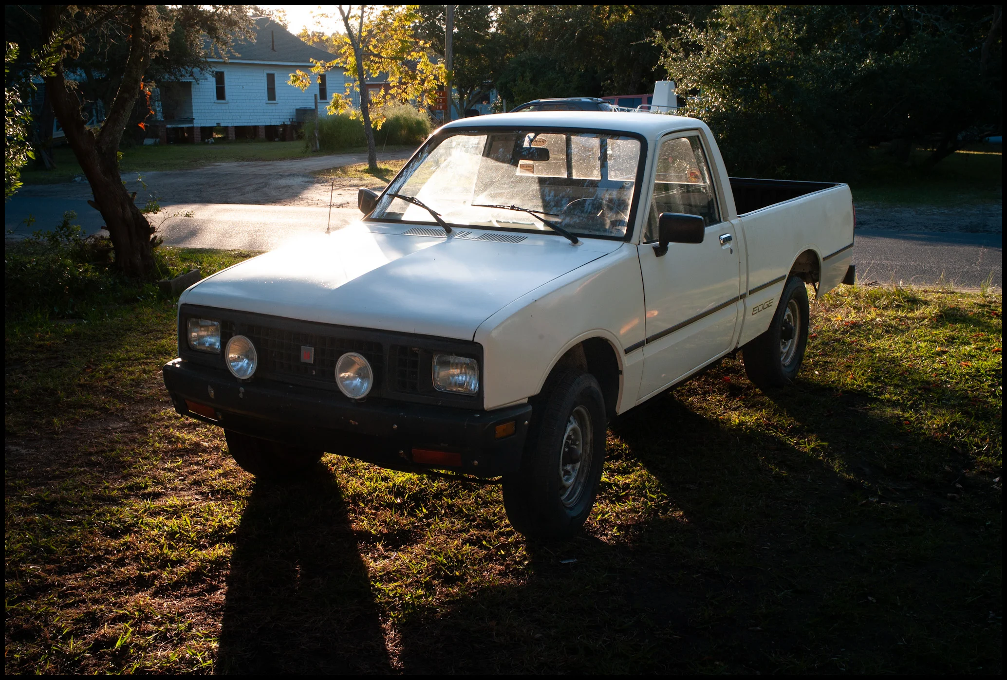

I bought a 1987 isuzu pup so I could work on the fj40... haha sorta. But it will be nice when I need to do my knuckle job and windshield gasket on my saltwagon Fj40

@Green Bean that does look nice…the polished valve covers for me, were always a source of labor. I found them demanding time polishing them to keep up appearances. A tube of simichrome was always 1/2 empty. Particularly on the motorcycles. My 45 has a polished one and the 40 was painted green.

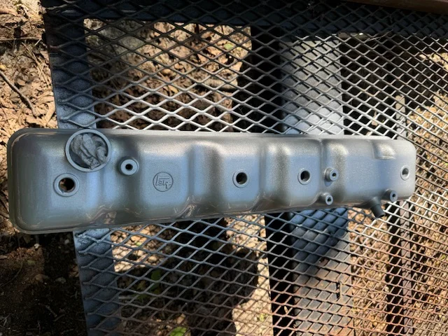

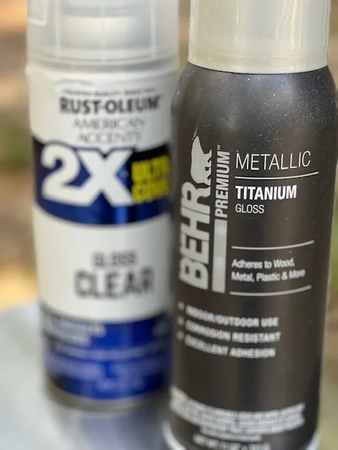

Back when I did the sniper install I stripped it and used a new gasket to paint it…it’s not powder and it would be good if it was but I have not trouble so far and it looks REALLY clean. I have been using this from Home Depot and then clearing over it with this other stuff… glossy as hell, cheap and quick

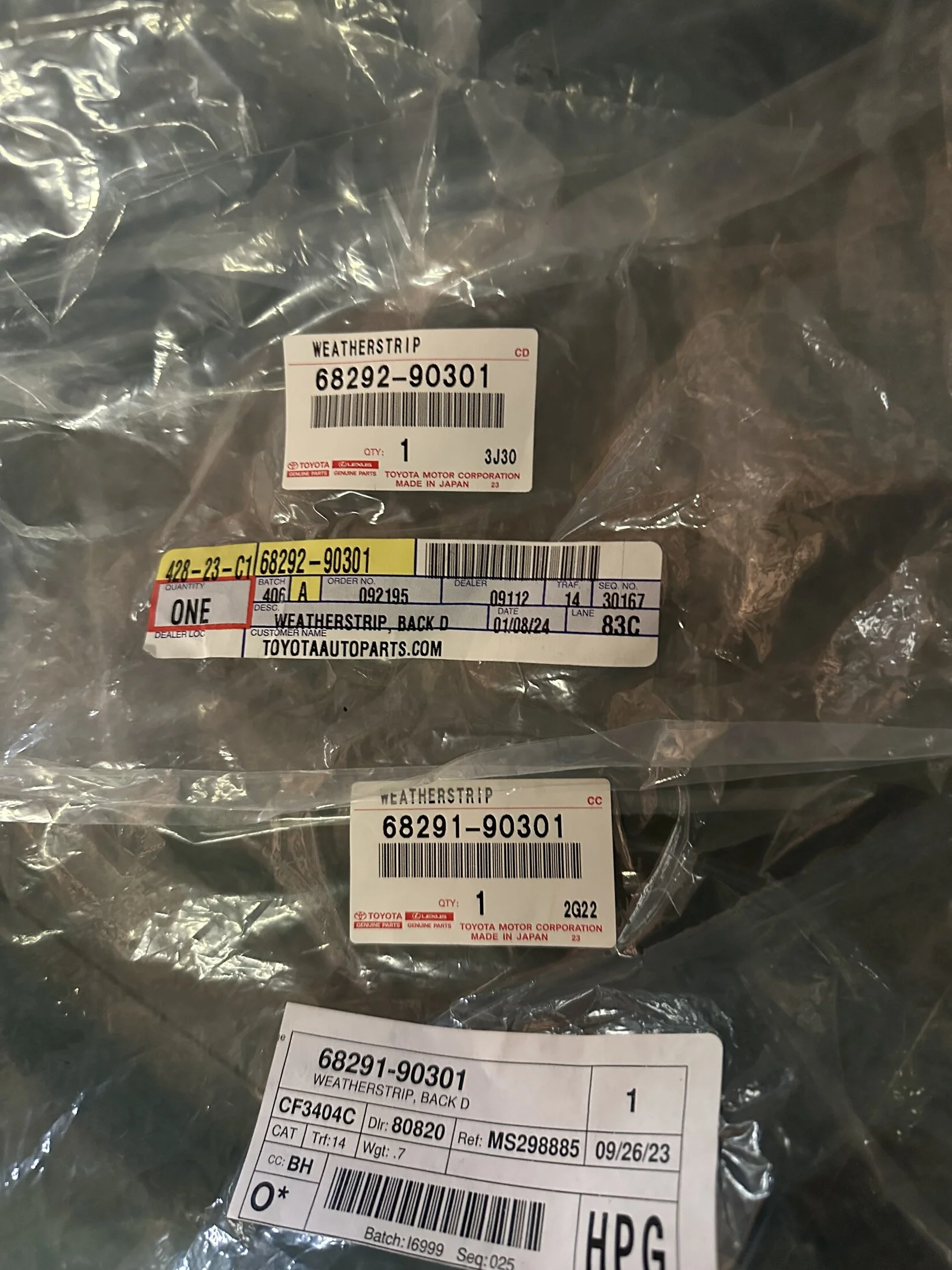

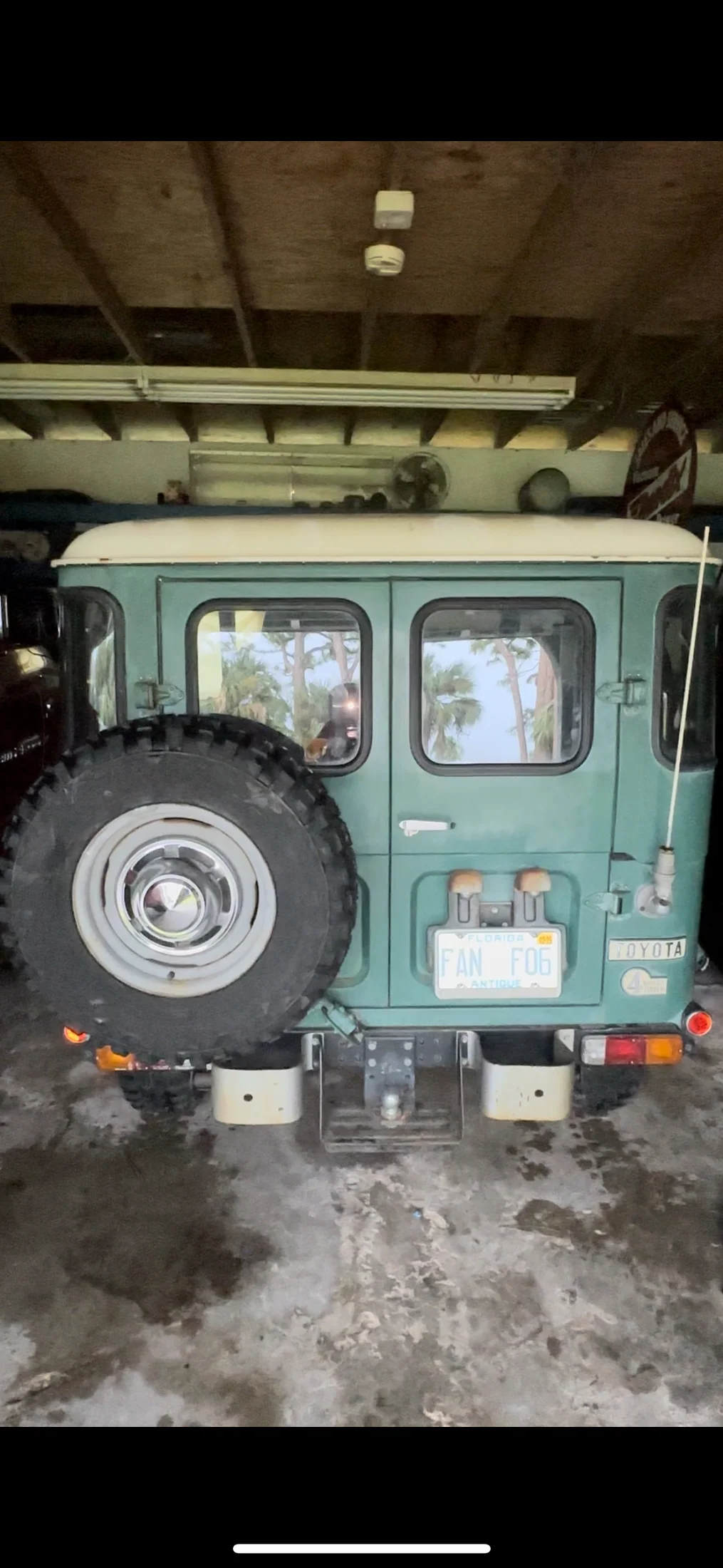

I redid the weatherstripping on the ambulance doors with OEM Toyota weatherstripping part#
68292-90301 & 68291-90301.

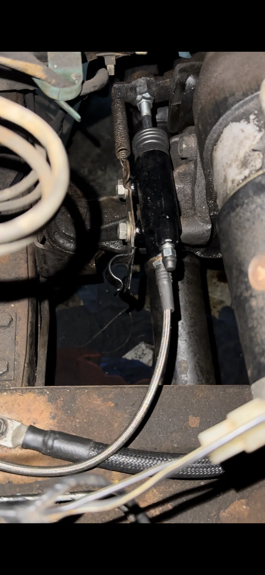

Changed out the slave cylinder which was most likely the original since the flex hose had a band with “3/77” on it indicating that was when it was put on and that’s the original build date for my 40.I went with an Aisin replacement and replaced the line with a stainless steel line from Manafre. I also replaced the air cleaner to carb gasket & some other weatherstripping on the rear sil and front doors got that from City Racer.

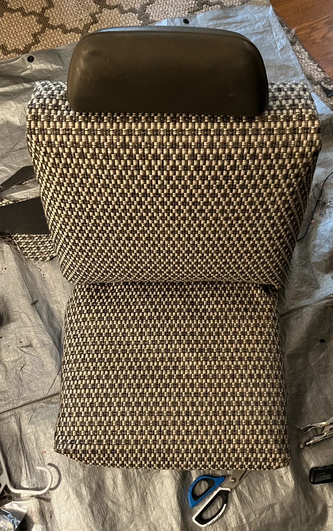

Ok, so my seats were recovered many years ago with a fabric that didn’t appear to like the sun! The passenger seat below is nothing compared to the drivers seat. My son’s GF asked if it was attacked by a bear… lol
I thought I could just cover them with an outdoor carpet with some waterproofing. Below are the results. Kinda looks like my grandmas old couch now… or like I covered them in carpet (which I did) lol. better than a bear attack I guess.
Passenger seat before:
Test fit:

The shiny polished aluminum valve cover is nice but our engine bays are practical and utilitarian. The color you chose just fits.
I bought a powder coating kit gun from Eastwood and enjoy the process. It’s very easy. The powder from Prismatic is great with baking time for some powders under 15 mins. The hard part is getting oven large enough and then hangin the parts without bumping into anything.
