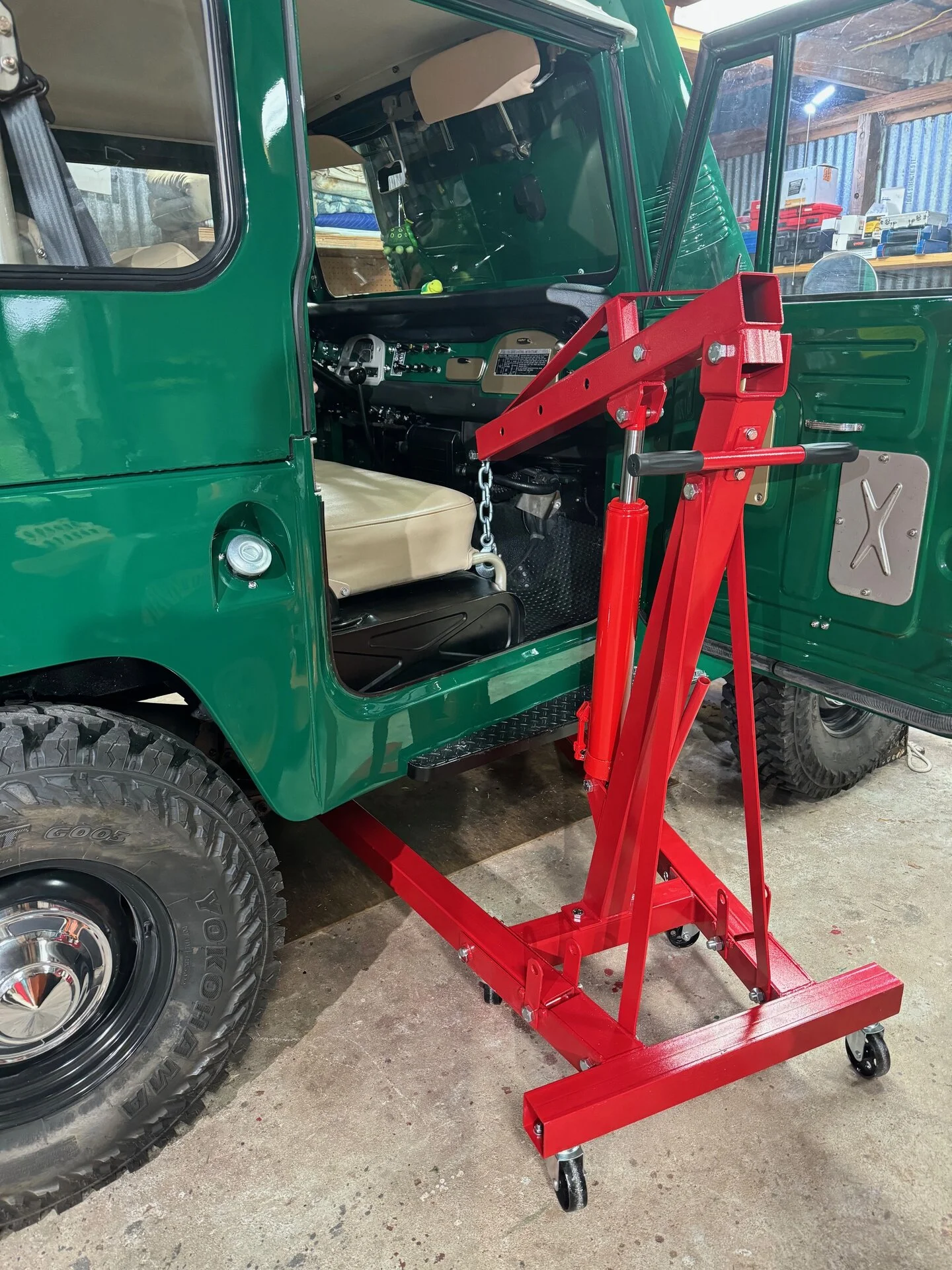

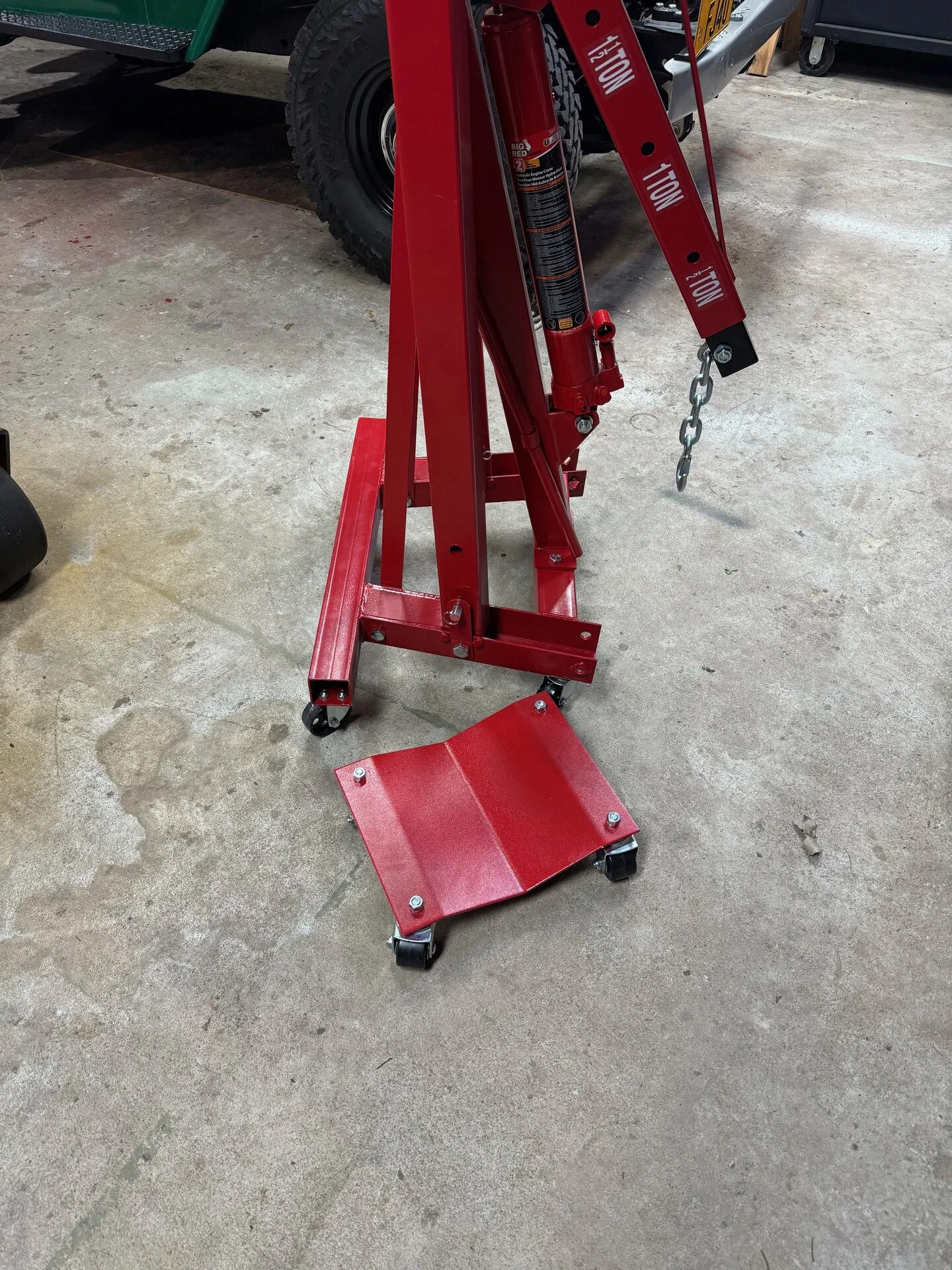

Green Bean, I used the poser method with small zip ties vs string. I also left my pan on top of the gasket with some weight to help meld the cork in to the corners better too. No leaks so it worked. Good luck!What better way to spend a rainy Saturday morning: Trial run for the hoist, getting closer to the 4-speed conversion project. Also cut some slots to make dowels for installation of the oil pan and trans swap.

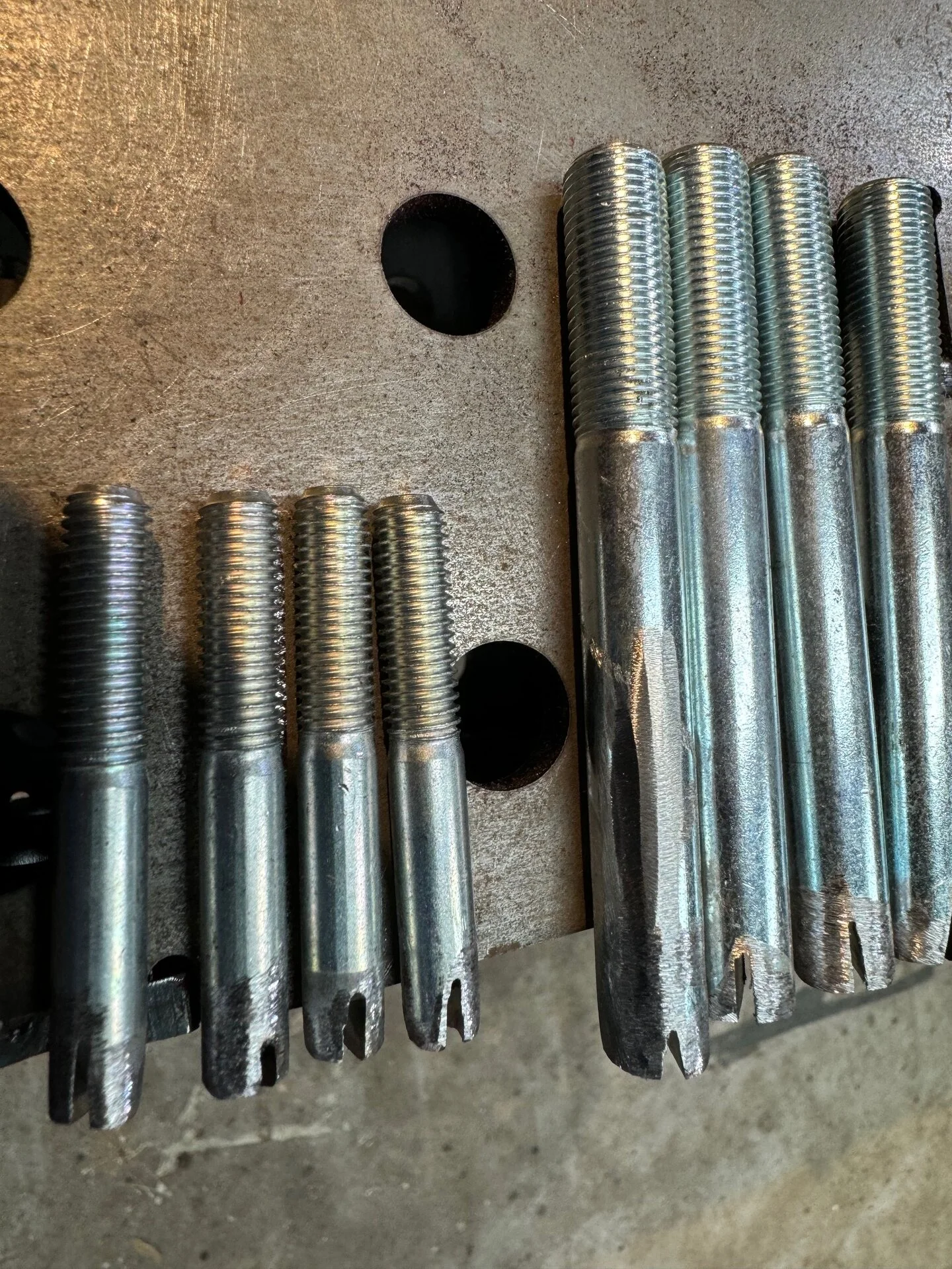

New rear suspension parts..
Do you just drive out the old ones and insert these or is there an STS?I recently used these bushings https://www.amazon.com/dp/B000CNB3FQ?tag=ihco-20 when I swapped out both axles. I previously had the OE bushings and can say after the two spins around the block that I do like these bushings better. I also noticed my lean was less noticeable afterward too.

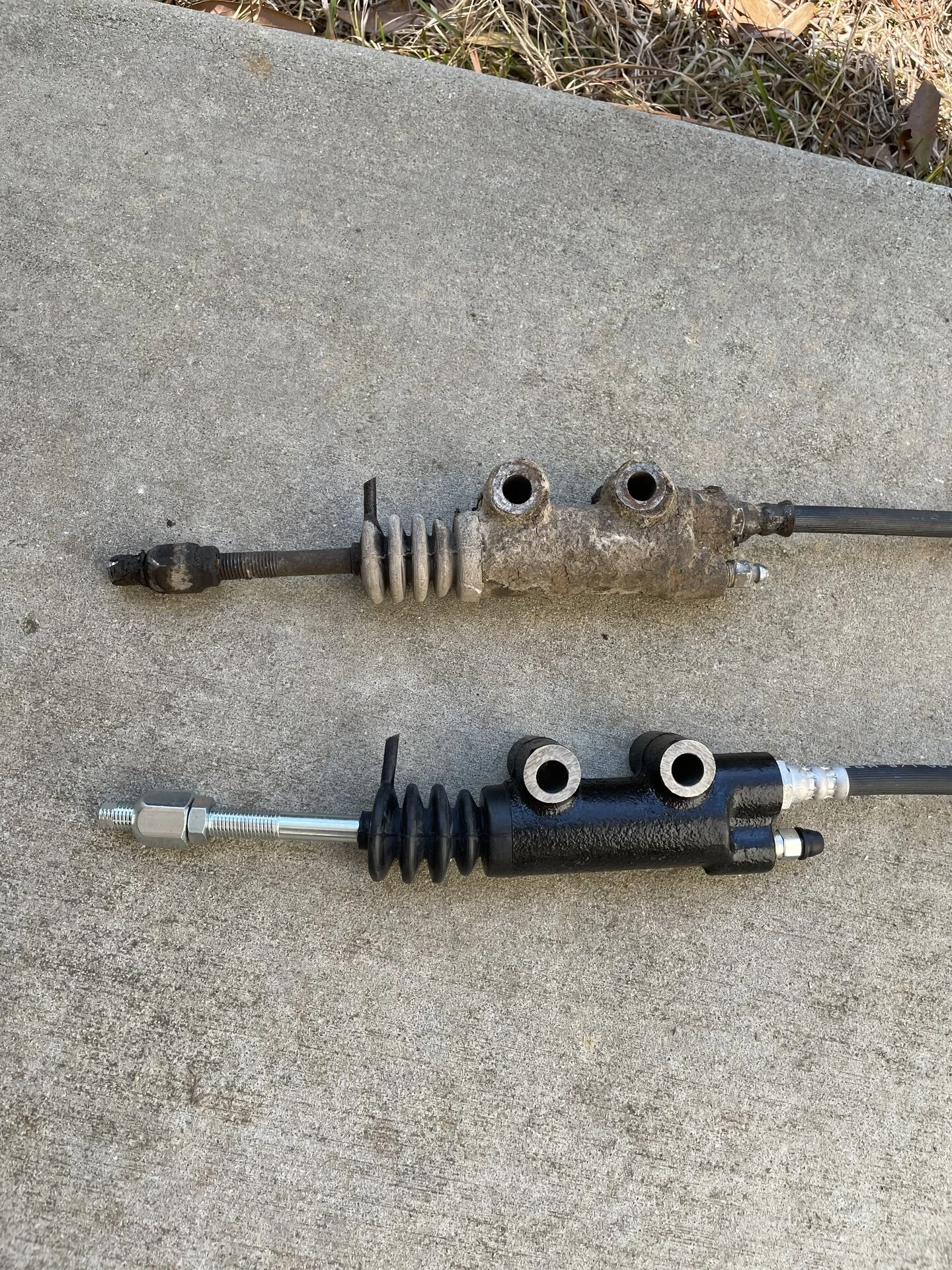

Slave cylinder blew so replacing with new one as well as new master cylinder and oem rubber hose from City Racer. There shipping was faster from California than the Toyota parts deal clutch spring coming from Florida. Ordered the slave/ master cylinder last Saturday and got here on Thursday usps. Ordered the spring from Toyota parts deal at the same time usps and it’s still not here. Supposedly Monday now.
Almost stripped the hard line so we’ll see if it leaks. Where is the best place to order a new one just in case?
View attachment 3549401View attachment 3549402
I did he same. The braided stainless line seems high quality and I hope it lasts a long time...I recently installed the master/slave combo from JT Outfitters. It came with a stainless steel braded Teflon line. Easy enough to replace the hard line. I think they sell it separately.

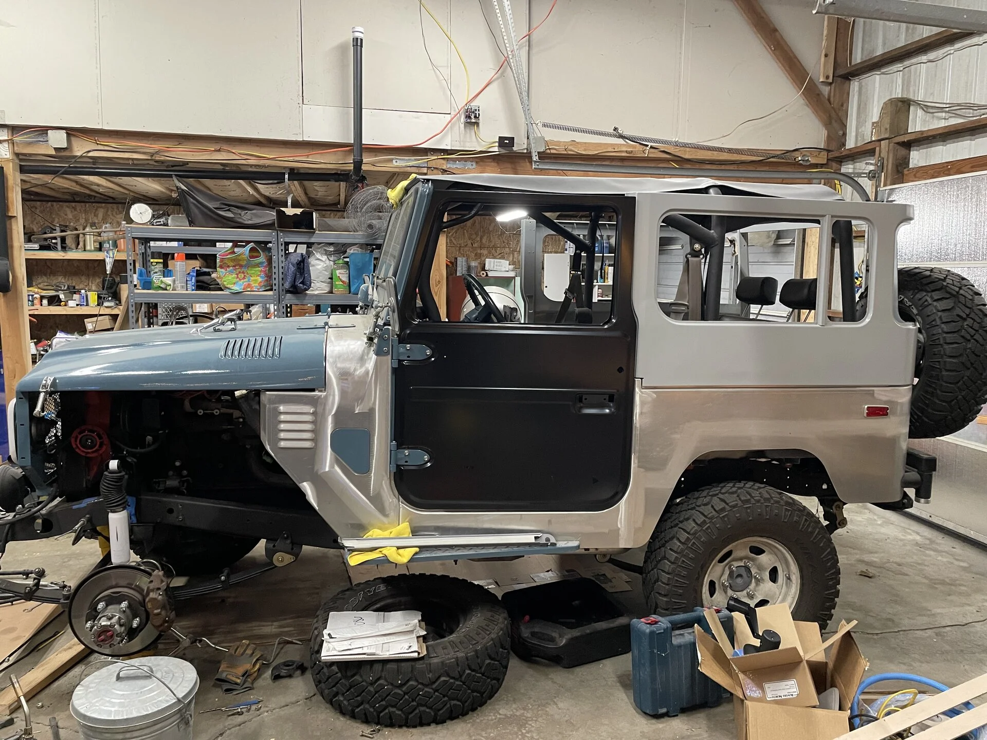

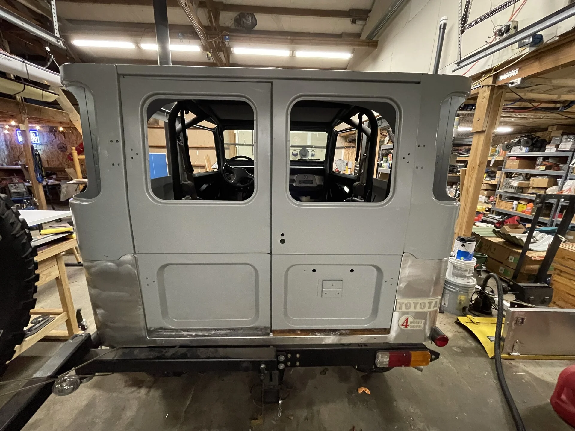

Working on replacing the old mini-truck power steering with fj60 PS setup. Also, adding seat heaters and new foam to the stock seats and getting View attachment 3549260the hard top, sides and rear door repaired.
