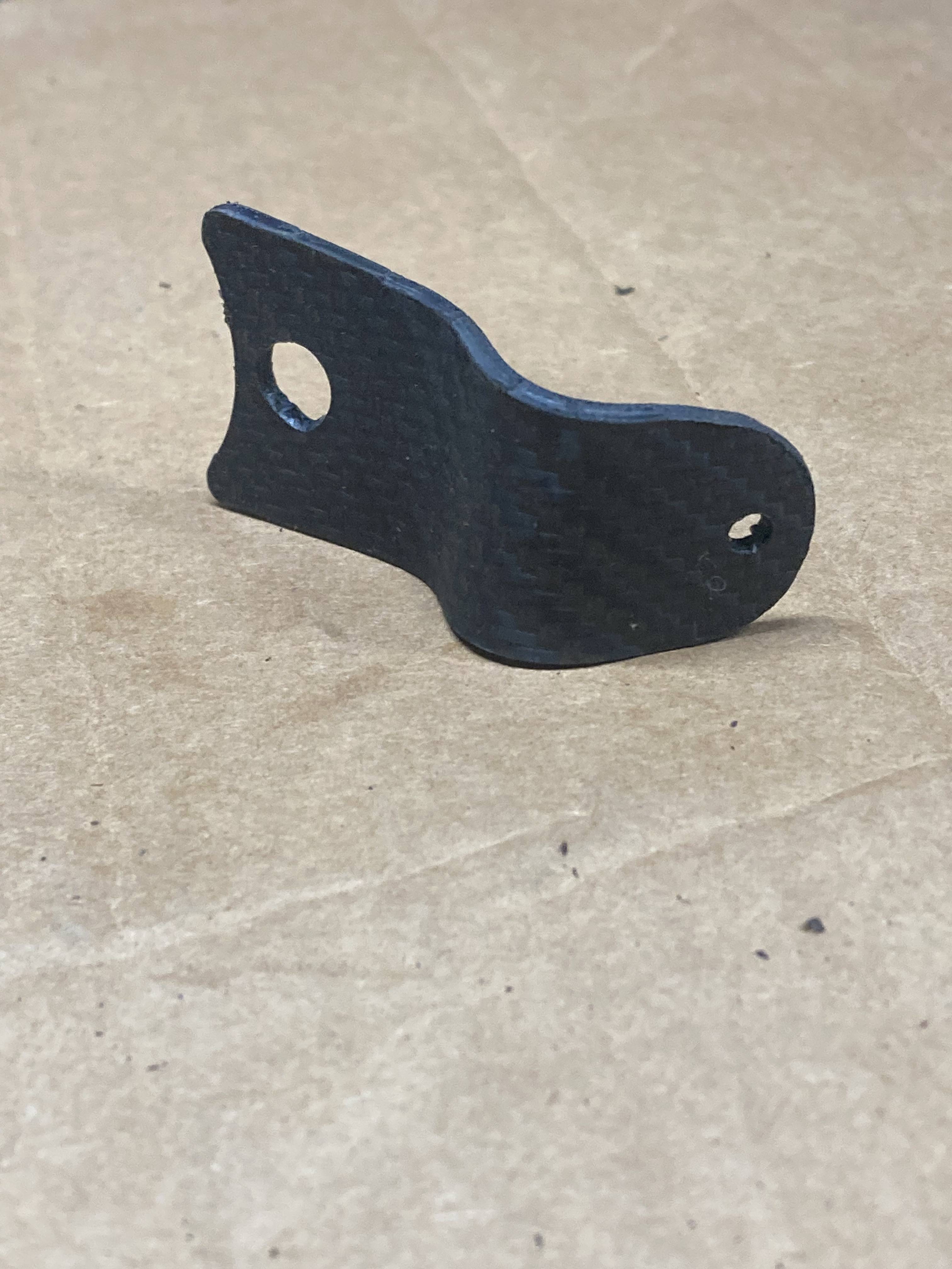

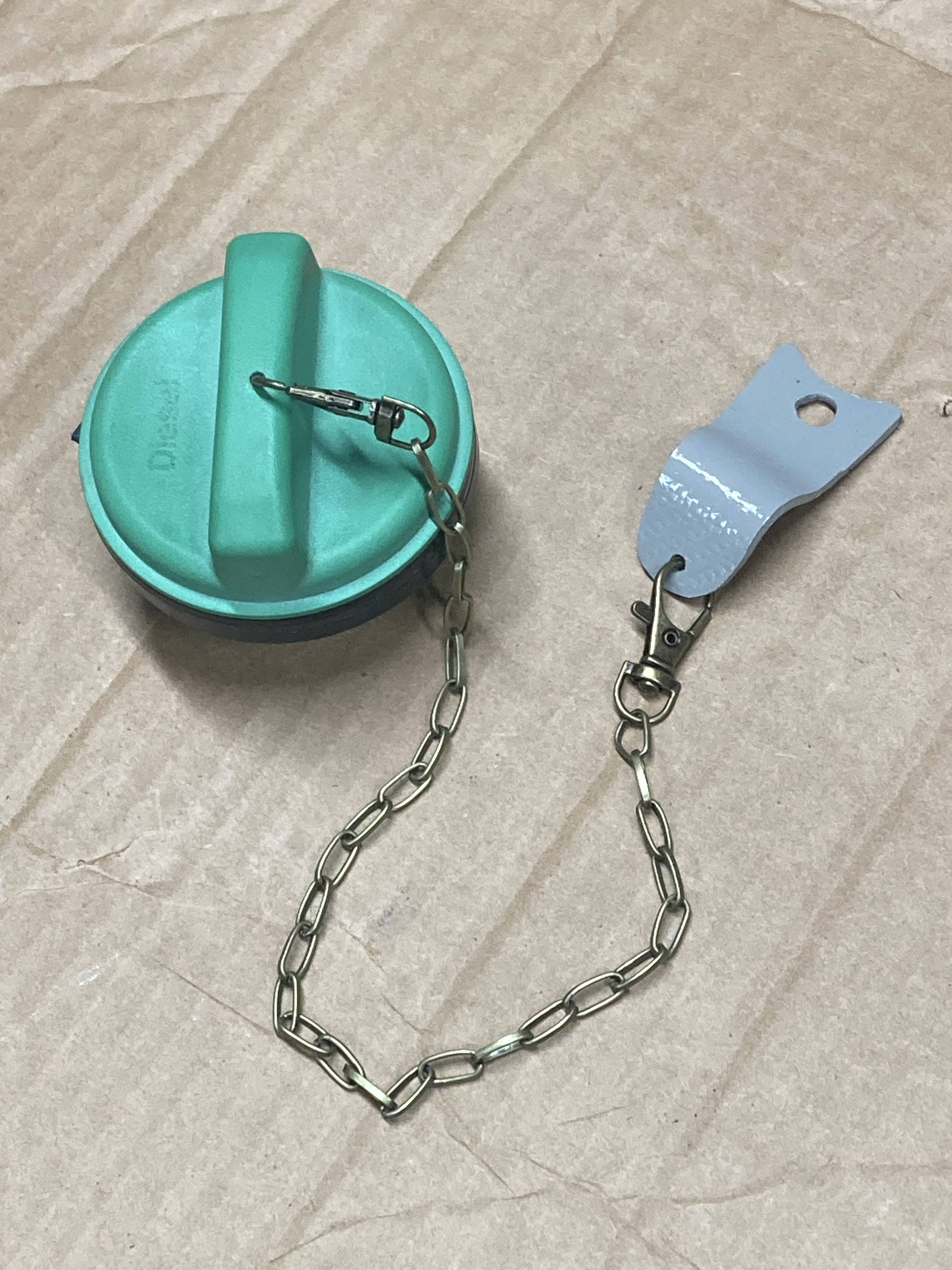

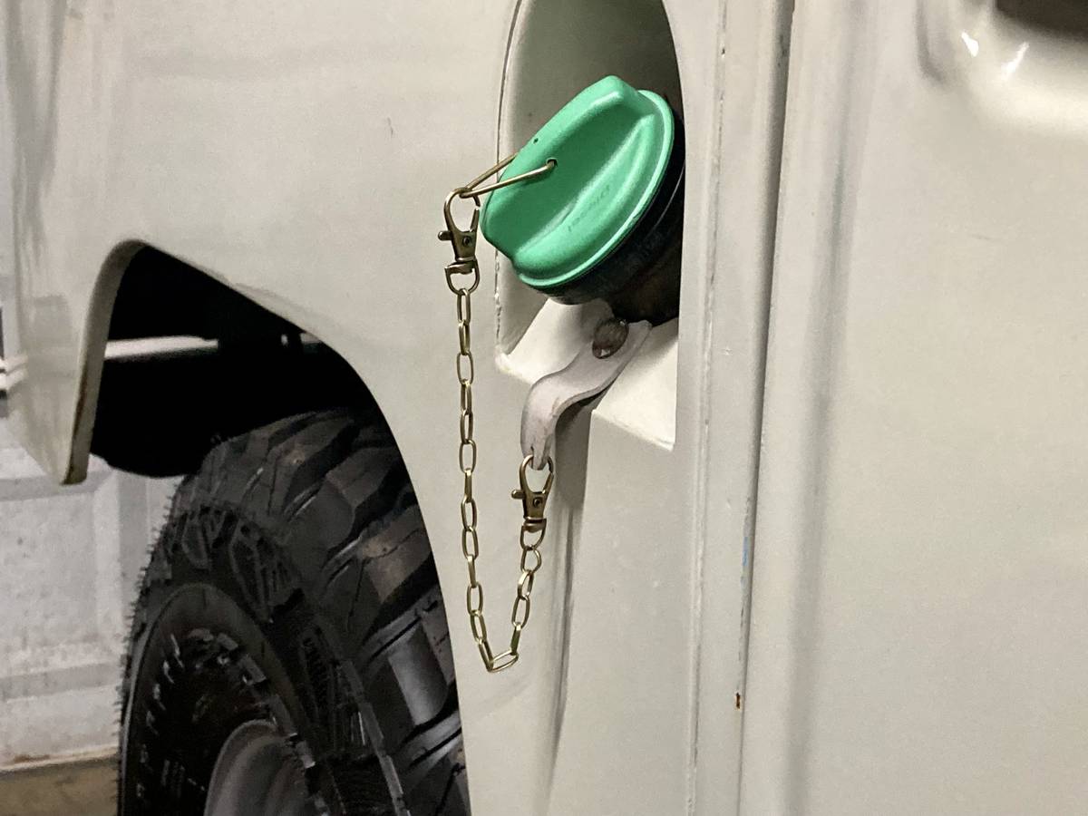

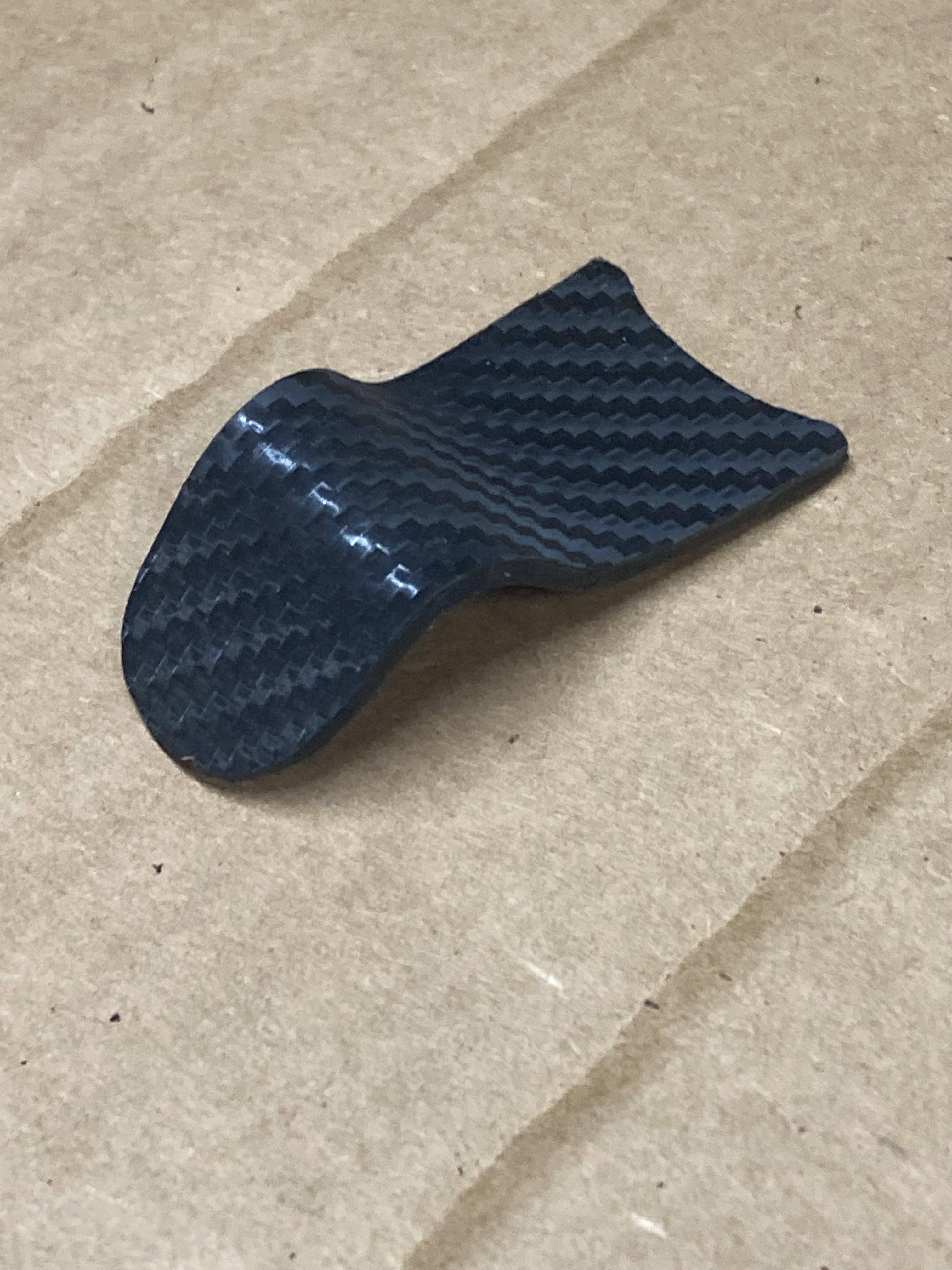

My BJ40 doesn't have a fuel cap door so the fuel cap is exposed. I decided to make a fuel cap lanyard to give it a vintage look so I made the lanyard using a small bronze chain link and a couple of swivel clips. To mount the lanyard to the body I fabricated a bracket out of Kydex I've been working with kydex for many years and as a side-hustle I make and sell stock comb risers for specific rifles.
The bracket is secured to the body by the bottom bolt in the full cap housing. I think it came out okay..

Nifty idea only I'd think might the chain abrade the paint at speed?
I thought about that. I could shorten the chain a bit and easily heat and move the bracket tip out about 1/2 " making the chain hang away from the body...
What about coating it? Maybe with some heat shrink or something similar
Or maybe nylon chain/wire? (I agree the metal chain, even if shortened, will scratch the paint - but like the idea 👍)
It shouldn’t be an issue if I shorten the chain enough to just loop a few links onto the bracket. As I posted previously the chain connecting point on the bracket will be adjusted and spaced further away from the body.

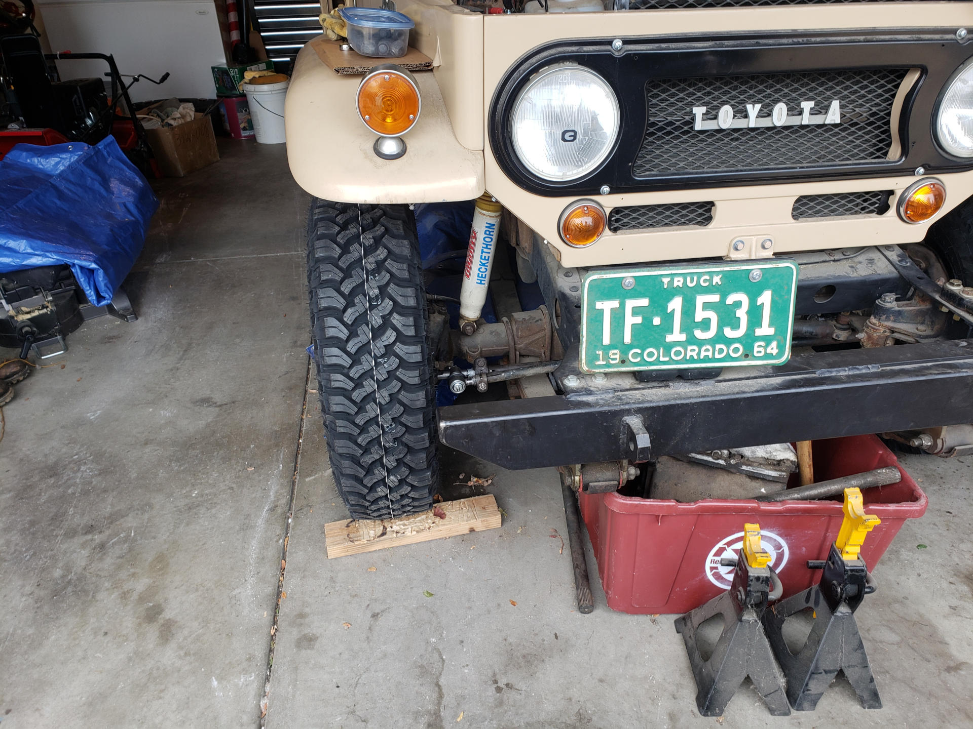

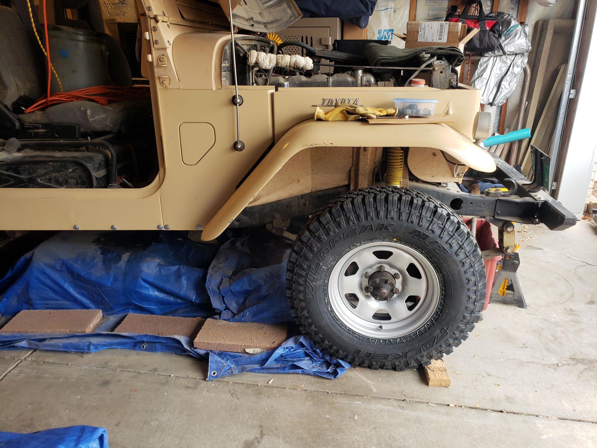

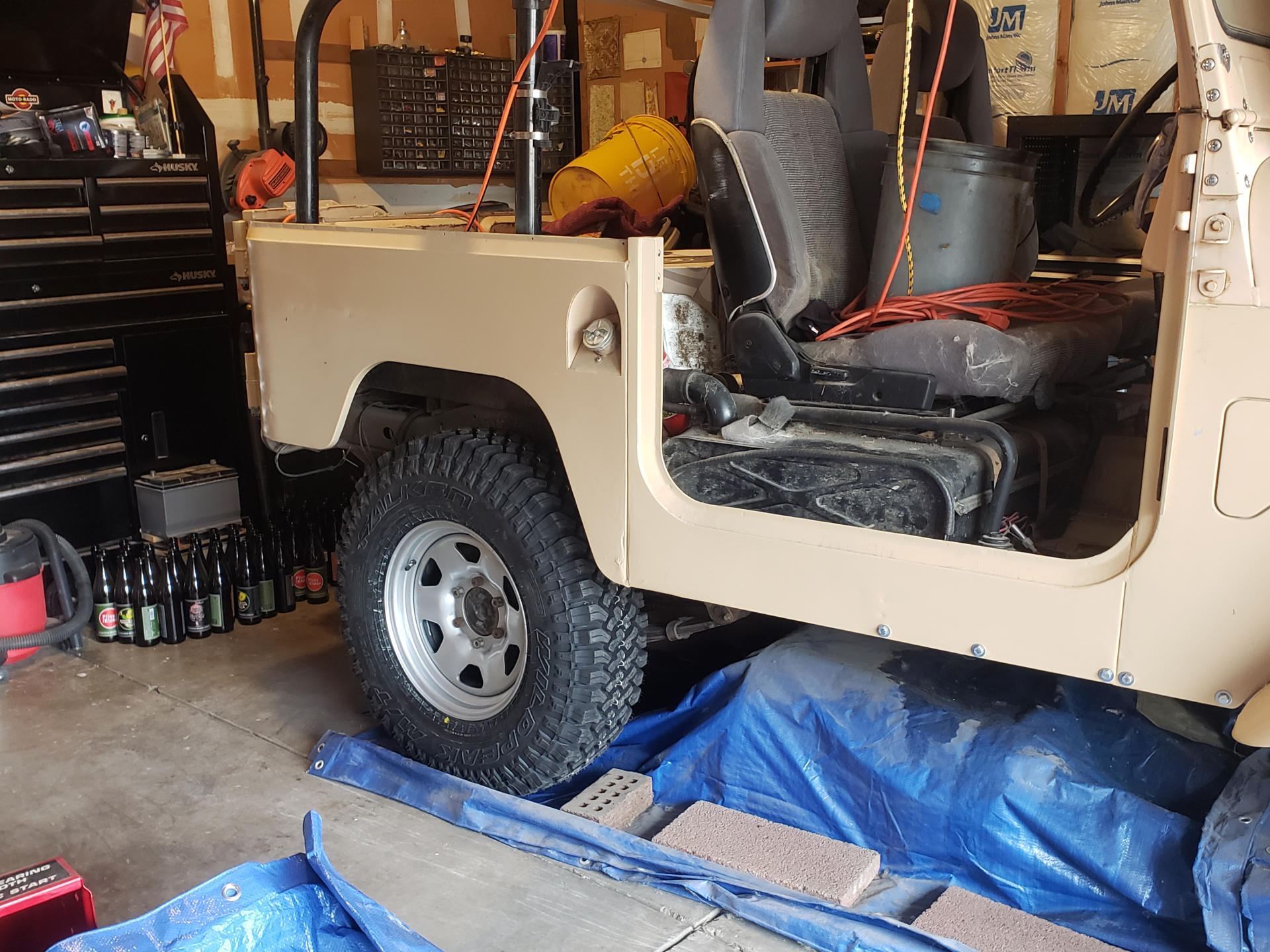

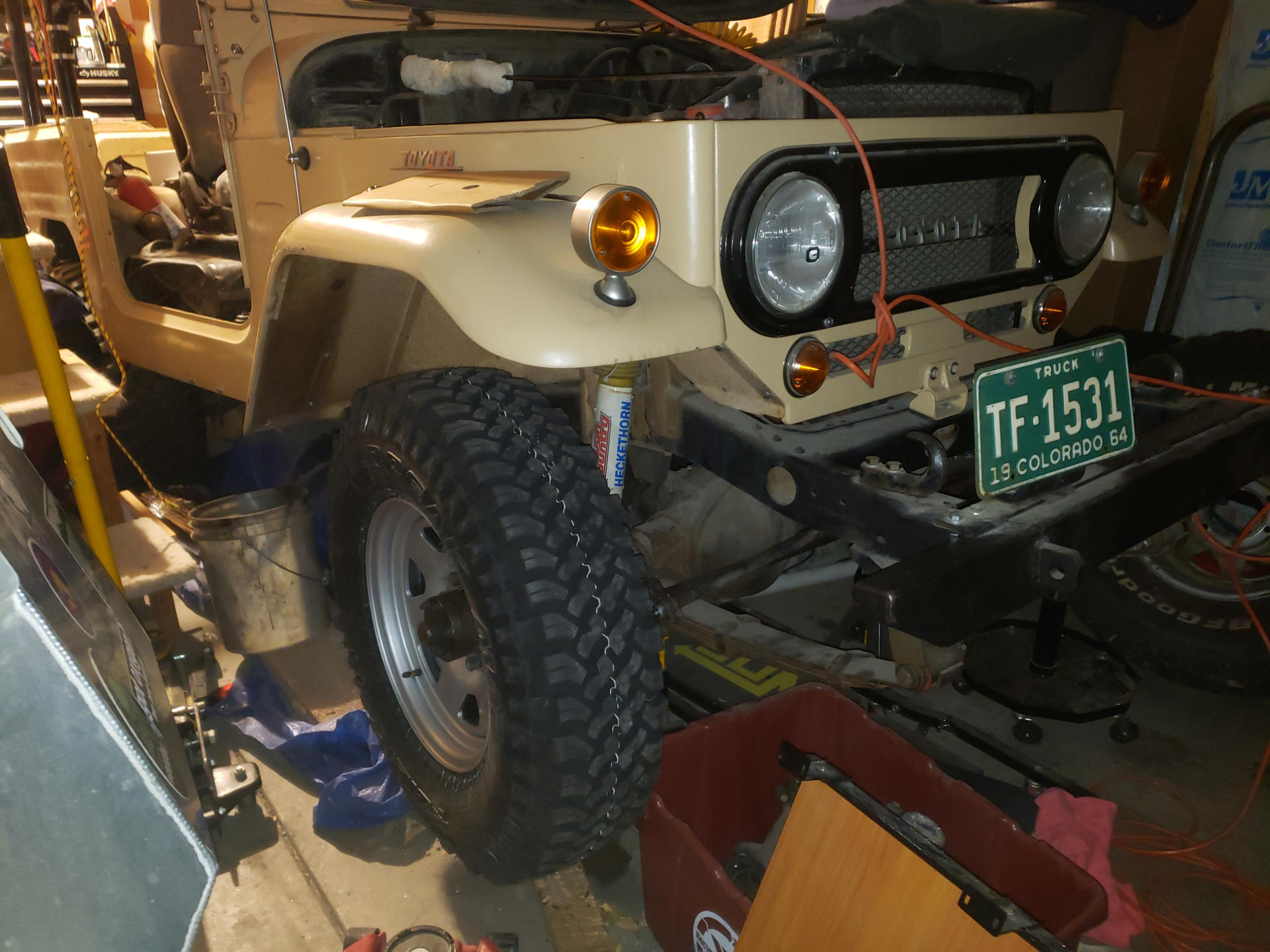

Got 'em mounted! My 40 has four inches of lift...
