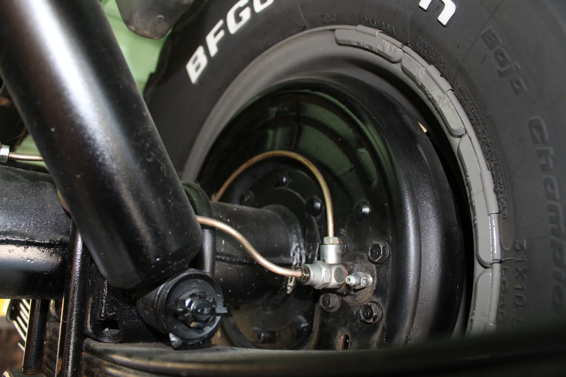

Yes, except that the front end has one inlet now instead of two, and I’ve put a later model (dual res) master cylinder on in place of the old single. I’m thinking of upgrading the rest of the system (lines and rear cylinders) to late model oem for ease.
I made my own lines and used late 70’s rear wheel cylinders that don’t have the split line. Plumb the inlet line into 1 wheel cylinder, then outlet of that into other wheel cylinder inlet. Simpler than the early 70’s cylinders, especially if you don’t have the special fittings. (1971 style in pic).
