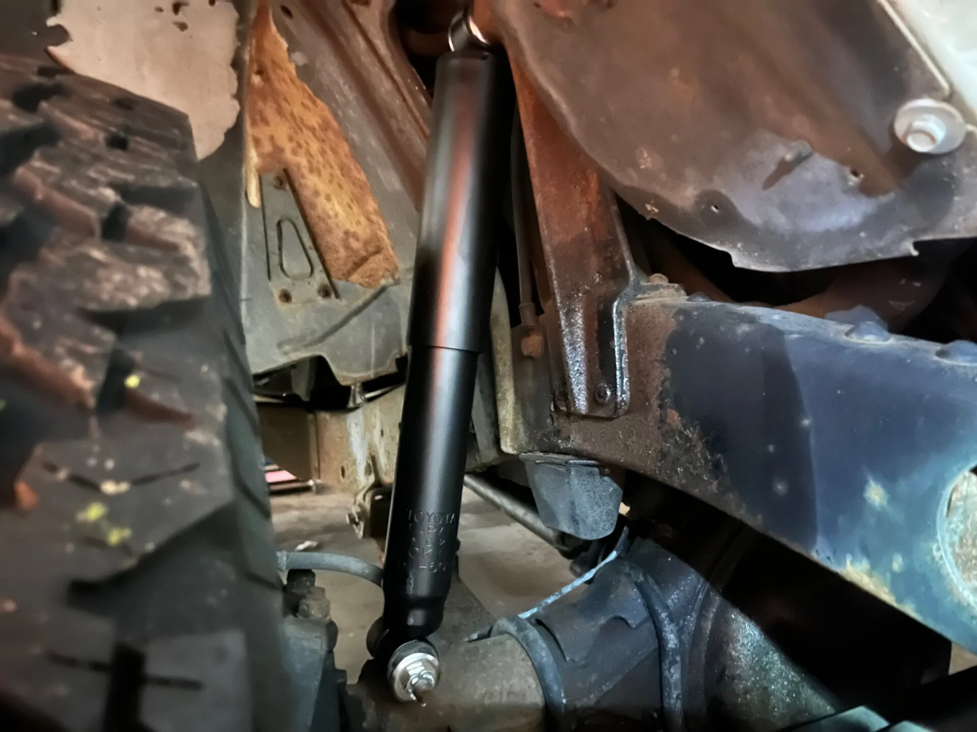

4 new OEM shocks for the 40. For the life of me, I can't figure out how someone could install all the washers backwards. Also, no castle nuts with cotter pins were used. Therefore, some of the nuts were backed off to the very end of the threads, and some were even gone. Most of the inserts were gone too. The ones that weren't were completely shot. From what I understand, the shocks were last installed by TLC when they were out in California. FWIW, the shocks I removed were Old Man Emu's.

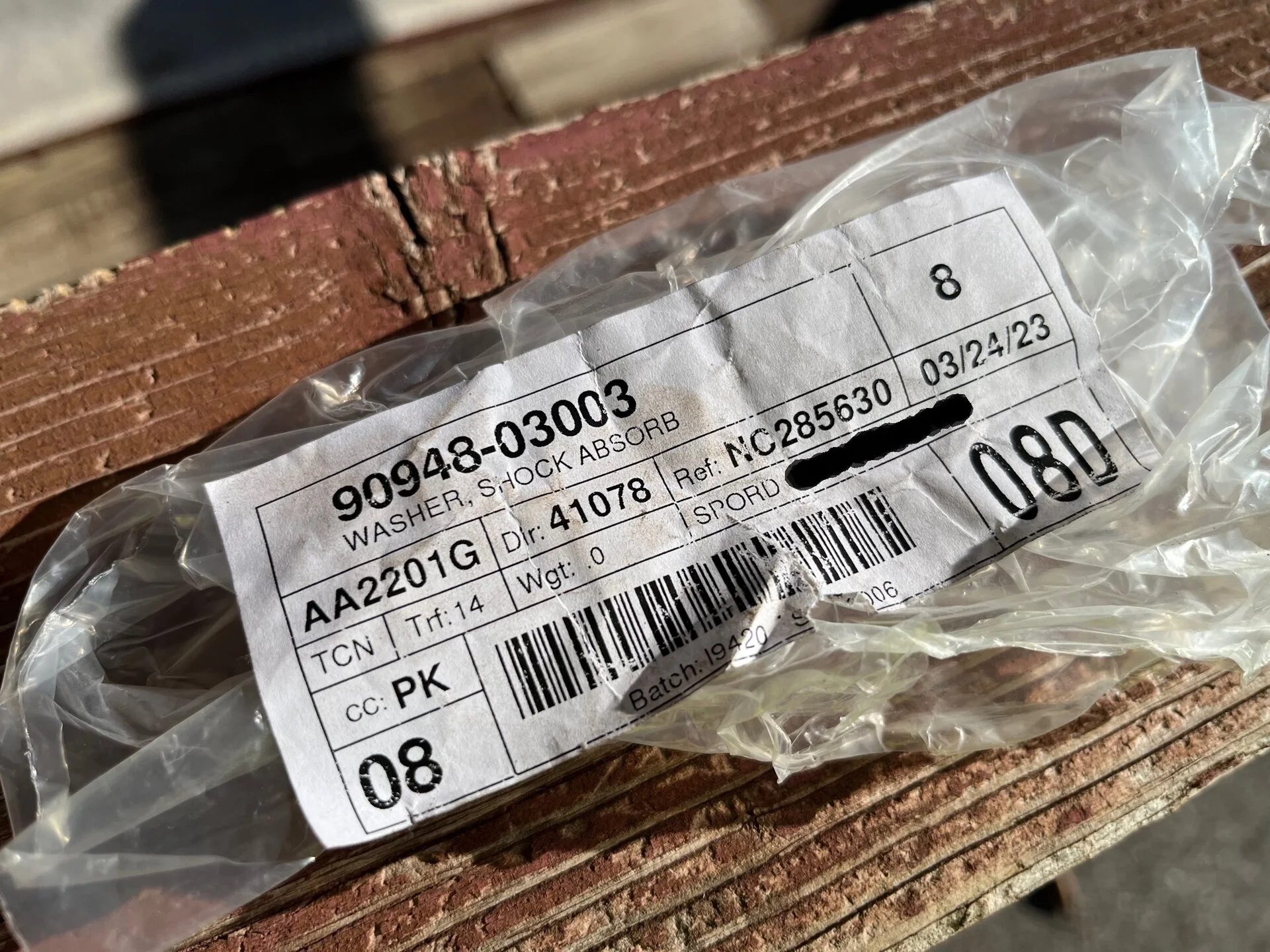

The Cruiser Outfitters sticker was placed over the top of the Toyota sticker, so that's why it's kind of messed up looking, but I was able to salvage the numbers for you. I got them from Cruiser Outfitters because Toyota had discontinued the rear shocks.
And here are the numbers for the inner and outer washers for the shocks...

Wow sir! Thank you very much for sharing those! Yeah those are some superseding numbers that I couldn't find in the old Microphish scans, very cool! I'll do some research to see if they will work with extended shackles, I guess it just depends on if they will extend far enough. My current "good enough" cheap yellow shocks were all about getting it going, now I'm experiencing parts envy seeing these gems. :) Have a great day!

You're very welcome. I don't know, but just by handling them, I kind of doubt they will work well with those extended shackles. If I didn't go with these OEM shocks, I would go with Bilstein. (although, it seems a little like an abomination to put a German part on a Land Cruiser) Good luck to you!
Curious what others say, but I don't think those washers were installed backwards. If I remember the OME instructions, they're supposed to have the cup portion facing away from the grommet.
That is true. They should cup away from the rubber portion and ride on the center metal spacer. Note in pic through fender washers get installed opposite of being mounted on a bracket.
I'm no engineer, but what purpose could that possibly serve, to have the cupped washer facing the way it is in the bottom of the diagram?
I made the same mistake because it appears they have an obvious orientation. But when you install them with the cup facing in, the washers end up cutting into the grommet as things flex around.
