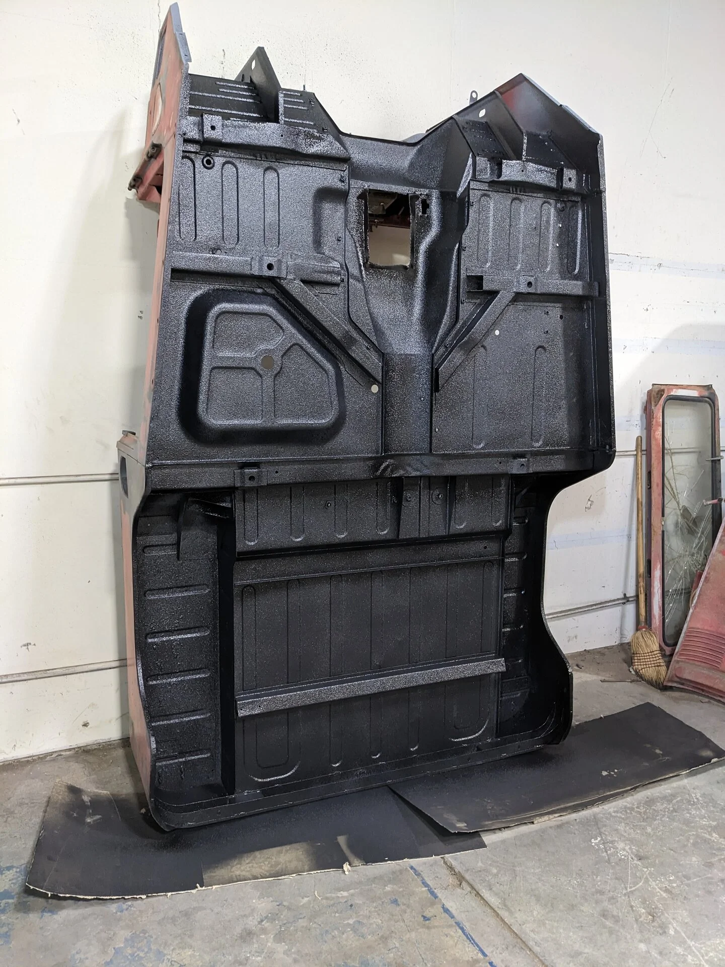

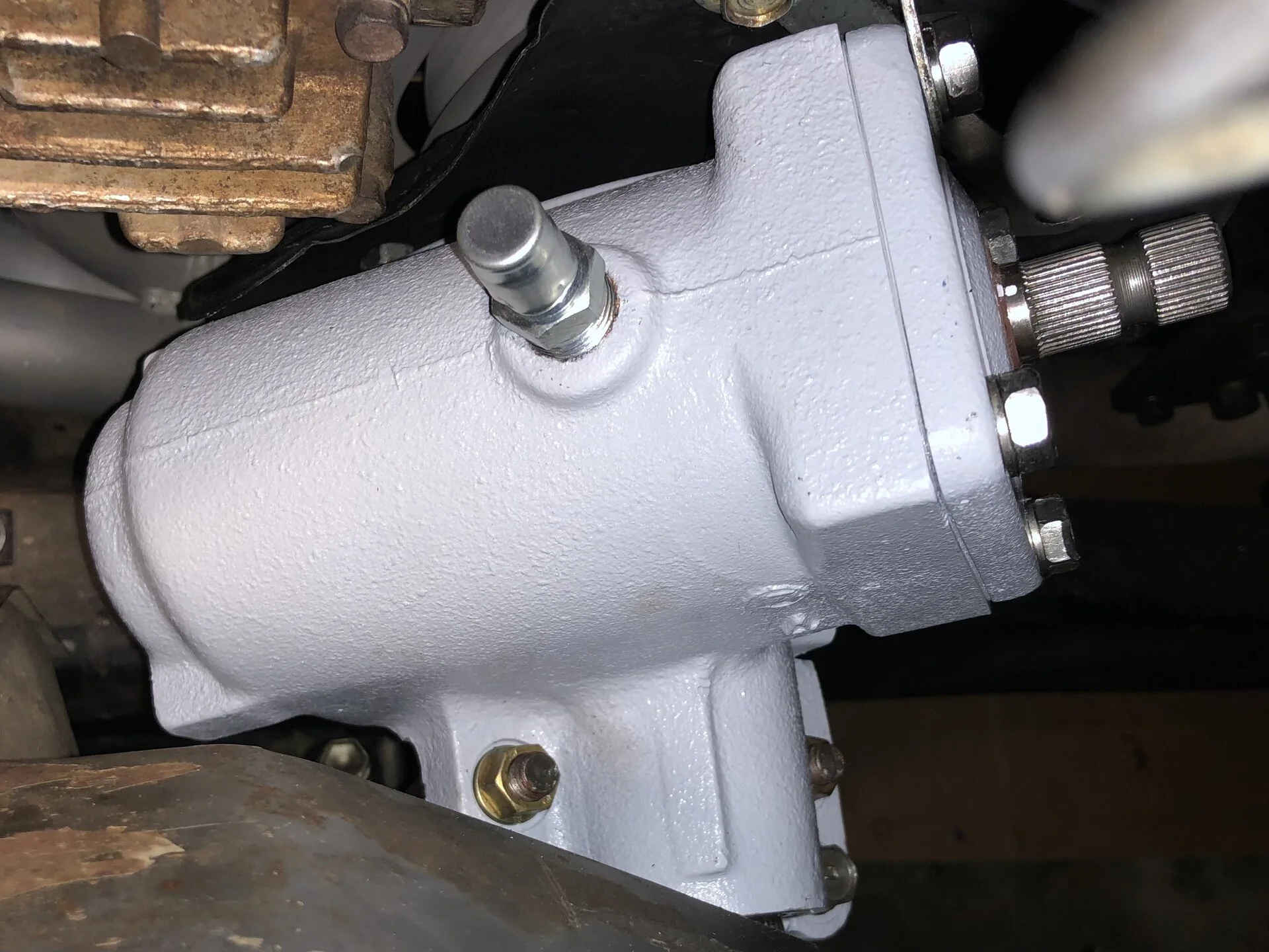

More scrubbing and wire wheeling.
Wiped down twice with wax and grease remover, 2 coats of epoxy primer and 2 coats of Sherwin Williams Genesis coating.
Will spin around on Monday and strip inner floor and firewall and prep for 309 Freeborn red color match Genesis coating.
Jason
