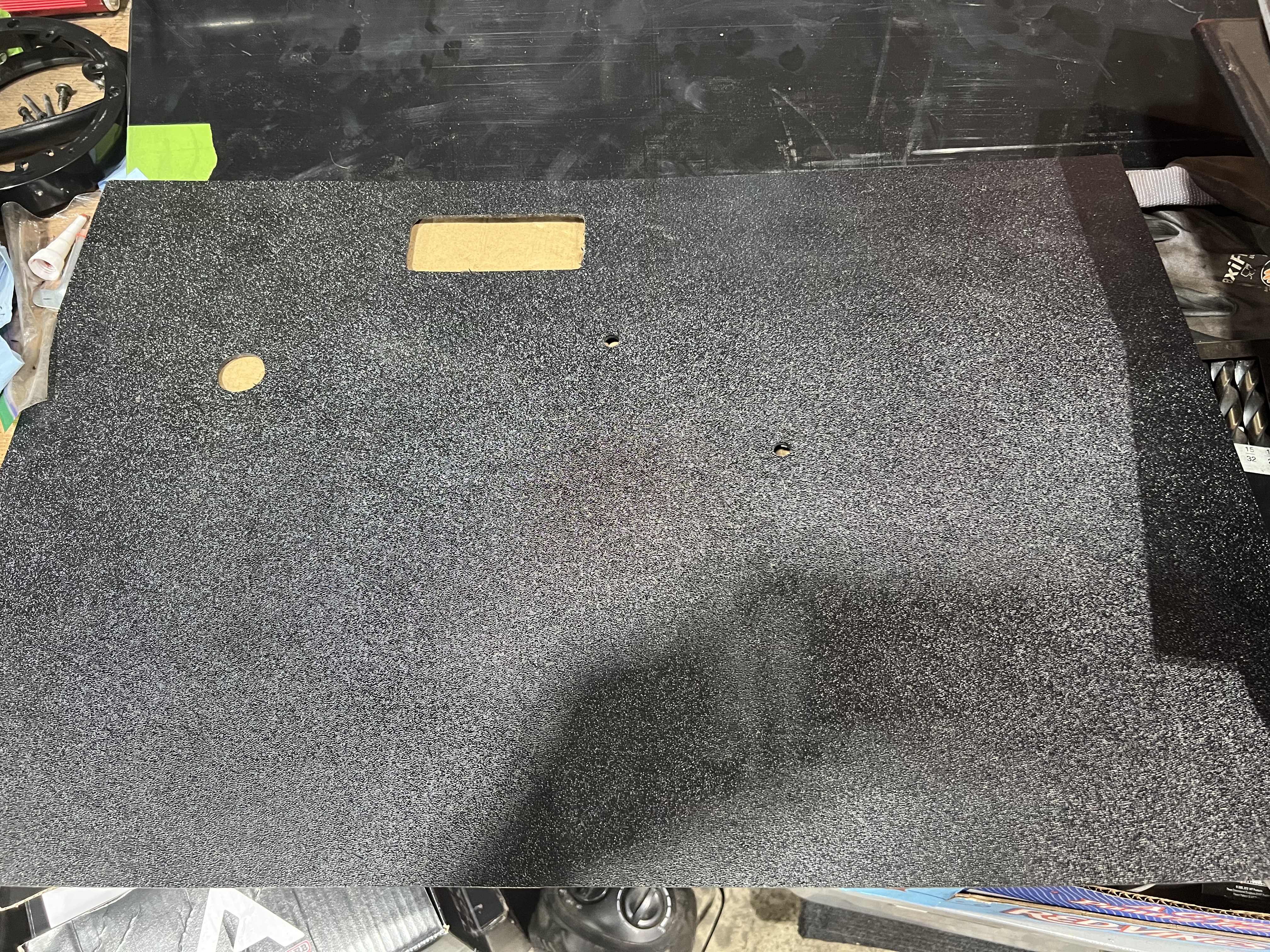

I started working on the interior upholstery. I bought a sheet of ABS and used the current door cards template taped to the ABS sheet to route a new blank.

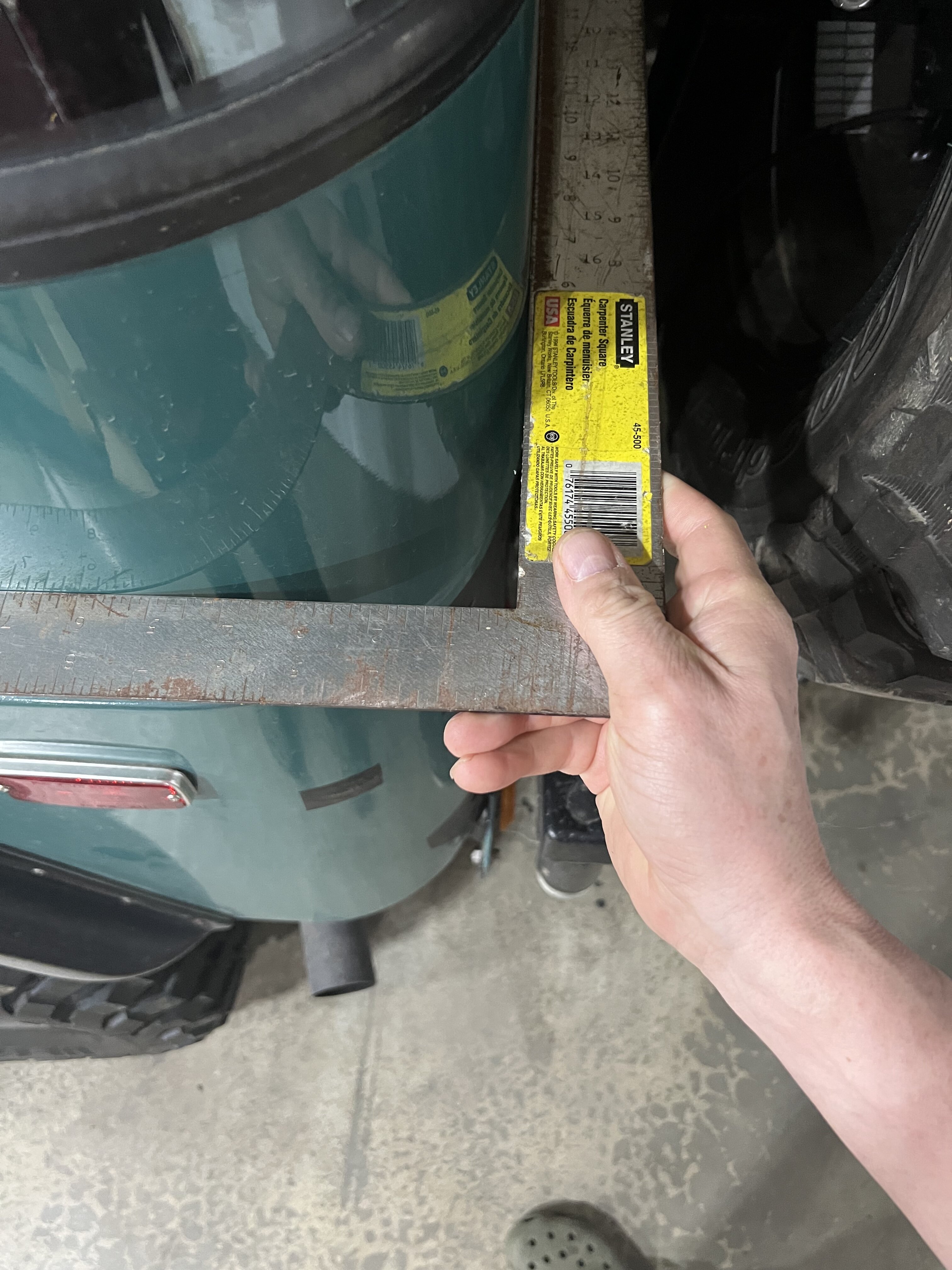

I'll fiberglass speaker rings onto the new ABS card, cover with second skin foam and then cover with the same vinyl as my seats. I'll also cut 6 x 56 inch ABS strips for the space at the bottom of the top at wraps around the back. This will also be sound treated and covered with vinyl. But I'll need to heat and bend the strip to match the rear corner. I was just going to use a paint can but I decided to do some research and measure it the right way. I'm sure most of you either know the dimensions or know the technique, but I'll leave this here for posterity.
Use a square on the outside of the curve. Measure the distance from the corner to where the square touches the curve. I got 6 inches.

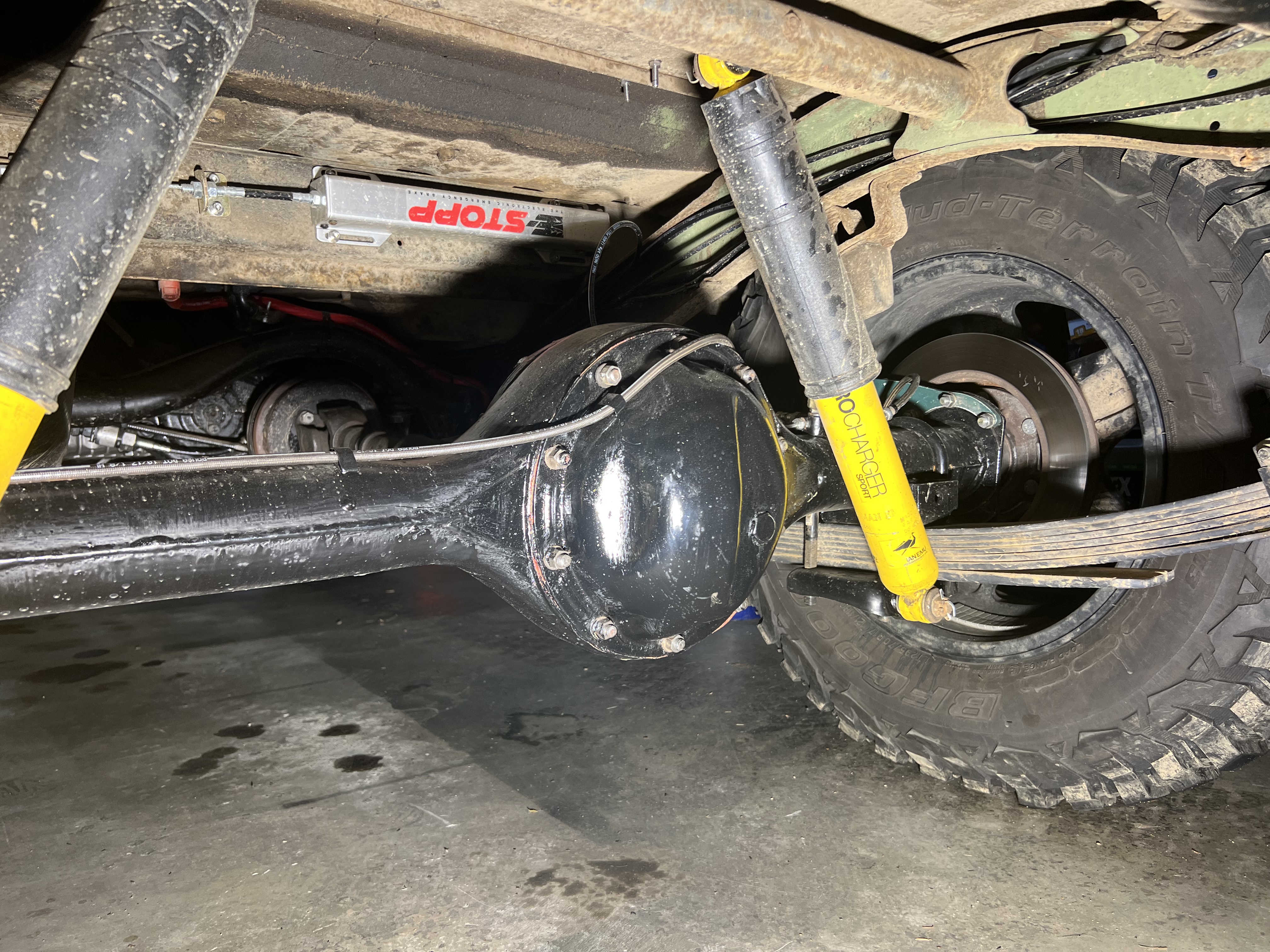

Custom springs from Alcan, rears are 6" longer, axle pushed back about 4", 160 lb spring rate, 80 rear axle,
Saginaw, 2nd gen 5.7 with Vortec heads, sm465 to 203 doubler, split case with 3:1 Mark's gears
Replaced forward rear hangers and shackle hangers with late model so I could use the 18mm spring and shackle pins. The late forward
hangers have factory bracing that the earlies don't.
60 series rod ends and a 1 3/8 x .313 wall tie rod. Wagoneer pitman arm with GM hi angle rod end at that position
Front axle widened to match 80 rear, 4:88 with ARBs front and rear Have to build the cage and paint. Have Beards Superseats to set into the cage.
